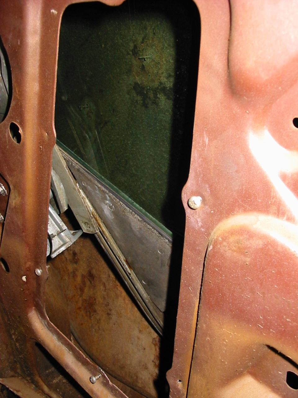

I thought I’d start disassembling today, to prepare for the installation of weatherstripping – gotta take the back apart anyway, the driver’s side rear window motor is frozen. (More about that later.) So I very carefully follow the instructions on page 49 of the service supplement: remove front run channel to lower stop attaching bolt… Got it. remove two bolts attaching lower stop bracket… piece 'o cake.
_remove upper window stop bracket on window lower channel…_child’s play. remove front run channel upper attaching stud… (yawn)
_run glass all the way down, disengage lower nylon bushing…_fershur.
_remove front run channel by pulling straight up…_uh-huh. disengage nylon roller from center run channel.Whaaa?!!
How?! When I run the window all the way down, the roller is no where near the end of channel travel…

OK, I’m off today. I gave up on trying to get the roller out of the channel without removing the regulator. The regulator removed quite easily, and the roller quickly slid out of the channel. Alright!
Now, to remove the window itself. The manual says the window should be all the way up, and slid forward as far as possible to remove the rear roller from the channel. Well, I’m doing that – but, it’s not far forward enough! I still don’t have enough wiggle room to remove the window.
Am I missing something? Shouldn’t I be able to do this?

The old, upper weatherstripping pulled right out of the channel. Then I was able to pull the window right out. Hmmm… I wonder if the stuff I bought from Bernbaums, will lock in that channel the same way, without glue. If I ever have to take the back apart again, it will be an important consideration. What do you think? Glue, or no?
It’s obvious: The stuff from Bernbaum locks onto the channel. In fact, the channel is removable. In fact, I can see now that the channel must be removed when I go to take the upper stainless trim off for polishing (and, the interior upper rail for rechroming). So that’s what it’s all about…
The book says nothing about removing the regulator, or the upper weatherstripping channel, in order to get the rear window out. But, I don’t see how one could do it otherwise.
