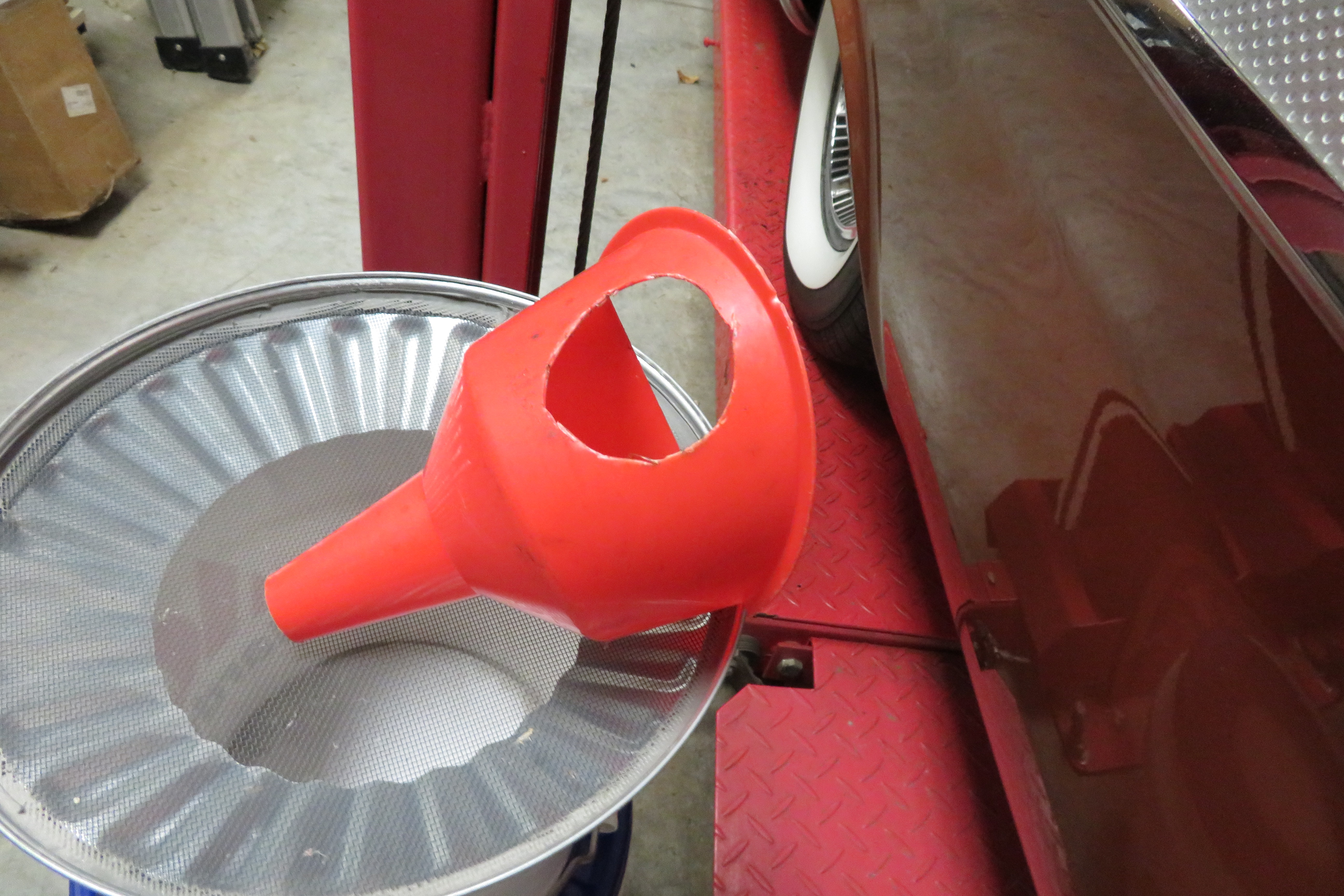

I cannot solve the problem of lost gas in the filling process, but have a solution to any gas running out of the filling tube during a fill up. Bob Hinds (Previous Owner of my car) utilized a funnel with a hole cut in the side of funnel near the top. (See attached photos) Hole should be larger than car’s filler tube. Before inserting the nozzle, hook the funnel over the neck of the filler tube and then insert pump nozzle. Funnel will catch overflow gas and direct it away from the side of car onto the ground. Otherwise overflow gas will run down the side of your car and behind and along the chrome trim below. (You can wipe off the gas on the side of the car but not the gas that runs along the backside of the chrome trim. Consequently, that gas will run horizontaly behind the chrome strip and then drool down the side of the car creating and unsightly mess.
