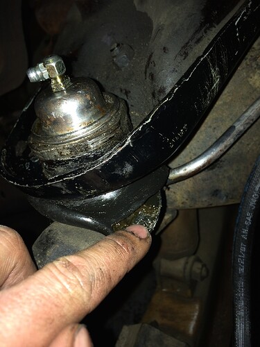

Hi guys,
In a glance of spontaneous stupidity, I “overgreased” one of my front upper ball joints on my 59SF today and the rubber cone burst open (see picture). :blush: Well done, Eddie :laughing: Ok, now do I have any other option than to replace the one (or better both) upper ball joint? I found there’s also a Mopar ball joint kit, which comes with new cones/washers etc.: http://www.ebay.de/itm/57-58-59-60-61-62-63-chysler-dart-desoto-dodge-plymouth-upper-BALL-JOINT-KIT-/231032695208?hash=item35ca9f29a8:g:yOsAAMXQ56ZSConZ
I’d rather replace the rubber than the whole ball joint, except you would recommend replacing the joints anyway. I dug a little in the forum and online and it seems at first I’ll need special tools for that, i.e. ball joint socket (1 15/16"?) and a puller… Ok, might run over to the local Chrysler dealer or US car shop and ask, if I can borrow the tools from them. Should be possible to find them somewhere I hope…
