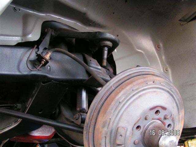

Well, I wasn’t under the car for very long today when I realised the front end needs a total rebuild. The upper balljoints are worn out. Back in '94 when I bought the car (sight unseen) I ordered up a front-end rebuid kit from Bernbaum. That kit has sat on the shelf these past 14 years. I will now look for a shop that can do this job, as it is beyond my capabilities to install. I’d include a picture or two , but I don’t know how.

Only just now have I wanted to use them. I stopped in to the local shop this am, because I hadn’t heard from him for few days. There I learned that Bernbaum had sold me the wrong lower balljoints…I need the ones that screw in, so the mechanic is searching all over for the correct balljoints.

well, $800 later the job is done. He said most of the parts I supplied were wrong (thanks Andy Bernbaum), but the correct ones were available from HIS sources (I admit I was just a little bit suspicious here). The clunking was from a LOOSE steering box (yipe!). He says I could still use an idler arm. The car does handle better, but now the brakes need attention, the defrost button doesnt work and the brakes need adjusting. For a piece of rolling art, sometimes I would almost rather hang it on the wall!
