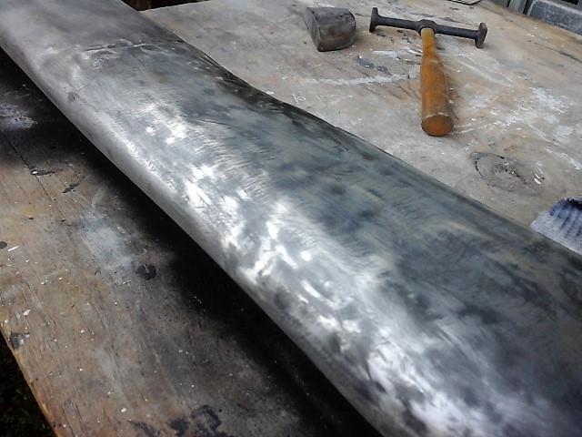

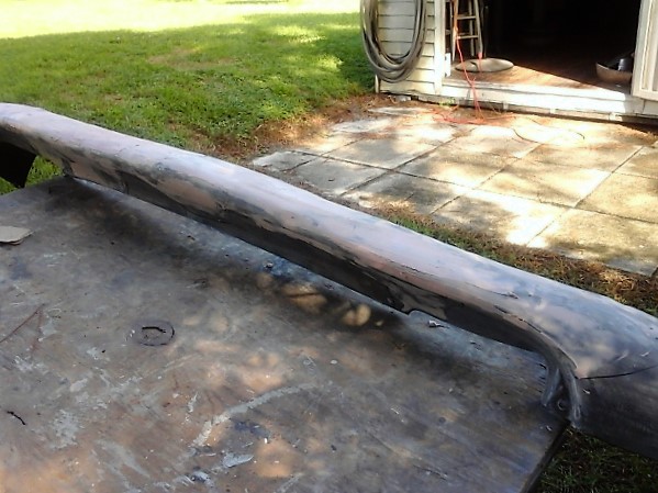

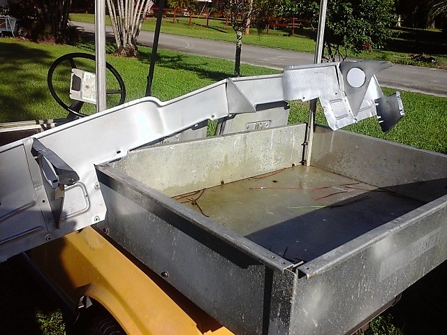

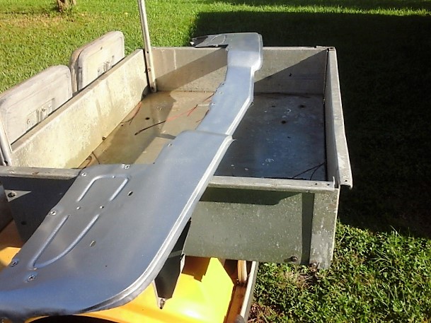

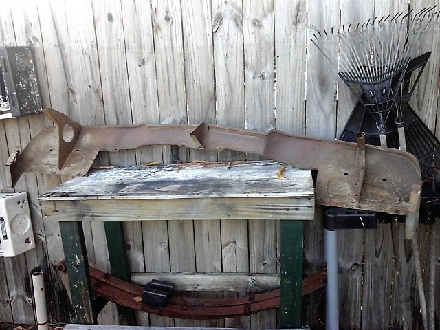

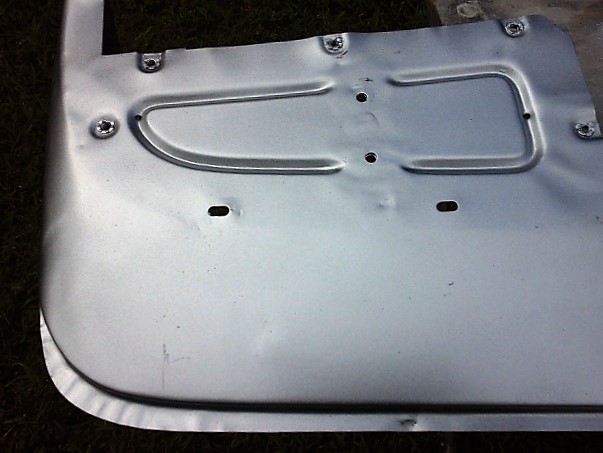

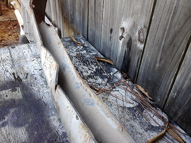

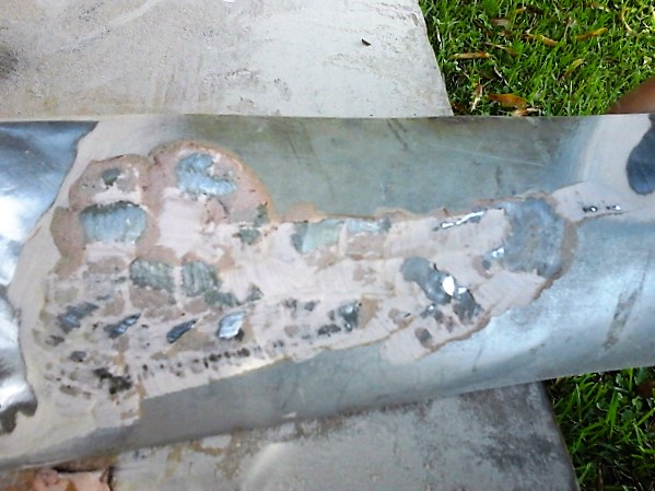

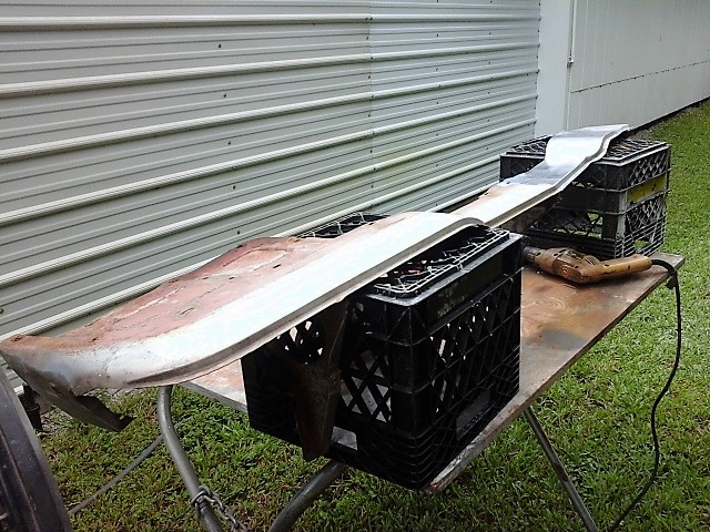

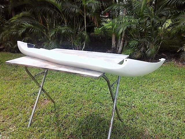

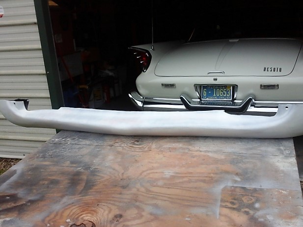

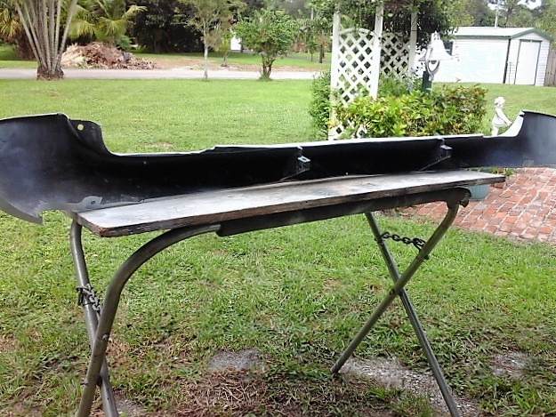

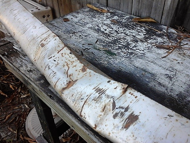

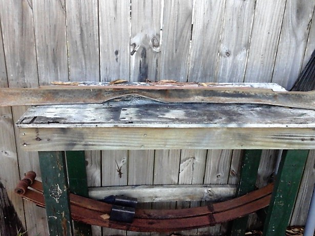

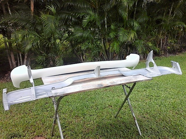

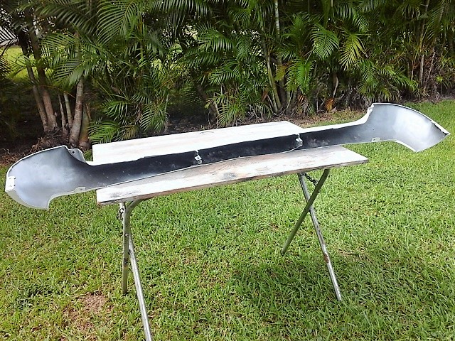

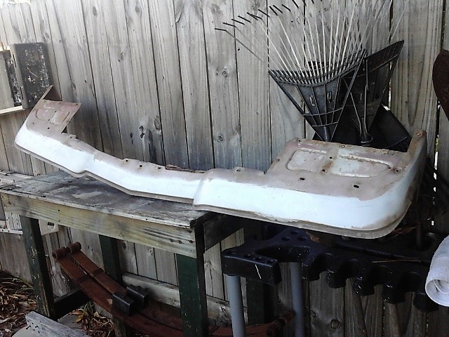

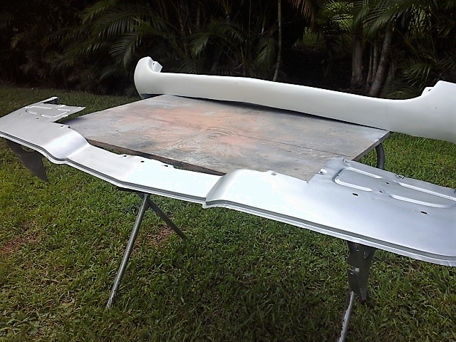

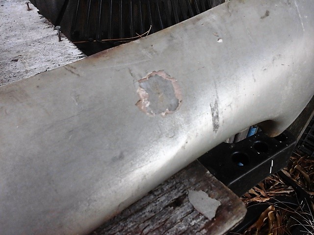

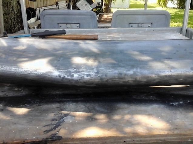

Hokay, some pitchuhs of Dans front splash pan and valance. Before, during and finished. I don’t know if they will be in order or not, but you will get the idea. The valance brackets had to be welded back on and a few tears in the metal was welded.
Dick, astonishing craftmanship! I can’t wait until Faulkner is ready to be reunited with valence and splash pan.

Thanks, Dick, for your beautiful work and generous payment terms.
Craftmanship!!! Bondo solves most problems.
:astonished: I am only fascinated by good body repair! Note: It makes me too angry and inpatient, when I try to do it myself, I need another “Colorado Native” I will bring some cases when I get back east.

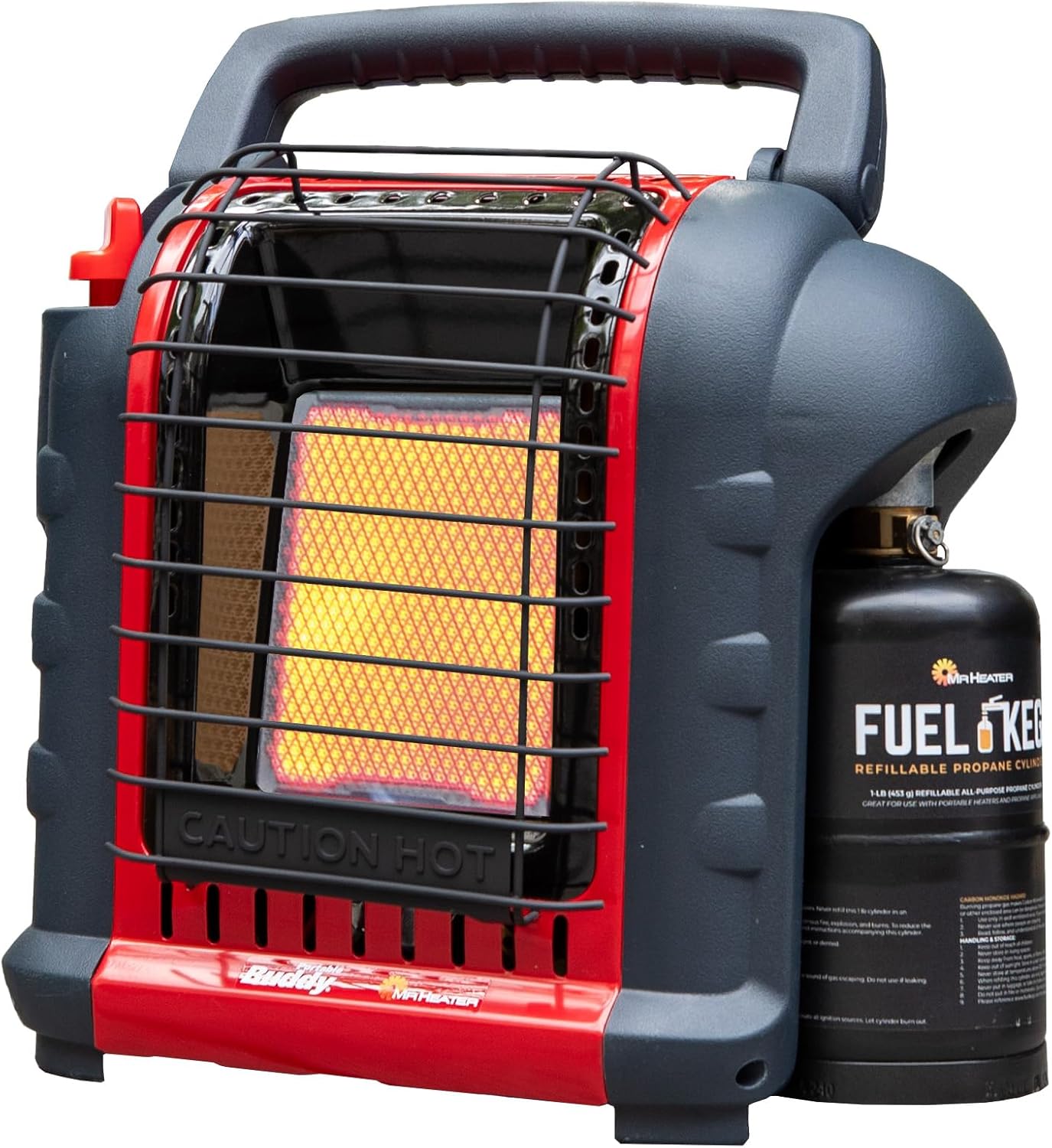

Well, the holidays are upon us. But soon the shopping and making merry will be over, and I’ll have a week off between Christmas and New Year’s. Let’s see if I can get anything done in the garage, with this:
I also ordered a ten-foot attachment with an adapter that let’s you run it off a standard 20 lb. propane tank, instead of the weenie tank shown here.
Is this a radiant heater? catalytic type?..looks good. Here in Co Col Cold Colorado.
Looks small for the temp you get. What’s the BTU’s.
9000 - ought to blow me out. I’ll be working in shorts and short sleeves.
I would think you would need at least 300,00 BTU! what with snow and all. But living in Florida maybe l mis-judge, you think. Oh, l forgot, going to car show tomorrow, if weather is good 500 to 600 cars.
I don’t think there’s any heated ceramic that radiates, Rick - just the heat from propane burning. Reading the reviews, it seems very safe - no CO, just CO2, which we breathe every day.
