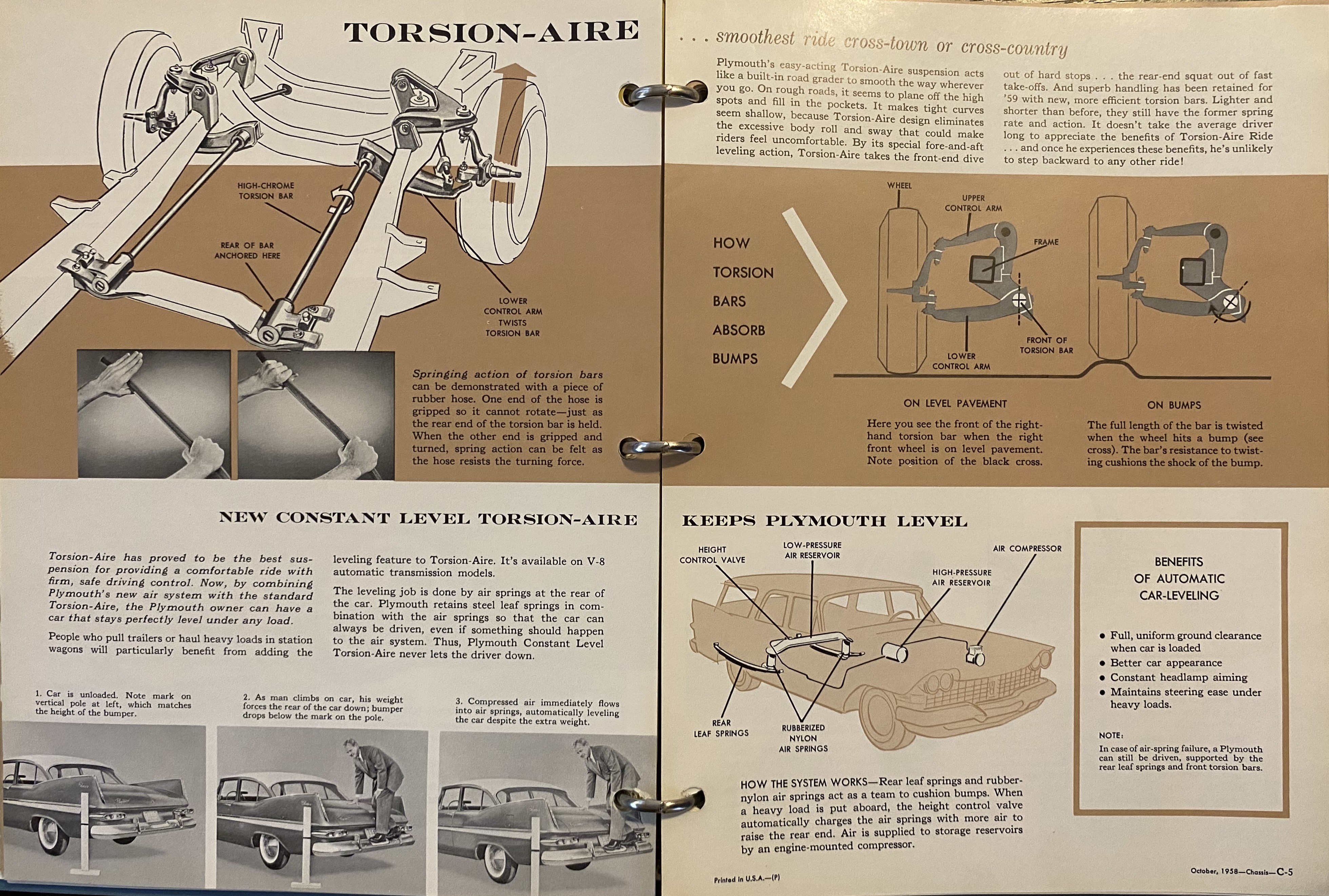

Hi @Whiterabbit - I was thumbing through my Ross Roy Data Book just now, and came across this!
Not that it helps you any in rebuilding yours; I just thought you would like to see it.
It is helpful, as it lays out things that could be missing… that being said, from what ive been able to learn is that its a rare option; it had a high failure rate and was prone to rust out rather quickly due to moisture build up in the pressurized parts of the system. Most dealerships were not trained to service them and literature was (and is) sparse, so its no surprise that so few are out there
