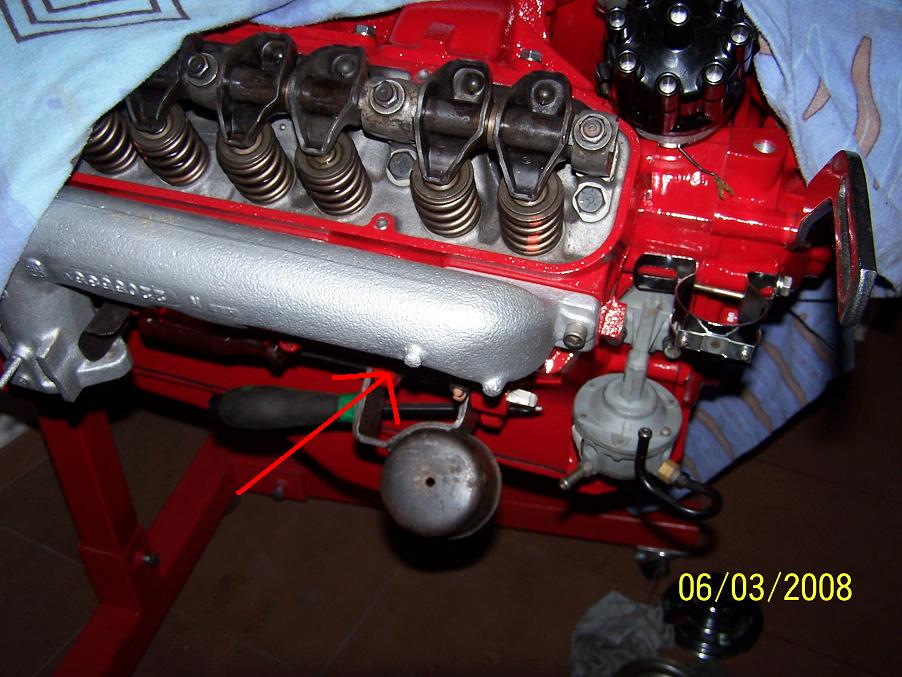

Hello,
usually the right exhaust manifold has a special support where the generator can be mount. My 361 came without it. Does somebody know why? Is the manifold not correct or maybe some cars came with a different manifold – but why?
Thanks
Stefan

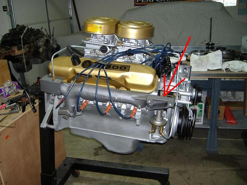

Looking thru the 1959 Mopar Parts Book, on page 9-12, they reference the part as #1739 597 for engines numbered up to 47334. Then they changed it to Part # 1946 969. My guess it the original design was prone to cracking, so they eliminated the generator attachment points.
I do not know how the later models attached their generators! Something for all 361 owners to check on their cars!

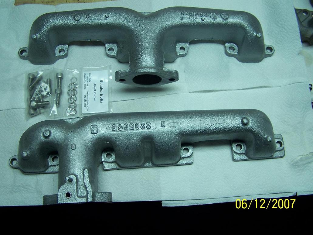

The # on the manifold shows 2205535
well, there you have it! The manifold is from a newer car (early to mid-60’s, right John?)
Thanks Roger & John, I’ll have to make a bracket.
That’s it, Roger, first used in '63 with Alternator application, hence, no Generator mount. I’m sure I have the correct manifold if you consider going that route. —John
