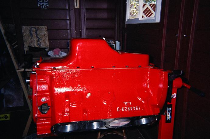

The engine is a natural ‘ML 361’. As far as I can tell, other than a valve job it was never apart. Being totally anal about this project I thought I would concentrate on the power train before actually getting a vehicle.

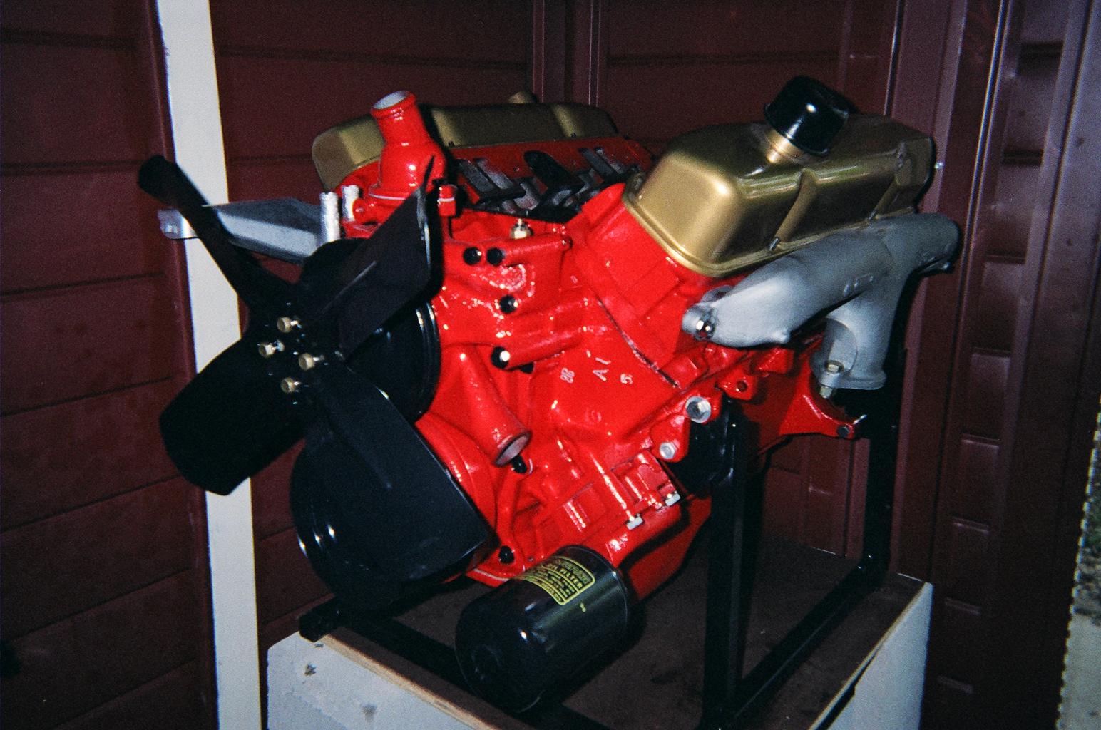

After a complete tear down and inspection I was so pleased to find everything standard size along with brackets and looms I never thought existed. I have acquired most of the new engine internals for the rebuild and have started ‘preparing’ the externals to go back together. It will be totally factory stock – with factory plymouth golden commando colors – along with the dual quad option. The only thing I am taking liberty with is the color of the bolt heads. There was just too much red on this engine!
I am pleased to say, that it will go back together with standard size main and rod bearings – she was that well preserved. I expect to have her together and ready to start or install by next summer. I am taking my time and enjoying every little operation. Next spring I’ll work my way back as I purchase a cast iron water cooled torqueflite to play with just waiting for the right body to come along.
Yes – the gold bolt heads are incorrect – but it came out so good!

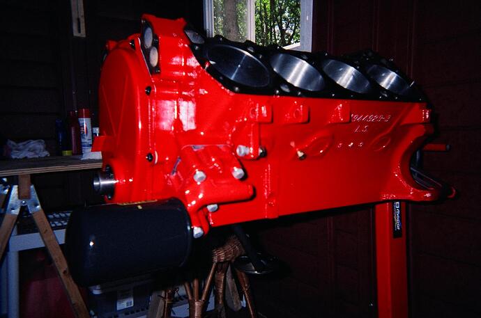

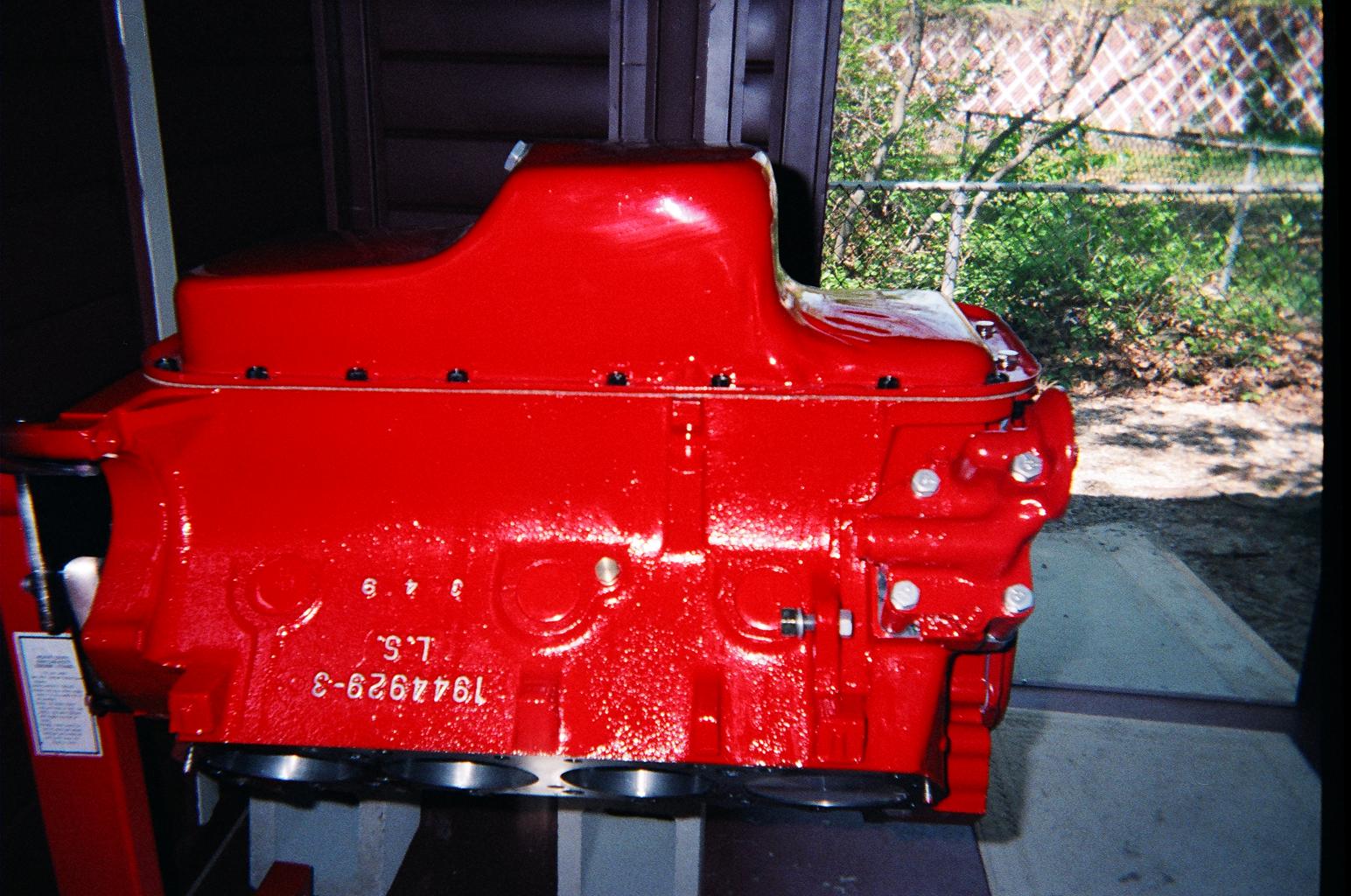

Bare block right after teardown

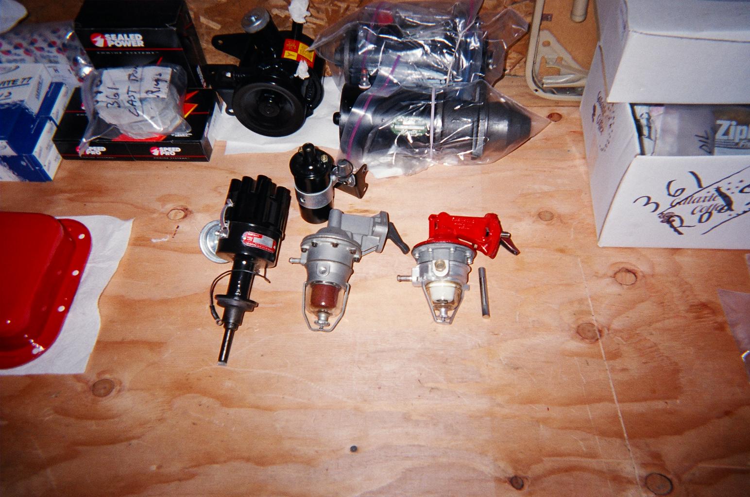

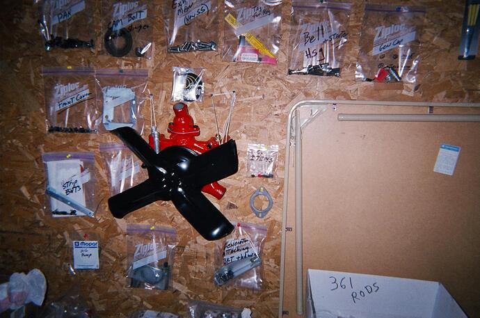

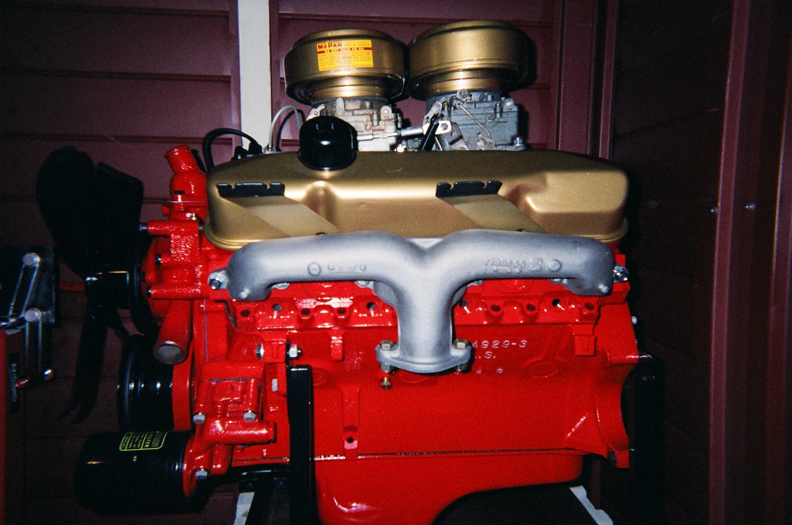

Finished items ready for final assembly!

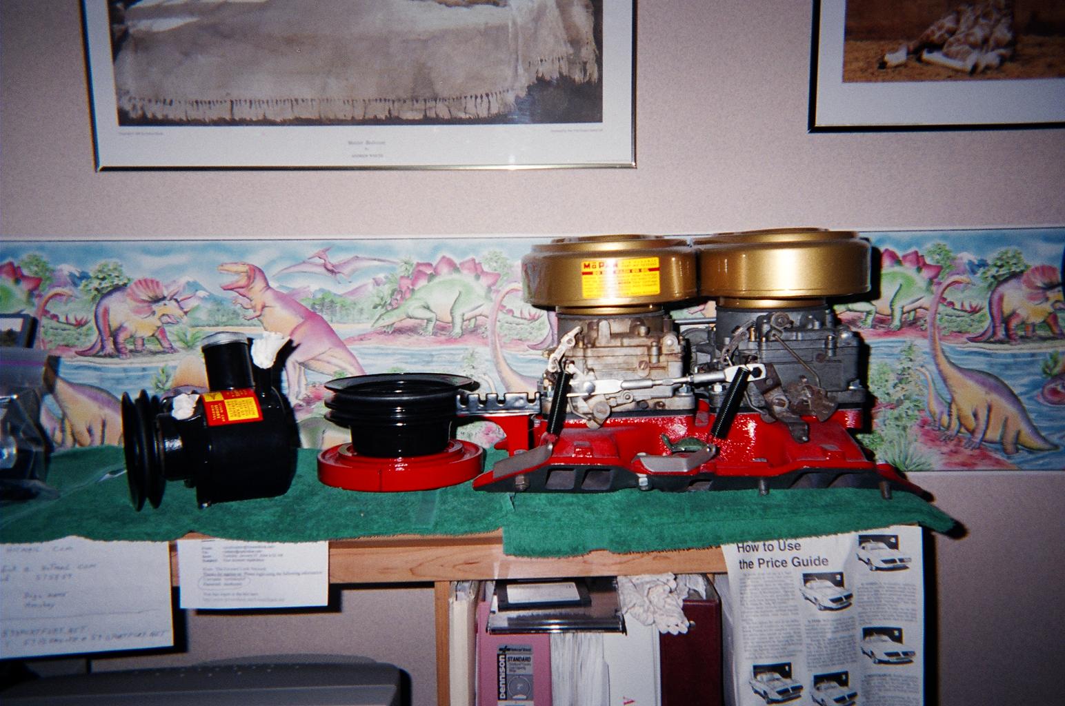

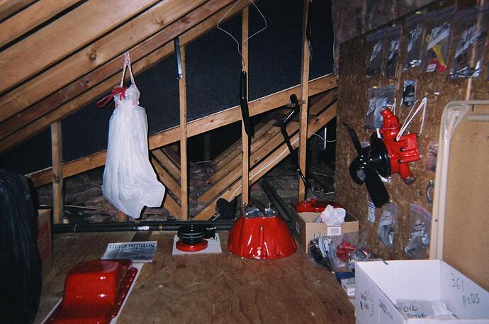

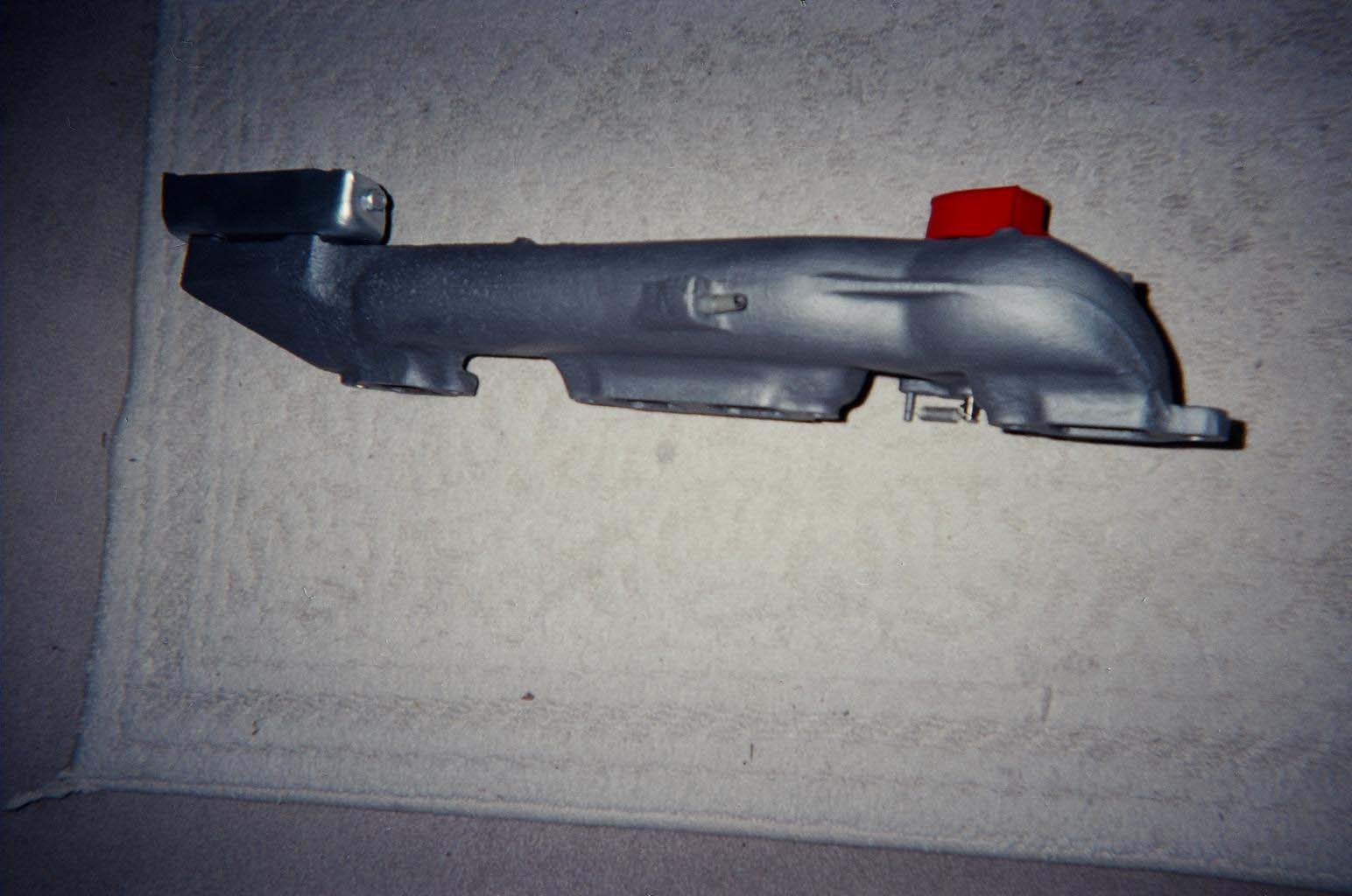

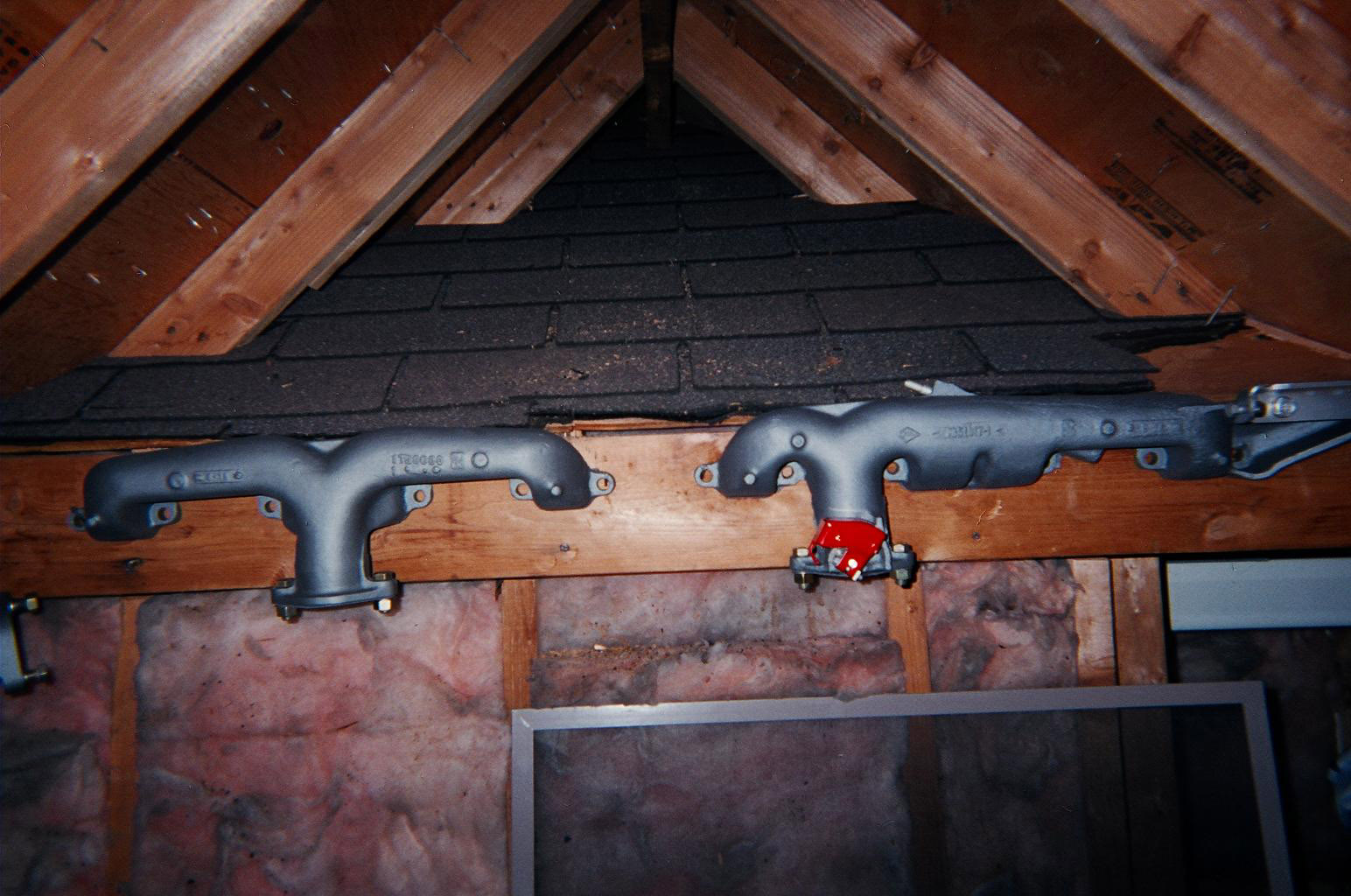

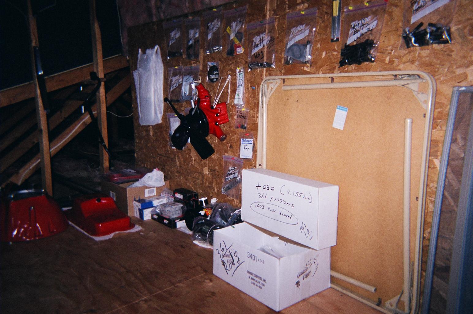

My attic is now complete with the 2 manifolds – I now have all parts! …and ready to assemble. In my opinion, the most elusive part! It is totally rebuilt, stripped, coated, new heat riser, new pins, new stainless heat tube. This was a fun item to rebuild.
You have no idea how hard this was to locate. If I told you what I paid for it and how much the parts and coating were total – I’d be embarrassed!

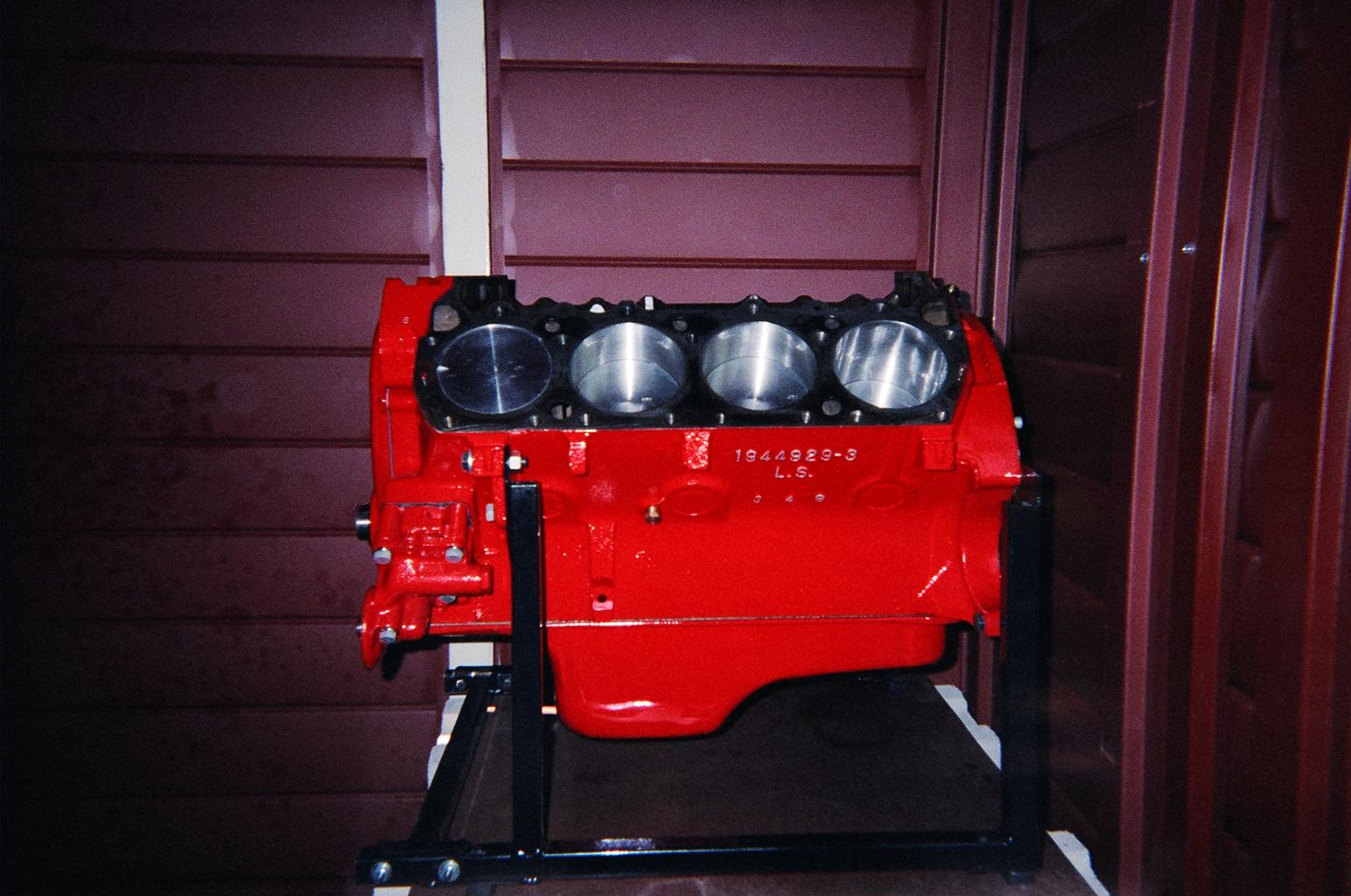

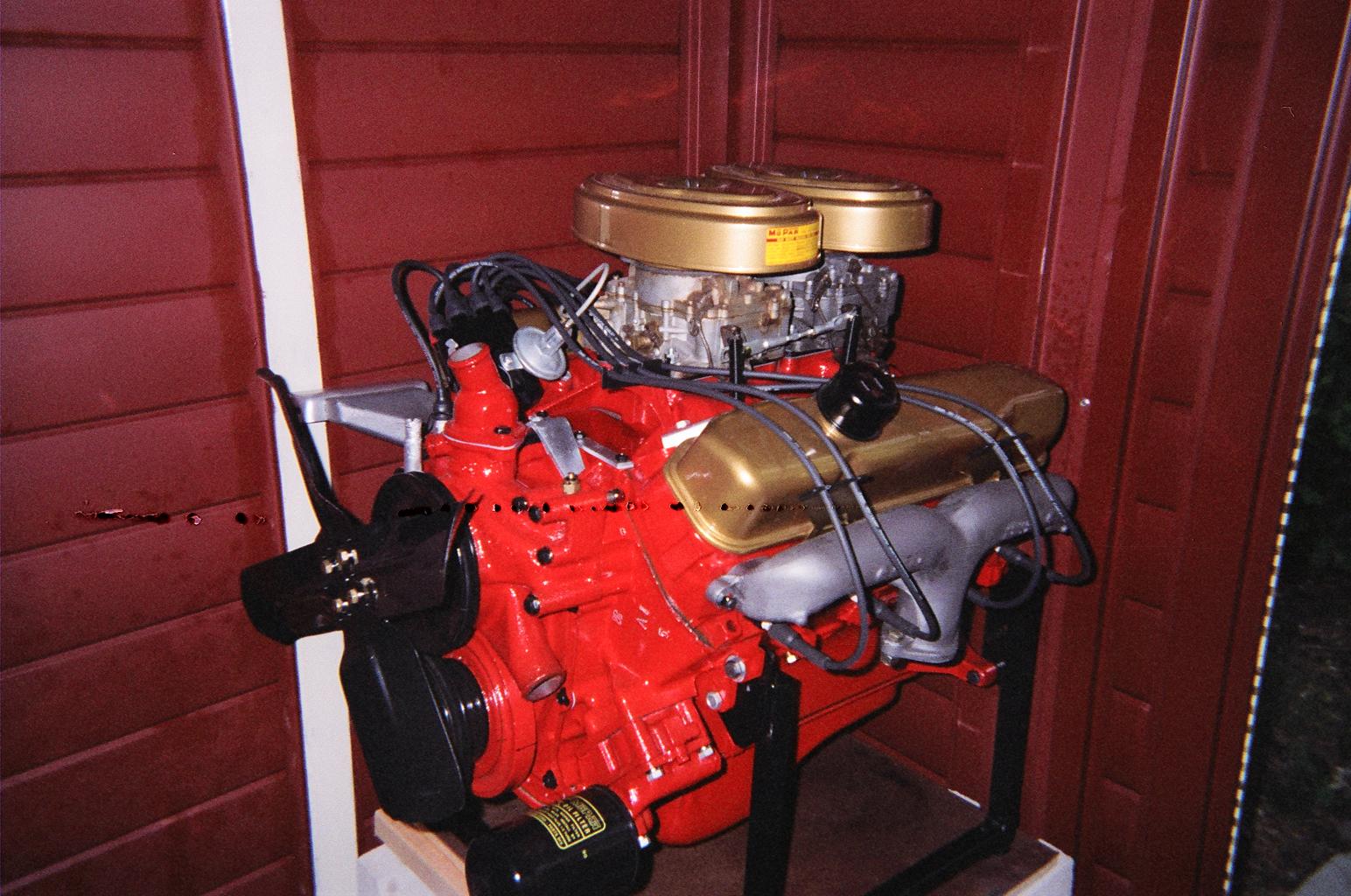

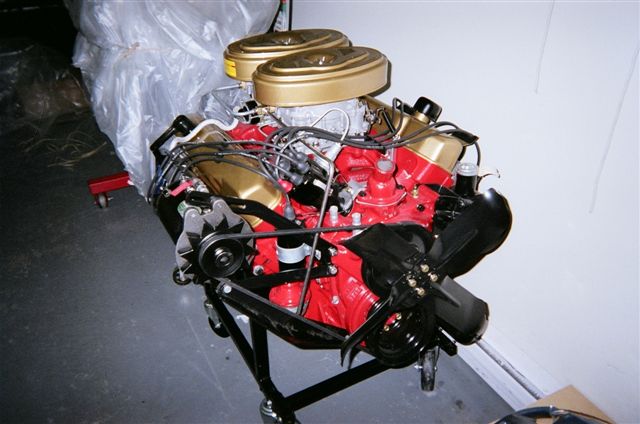

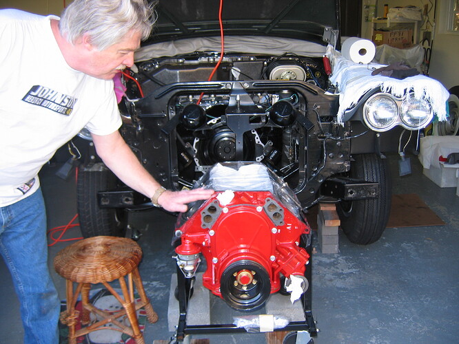

The Short block is complete and assembled! All clearances came out exactly to plan–she really came out nicely!! Rods and mains are standard size with .0015 clearance, pistons will supply a stock 10/1 comp ratio at .003 piston to wall clearance. The ring end gap is .012 with plasma molly rings, a bit snug, but it’s stock and should allow for no blowby at all.
I was able to paint the tops of all of the casting marks and numbers, along with the engine ID. Not exactly stock, but that is poetic license. I also went a little nutty on the bolt heads, but poetic license also.

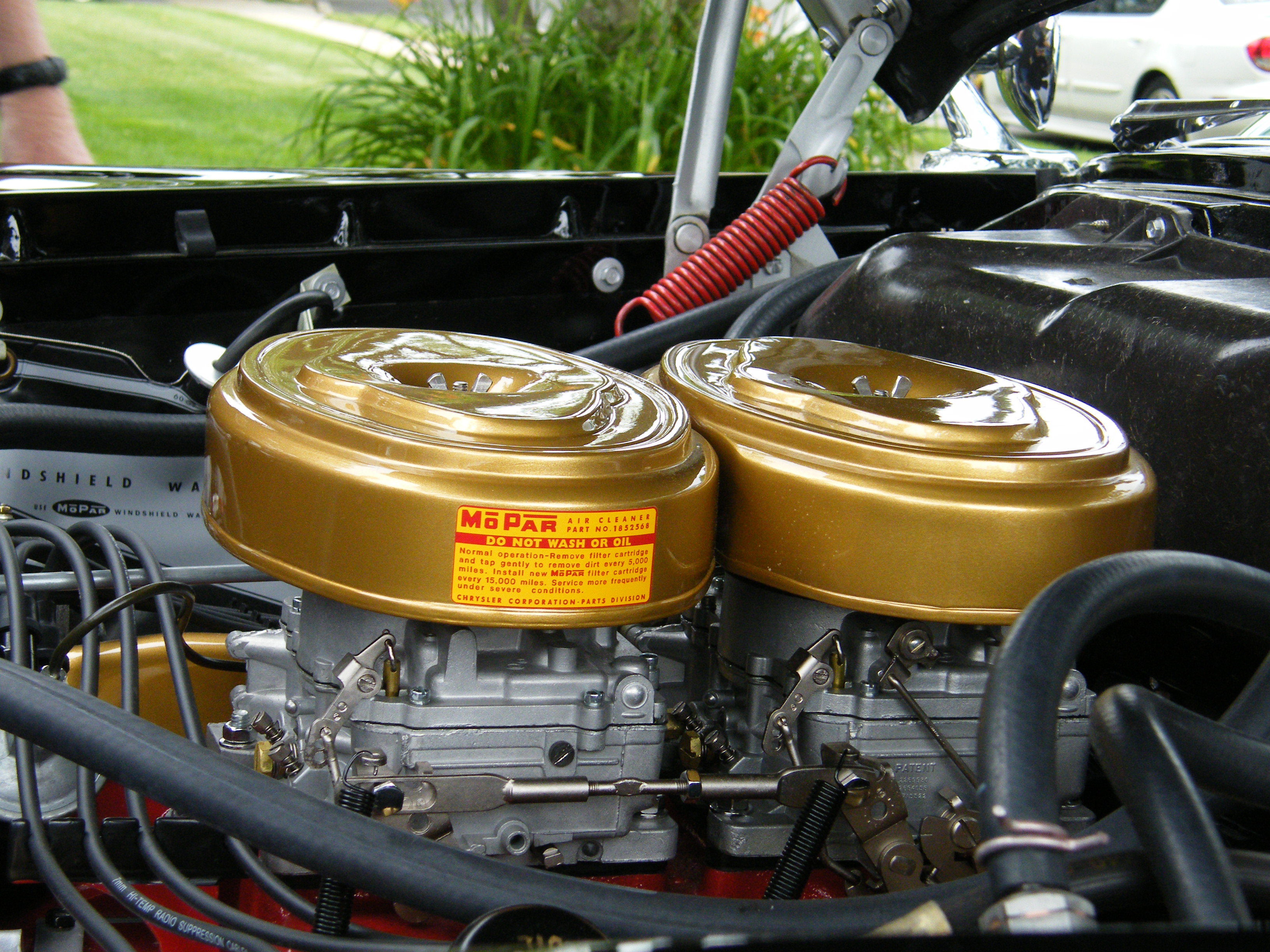

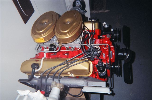

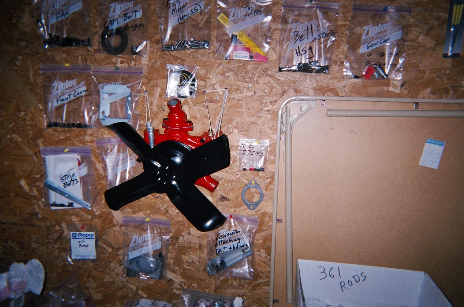

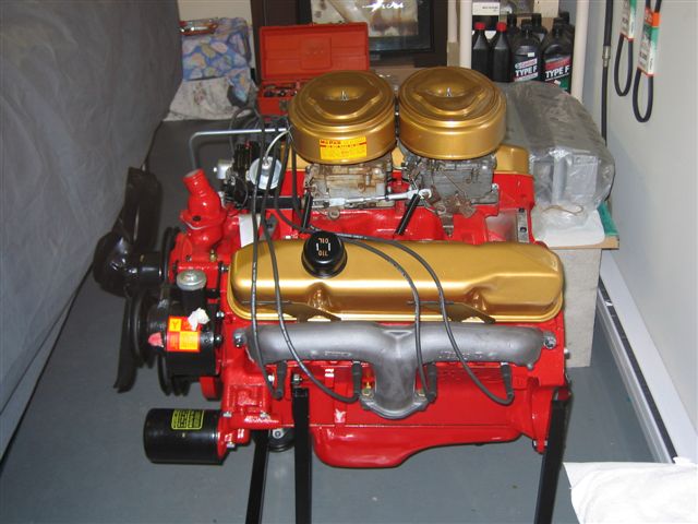

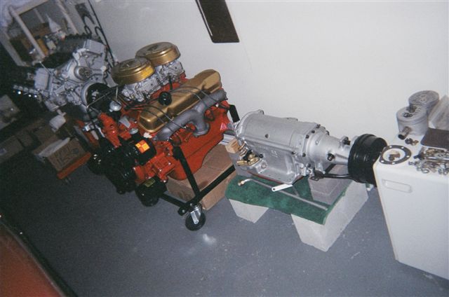

The heads and manifold are just held in place by a few bolts. I decided not to totally assemble it because of the weight involved in moving it sooner or later. The carbs will be rebuilt when I find a host – I did not want fresh carbs to sit dry if things extend for a while. All of the accessories are put away as there is minimal room where I am keeping it and no sense of hanging everything just to take it off again.

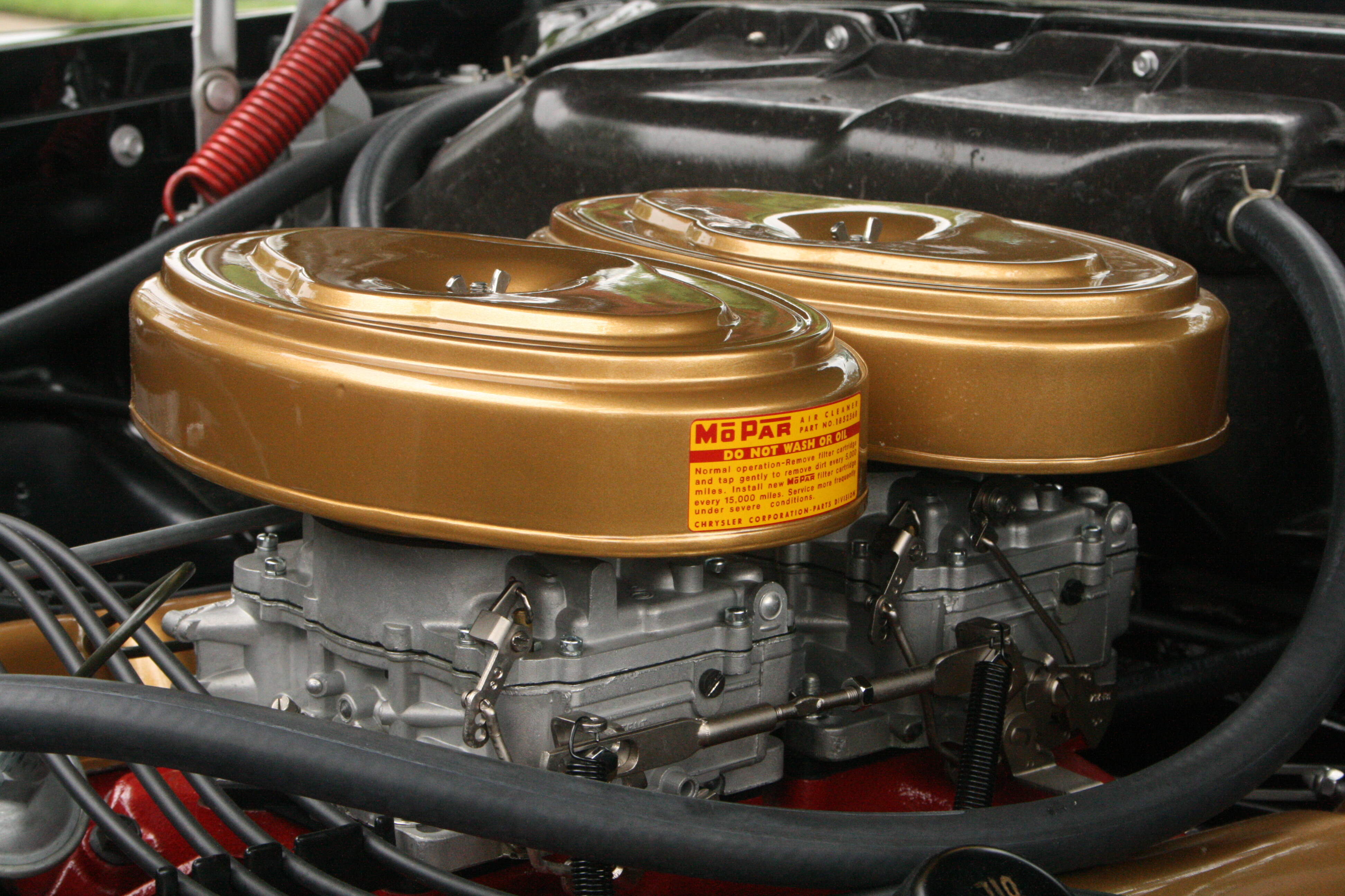

Complete except for carb rebuild

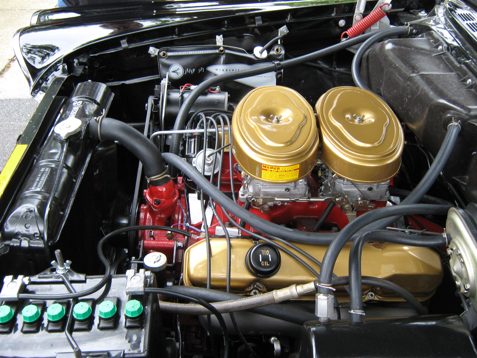

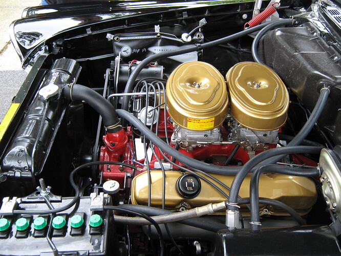

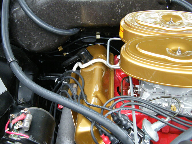

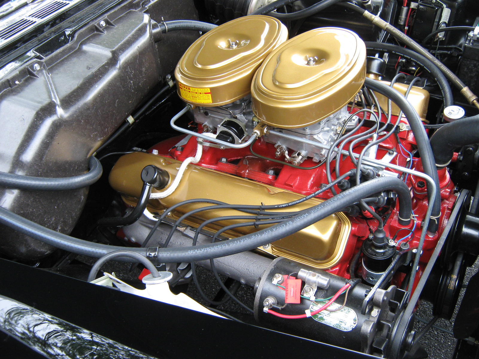

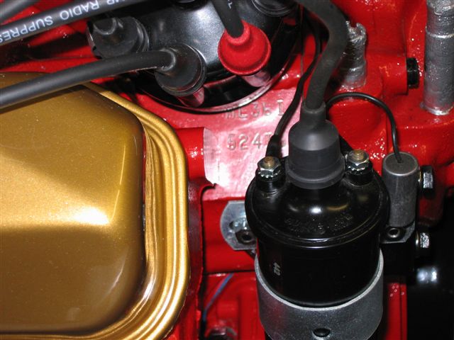

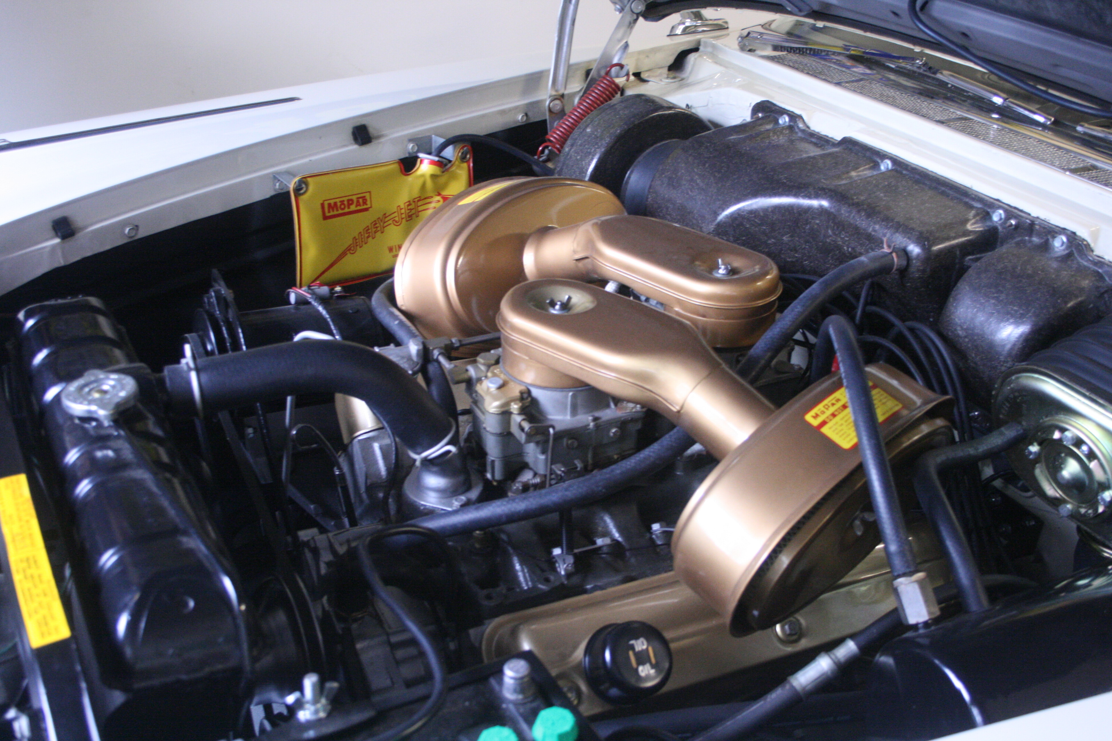

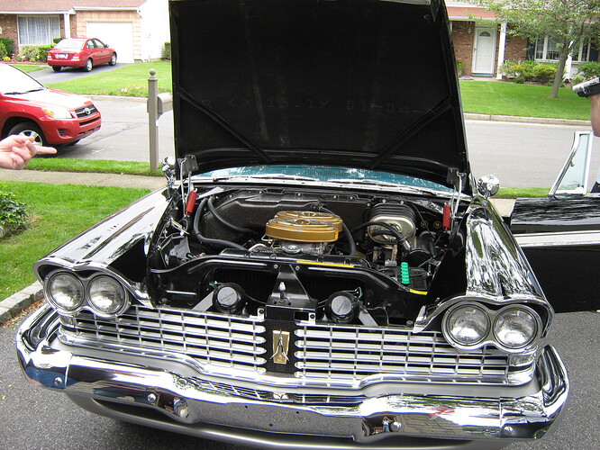

What makes this side interesting: 1) ULTRA RARE exhaust manifold with heat tube 2) WHAT A B**CH, but choke heat tube from manifold is correctly routed 3) Coil mounting bracket MOST RARE of all items! 4) Nice correct little red boot on #1 plug wire
A close up of the detail work

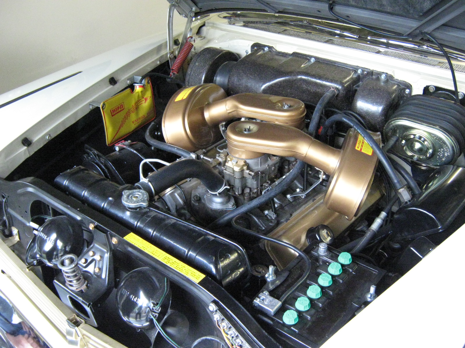

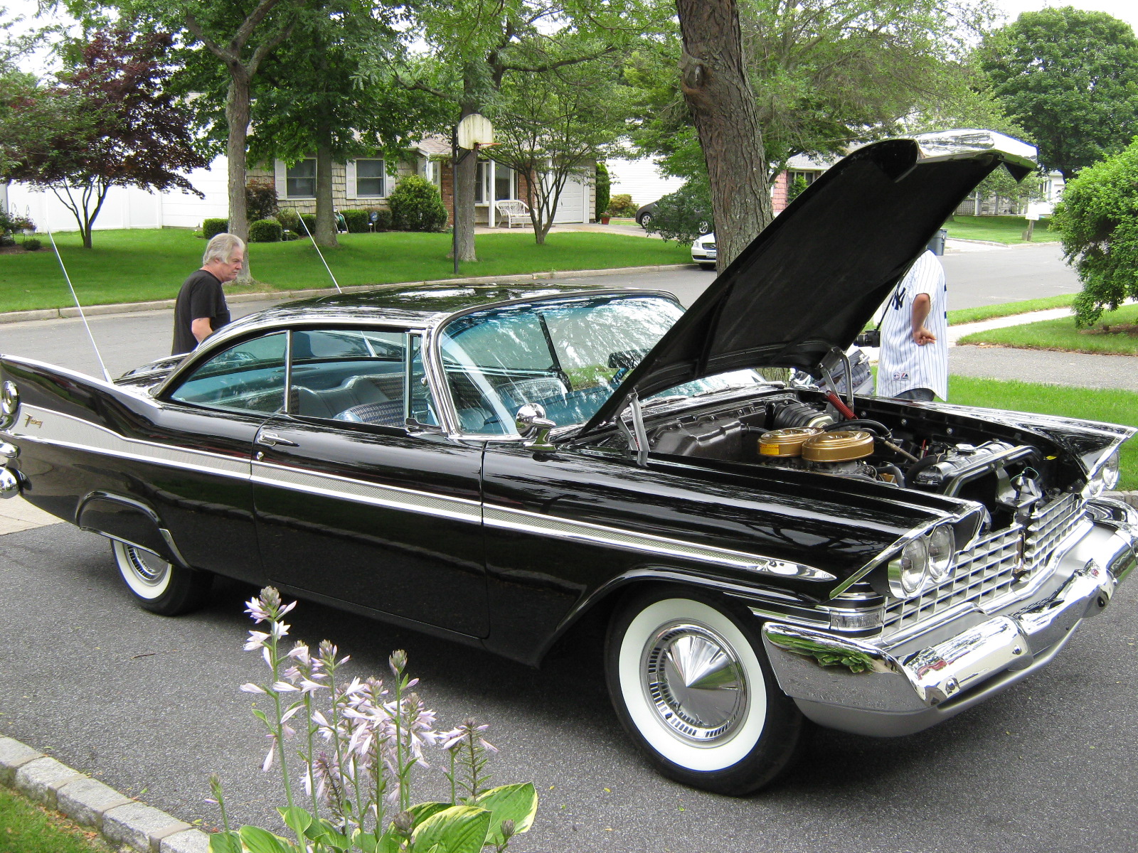

Just a few recent pics of the 361 COMPLETE with rebuilt carbs and torqueflite --just waiting for ‘BLACKIE’ and FP31 in the background
This was a fun 1 year project—I did drag it out a bit but had fun with every bolt I turned.

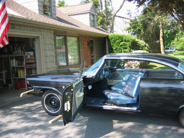

Ed finds his dream car! It’s had a 440 dropped into it, but other than that it is a diamond in the rough

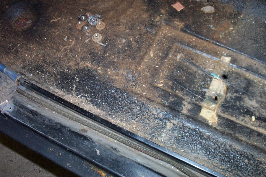

Original floor, NO RUST, LOVE IT

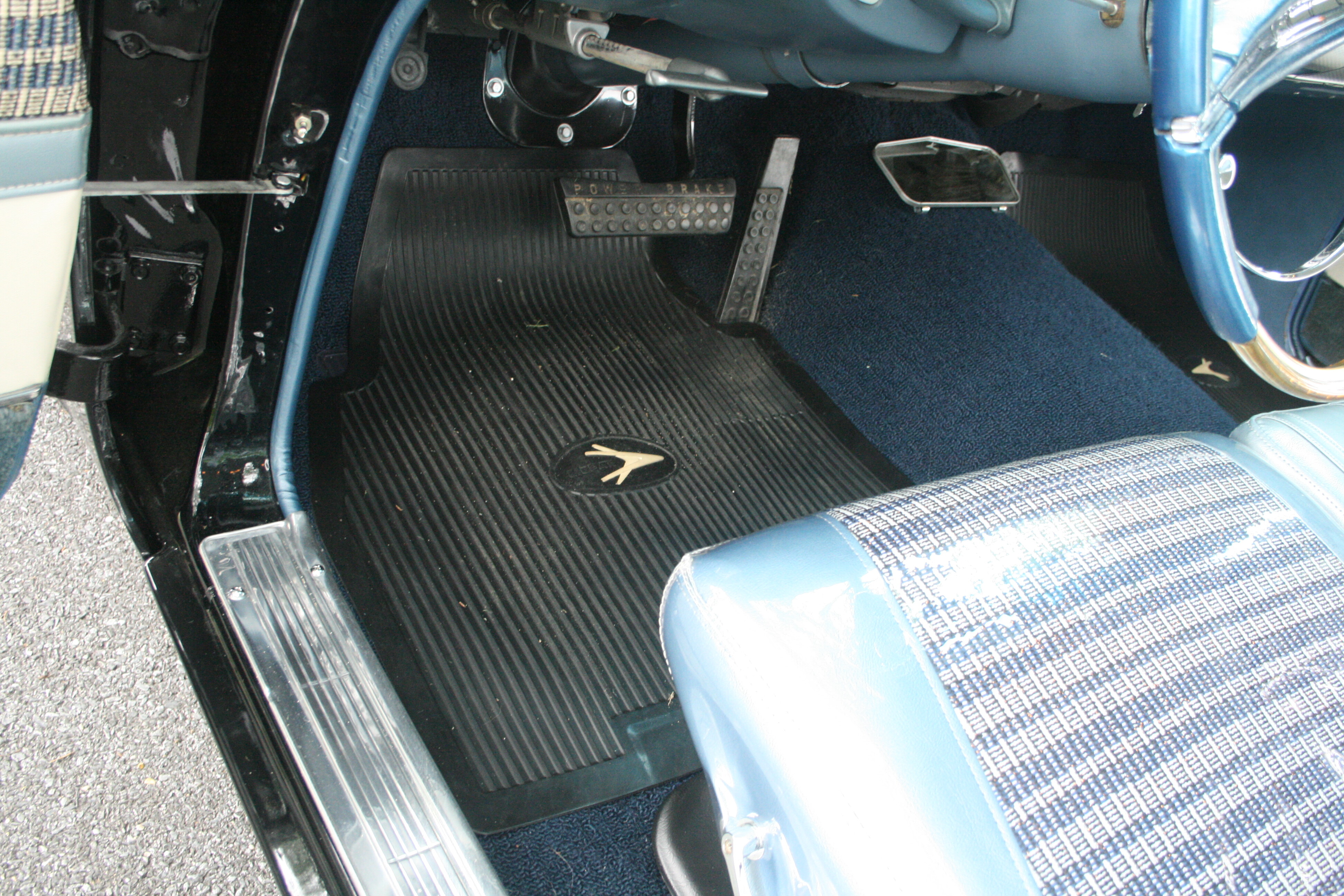

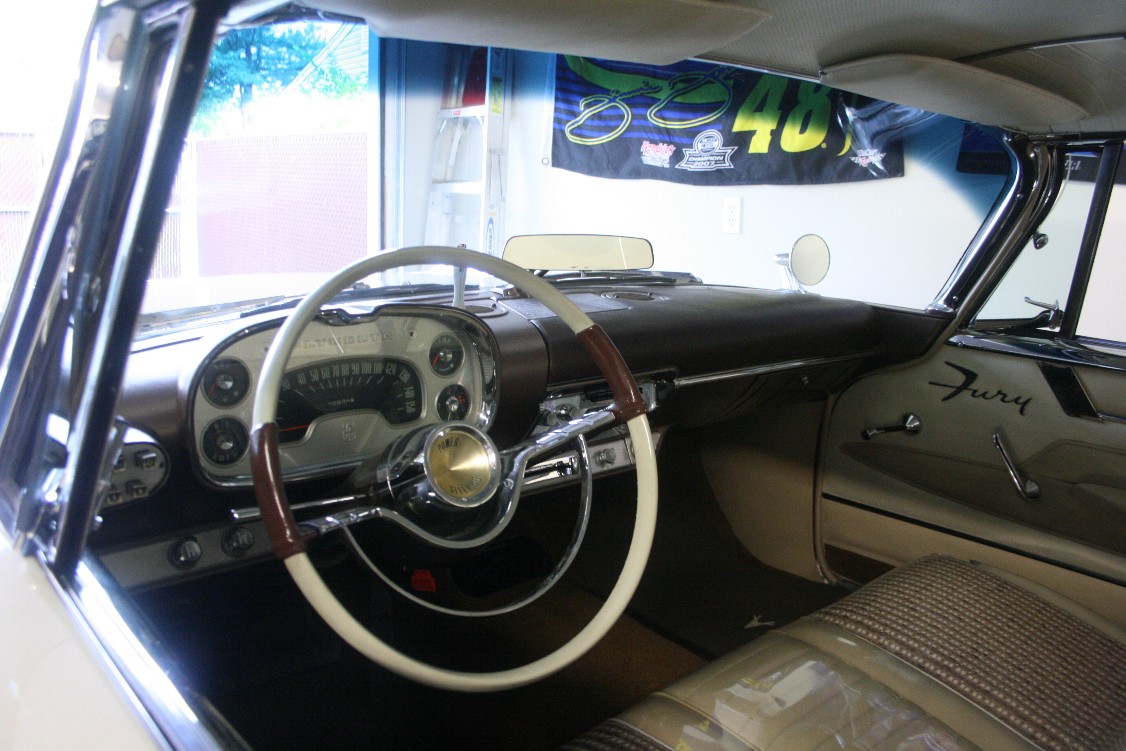

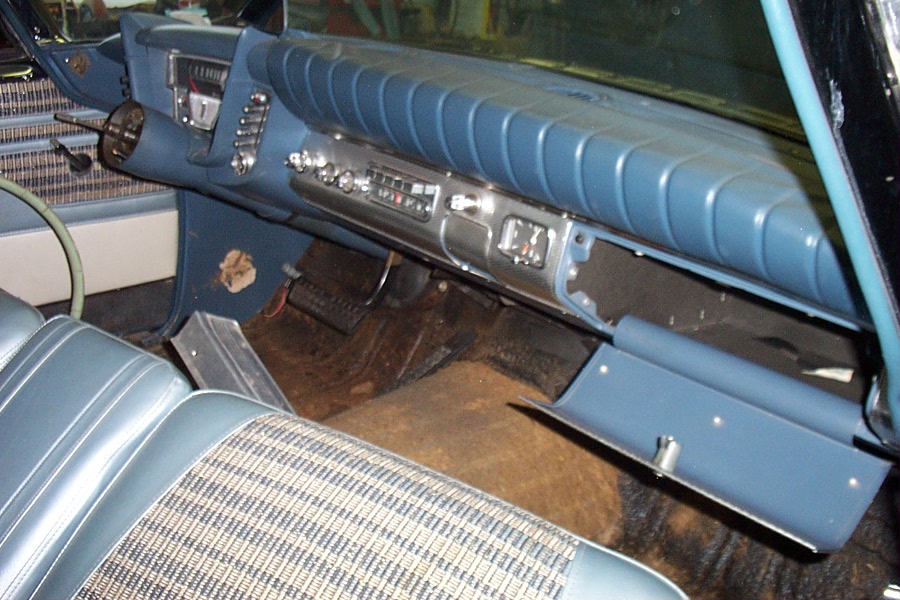

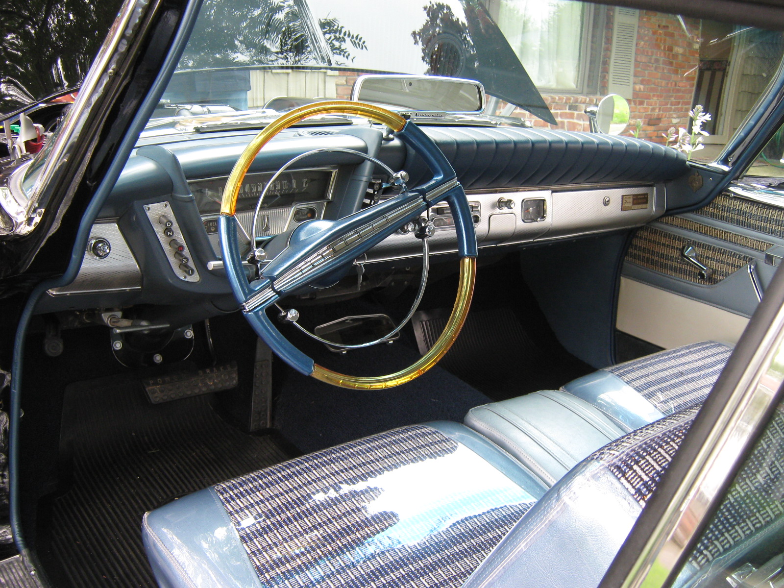

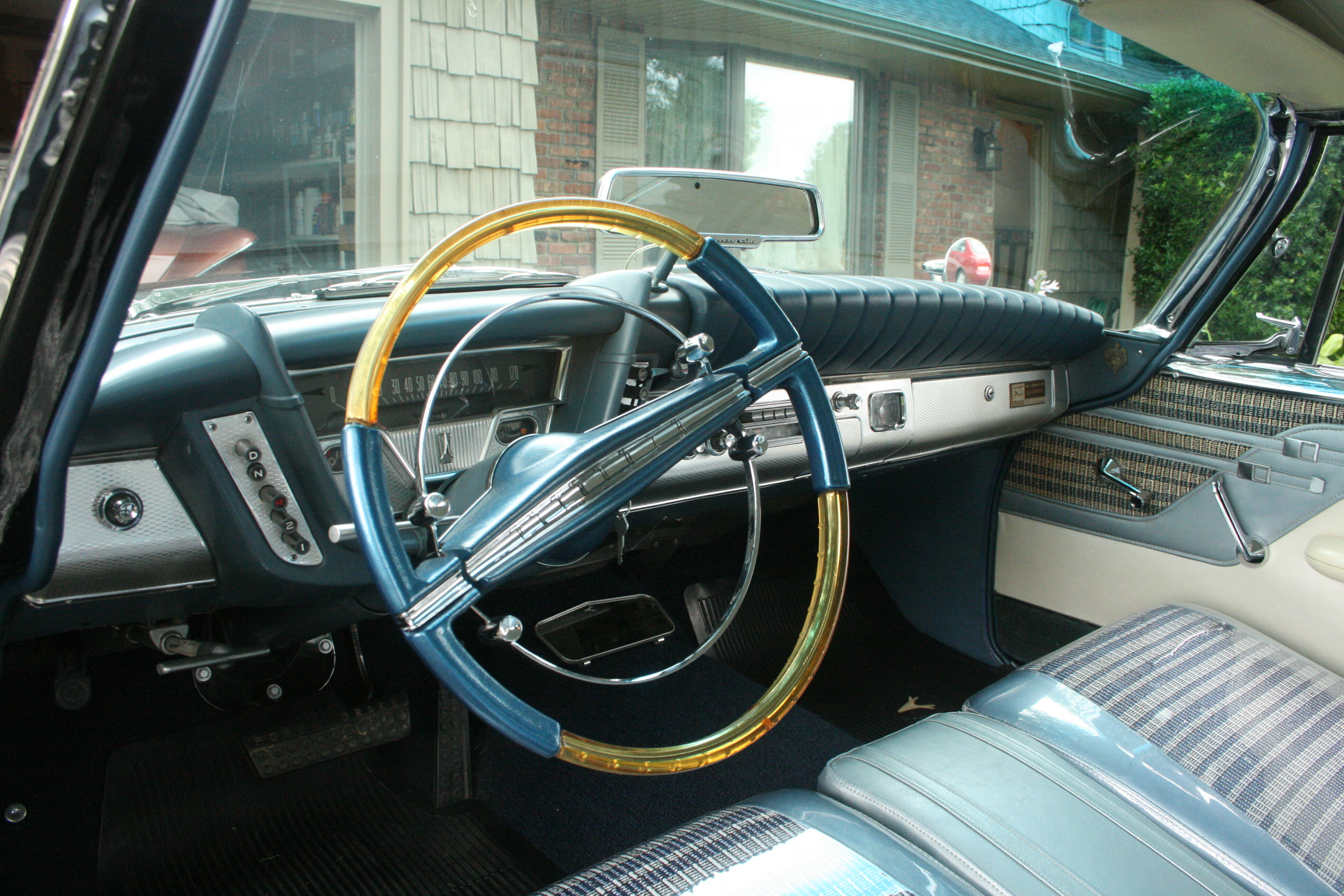

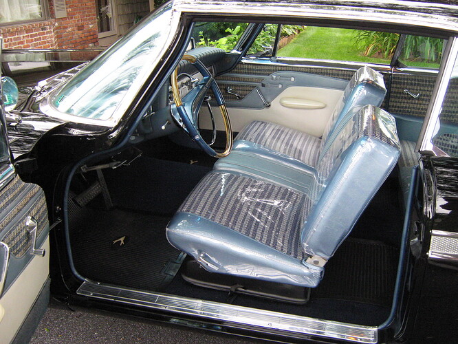

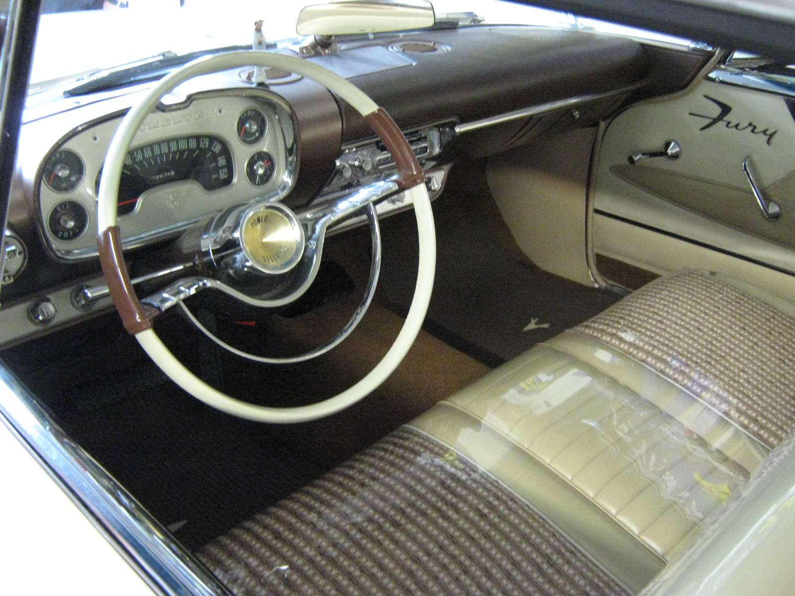

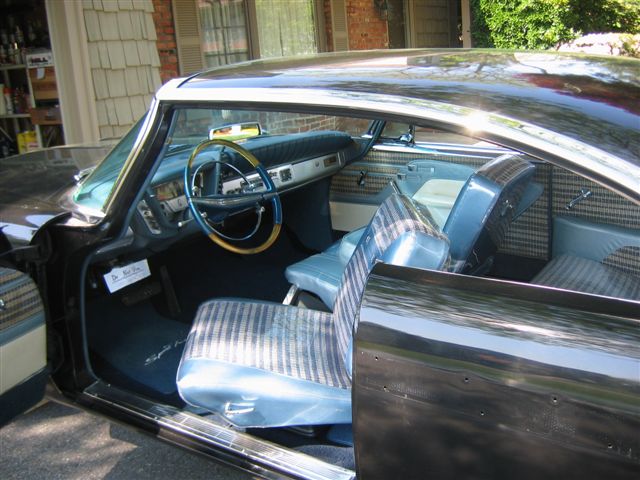

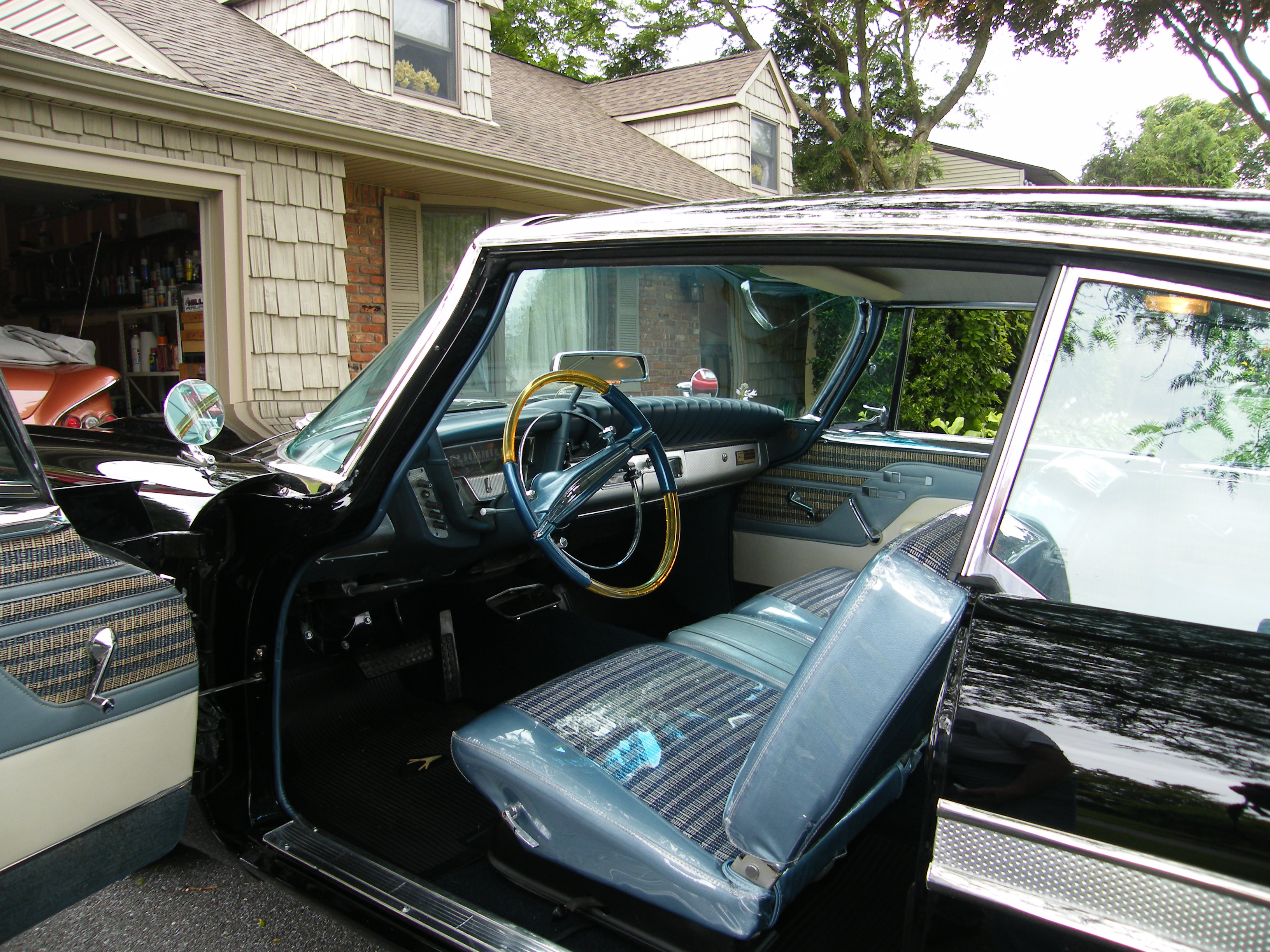

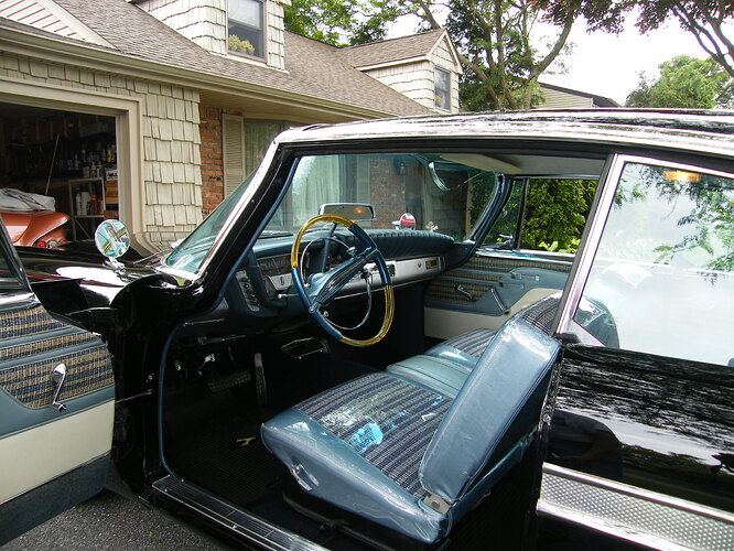

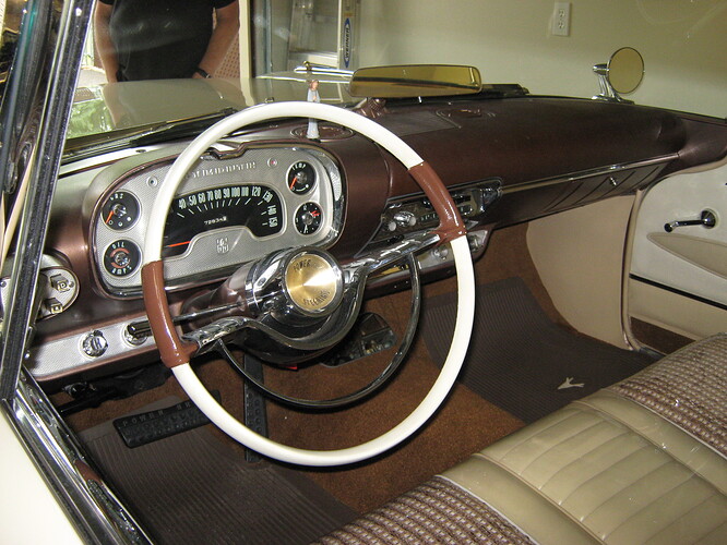

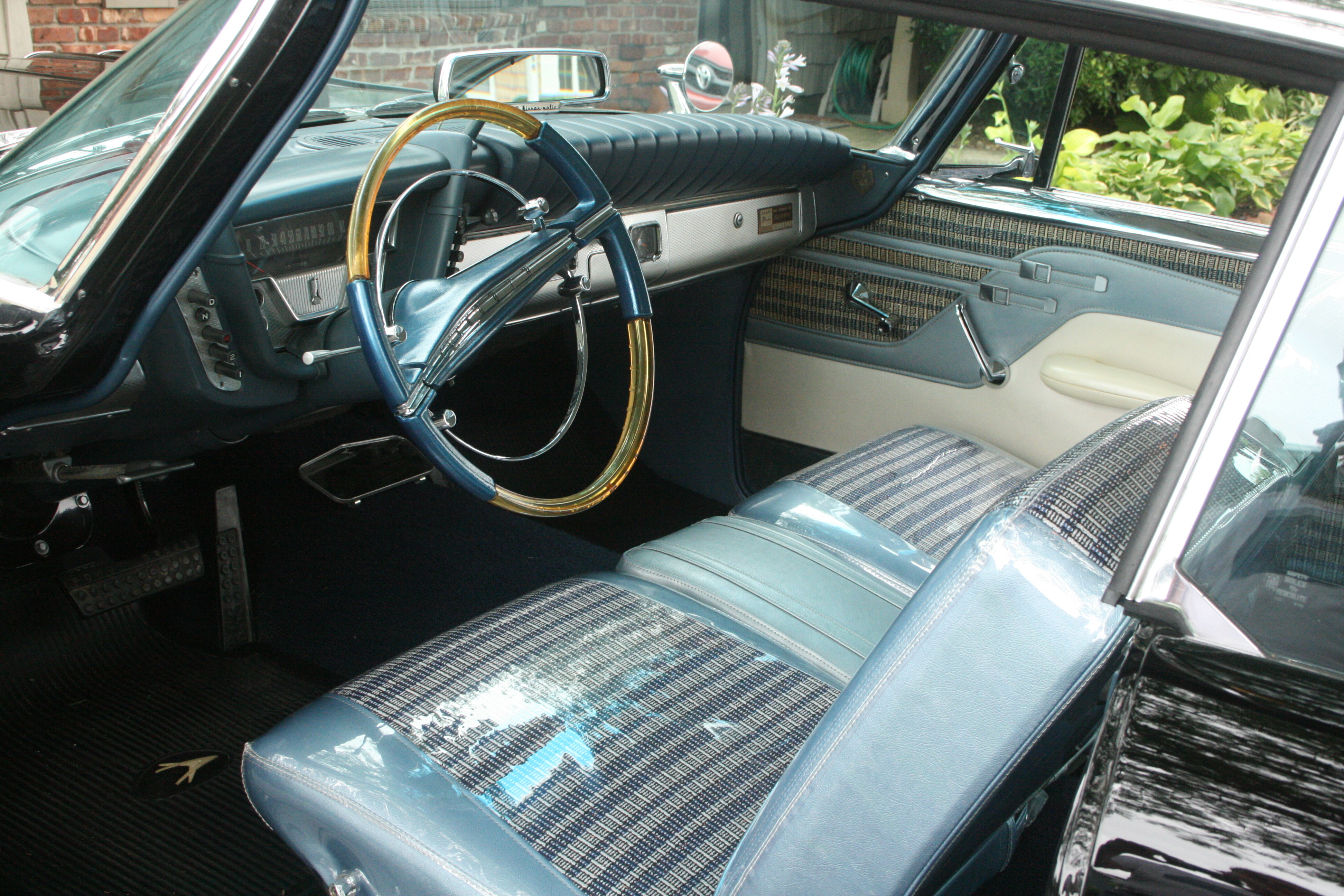

The interior’s DONE - as good as I could do!

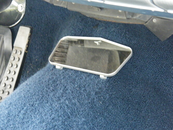

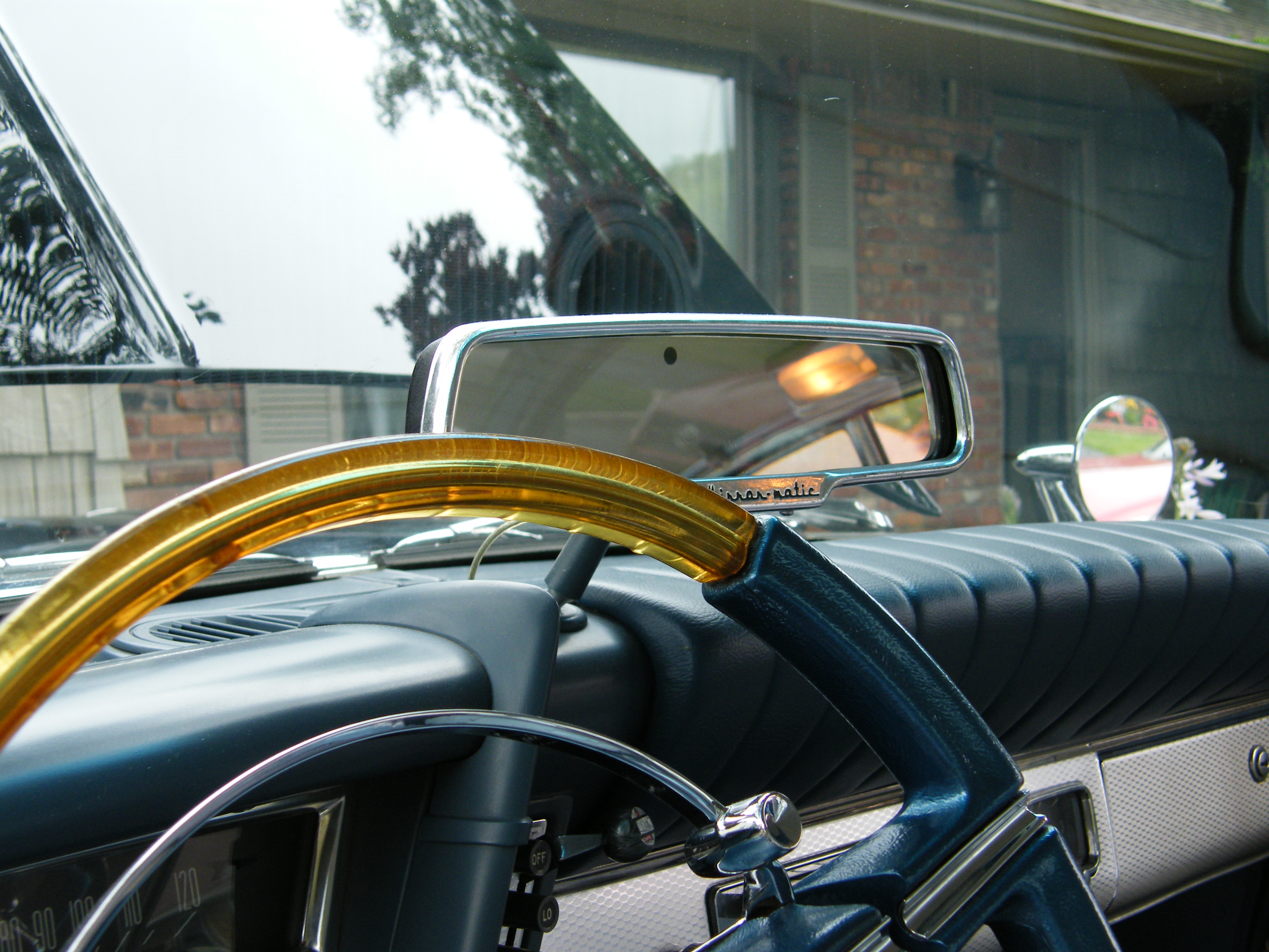

Center arm rest and back seat and door side panels a bit faded but ORIGINAL! Check out the MirrorMatic…

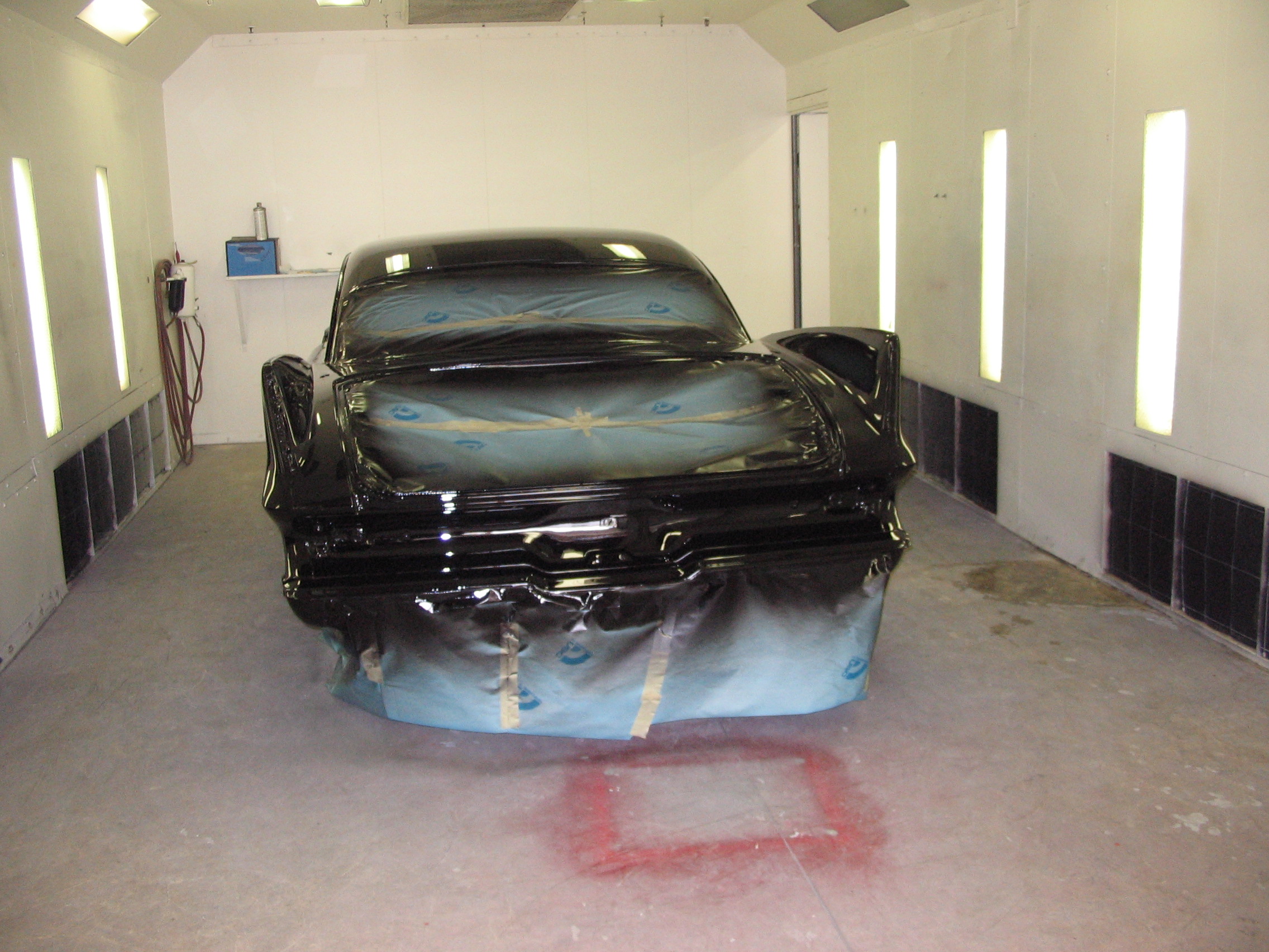

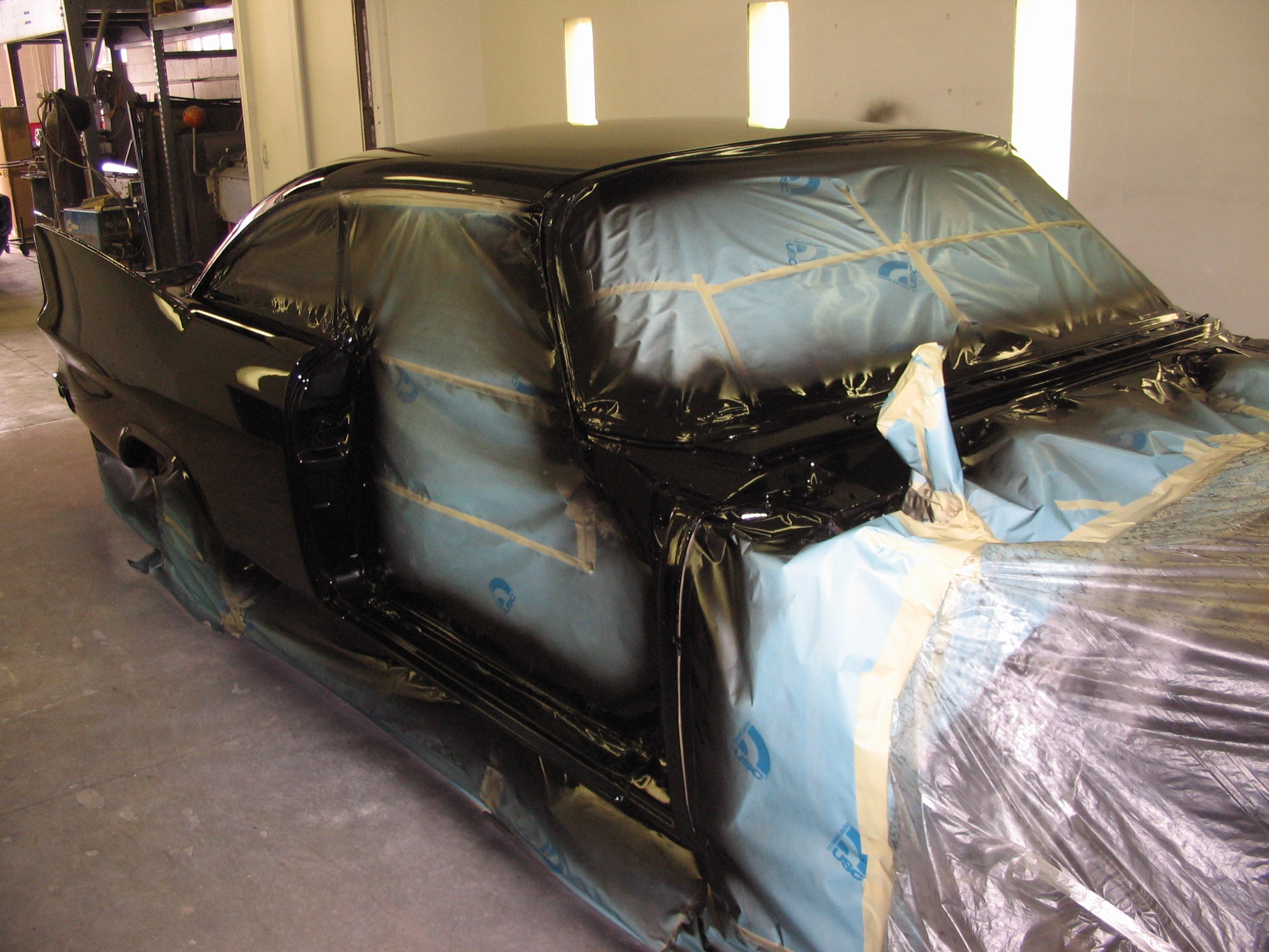

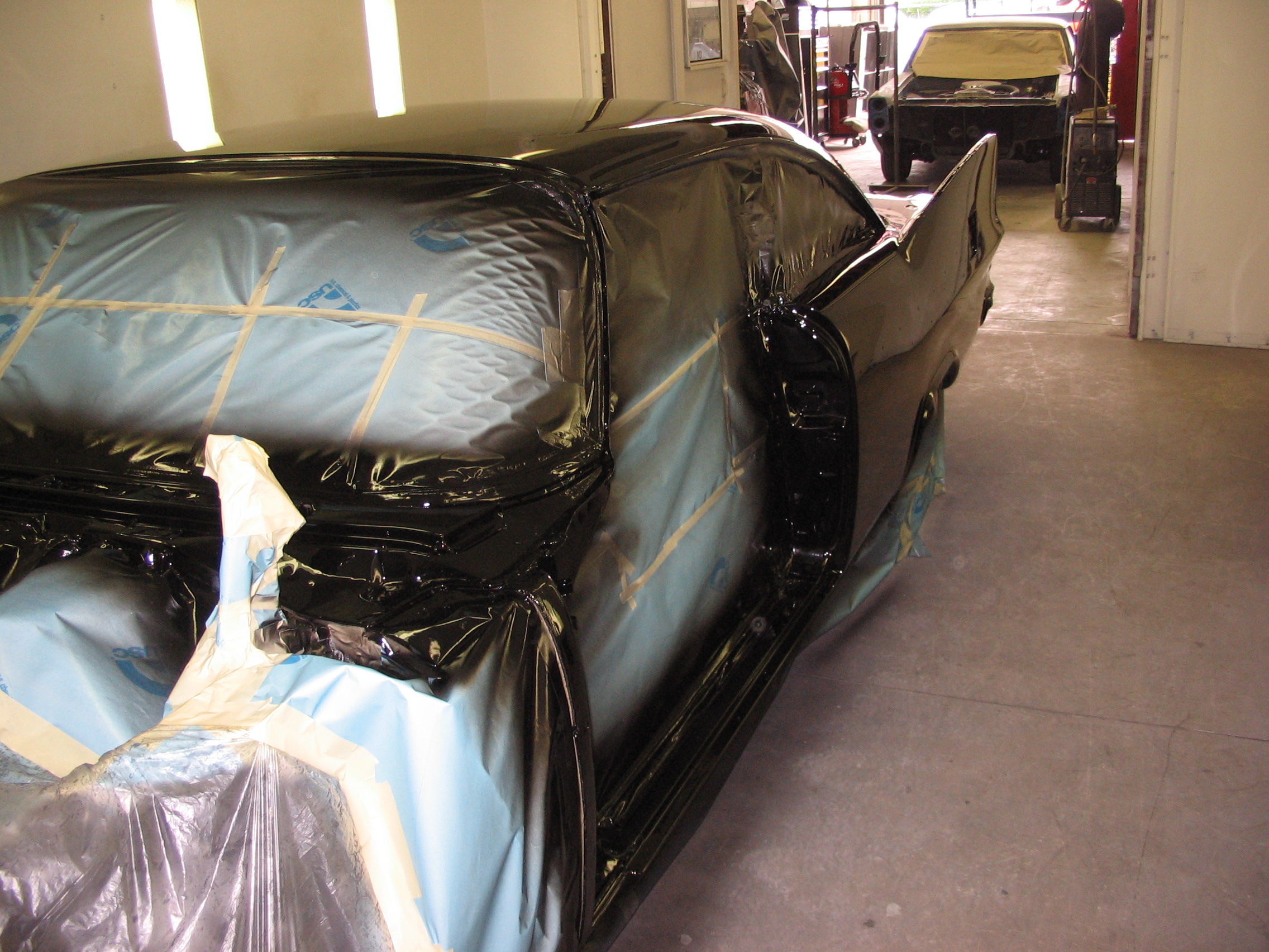

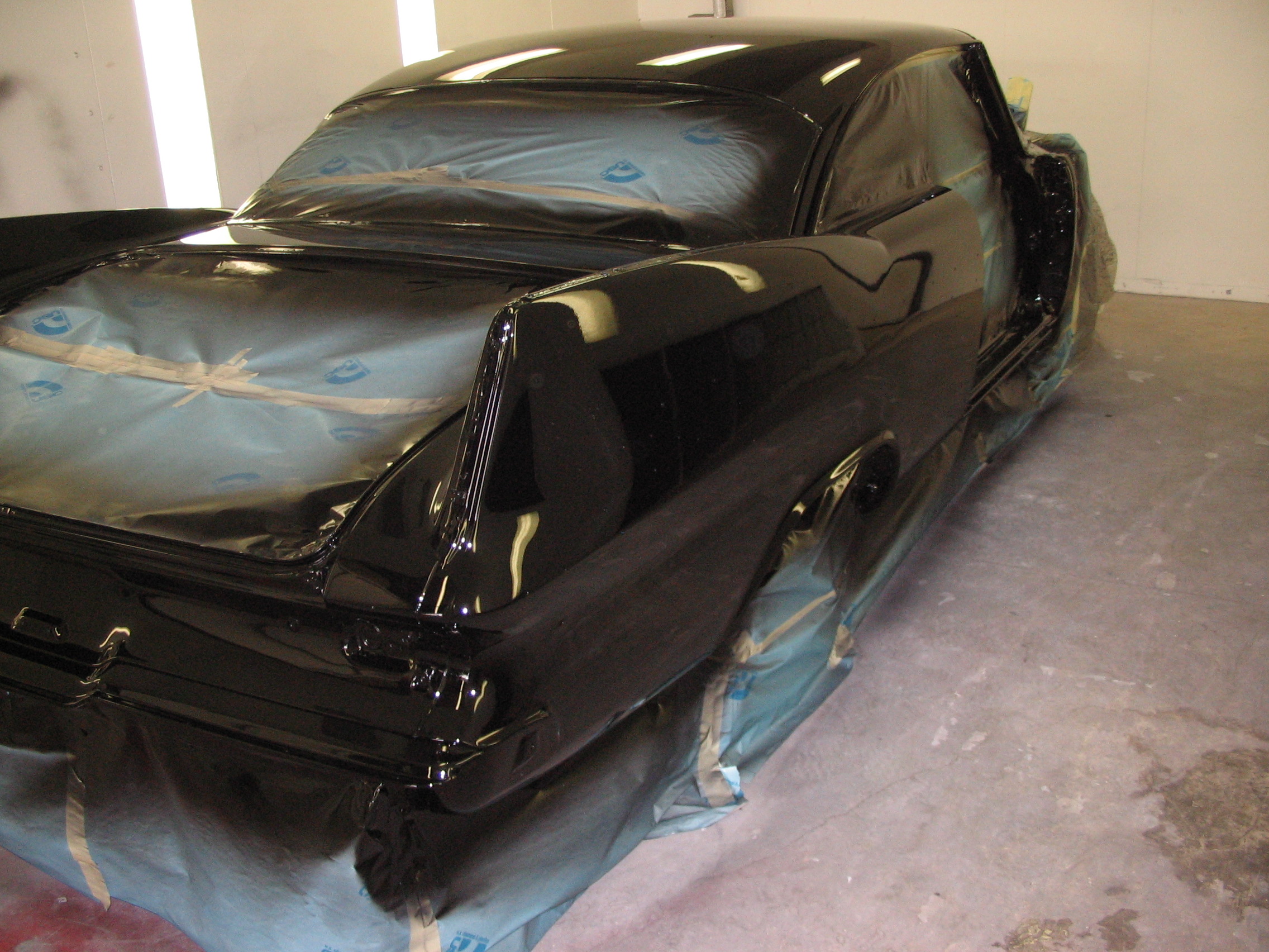

Ready for the paint shop. She is going ‘in’ within 2 weeks – Shop will do the exterior body, probably a repaint – partially or fully – do not know till they see her. The schedule for return is 1 to 5 months…

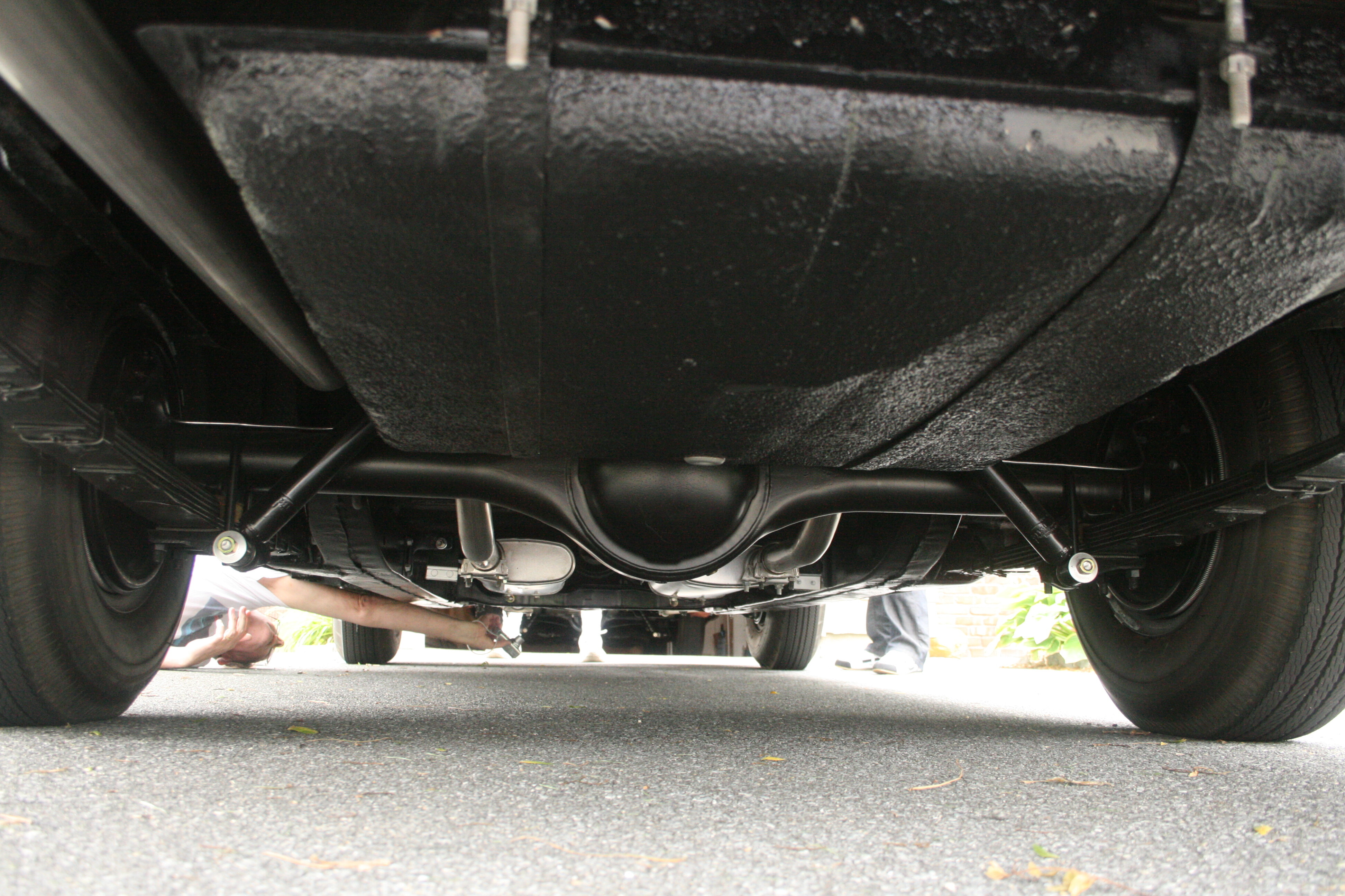

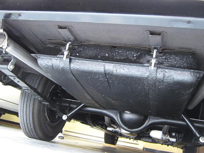

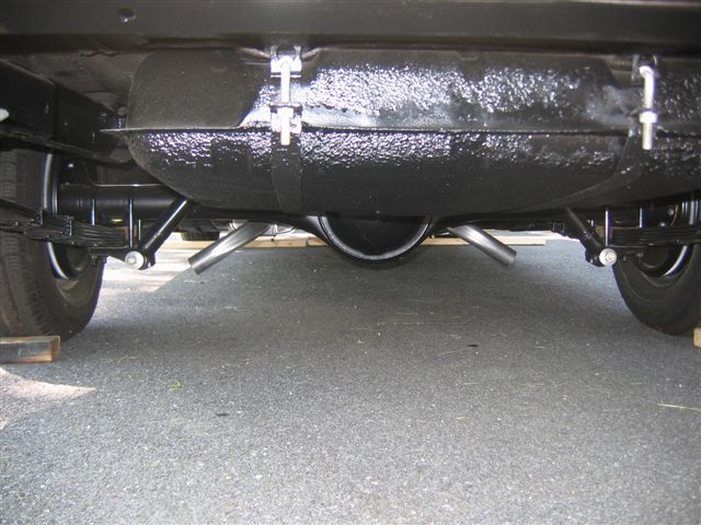

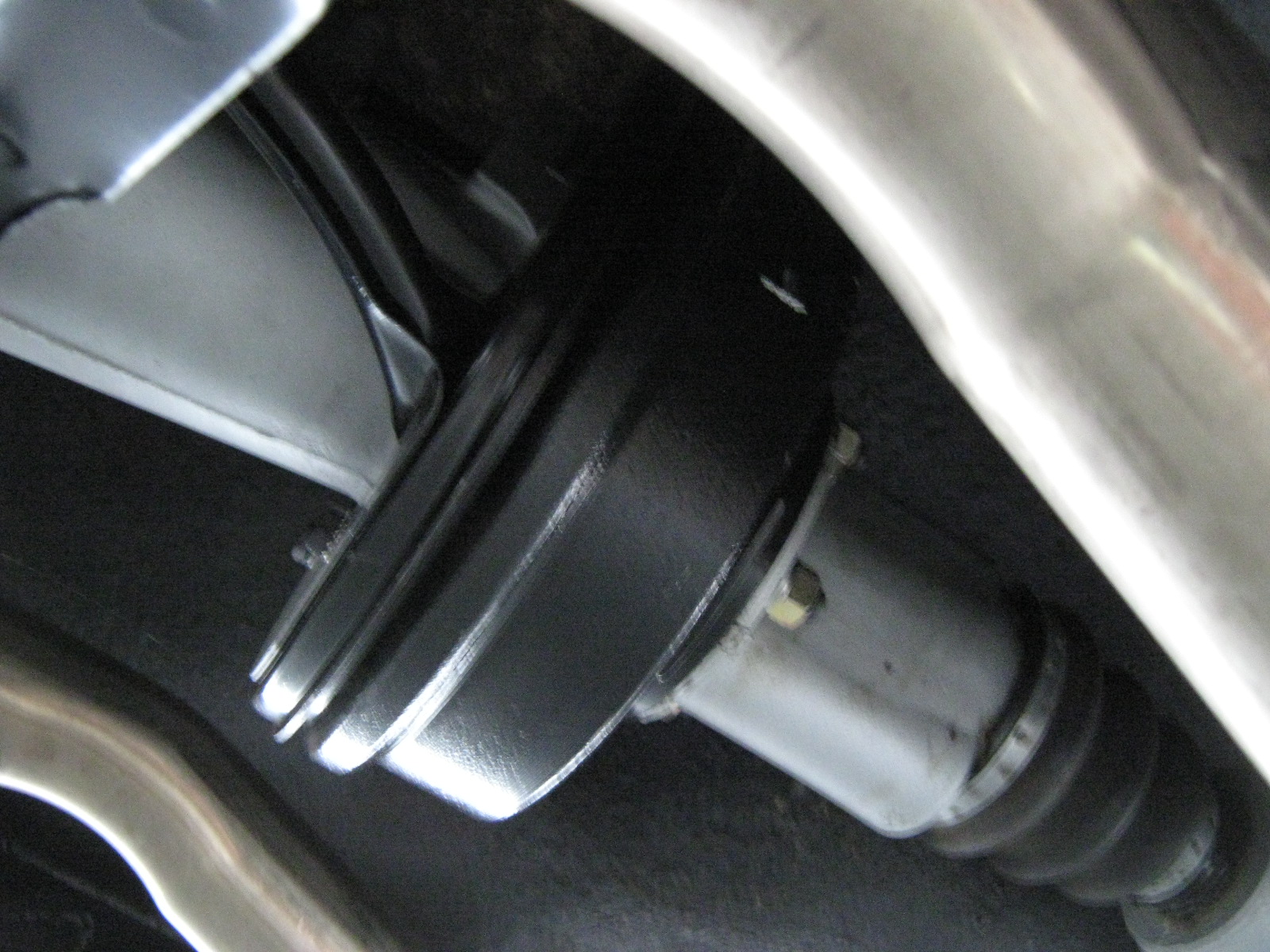

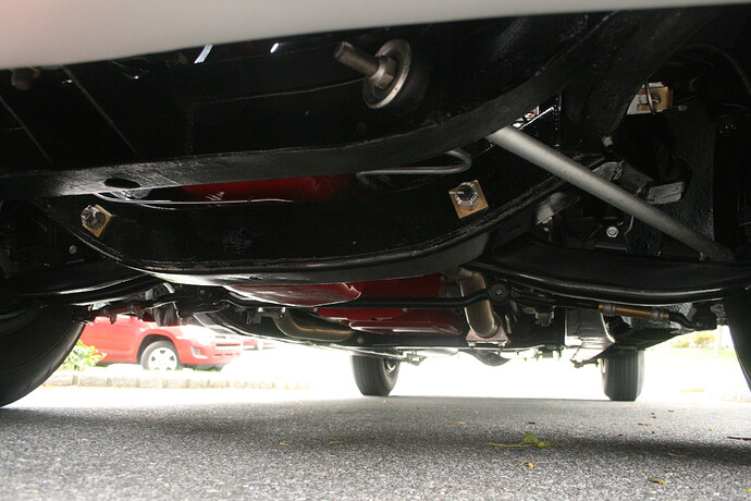

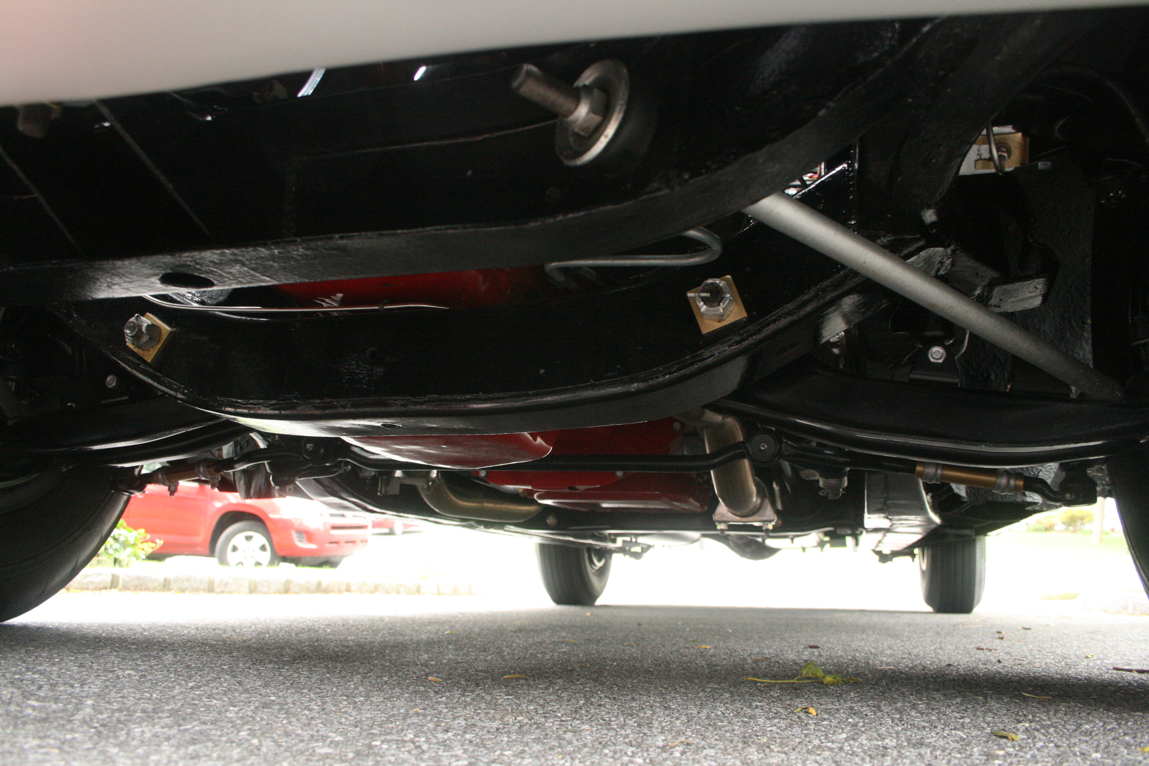

THE REAR END! My restoration–as good as I could do! SURE GRIP, 6 LEAF H/D suspension springs, 12" BRAKES, RESTORED TANK

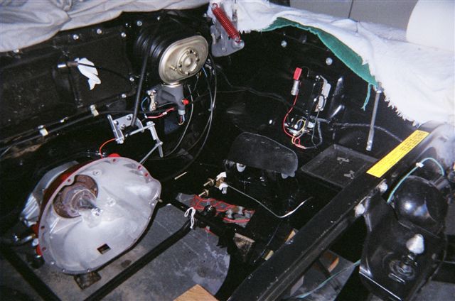

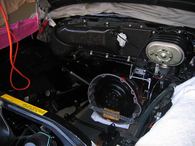

Some pics BEFORE engine and trans transplant!

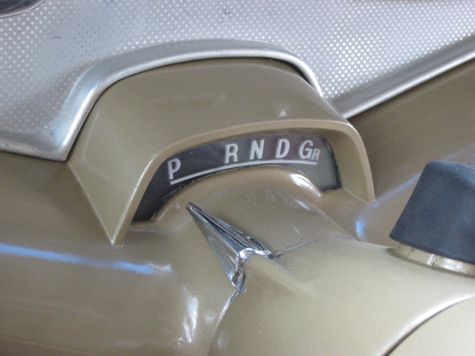

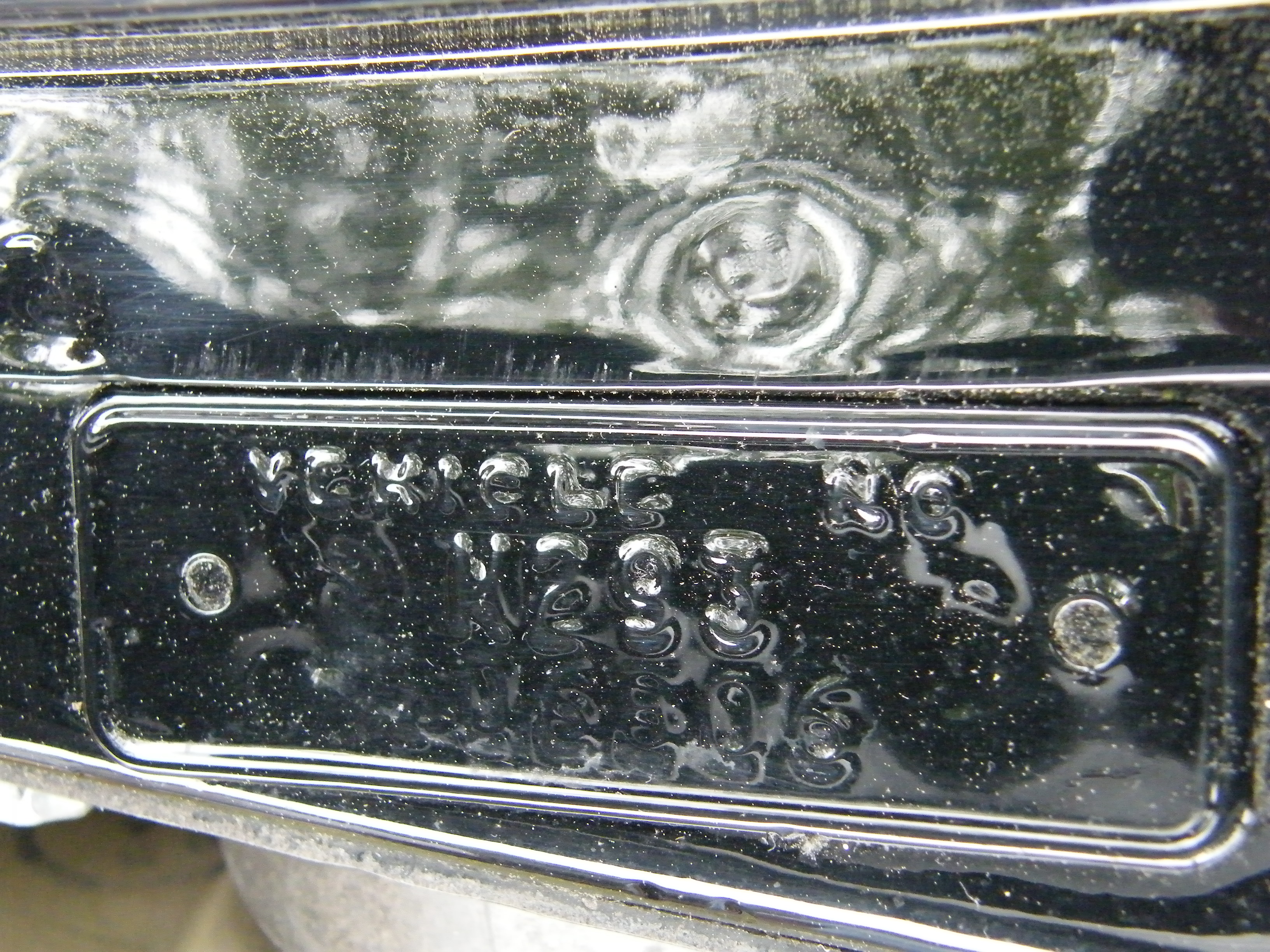

This one is just some silly detail on the trans. You cannot see it but the P/N of the trans is hi-lited in black

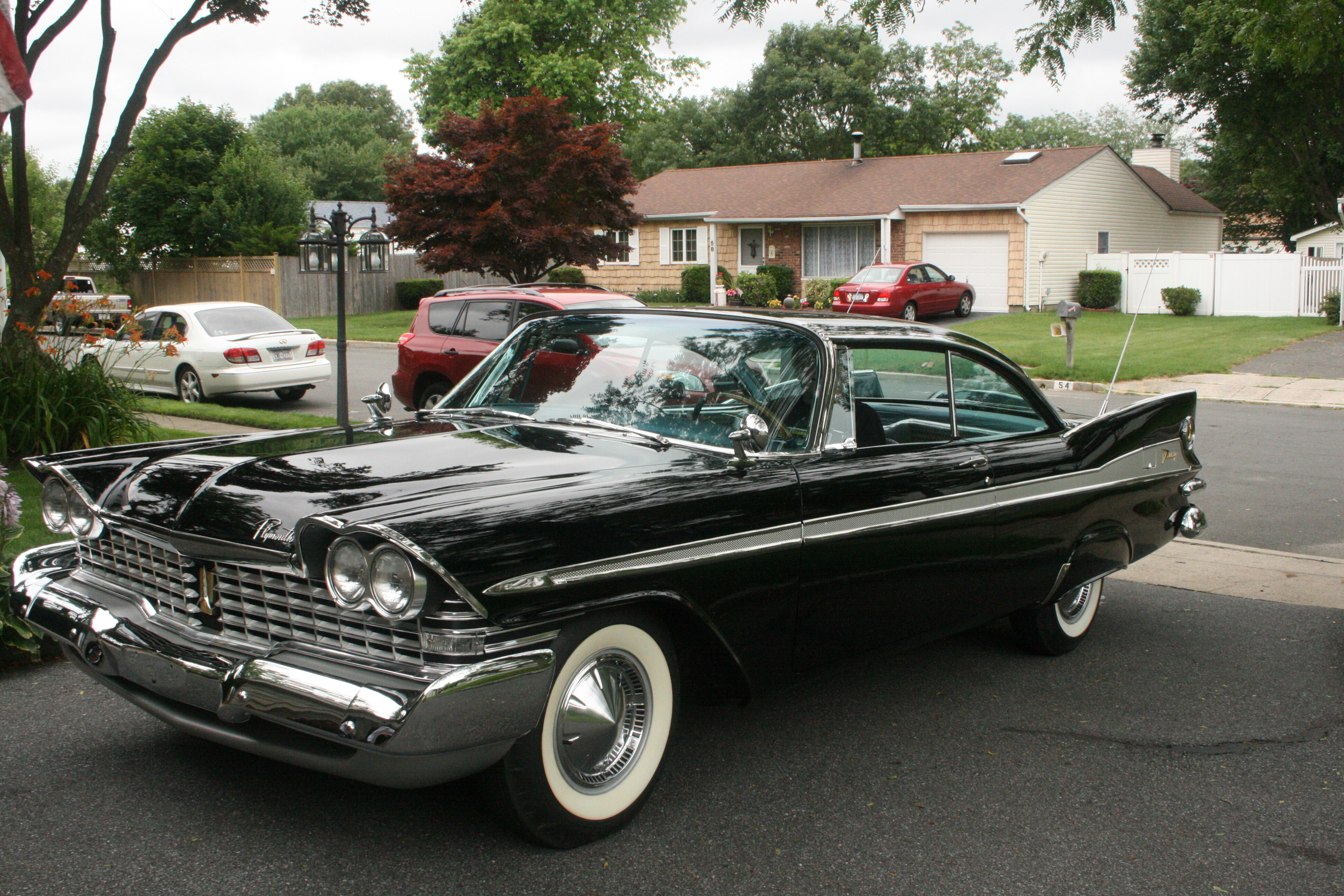

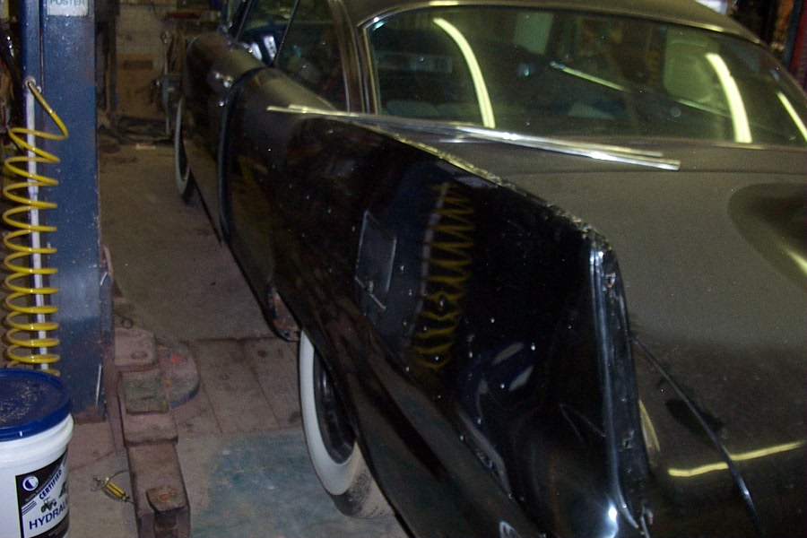

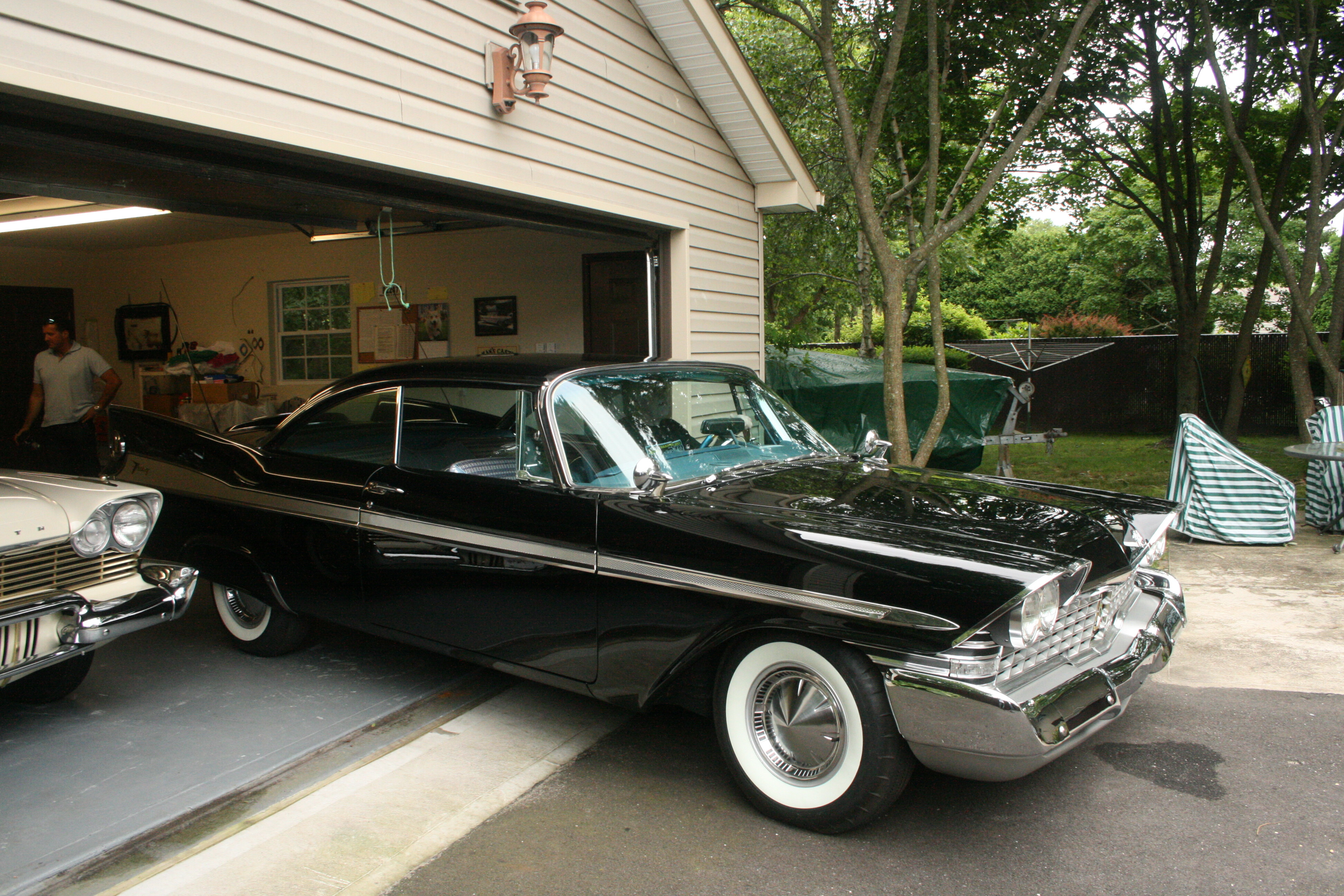

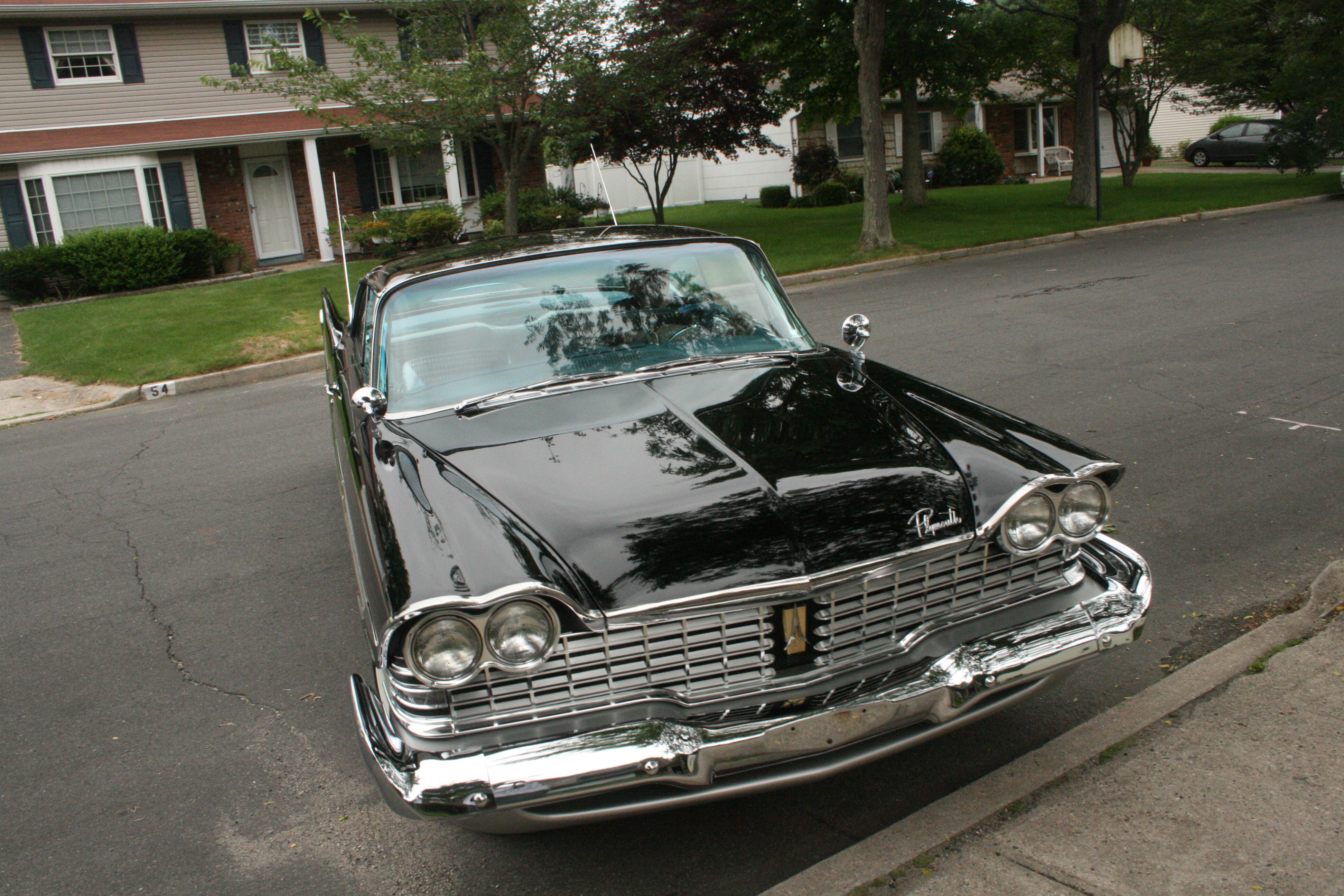

Blackie gets the "star" treatment at Nostalgia Motors in Boonton, NJ
Getting ready to come home

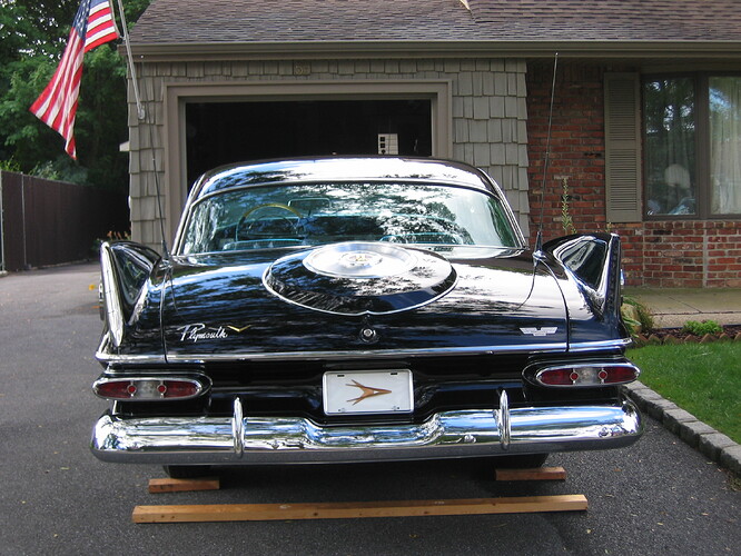

Home again!

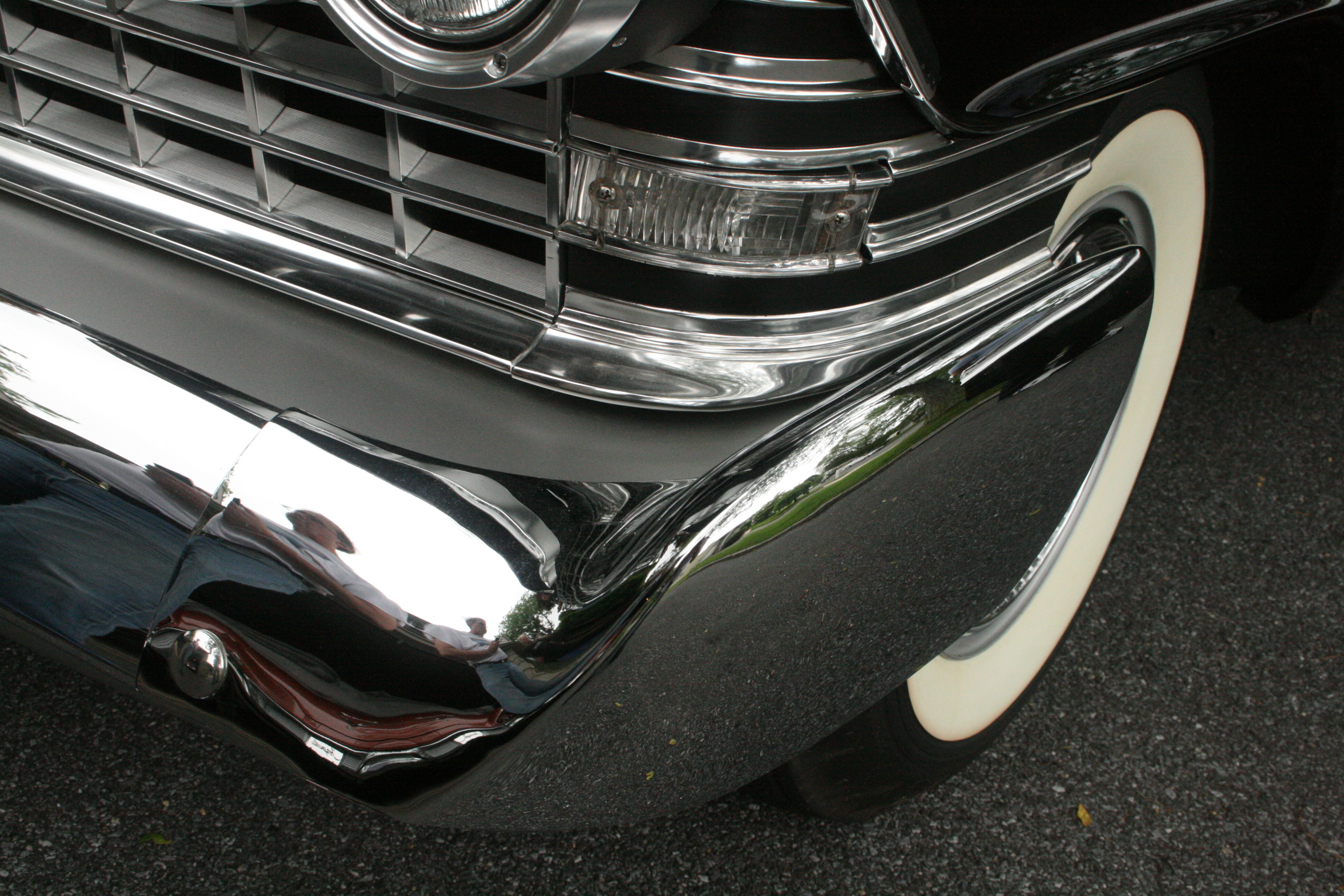

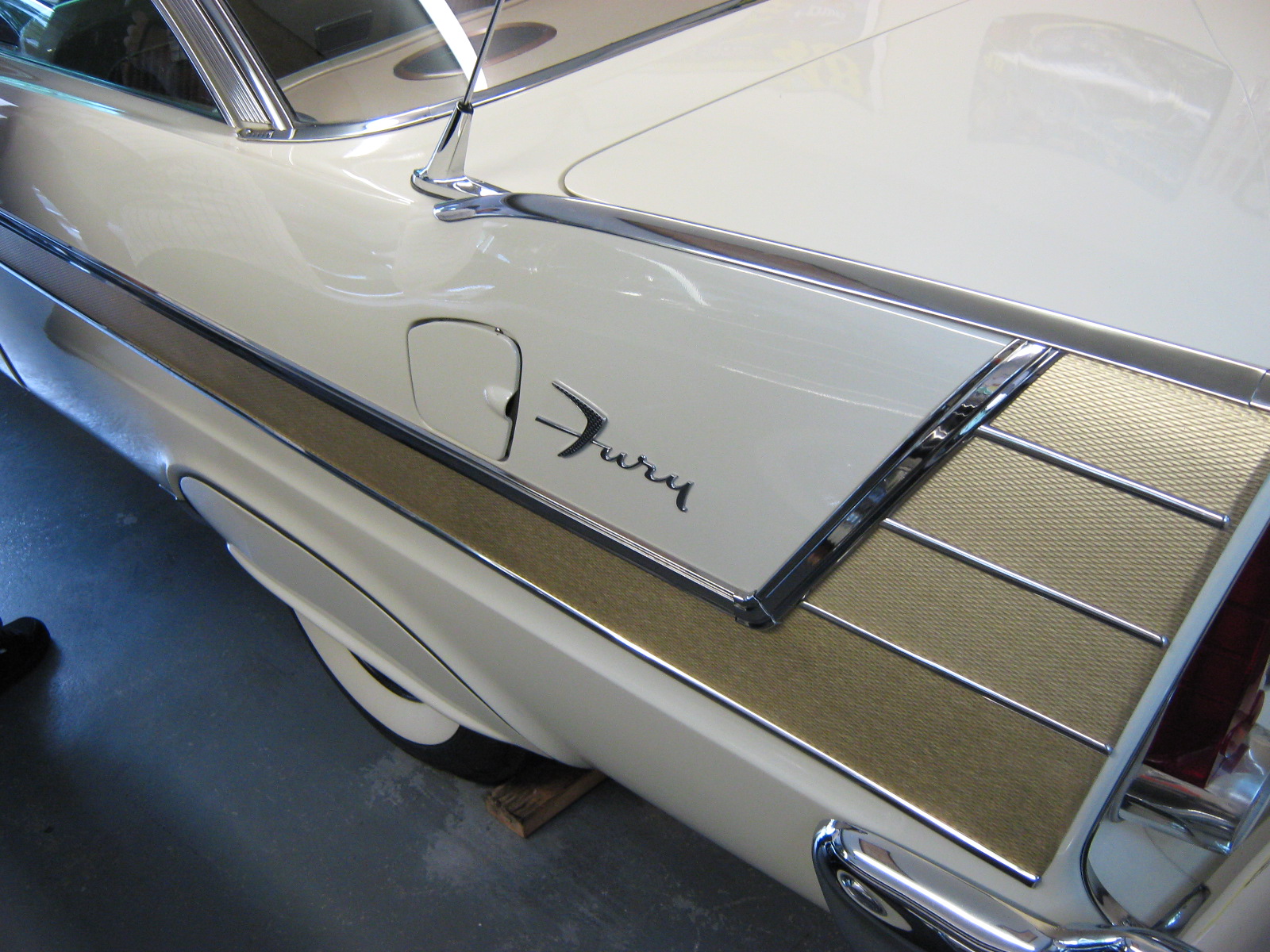

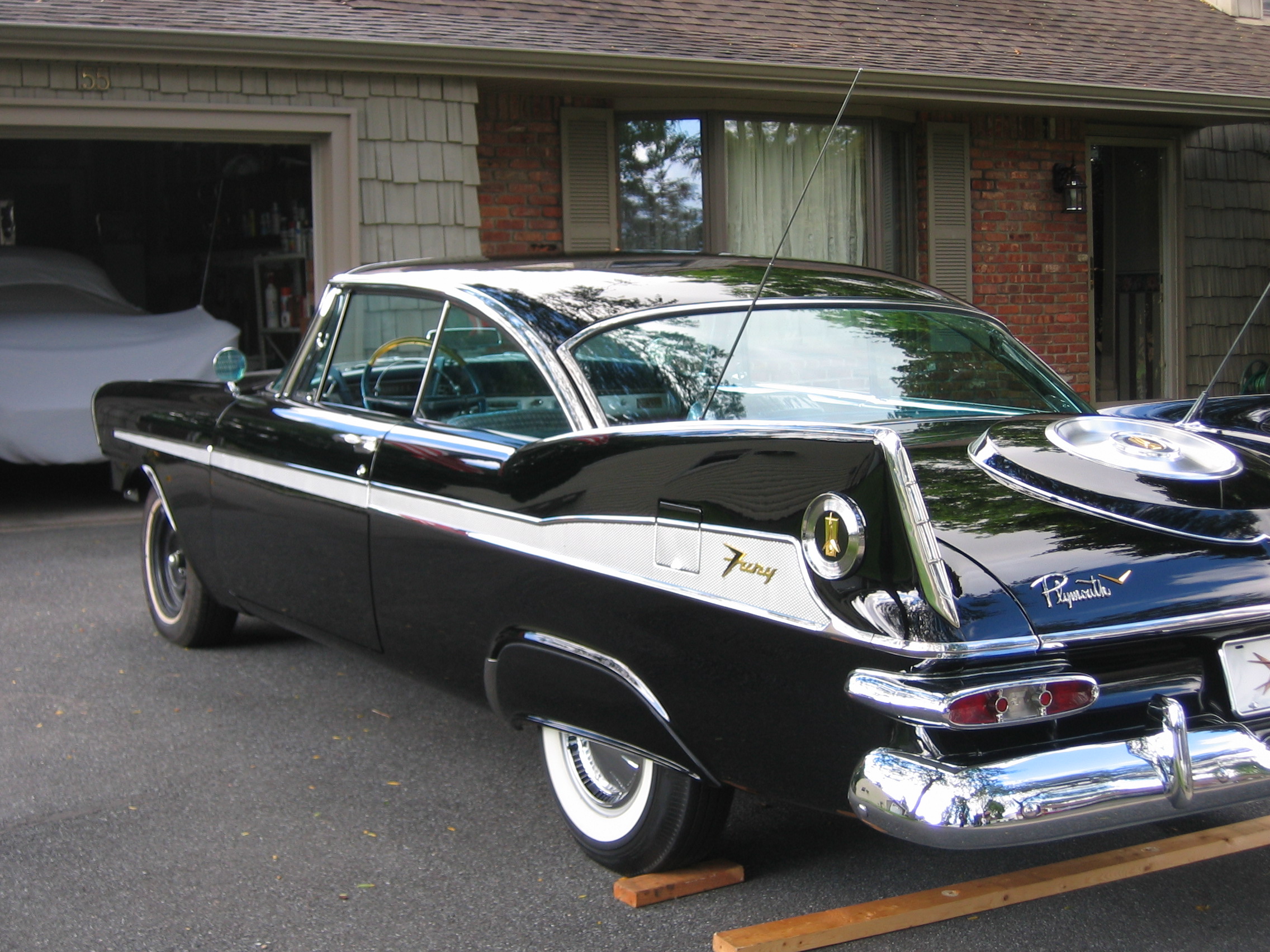

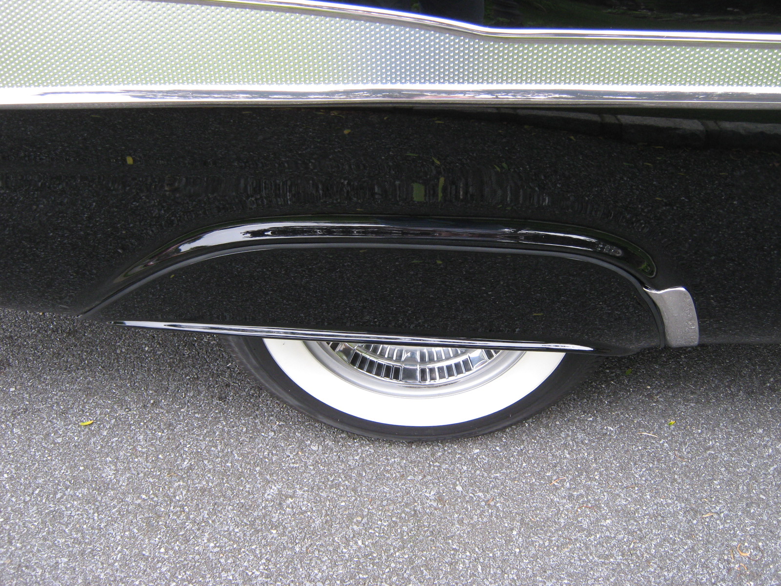

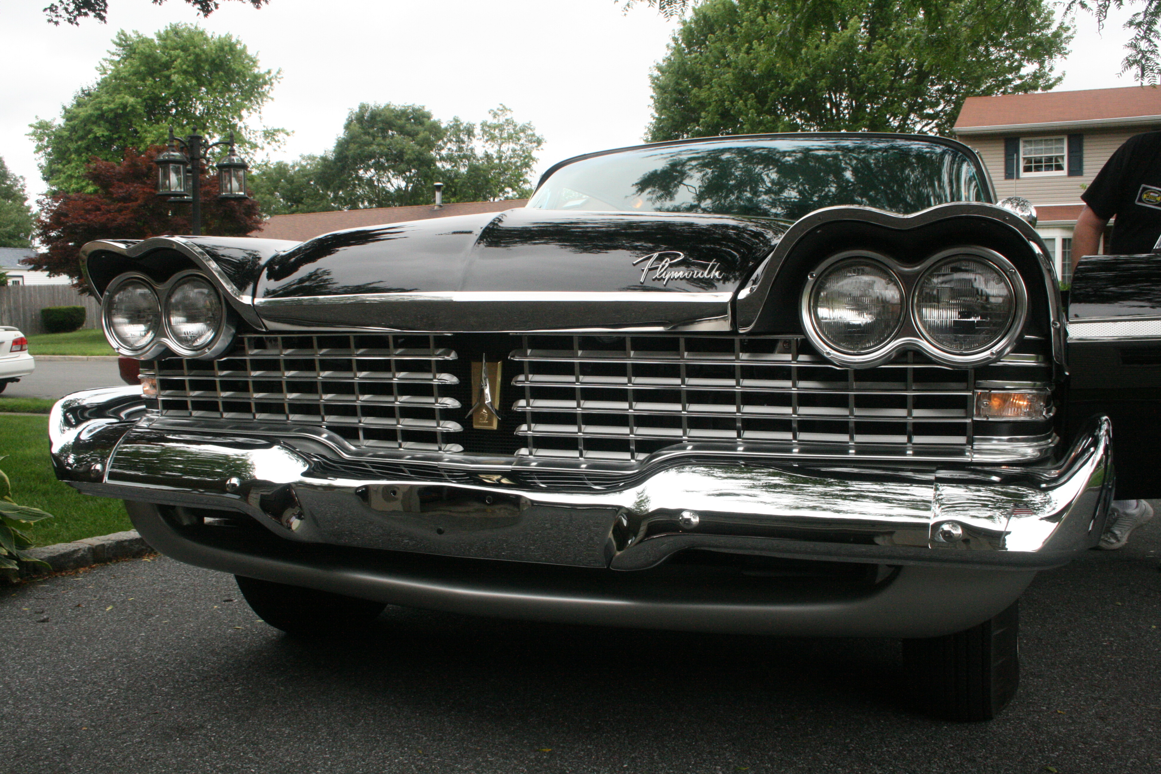

NOSTALGIA did the aerials and skirts and alum side trim with stainless – I did all the rest of the externals.

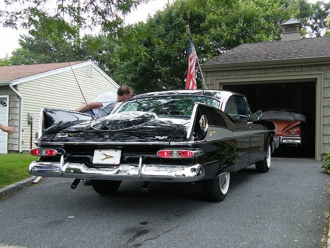

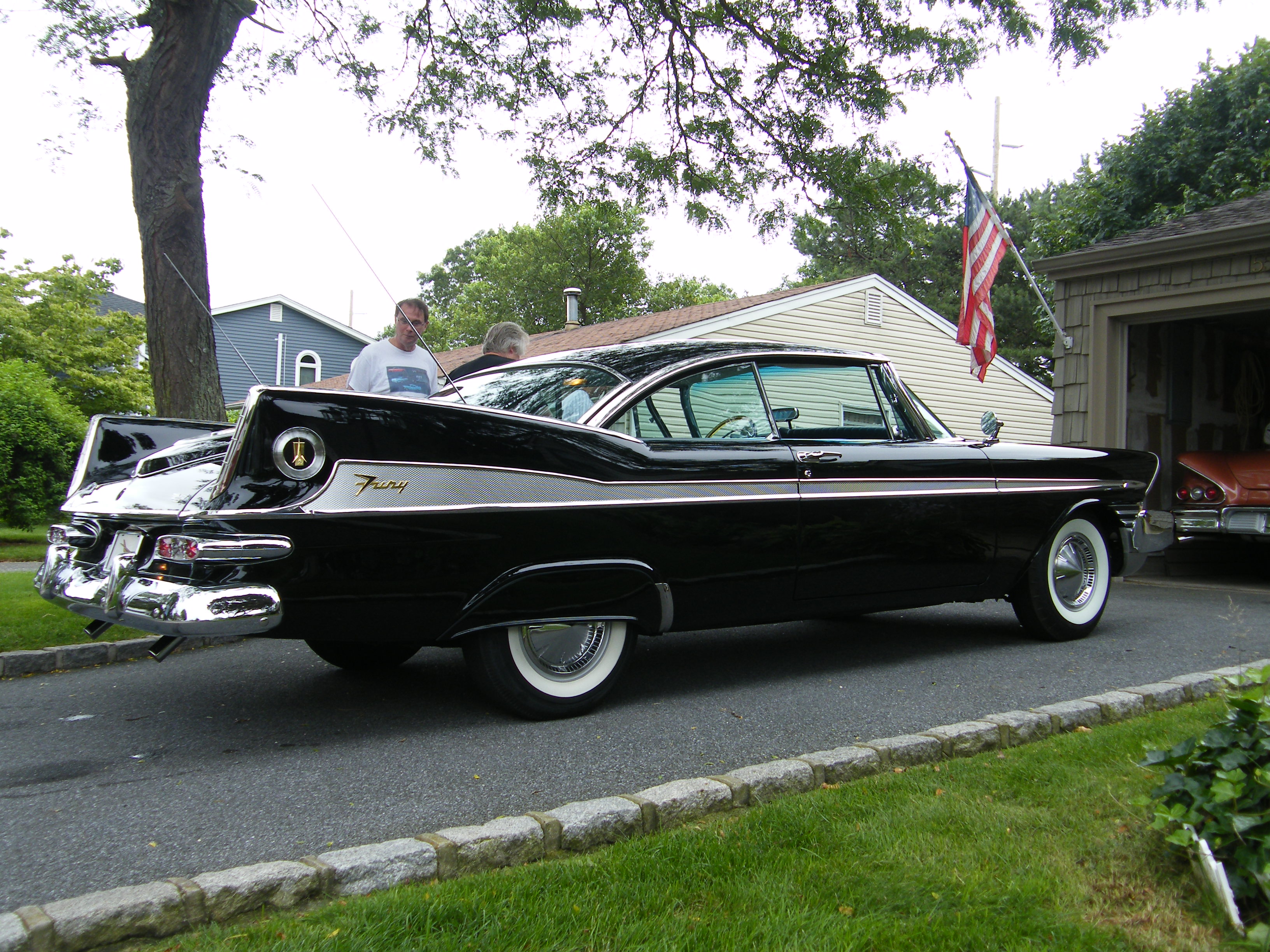

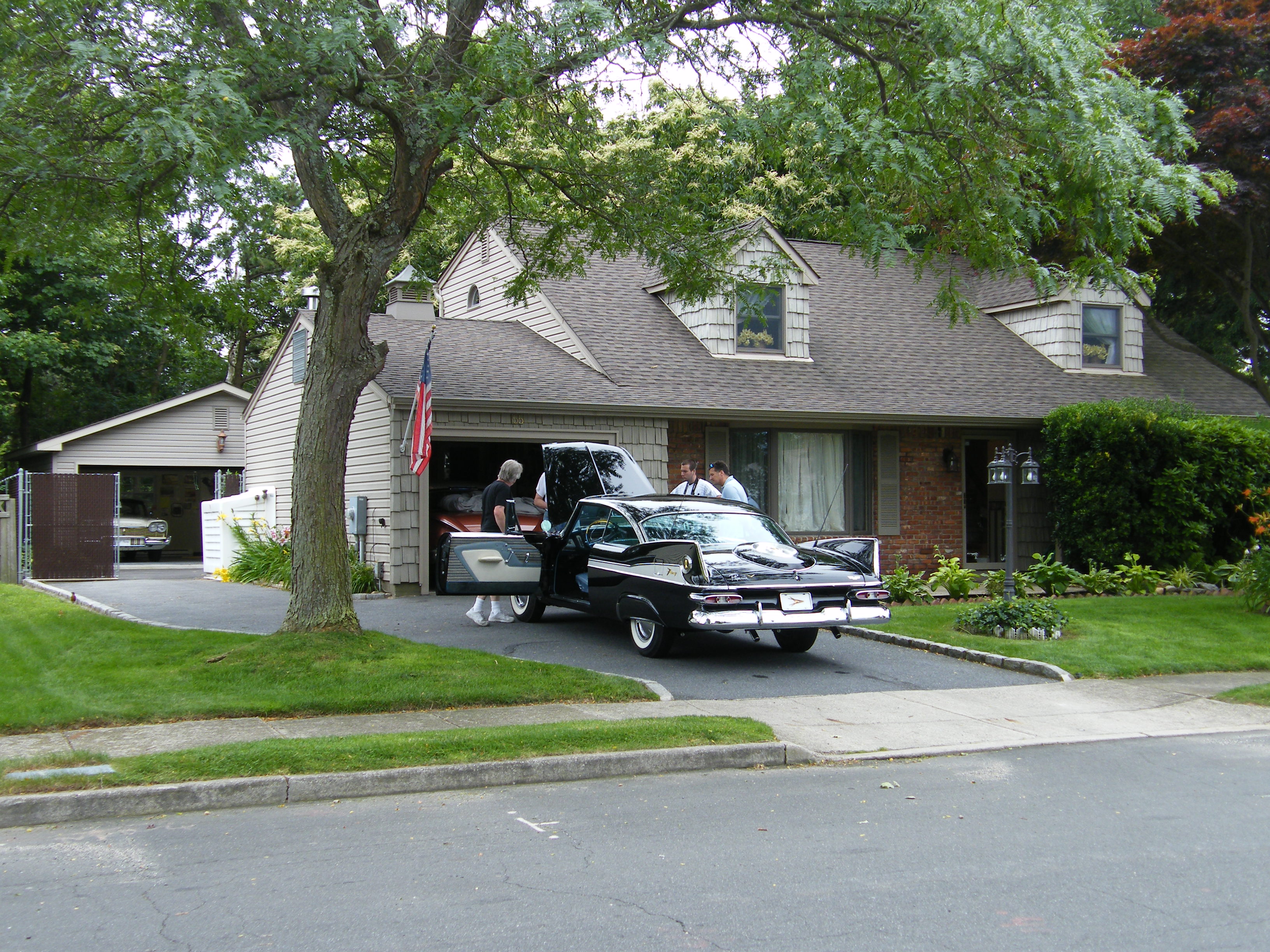

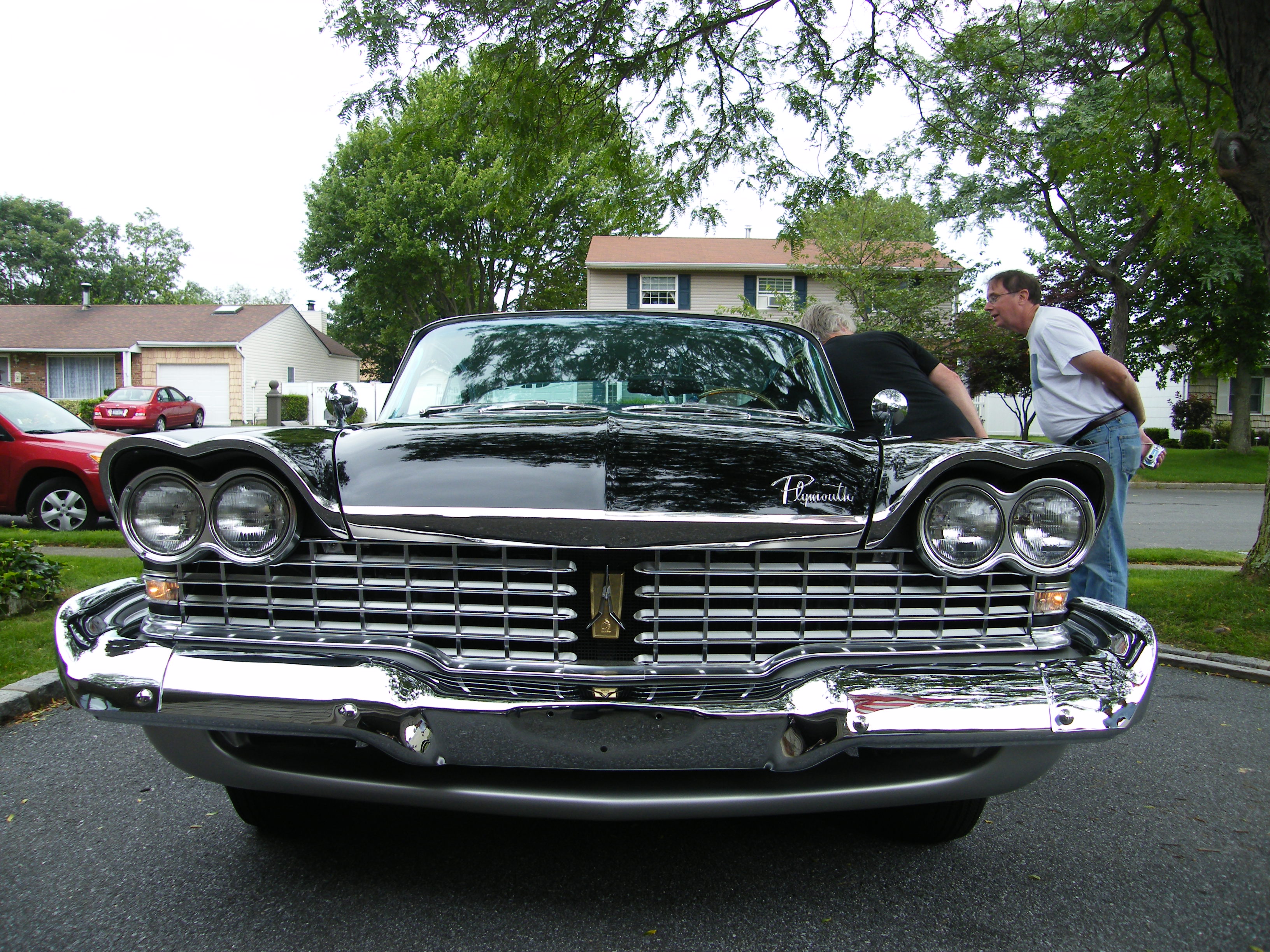

On July 9th, 2009, Ron and Matthew Keij, Andre Hakker and Dan Morton paid Ed a visit at his home in Long Island. The pictures that follow are from that visit with Ed and his exceptional car collection.

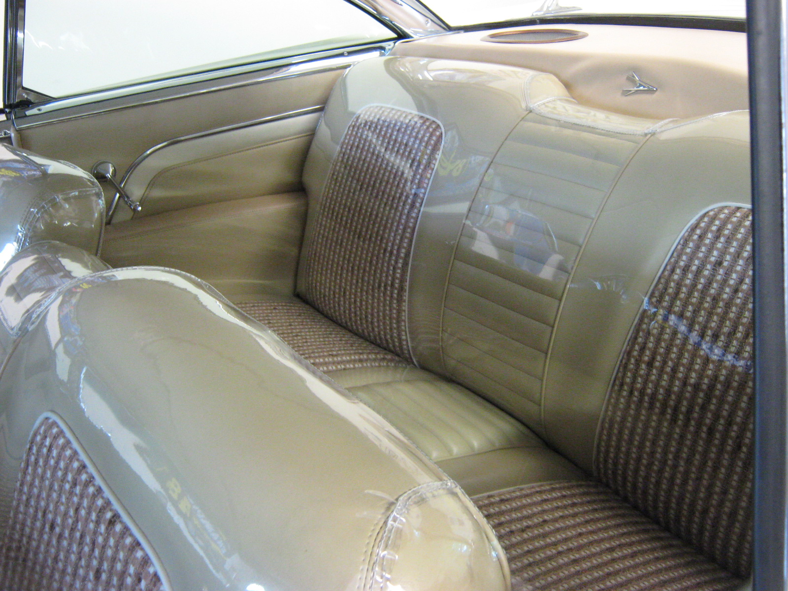

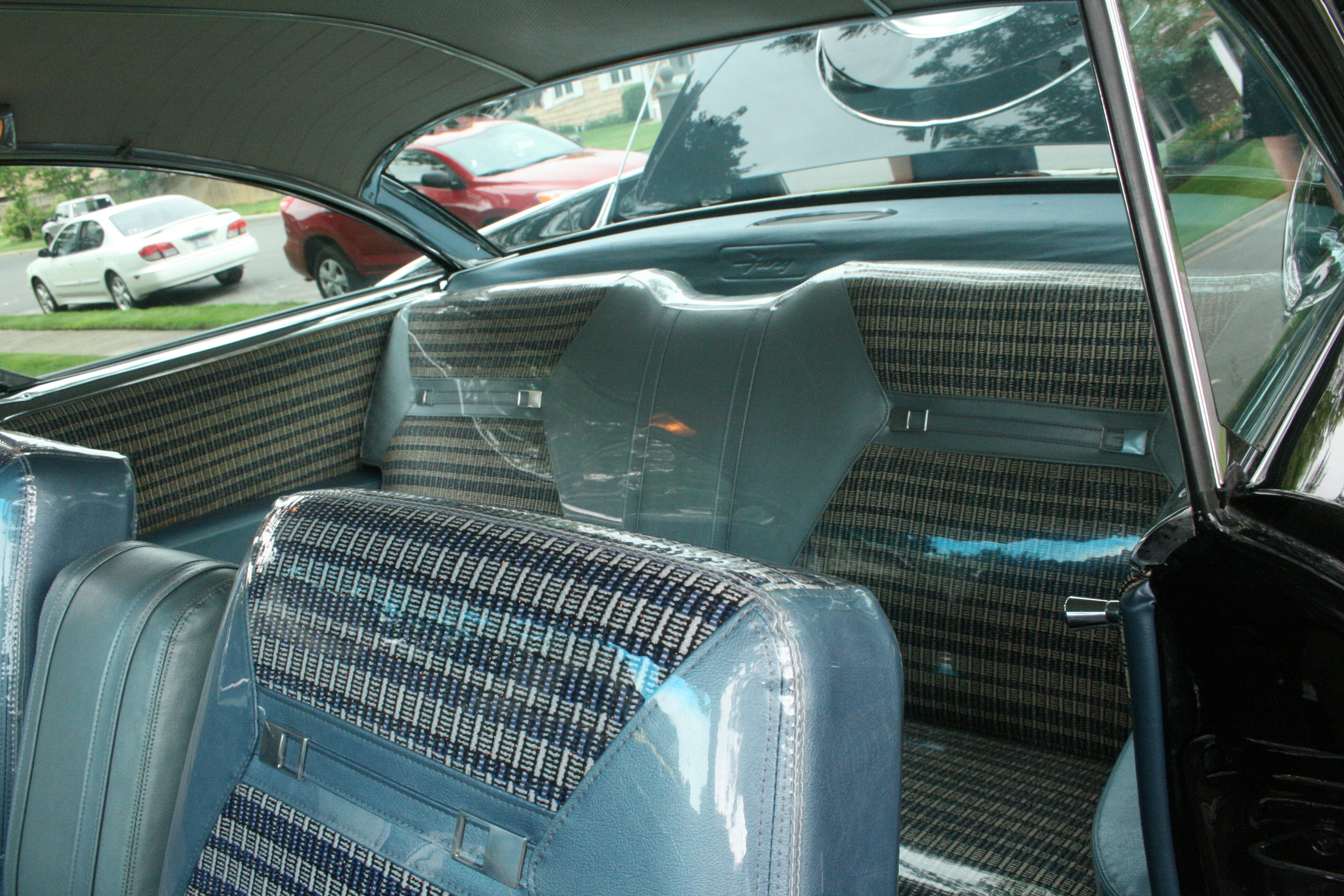

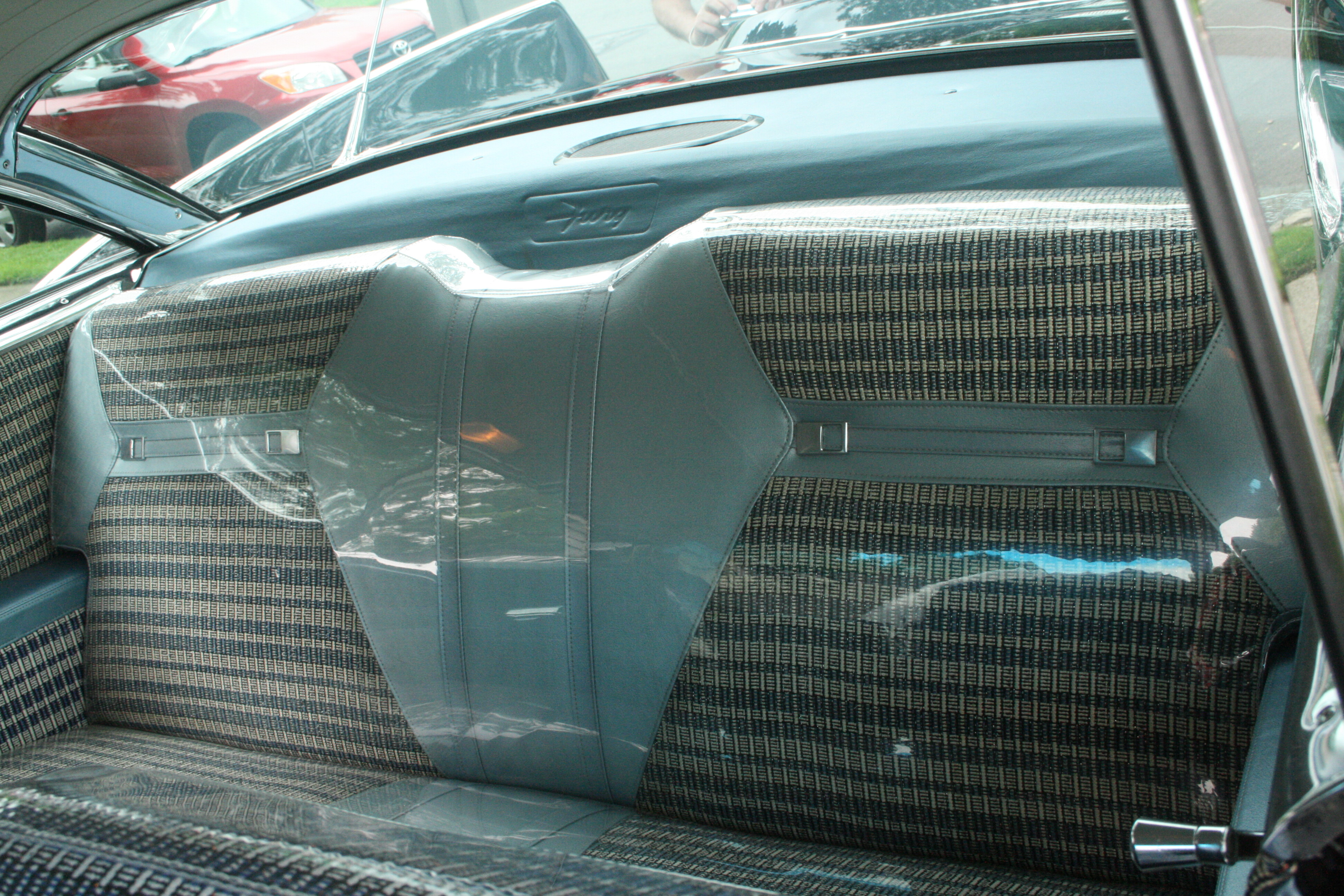

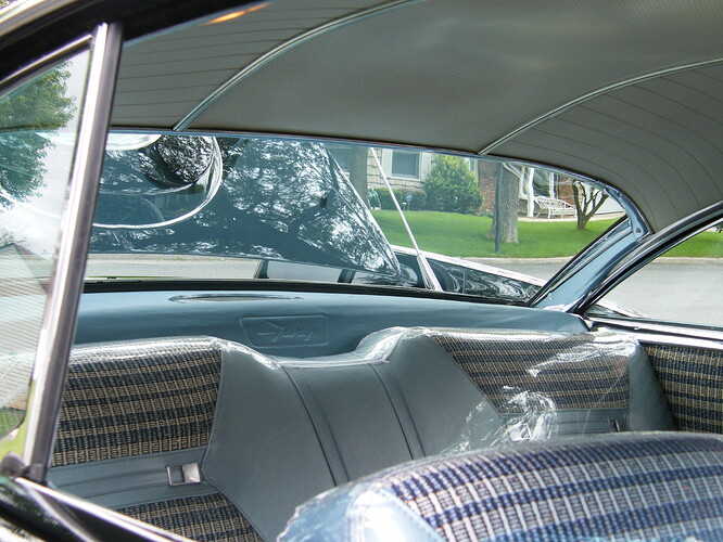

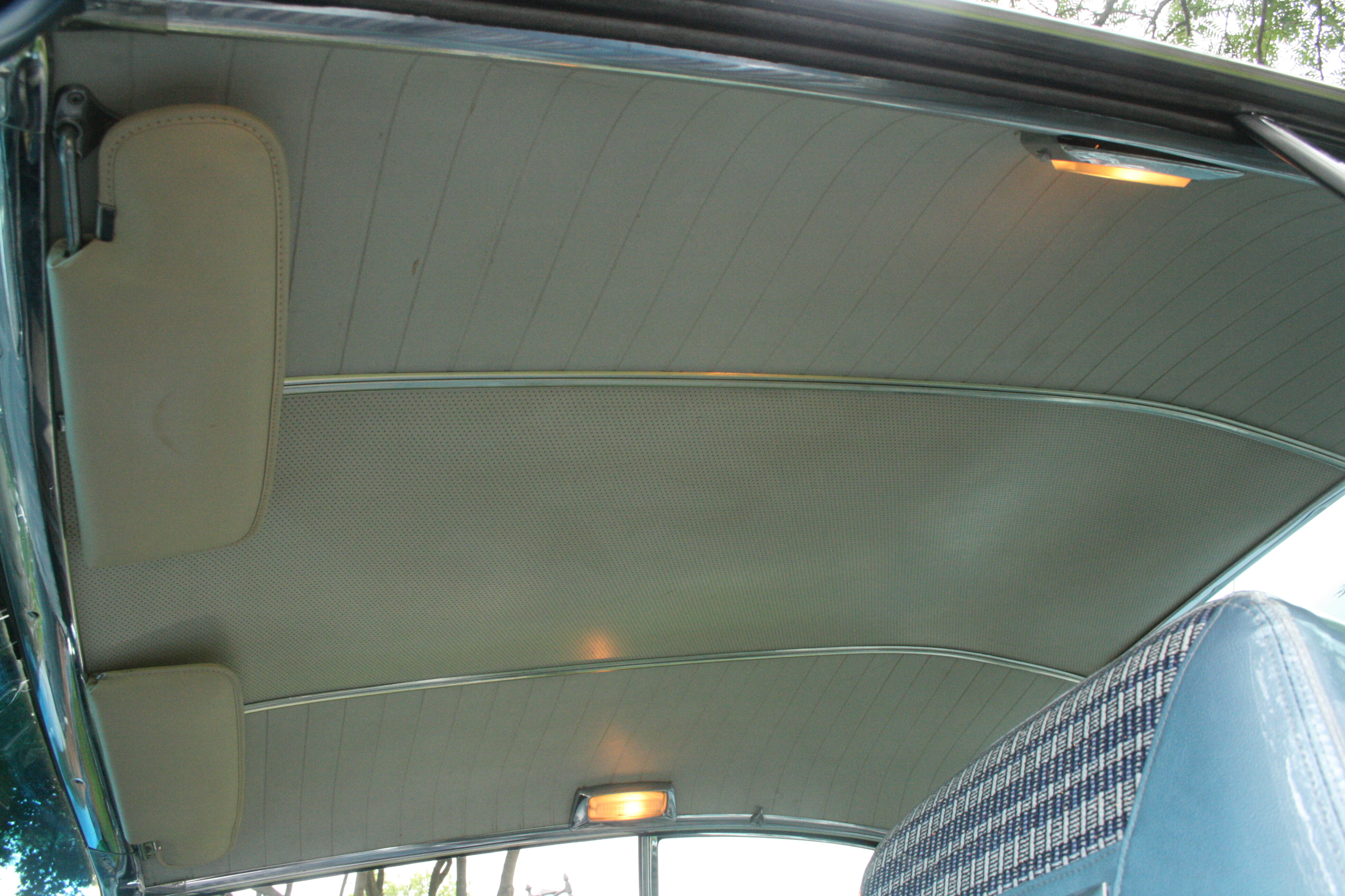

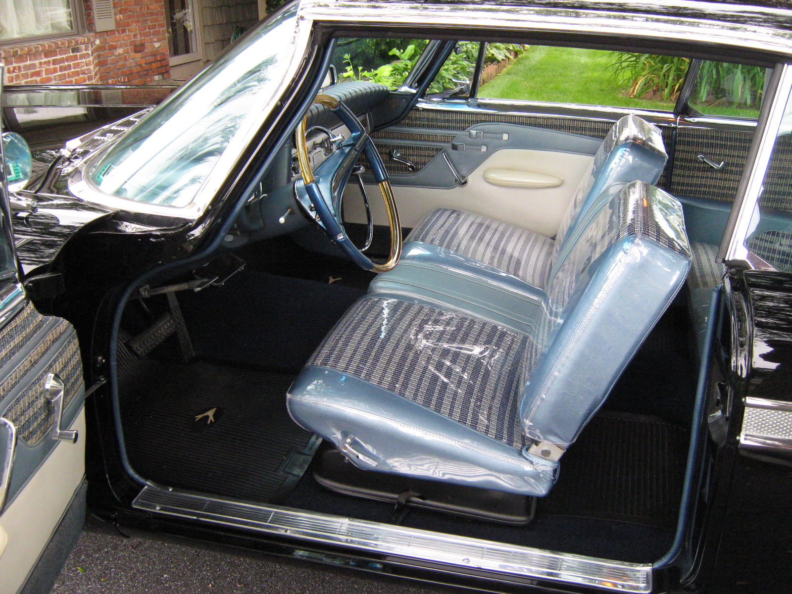

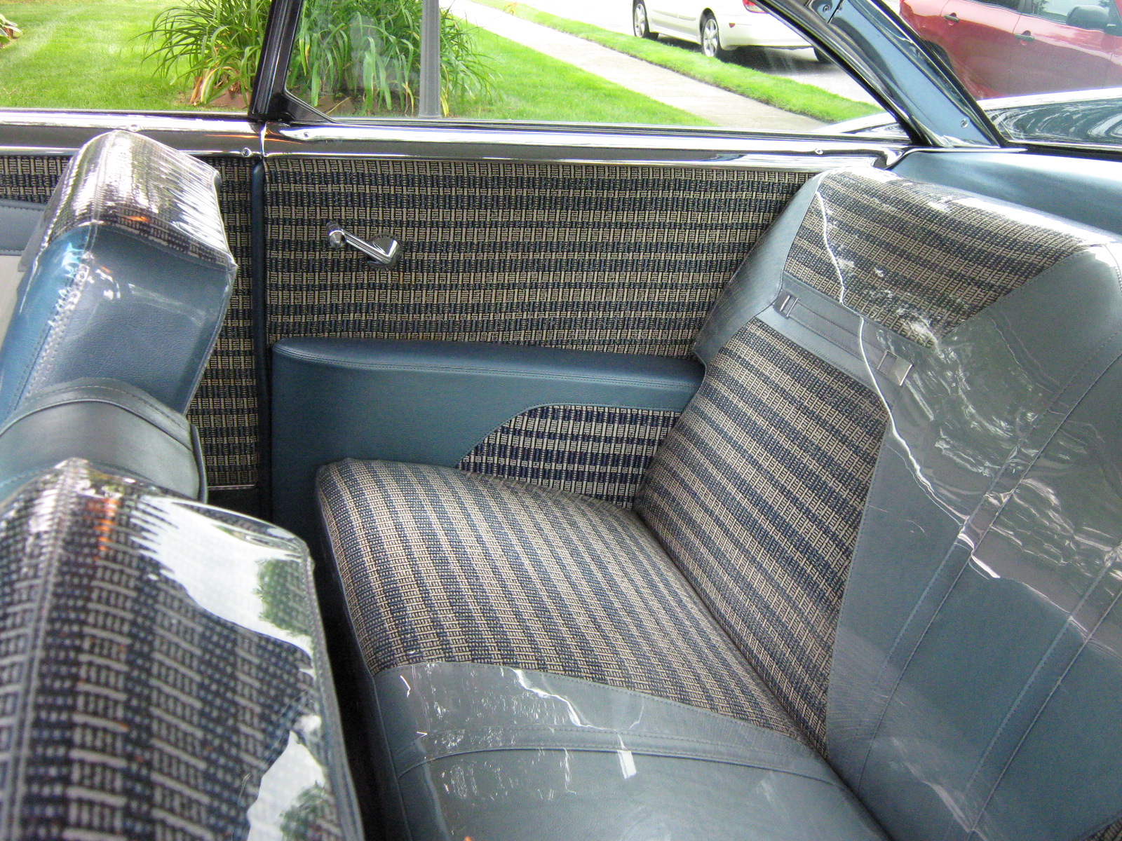

Back seat is ORIGINAL FABRIC–FADED BUT NOT TORN

Apologies for the duplicate pictures! Many cameras were clicking that day…

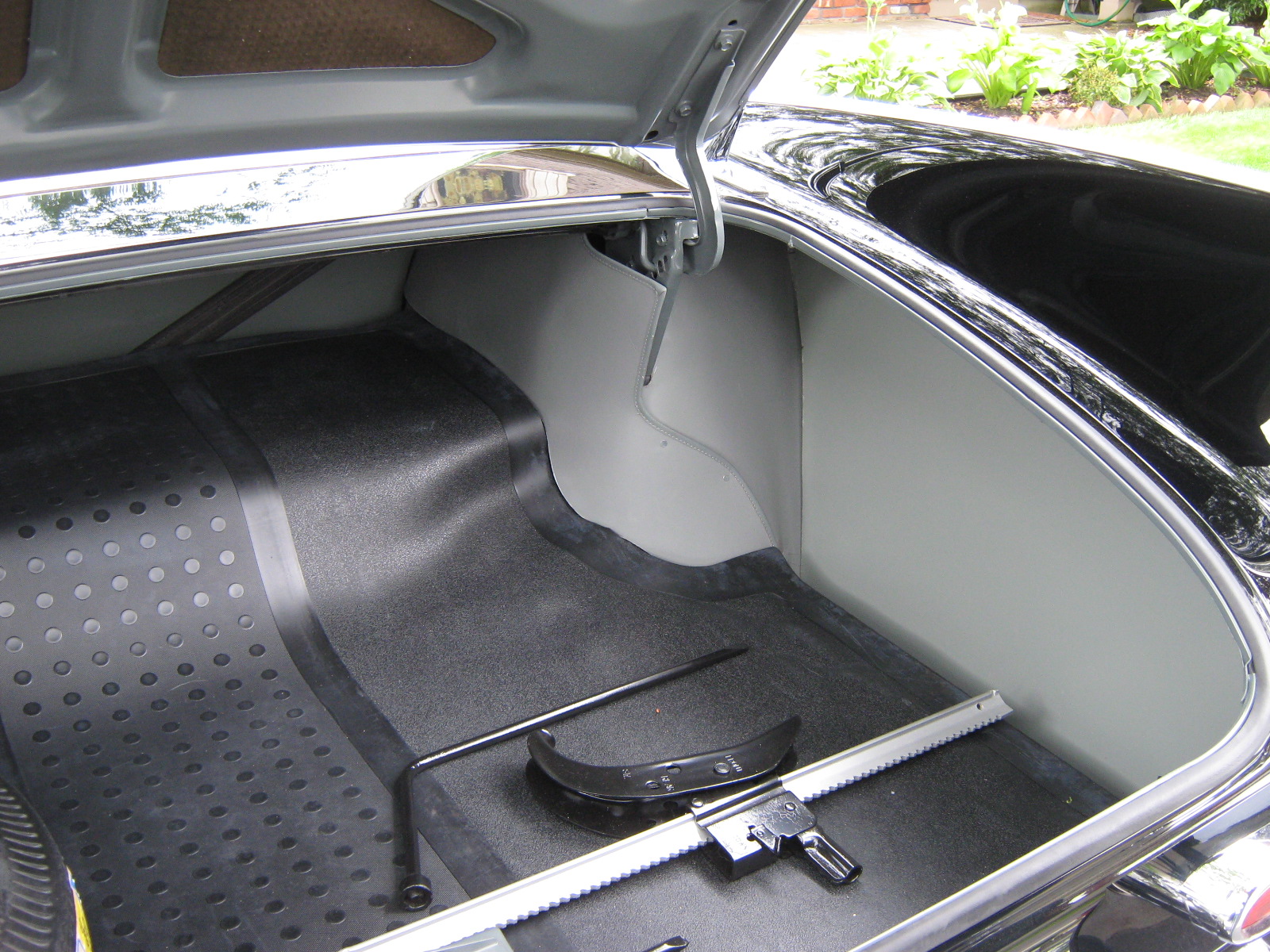

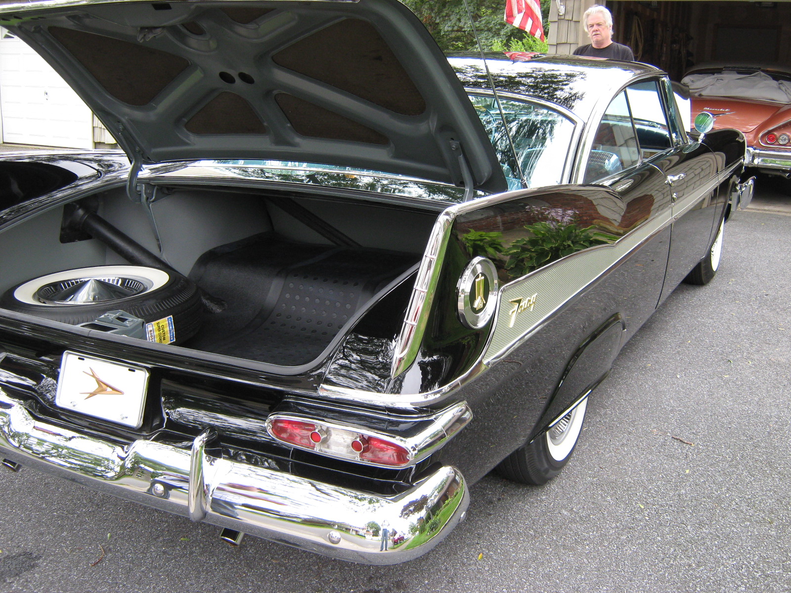

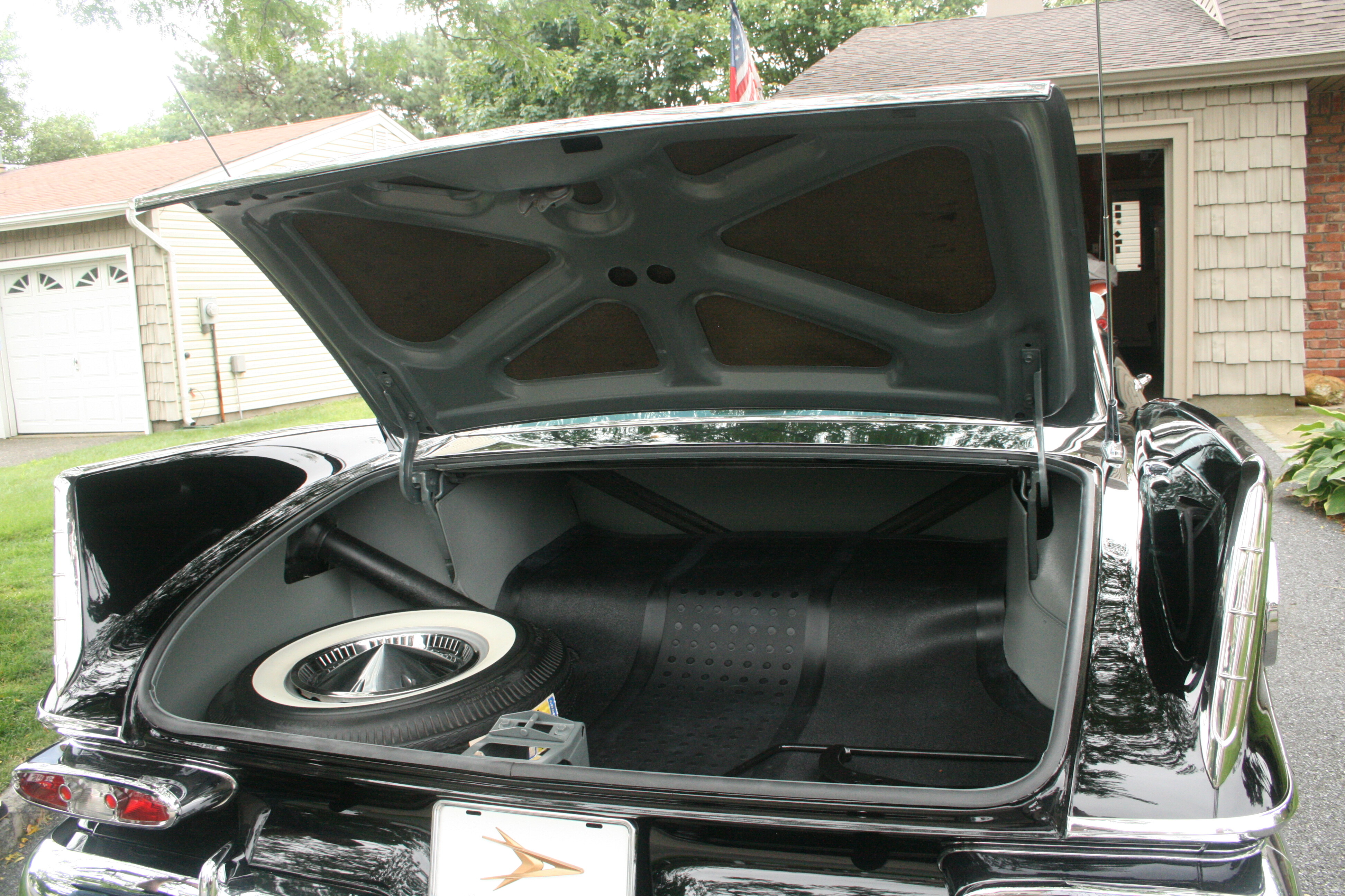

Original silencing fabric on bottom side of lid.

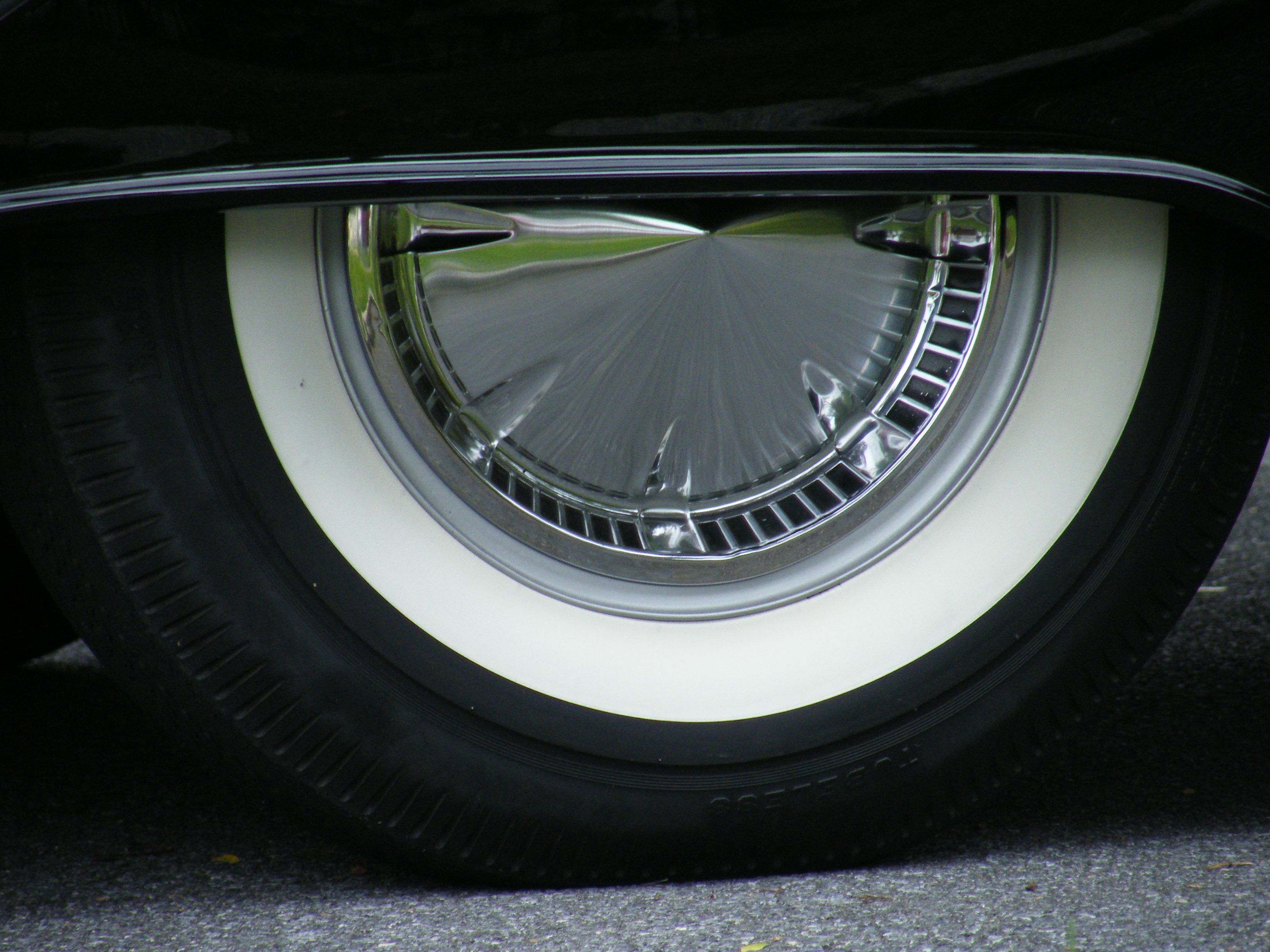

For the fender skirt lovers among us!

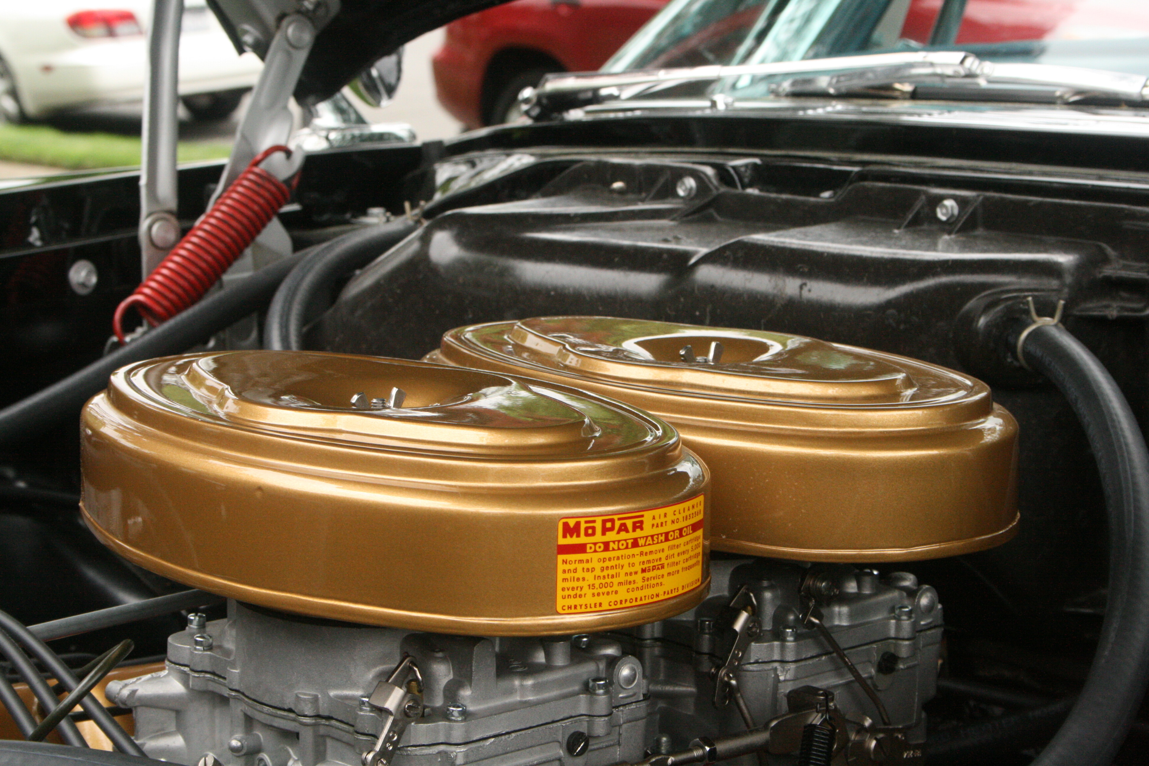

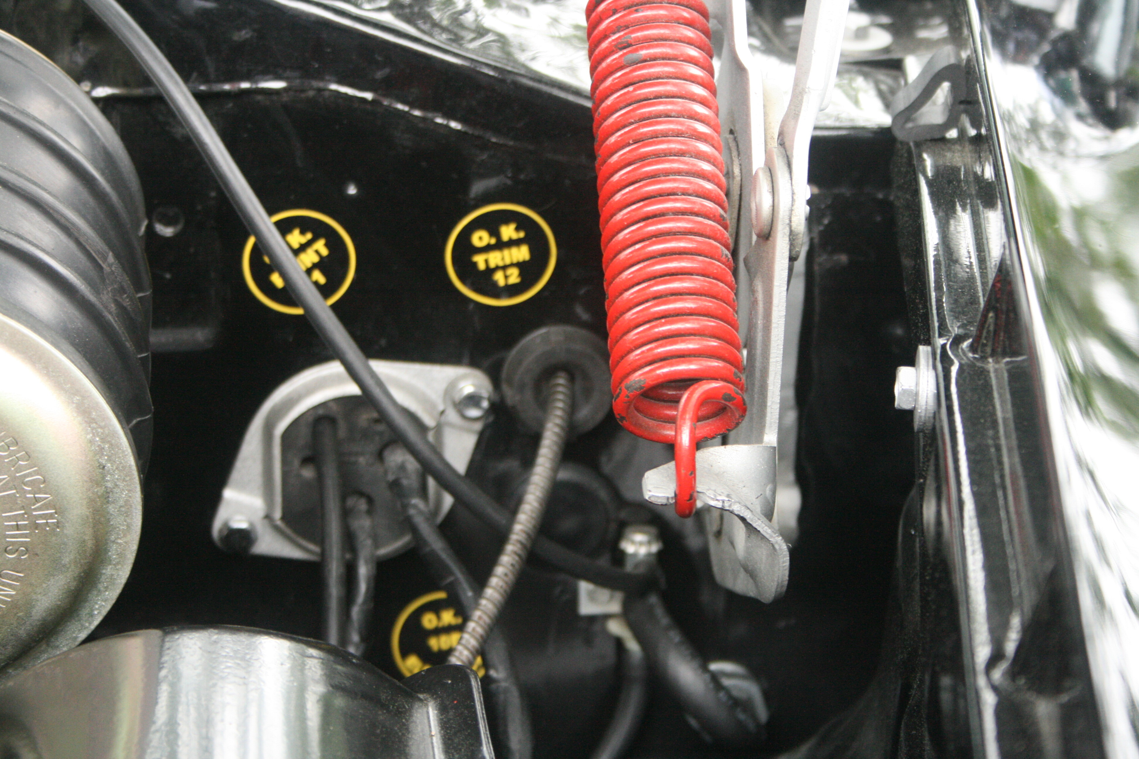

Routing of the choke line is correct–it was a pain

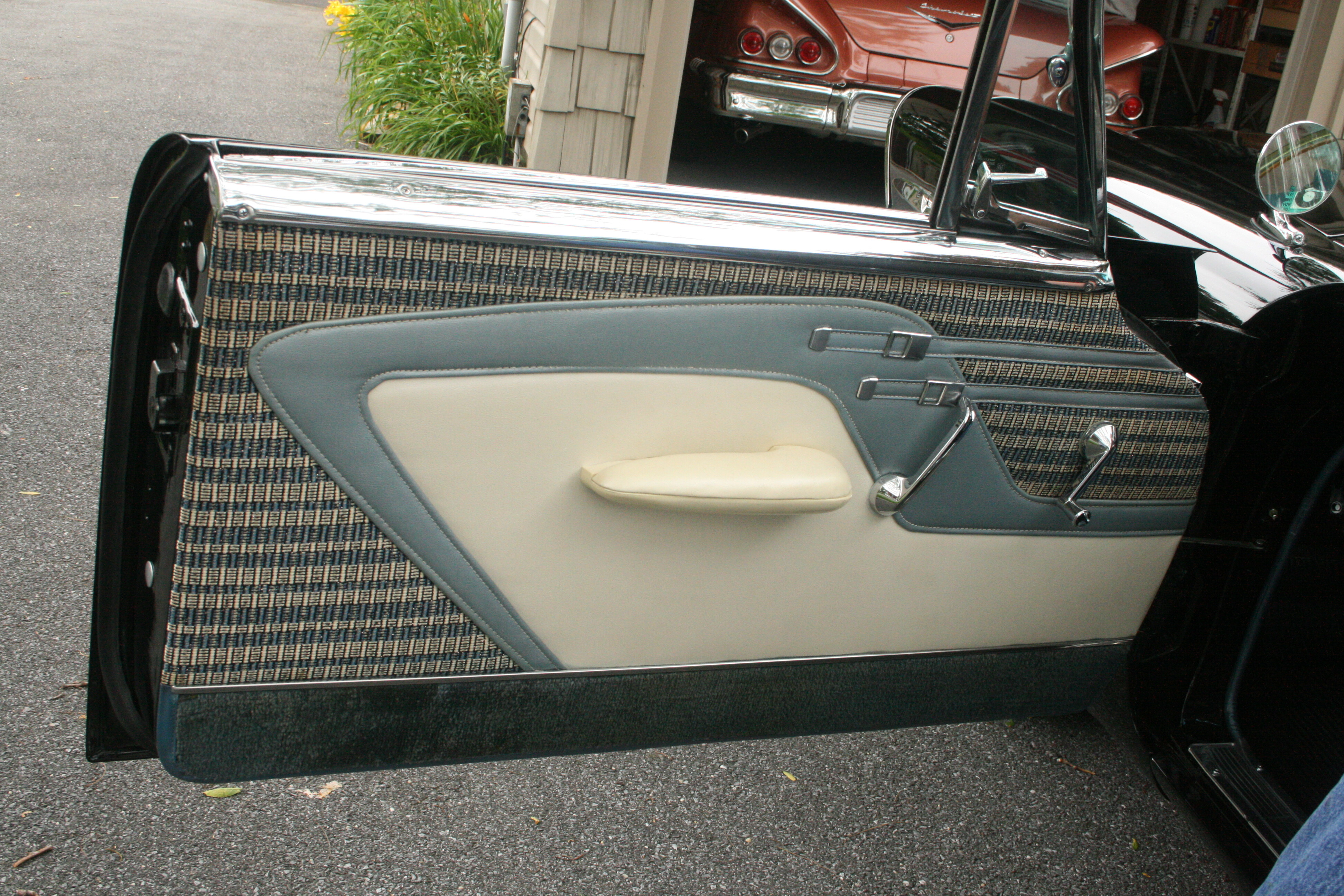

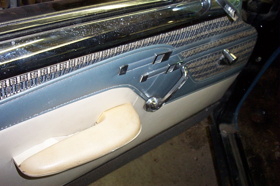

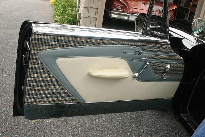

Door panels have the 5/59 date stamp on the back side

Center arm rest is original fabric

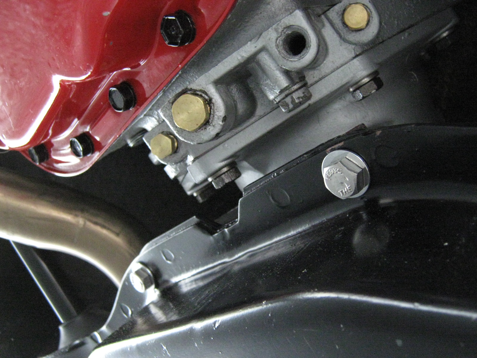

Bolt-head madness!

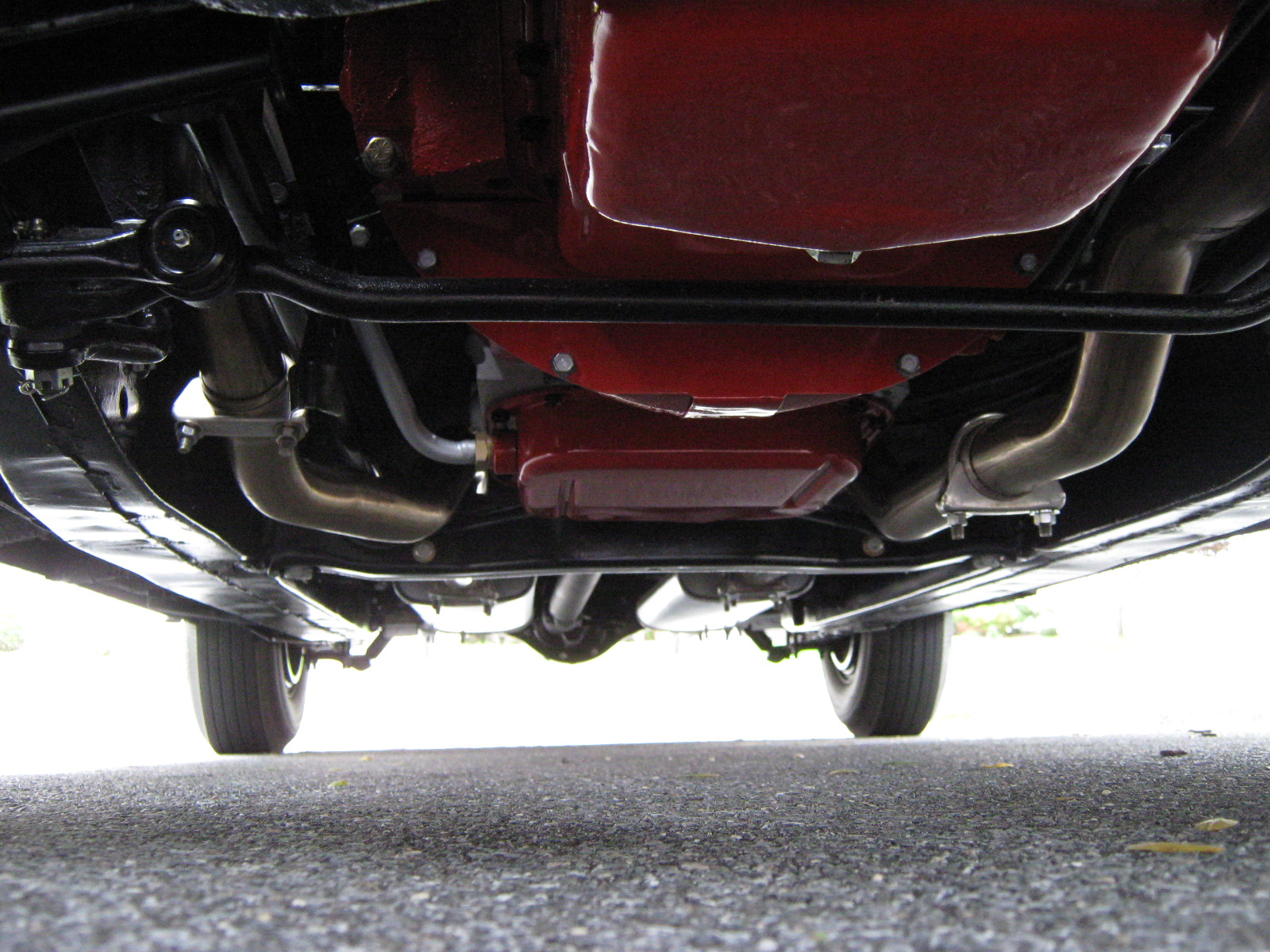

The Trans pan looked much better in red (POETIC LICENSE)

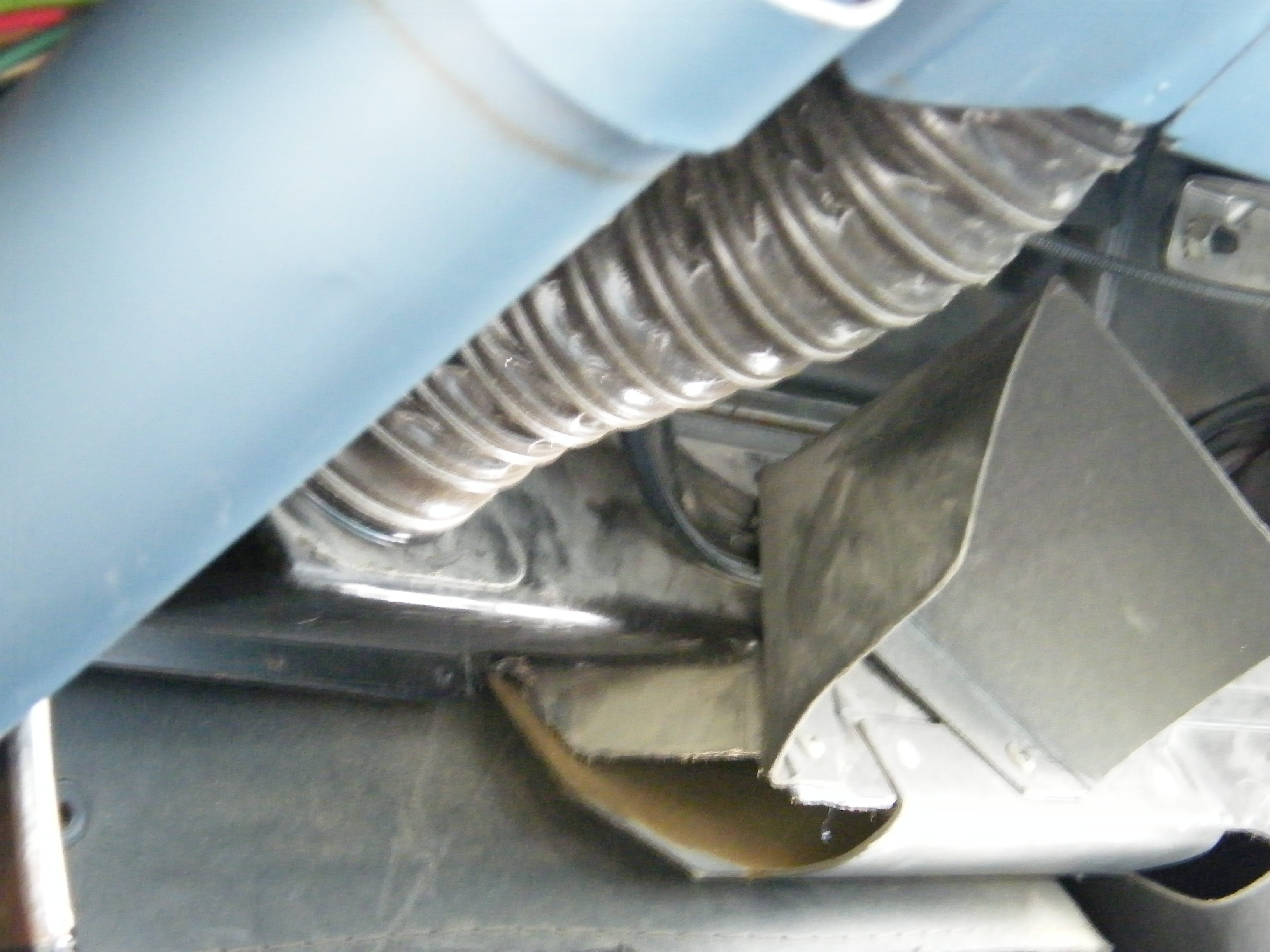

Correct rear muffler brackets and hangars—weird set up

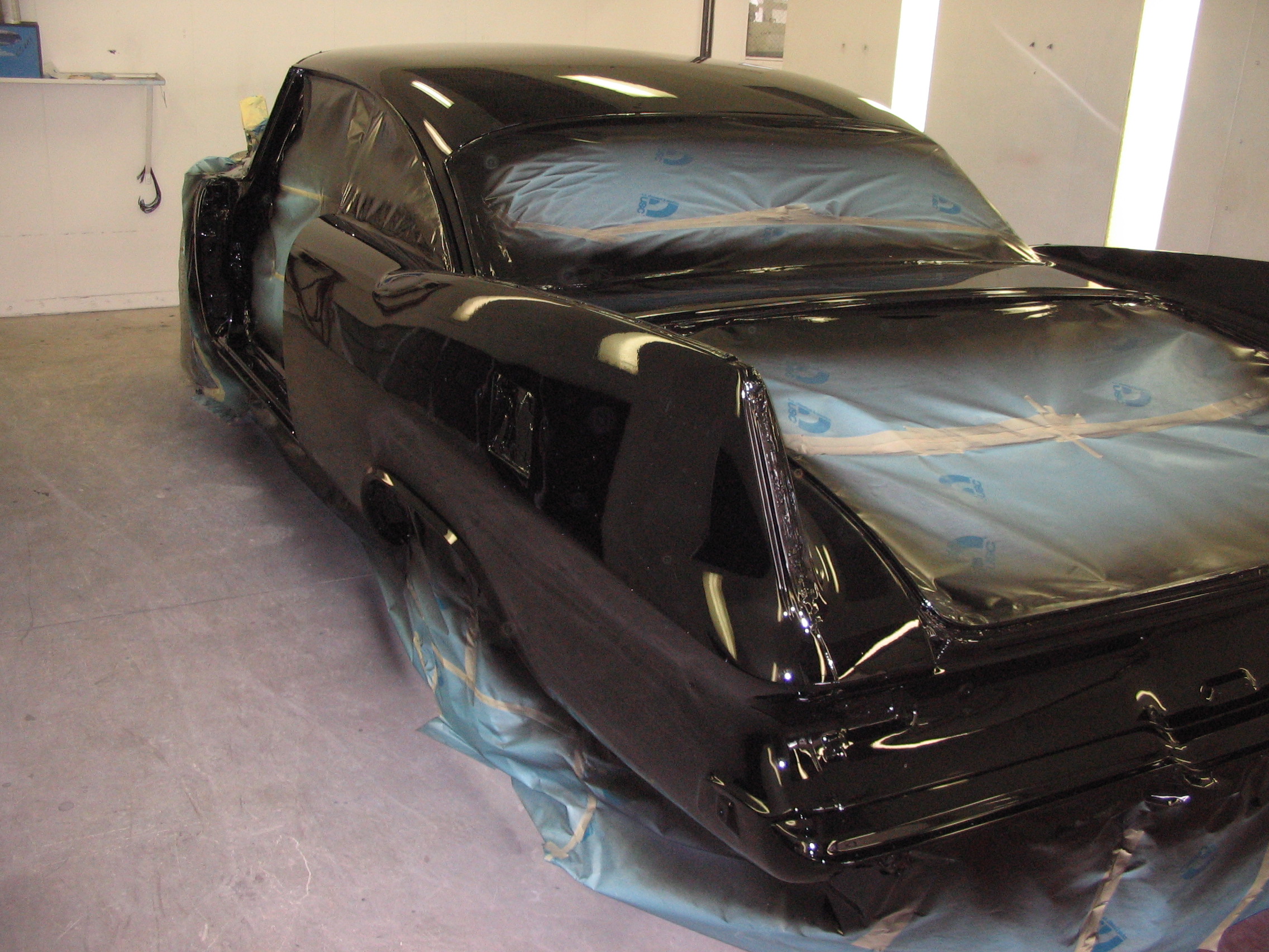

Exterior prep and paint done by these folks…

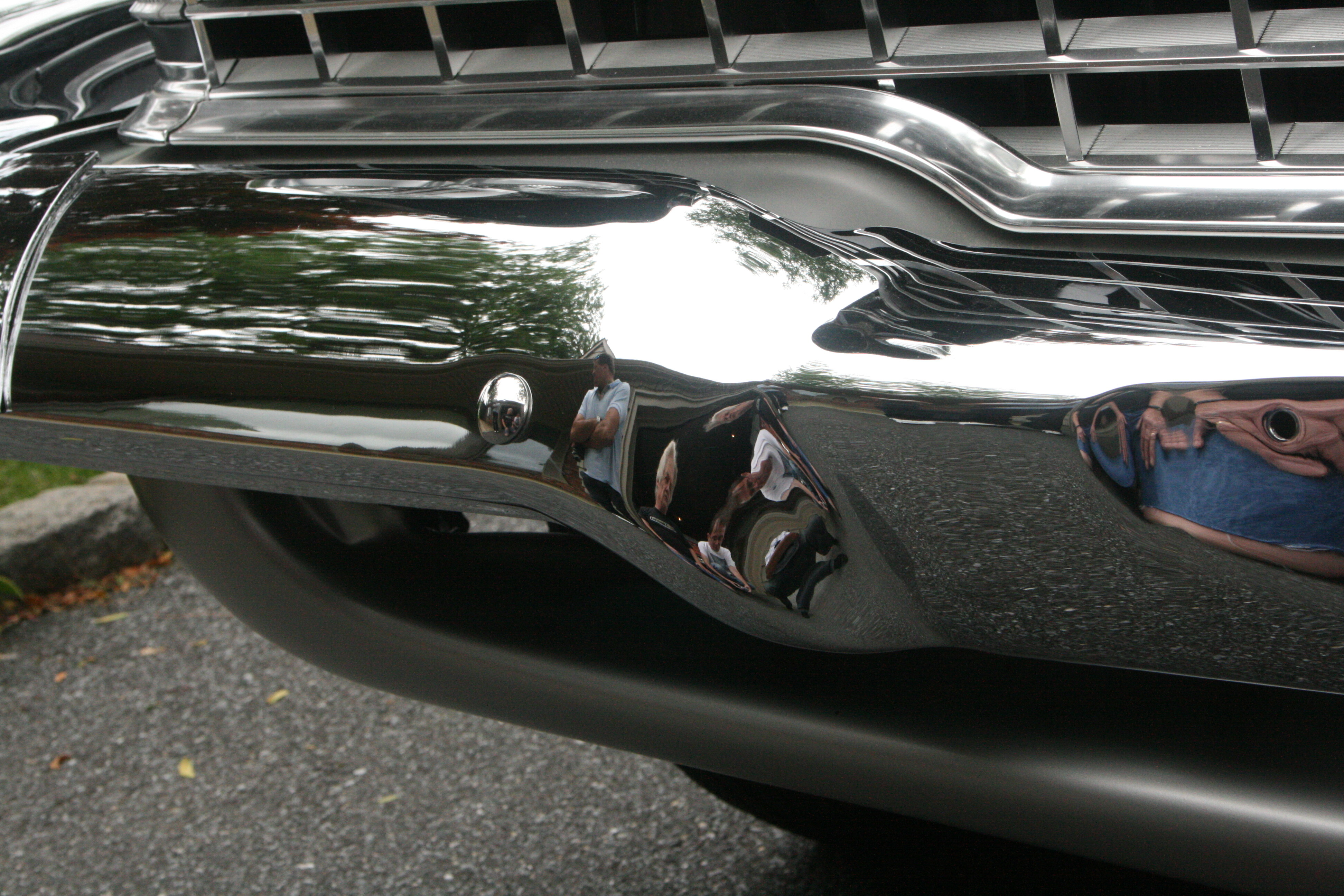

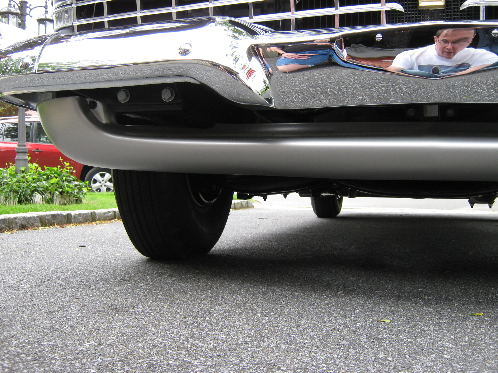

Matthew caught Ed with two heads in the bumper reflection!

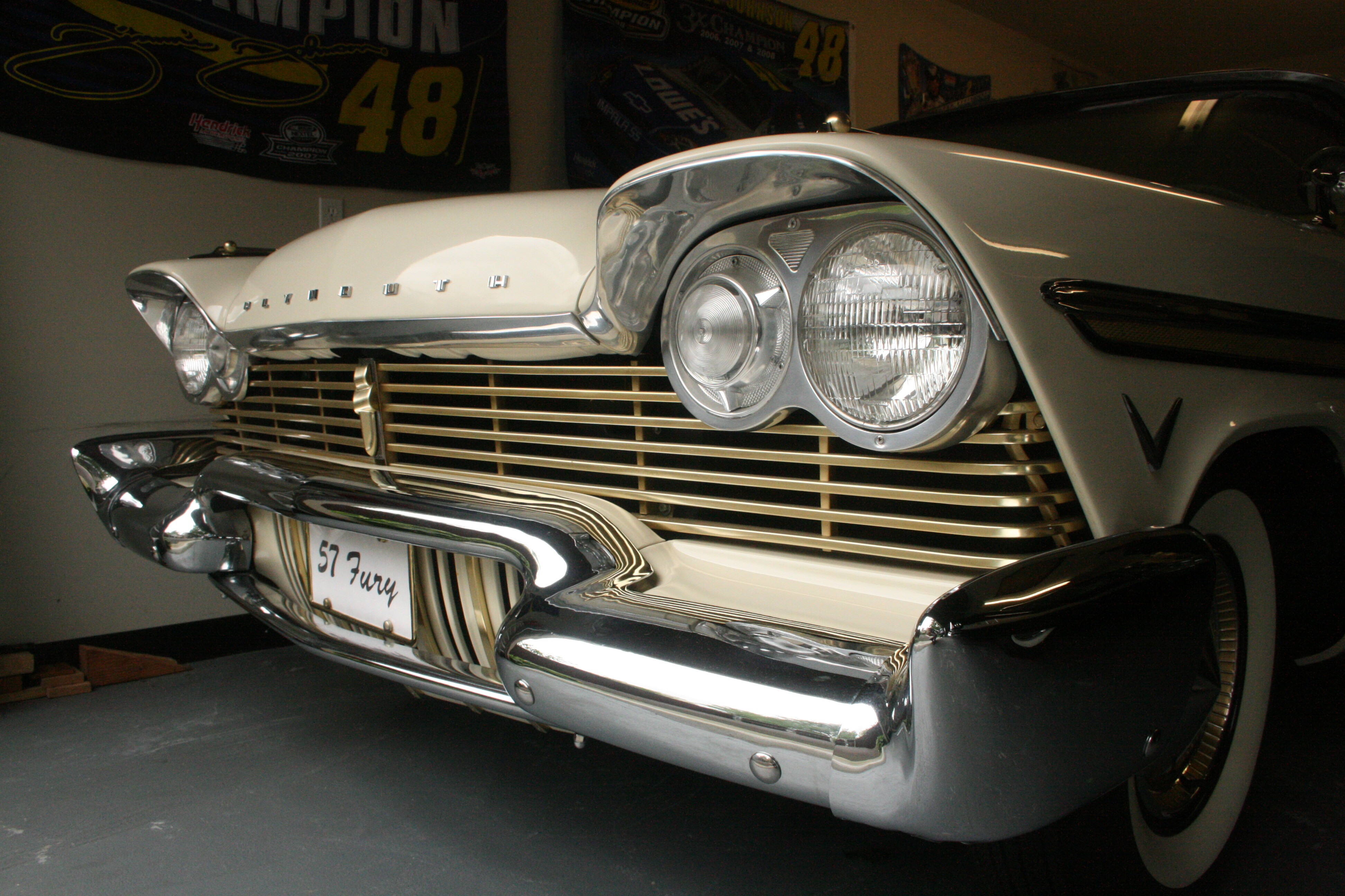

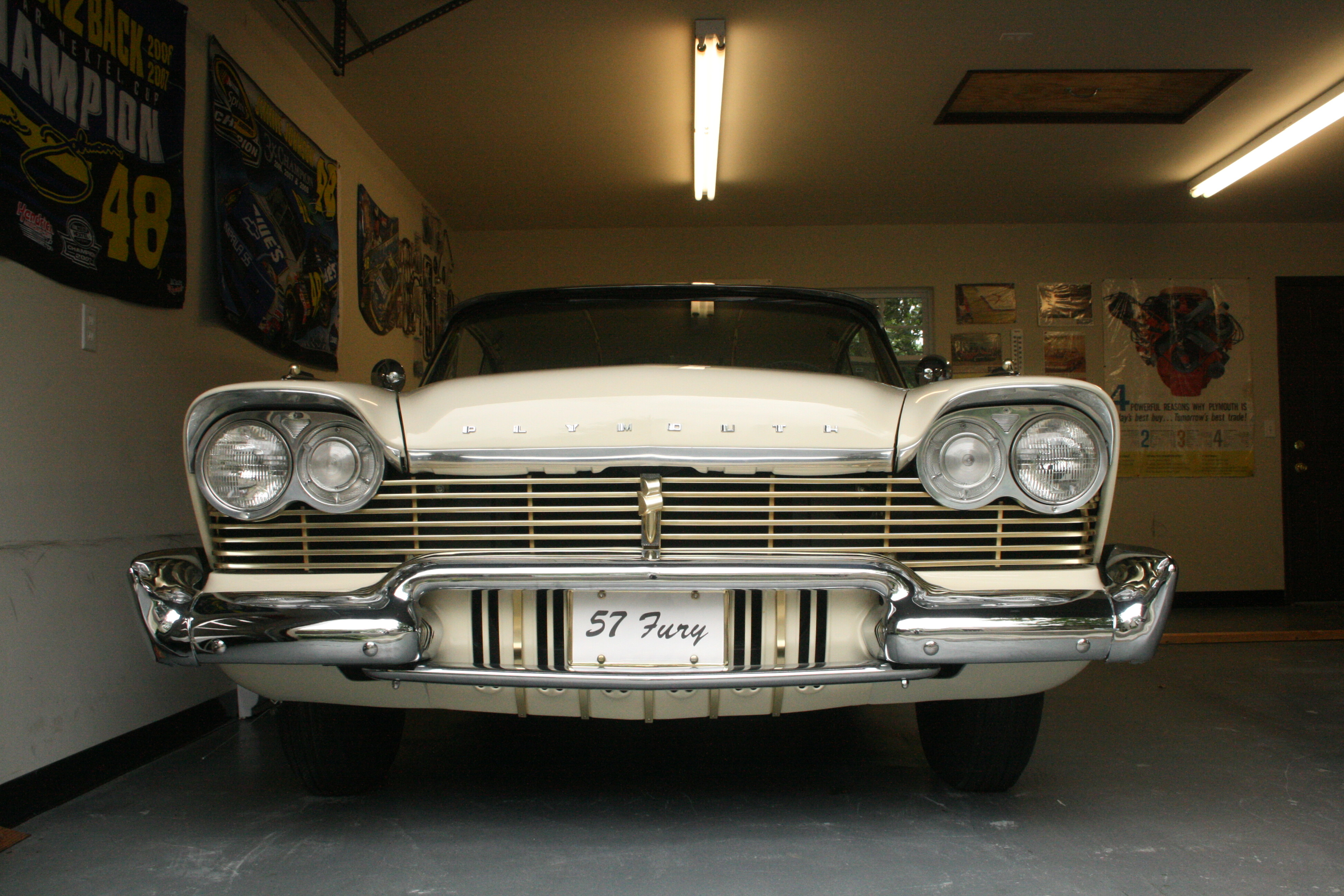

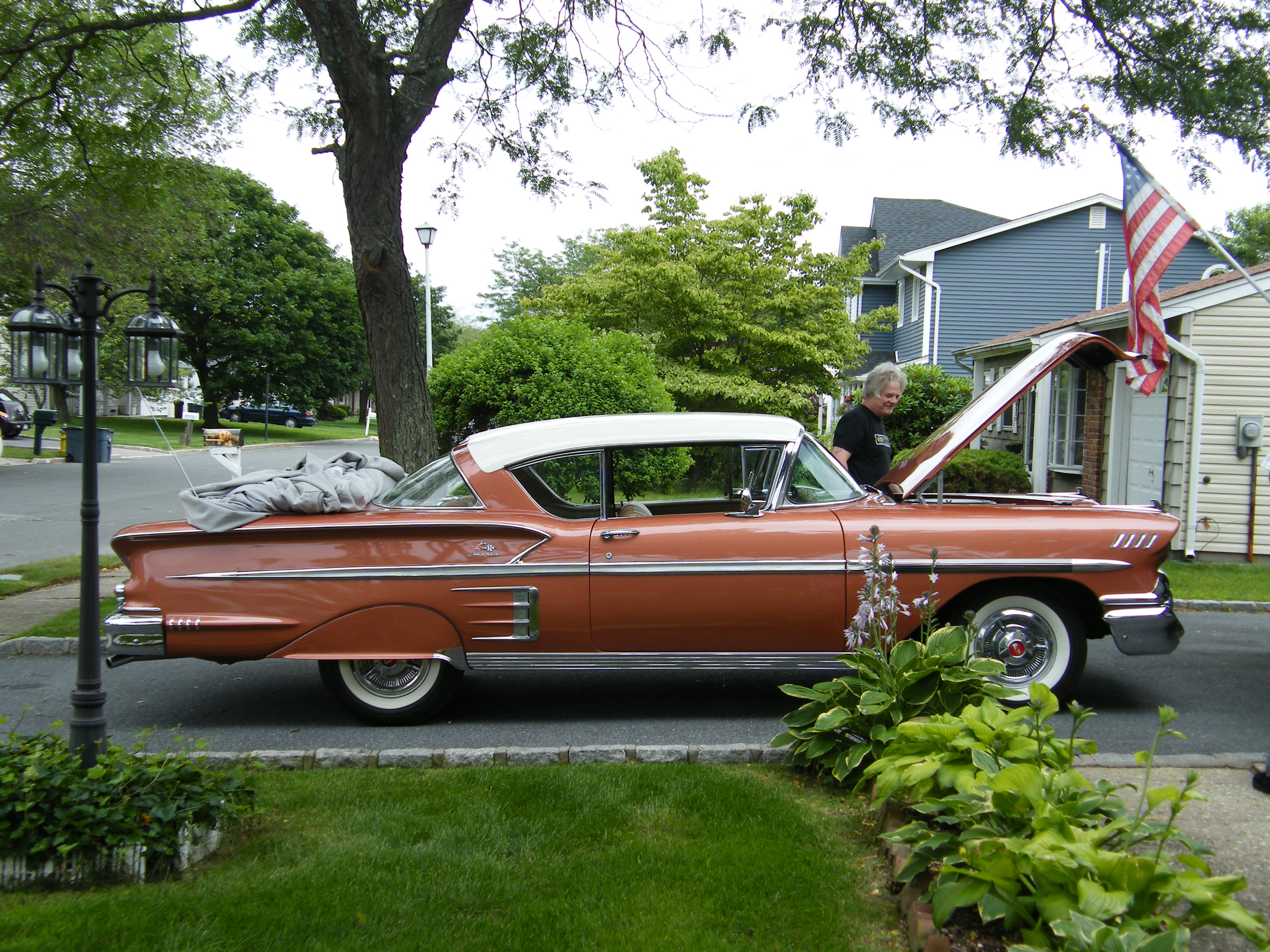

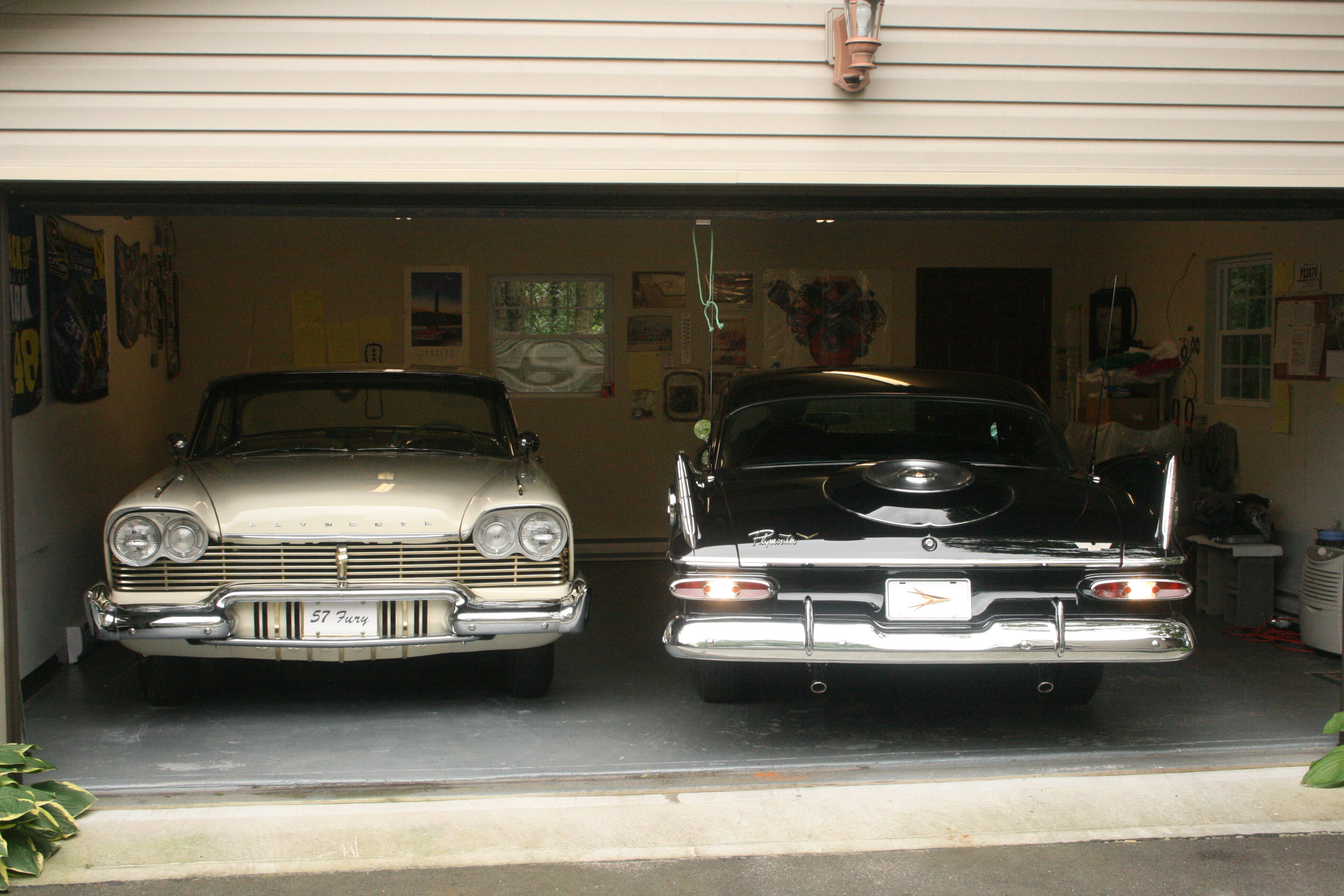

Ed’s prized '57 Fury
My 57 started the madness

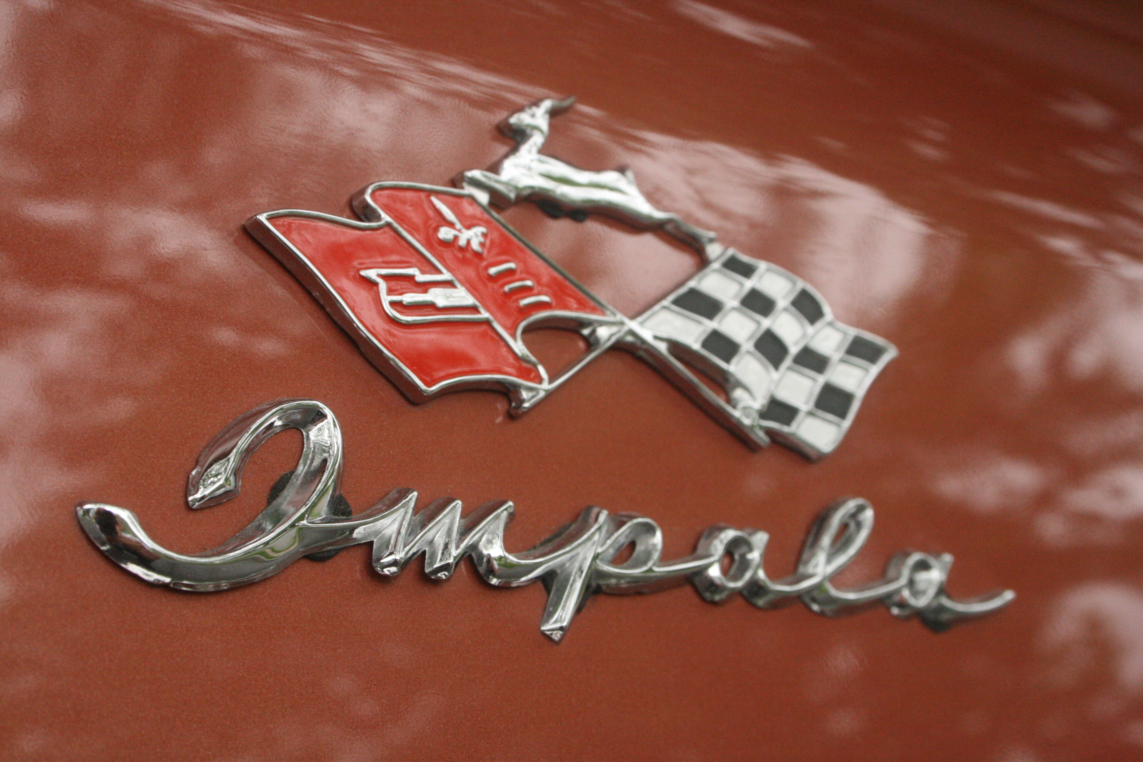

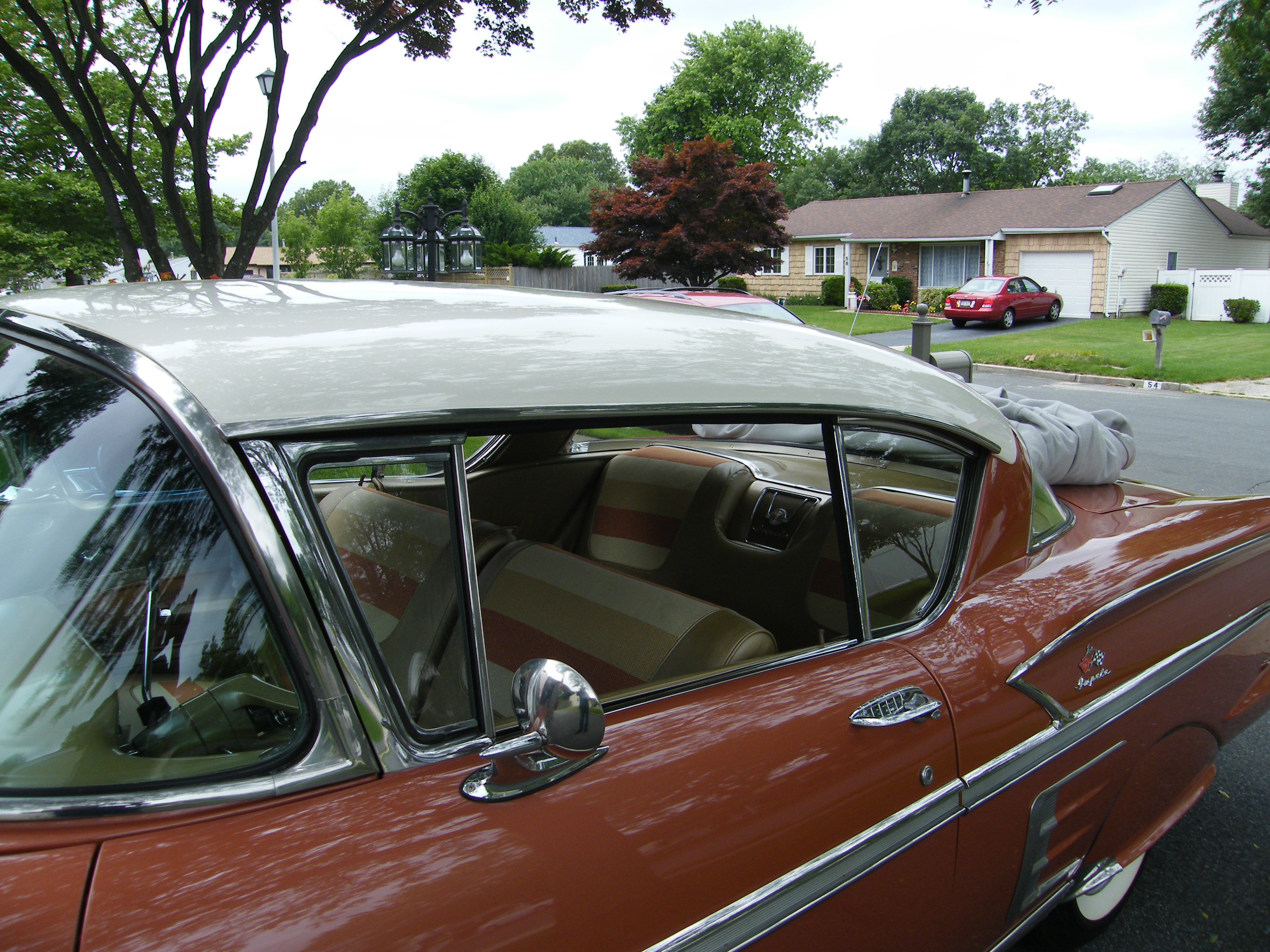

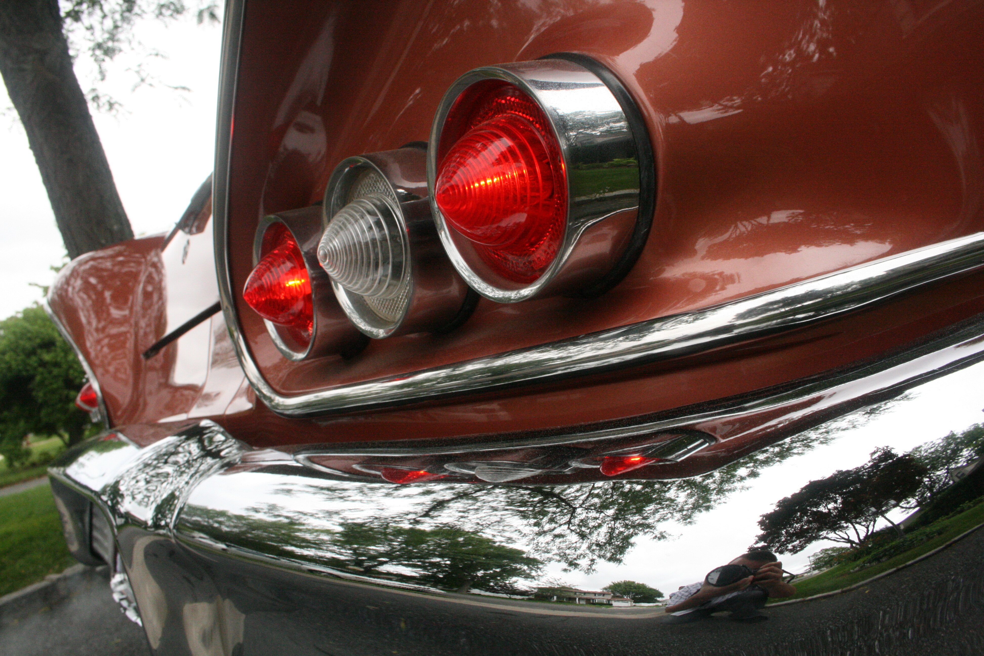

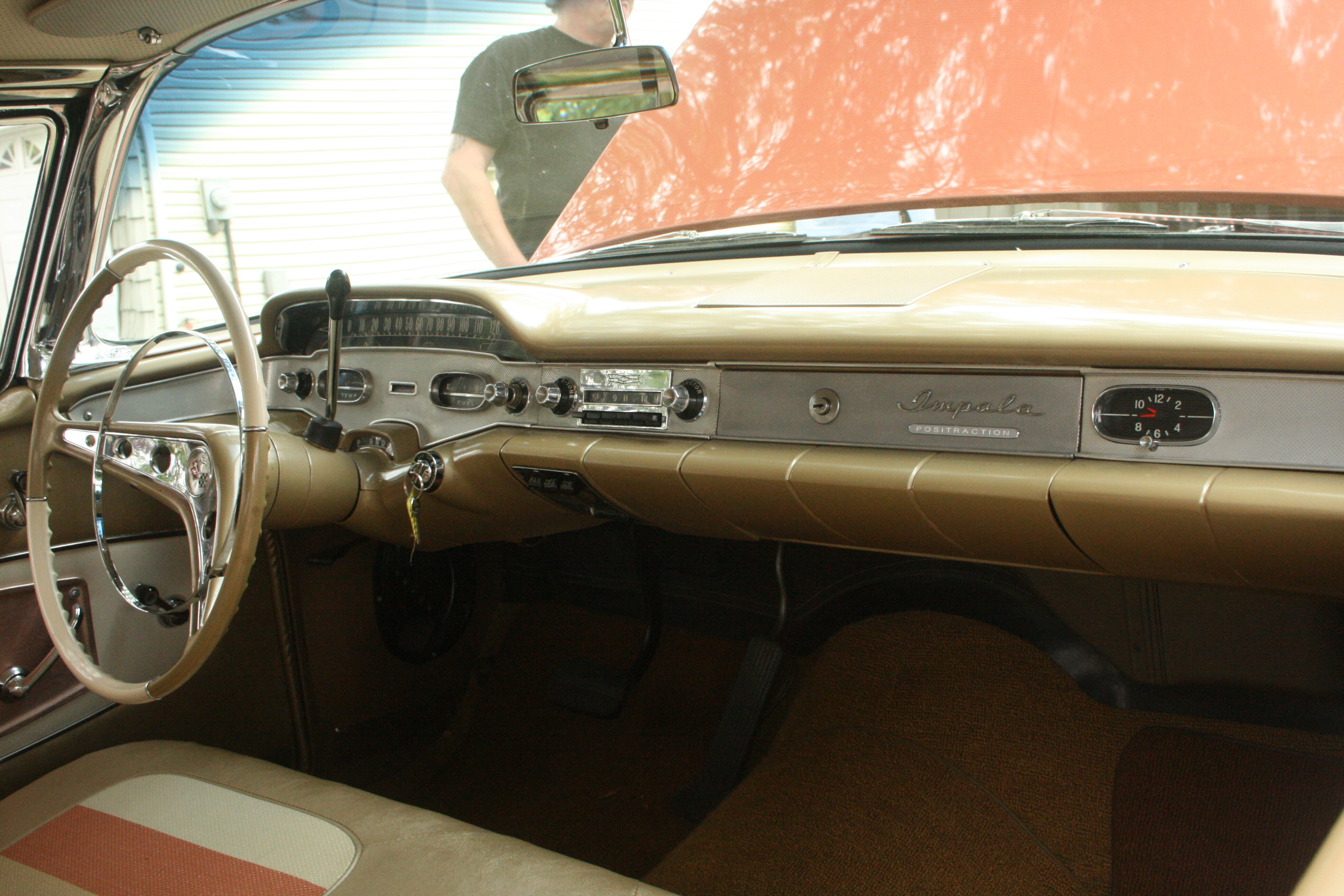

Truth be known – Ed is a Chebbie Lover too! He says…
A MOPAR LOVER WITH A CHEBBIE–NOT a Chebbie lover with Mopars

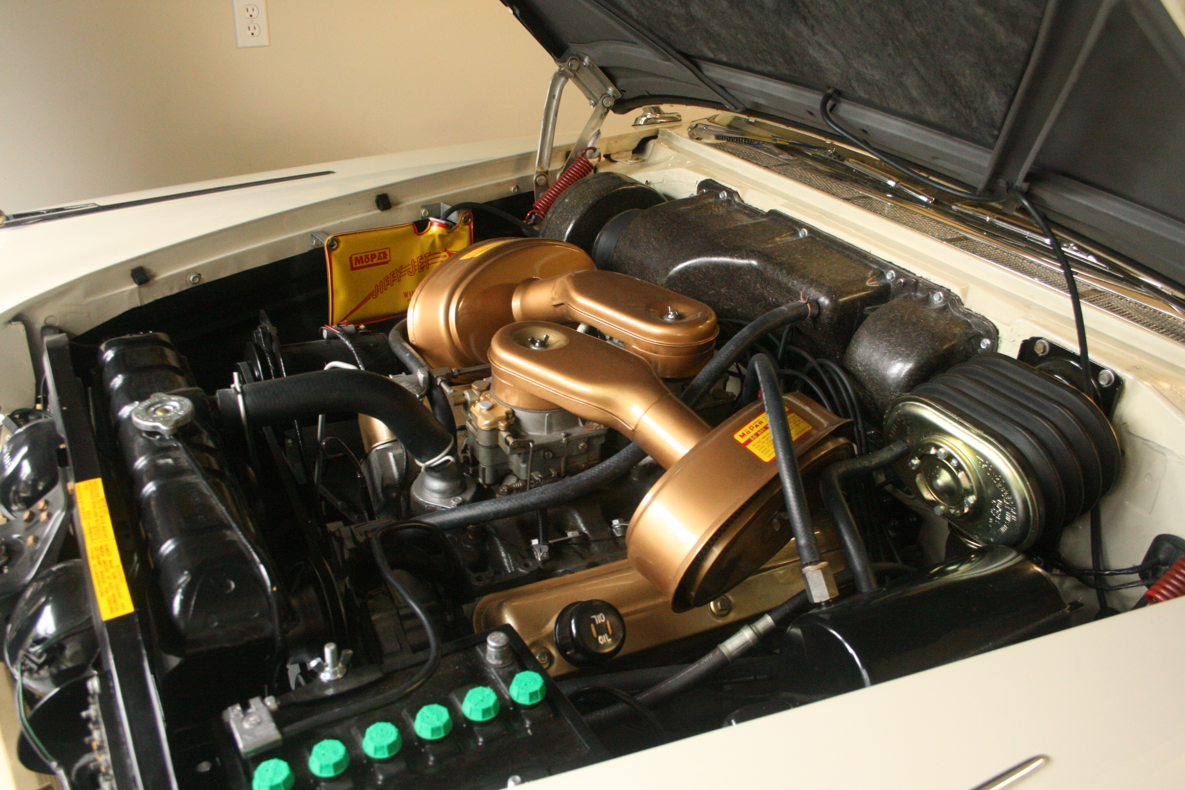

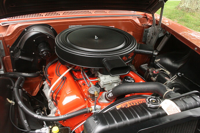

280 HP 348 ‘STUMP PULLER’–amazing bottom end torque
