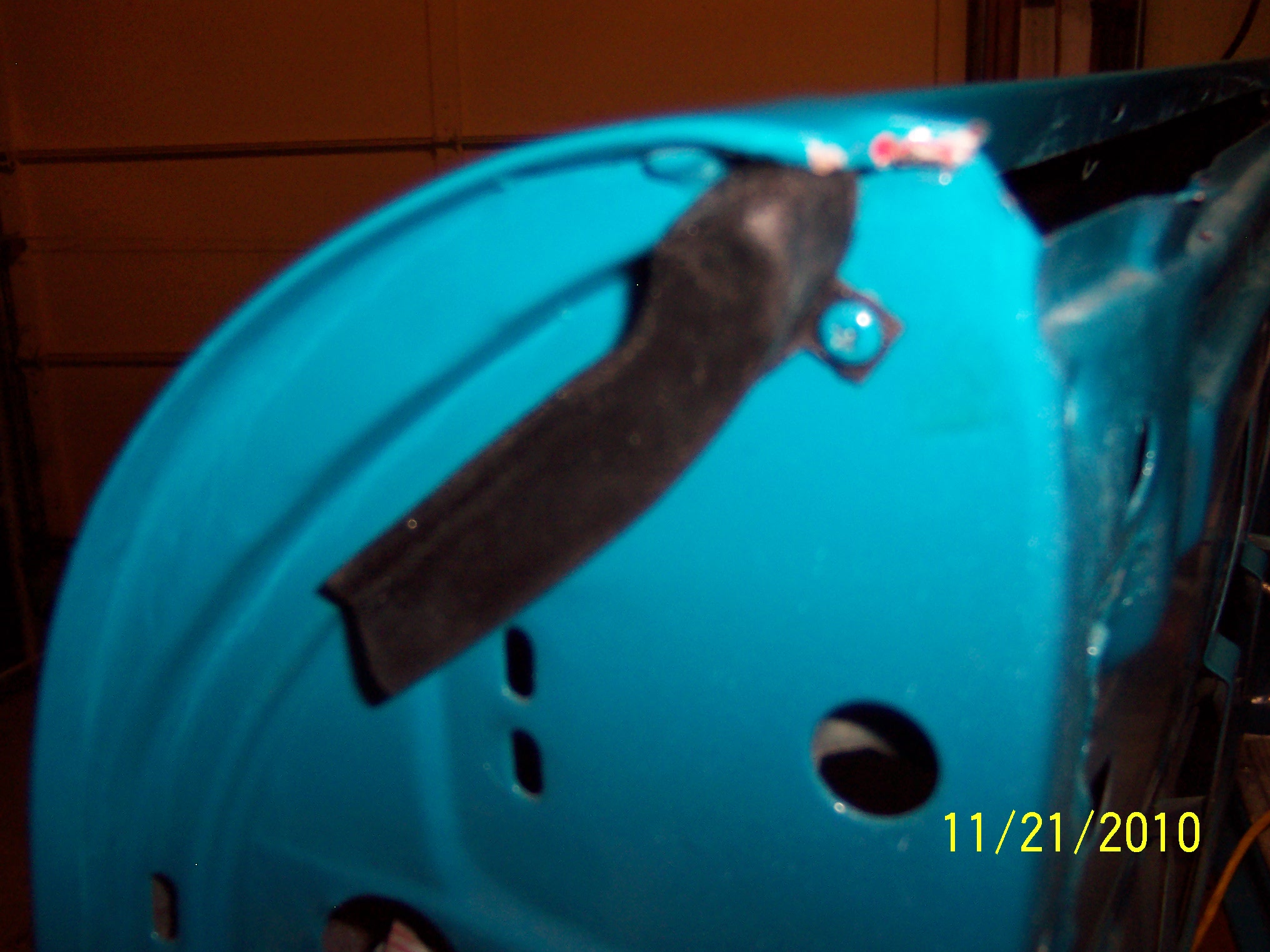

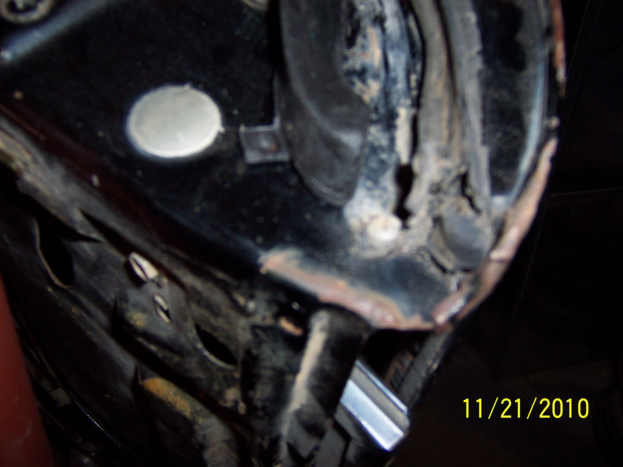

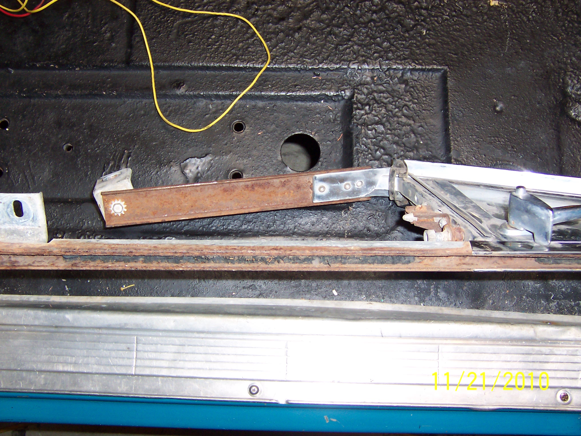

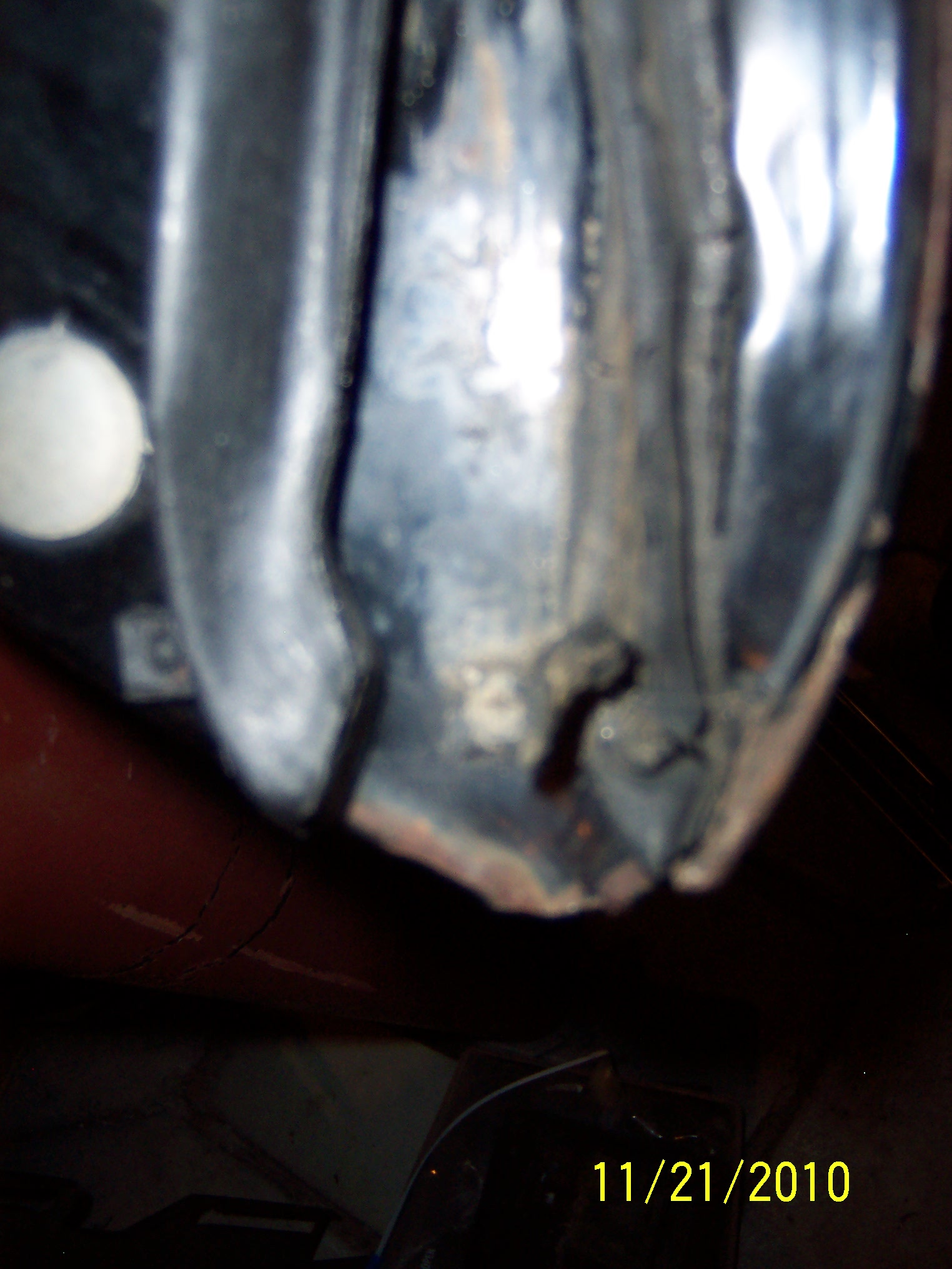

rear door support channel, C-2 seems to wide for this to be installed… need to remove this old U shapped old window channel and the now C-2 can be carefully tapped in. It does not go full length but it will work fine. Shown here is the C-3 part that does not go in this assembly, C-2 needs to go here.

Test installing of the #484 piece to drivers door to show how and where it fits. The body of the this short piece will kick over more when clued in. Looks like I have to touch up this door a bit.

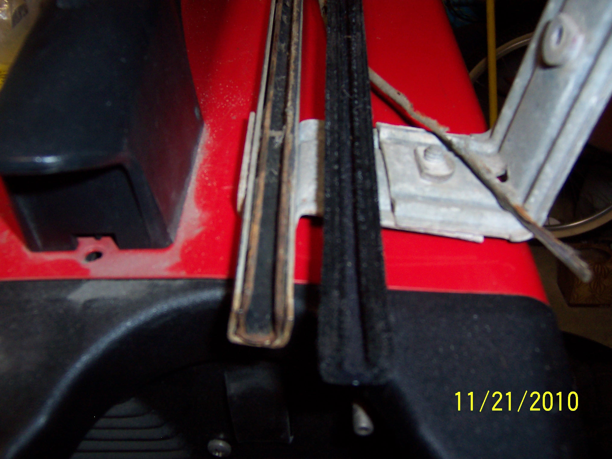

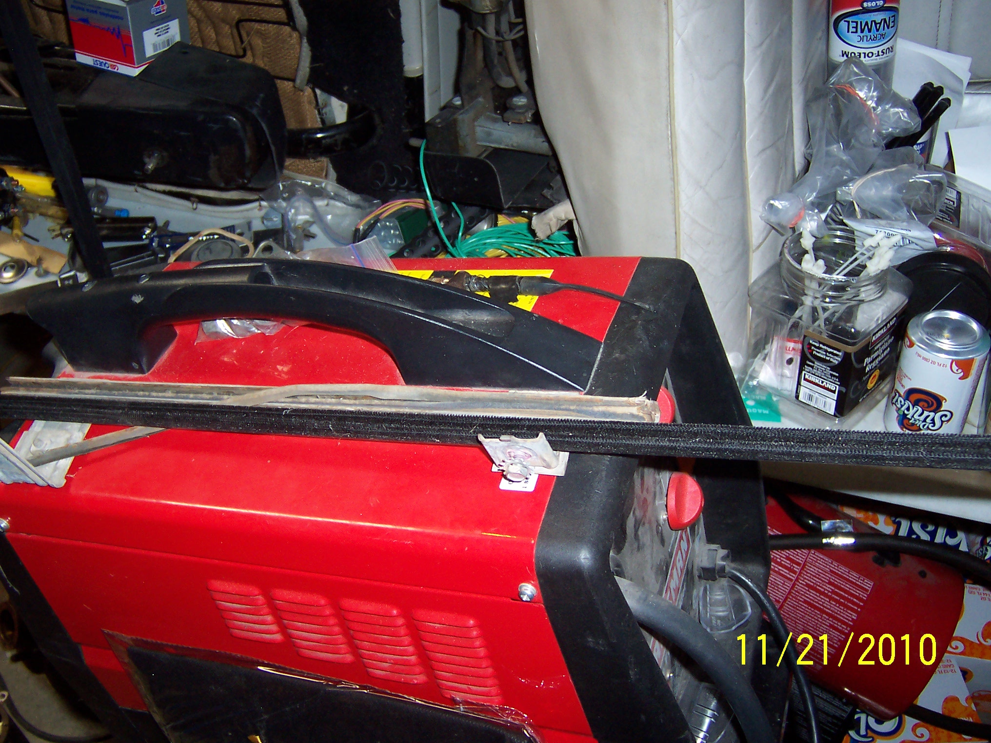

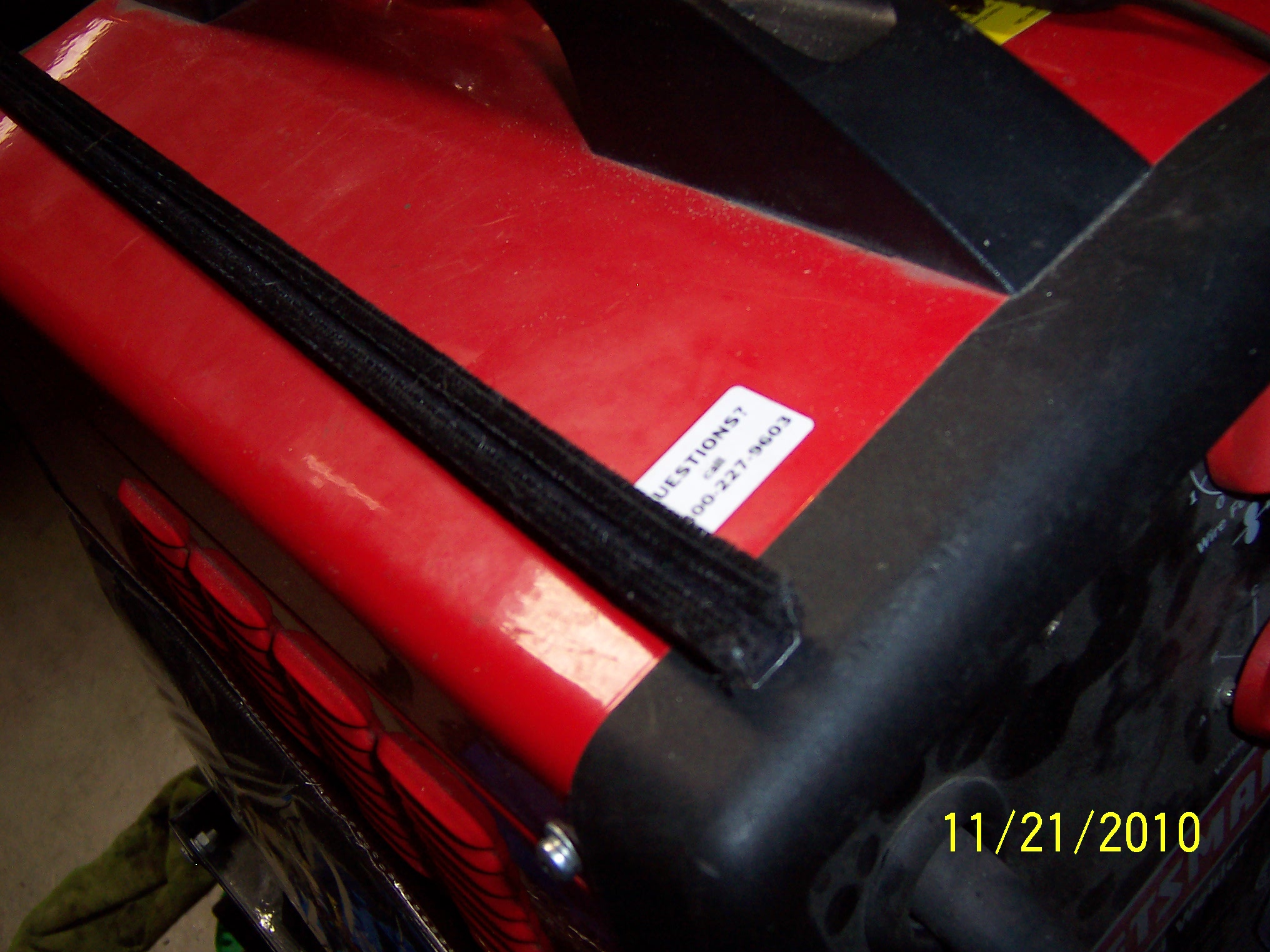

I found out why I was having a problem with the Goers part number (or so I thought the part was..) C-2 that I had ordered and could not figure out why it would not fit. It was actually the C-3 part shipped in error!
I had to remove the the old metal U shaped channel support that was in the Vent window grove first and then it could be tapped in. This part is actually the C-3 part not the C-2. (Goers shipped the wrong part but the width of the weather channel showed what part it was. I actually needed to order both the C-2 and the C-3. But ordered C-2 but received C-3.
Goers part nbr. C-3 goes to the vent window vertical assembly part (after you remove the old metal channel part there is room) and the C-2 goes in the narrower vertical rear window run that is located inside the door towards the inner latch mechanism. This internal window channel holder is narrower then the vent window channel. That is why it needs the C-2 Weather channel.
So, it worked out fine what I had, since it was needed anyhow. I needed the C-3 part too but had failed to order it. So in strange ways I did get the C-3 needed but now have a rush order in for the replacement narrower C-2 weather channel for the rear interior vertical run. Hope all might have learn from my adventures that there are two different weatherstrip weather channel pieces to a door. My pain your gain!
