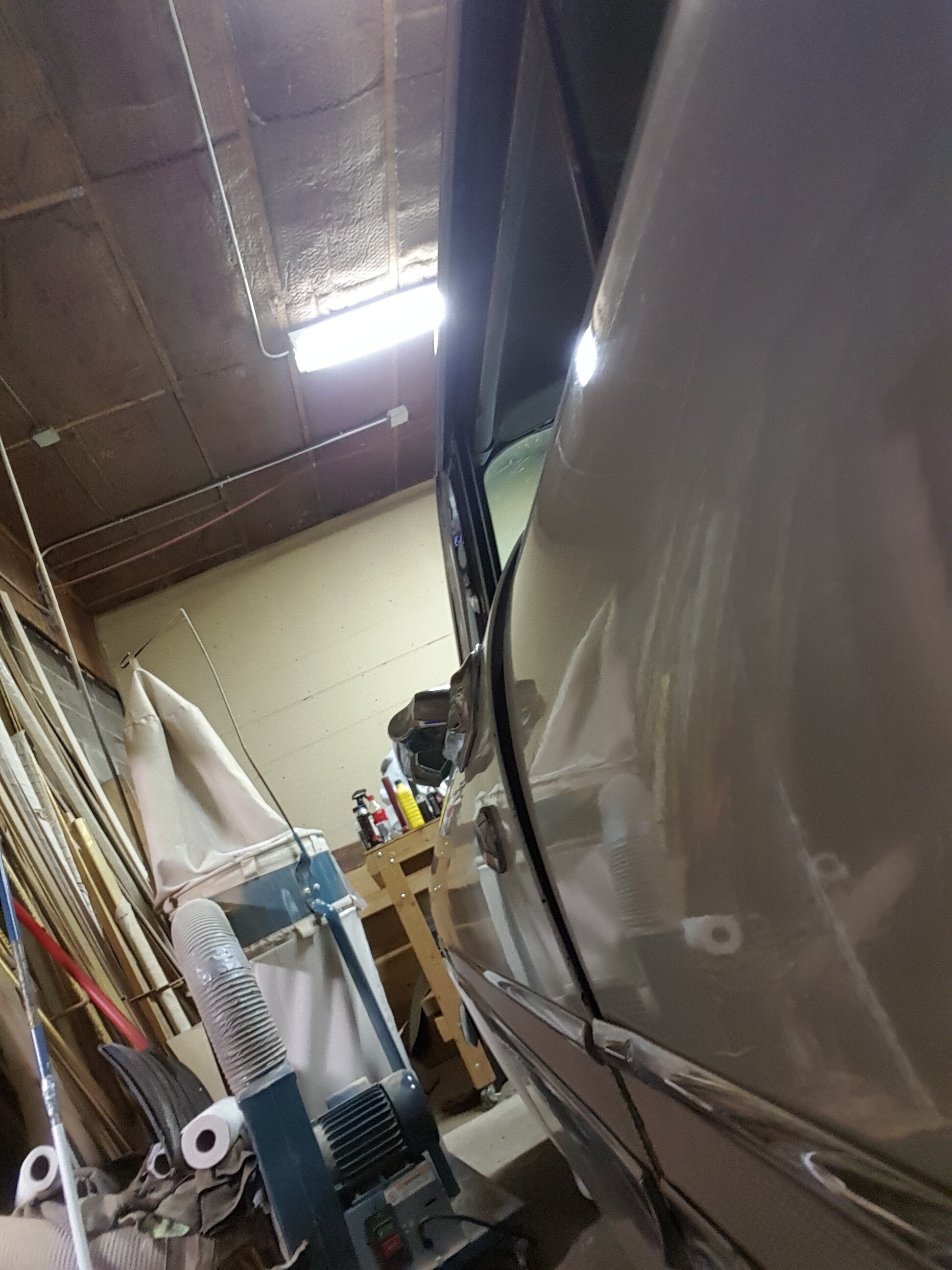

I need some advise on some alignment issues. Firstly… the rear driver side corner of my hood is about 1/4" lower than the fender, the front of the hood is fine. Can I just simply place a shim between the hood and hinge or do i need to a loosen the studs in the firewall and adjust the hinge placement? Secondly… Both rear doors line up with the rear fenders fine but flare out on the bottom about 1/4", I have no idea how to fix this, also the back of the front drivers side door sticks out on top about a 1/4" from the top of the back drivers side door. I also have no idea how to fix that. All the spacing between the hood , doors , trunk lid, etc. are consistent. Can any one advise?
