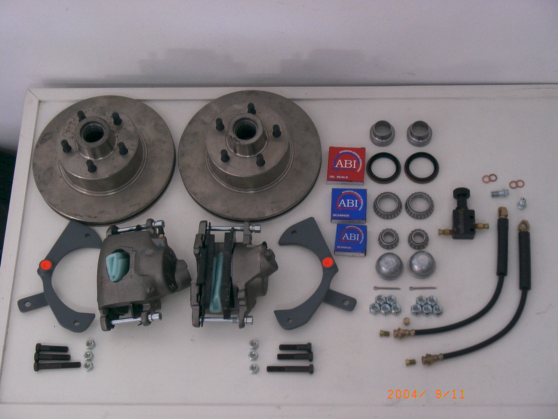

The “Super Deluxe Kit” from AAJ-Brakes contains everything you need to change the brake drums to disc brakes, except brake lines. Included is also a modified master brake cylinder and a proportioning valve to adjust the pressure to the rear drums.

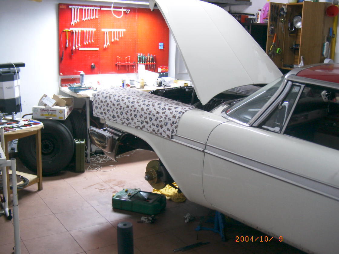

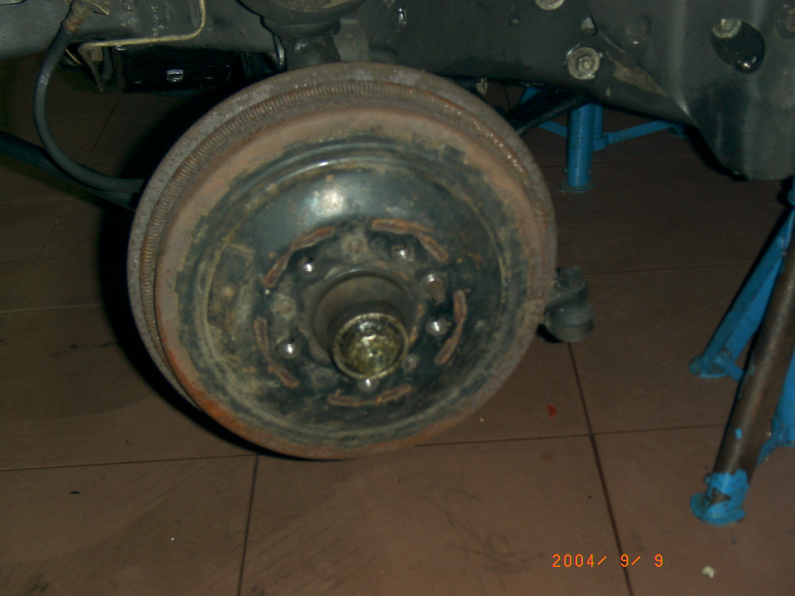

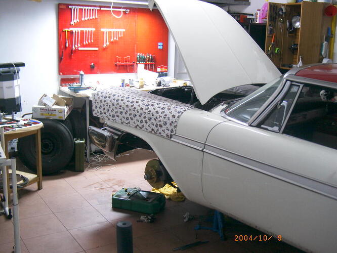

I put the car on blocks and remove the tires. It occurs to me that I worked so hard to restore the Fury to be “original” but in MY special case I don’t waste a tear on the drums. They go to stock – forever!

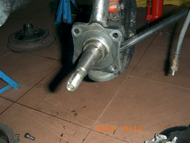

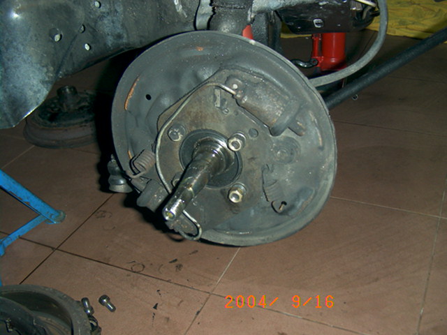

Remove the drums and the brake shoes. Than disconnect the flexible brake hose and loosen the 4 bolts that hold the anchor plate. Now you can pull out the bolts and take the anchor plate off.

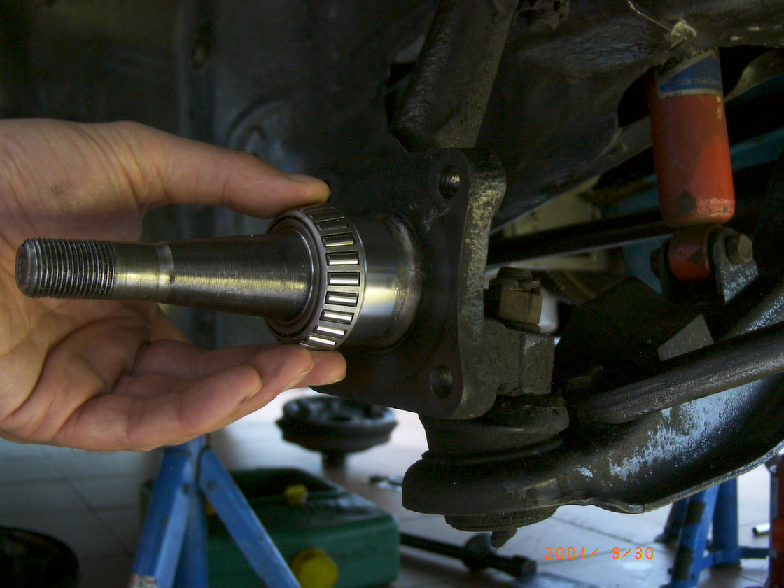

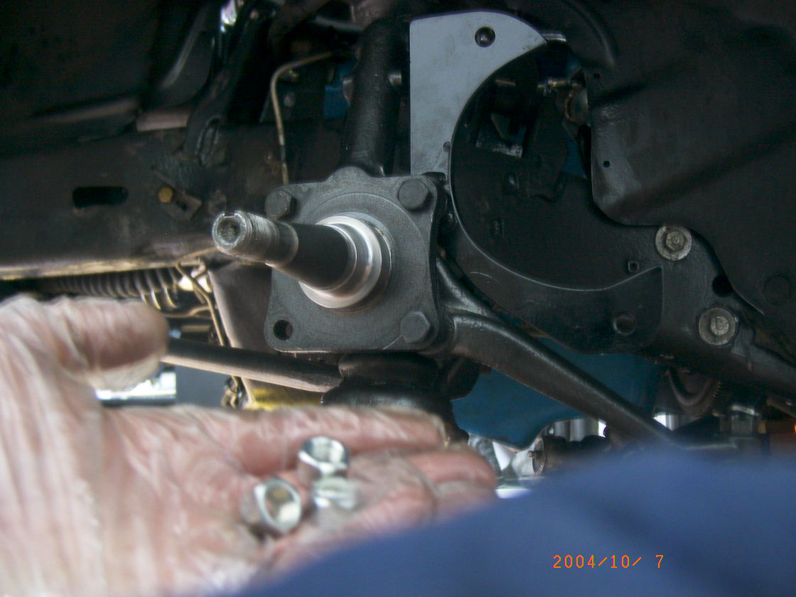

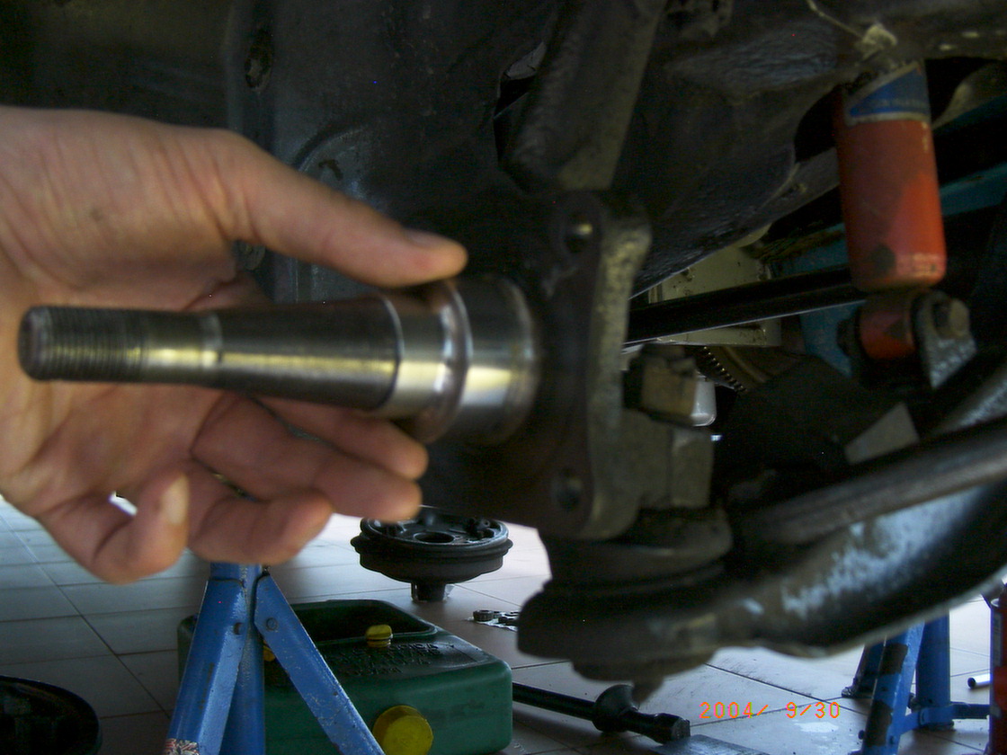

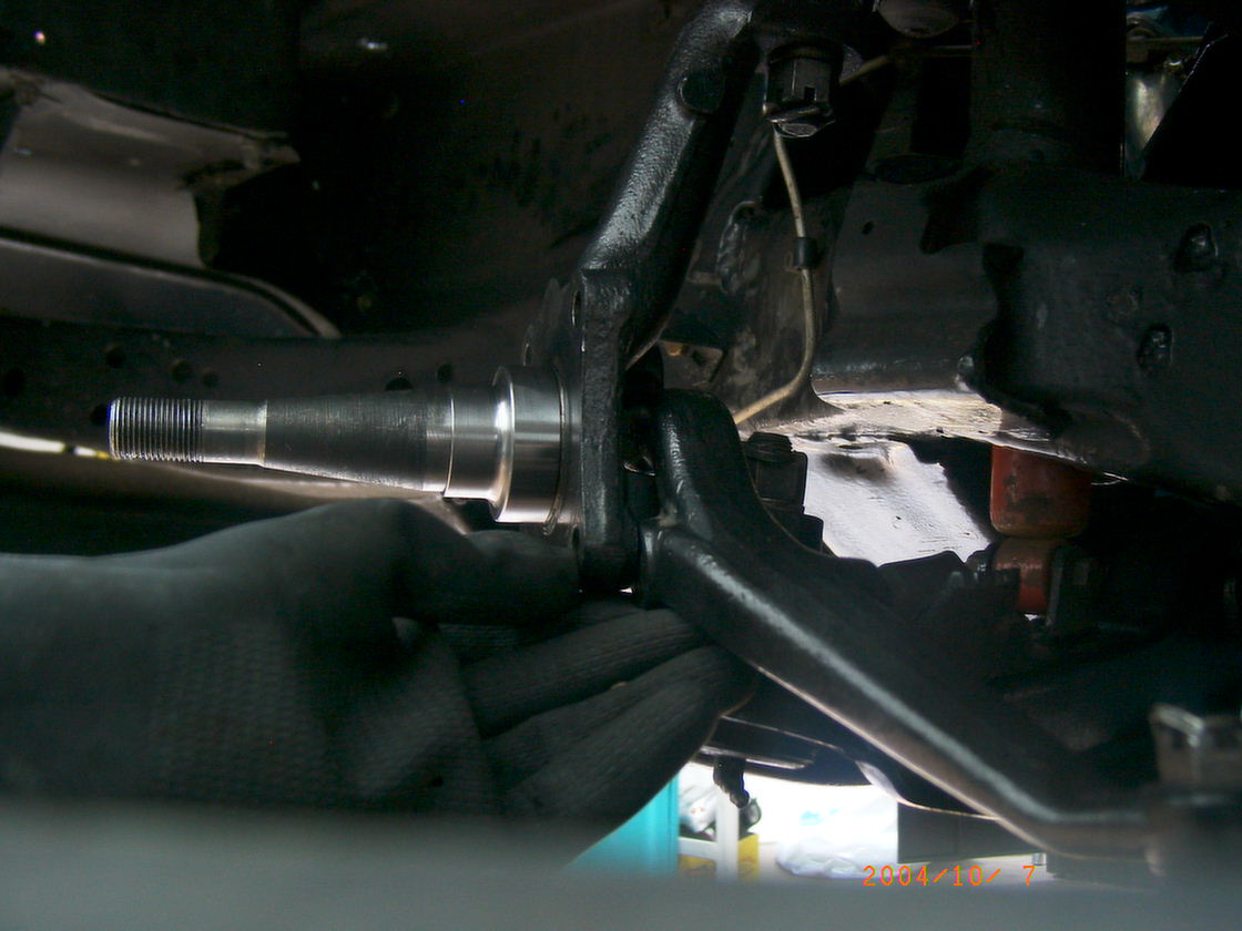

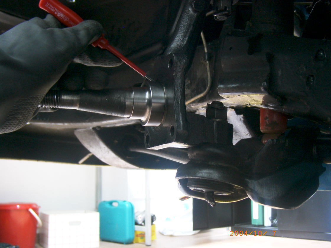

To avoid getting dirt into the bearings it’s necessary to clean the spindle from all sides, also from the back. A Brake and Clutch Cleaner spray works great here. It removes also the old grease and cleans the threads.

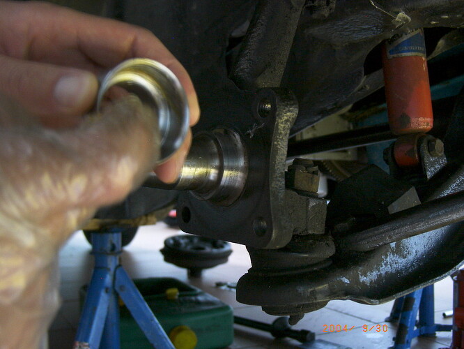

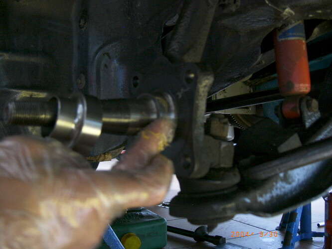

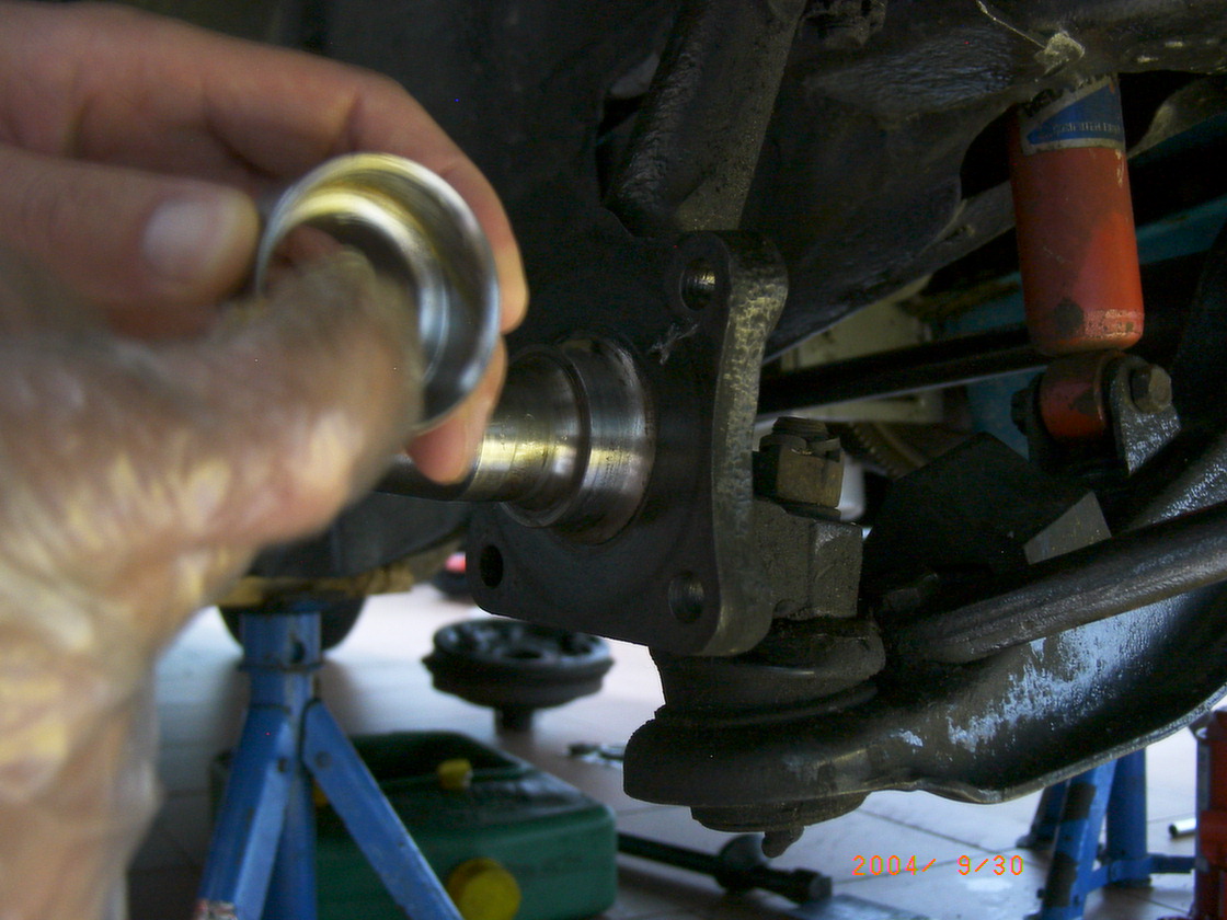

Now put some grease inside the adapter and on the spindle and push the adapter over the spindle as far as you can without force.
You will notice that there is no clearance between the adapter and the spindle and you probably can’t push the adapter until it touches the backing plate of the spindle. DON’T use a hammer, screwdriver or any other hard device now!
To force the adapter in the right position put the inner bearing over the adapter now.

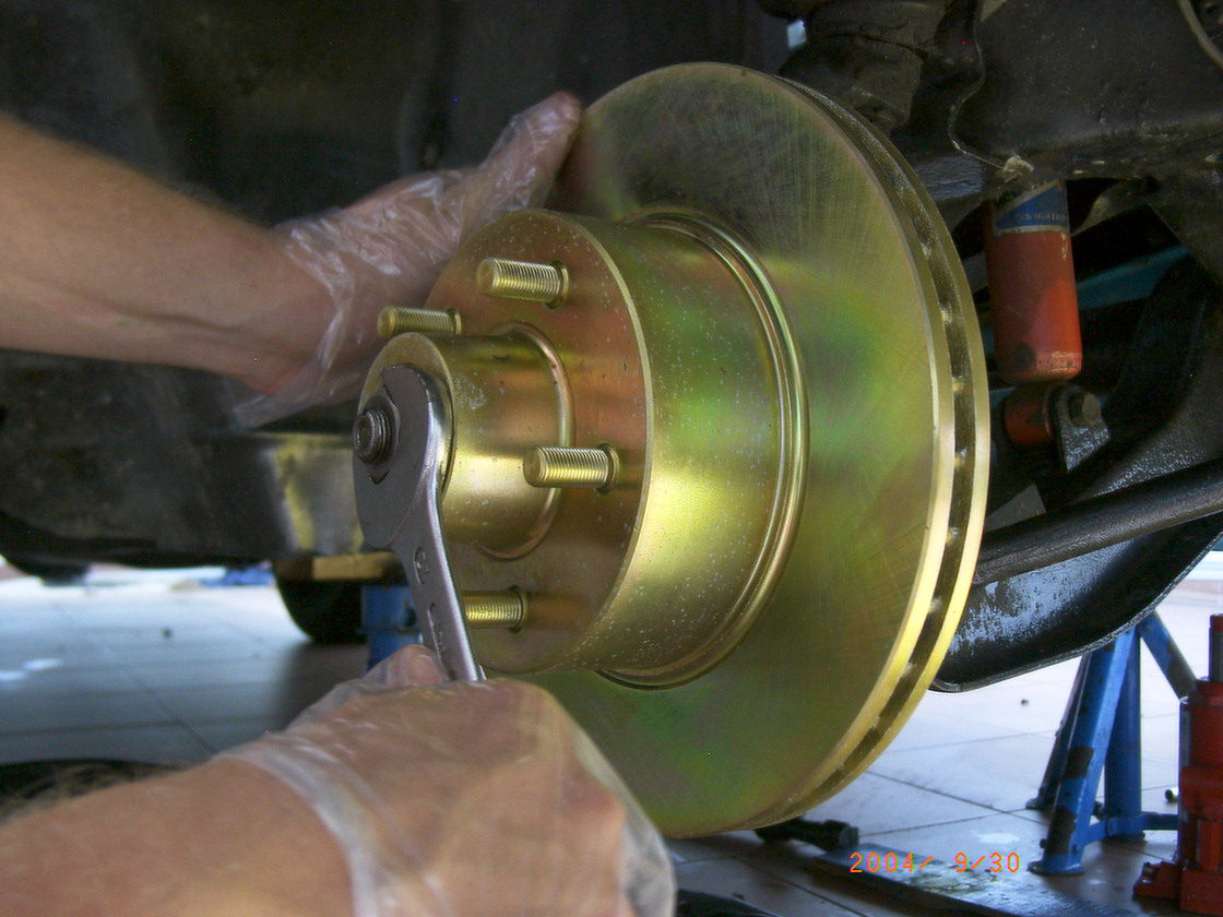

Take the disc, as it is without grease and seal and put it on the spindle with the outer bearing, the washer and the nut. (Note: the disc is yellow now, a zinc bath prevents rust)
Tightening the nut brings the adapter in position without any risk of damage.
Now, remove the disc and the bearings again. The gap is gone and the adapter is not damaged.

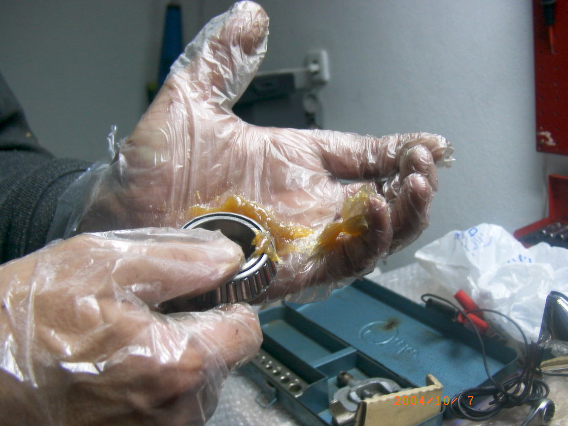

Time to grease it up! Use special grease that can stand high temperatures!

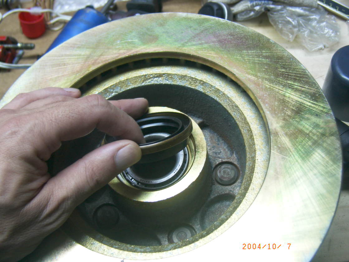

Put the inner bearing into the cup and place the seal (caution – this picture shows the wrong way!!!)
This is the right way! The seal is very sensitive, so better be careful! Use a ring over the seal to hammer it in the right position.

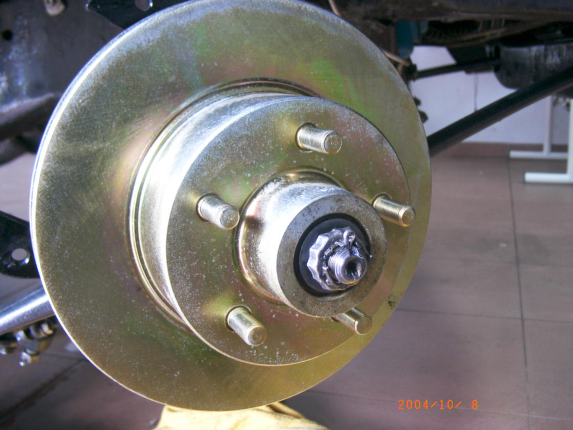

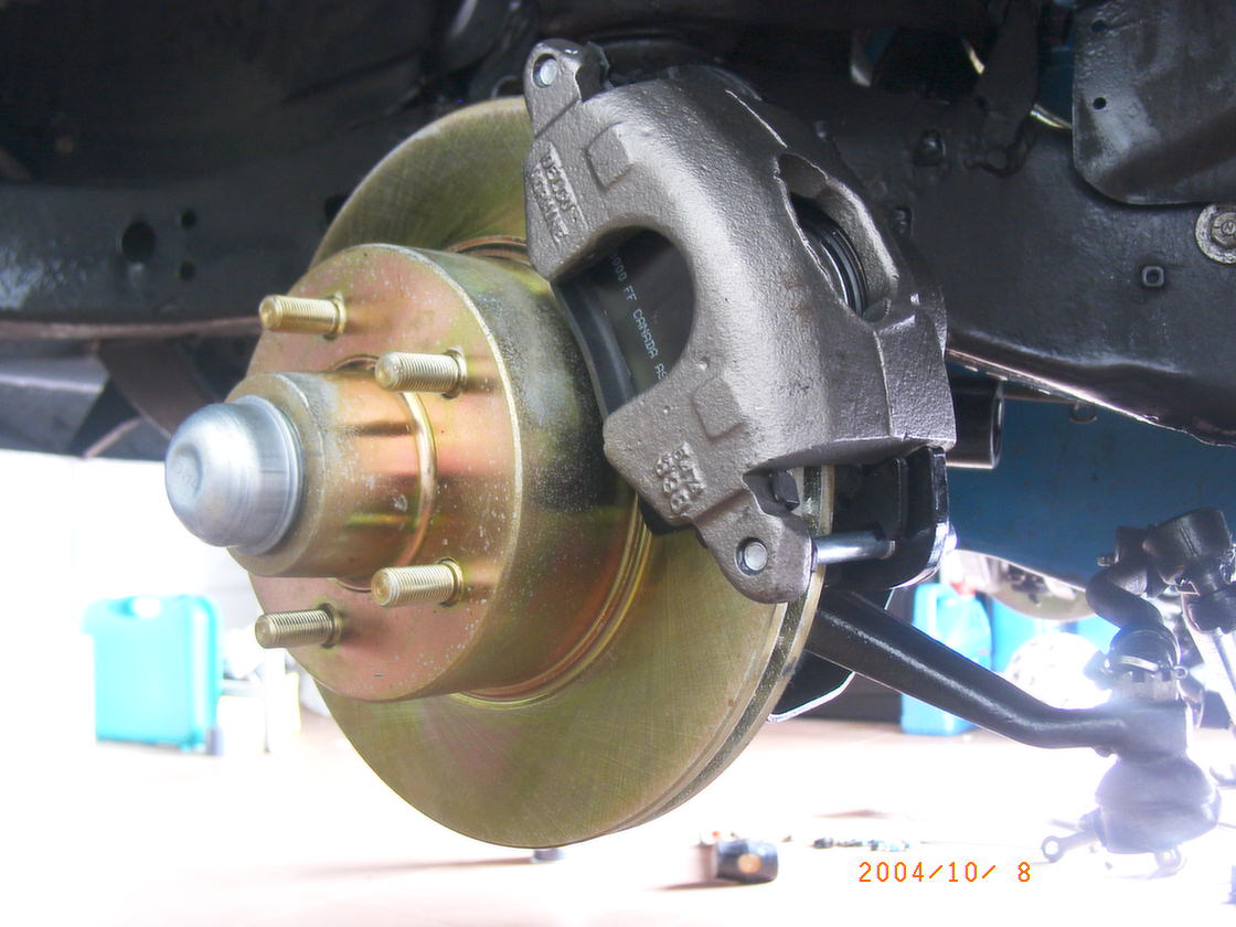

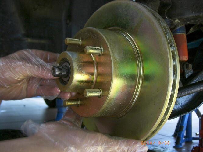

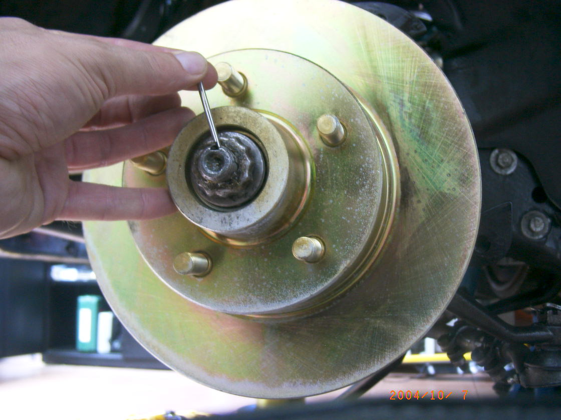

You can mount the discs now. Use the original nut, washer and “crown”. A new cotter pin is in the kit.
One side is almost done. Now I do the other side.

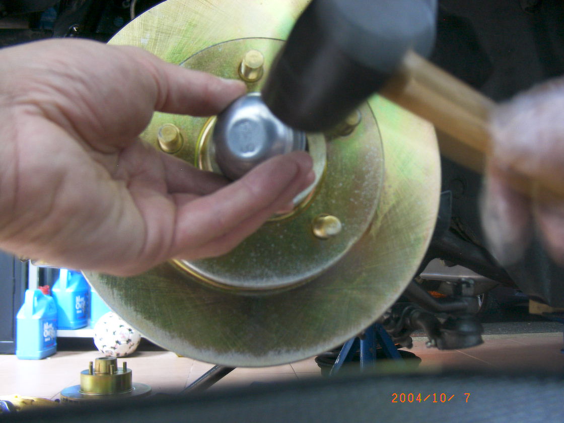

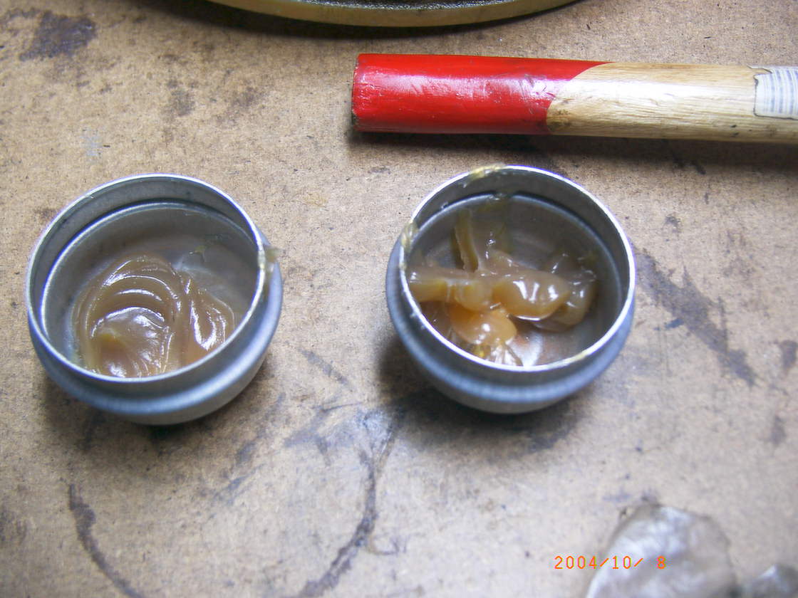

Some grease in the cups and…
that’s it!
Now, it’s time to mount the caliper. Due to the grease I’ve used before I cleaned the discs with Brake and Clutch Cleaner spray and changed the gloves.

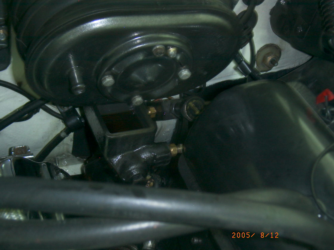

Before the MBC can be installed the push rod grommet of the original master should be installed. The grommet delivered with the kit is too small. Removing the air pressure tank of the PS-unit gives a free access to place the new brake lines.
With the push rod screwed completely back the MBC can be installed.

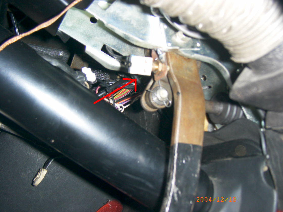

A front outlet is provided for the brake light switch, but it doesn’t fit in. Either the thread on the brake light switch or on the MBC must be reworked.
Another possibility is to close the outlet and install a separate brake light switch that works without hydraulic pressure on the brake pedal. I already did that some years before due to the fact that the stock switch needs a certain minimum pressure to work and is not adjustable. Also it is not very reliable and I had to change two of them in one year. The manual switch is adjustable and works immediately when you hit the pedal.

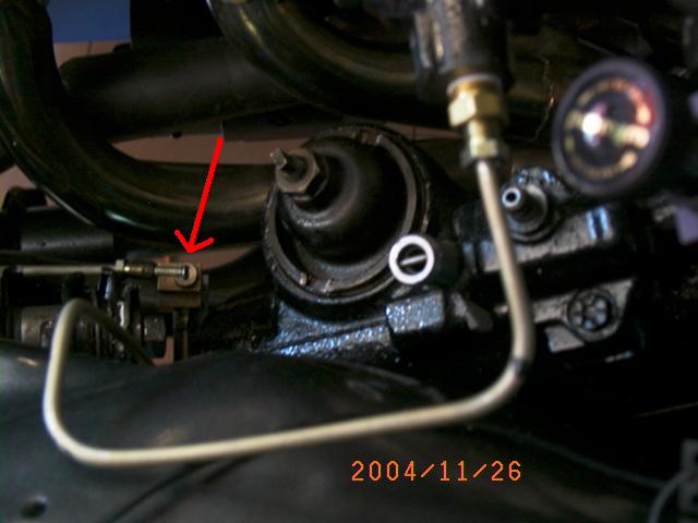

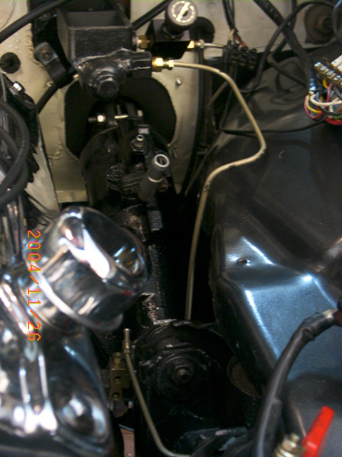

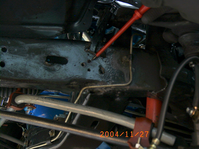

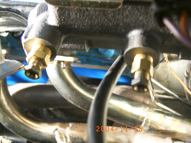

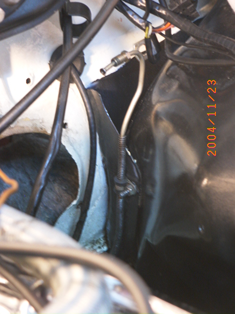

The brake lines can be brought in position now. I decided to start with the rear circuit. Due to the headers in my engine compartment there was no better chance except to fasten the original brake line like this: I had to overhaul the PS-unit so removing it was no extra work for me.

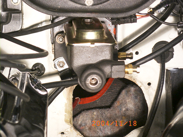

Proportioning valve is installed. I used a brass connection with a double thread between the MBC and the valve. Now the MBC works as a bracket for the proportioning valve.
The outlet for the front circuit is very close to the air pressure tank. Consider that when you seek a place for the lines.
Front circuit to junction block. The former intake of the junction block is bigger than the three outlets. The kit contains a plug to close the intake (red arrow). I used the outlet of the former rear circuit as an inlet for the new front circuit. – Works fine!

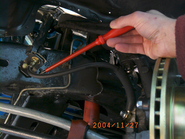

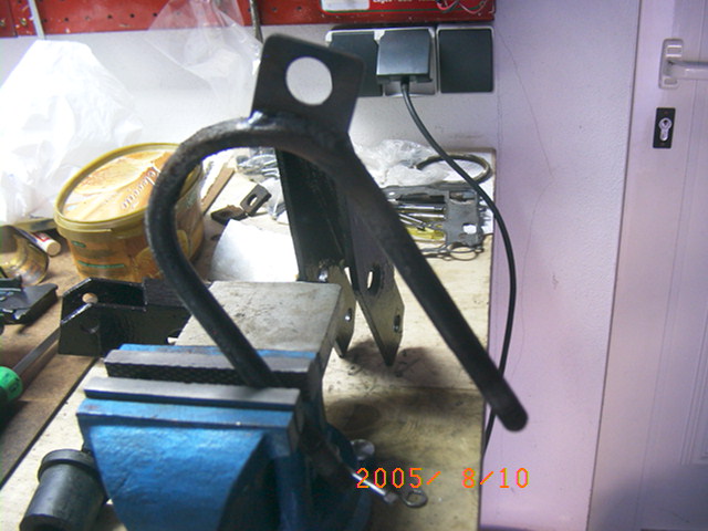

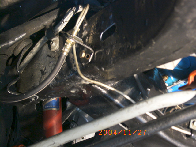

The flexible brake hoses are installed, but the bracket bent the hoses too much. It doesn’t look very safe to me!
I remove the bracket and…

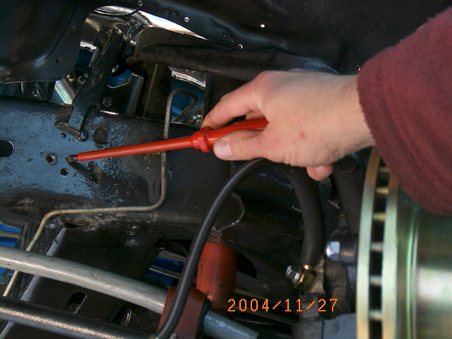

… drill a second hole about 90 degrees above the first one in the same distance to the center hole.
This looks way much better now and allows the brake hose a free movement without being bent to the limits. A new brake line can be prepared now
Special brake line tool helps a lot, but the neck of a Coke bottle does the same!
Do the same on the right side of the car, the difference being the hole is drilled 90 degrees under the first one.

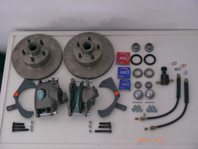

Finally the package arrived. Heavy stuff, and it cost a small fortune to ship to my place.

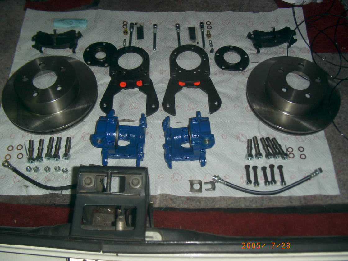

Check all parts – is everything there?

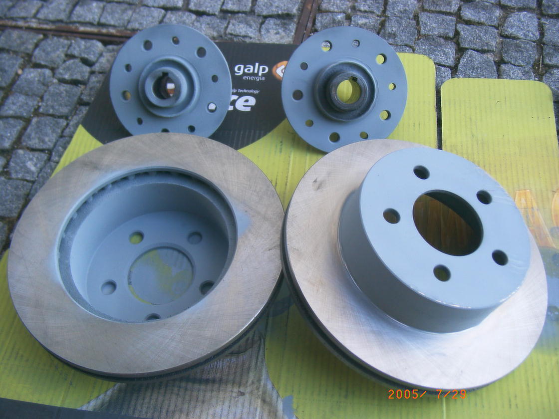

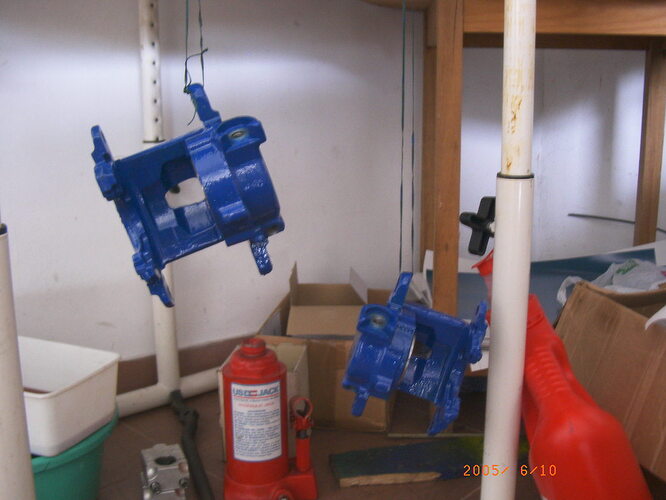

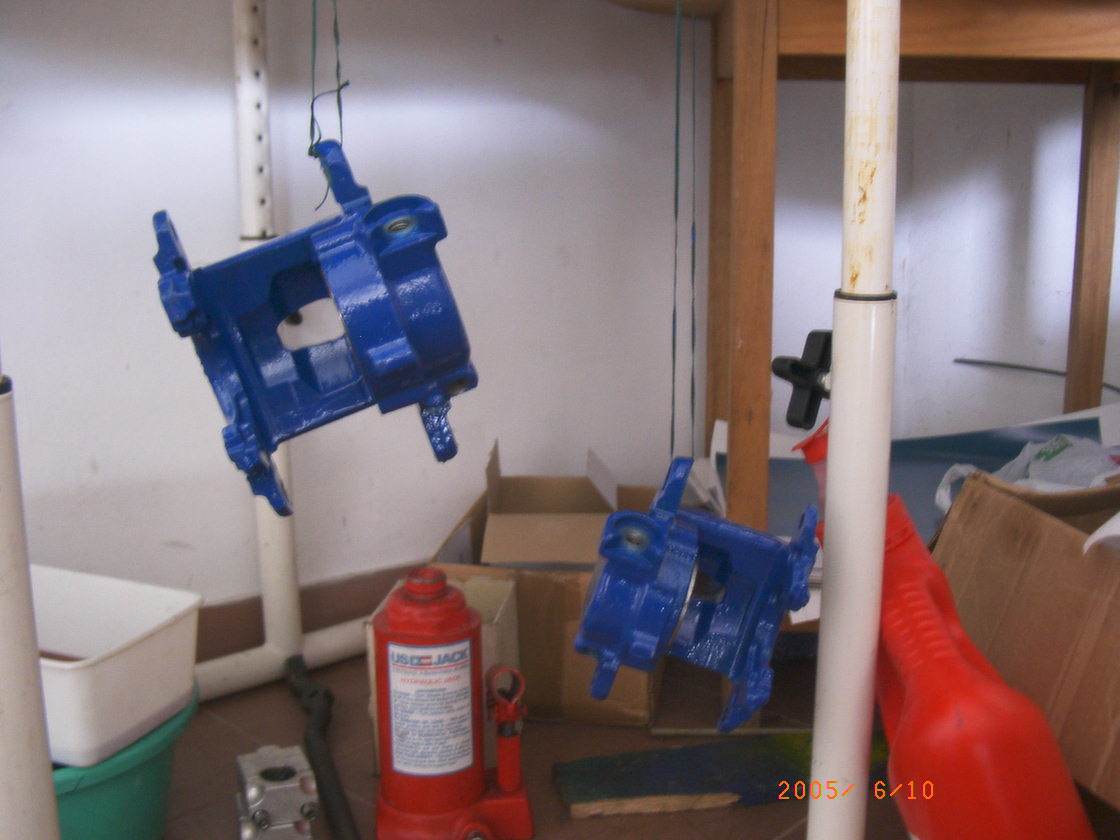

Well this time I’ll try to be smarter. The callipers are painted before installing…
…and the rotors receive a zinc coating to prevent surface rust.

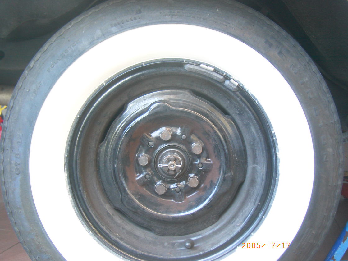

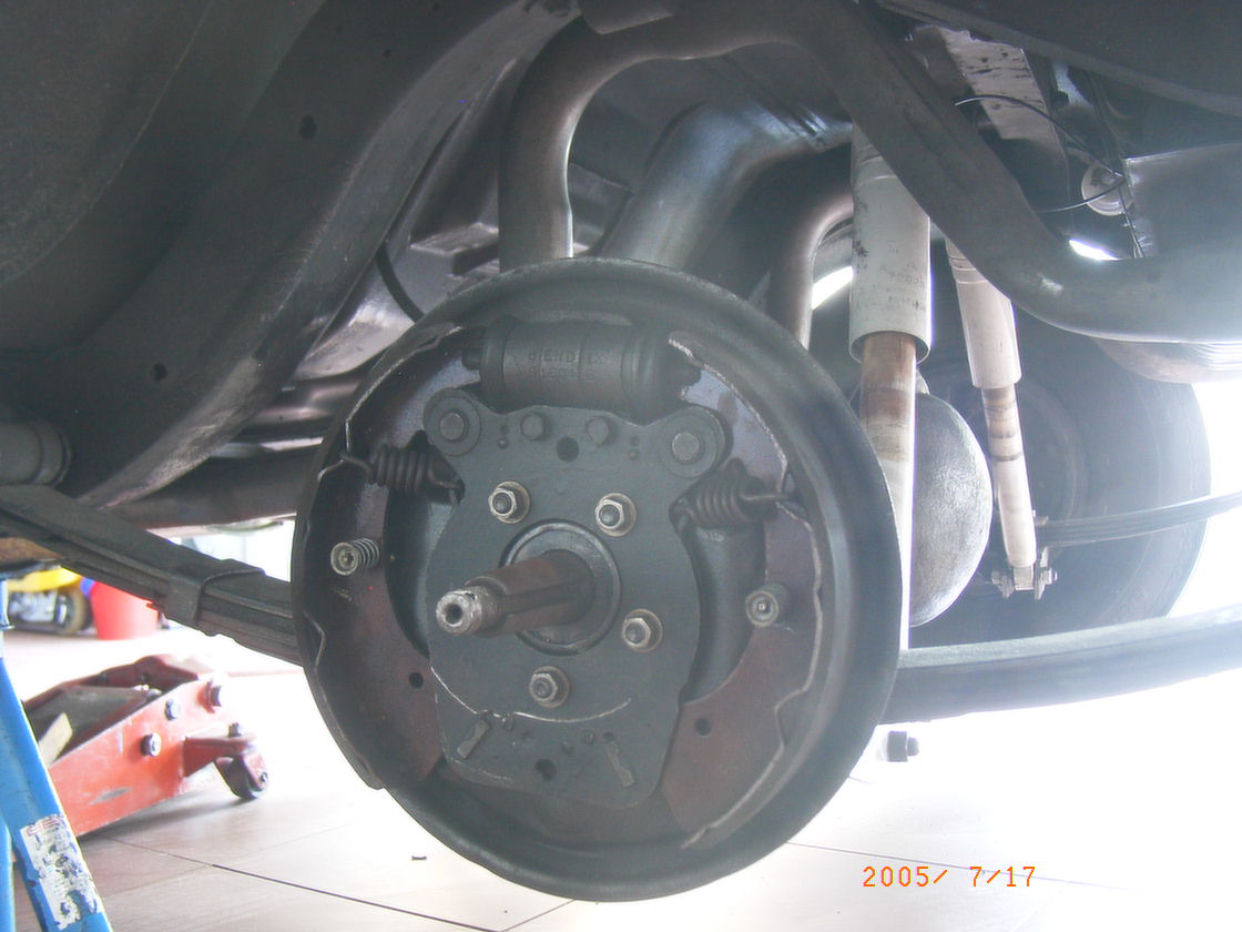

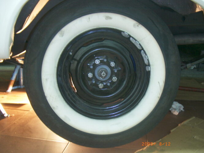

Let’s start to work. The rear axle and a historical moment! I expect a considerable improvement of brake performance and less vibration.

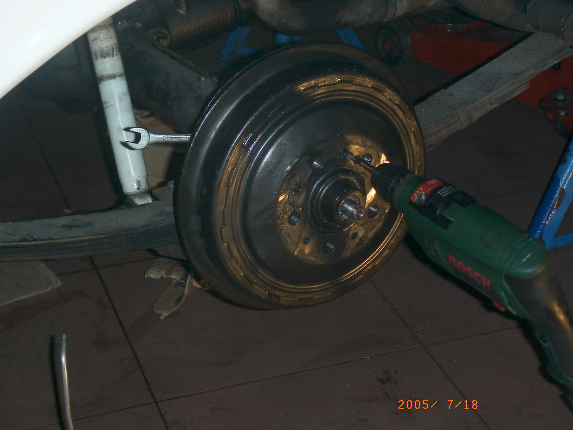

The brake pads are fully attached to the drum, so the drum is tight. With a drill I try to place the hole right in the middle of each rivet in order to not damage the hub.
Then I hammer the rest of the rivets out and remove the drum.

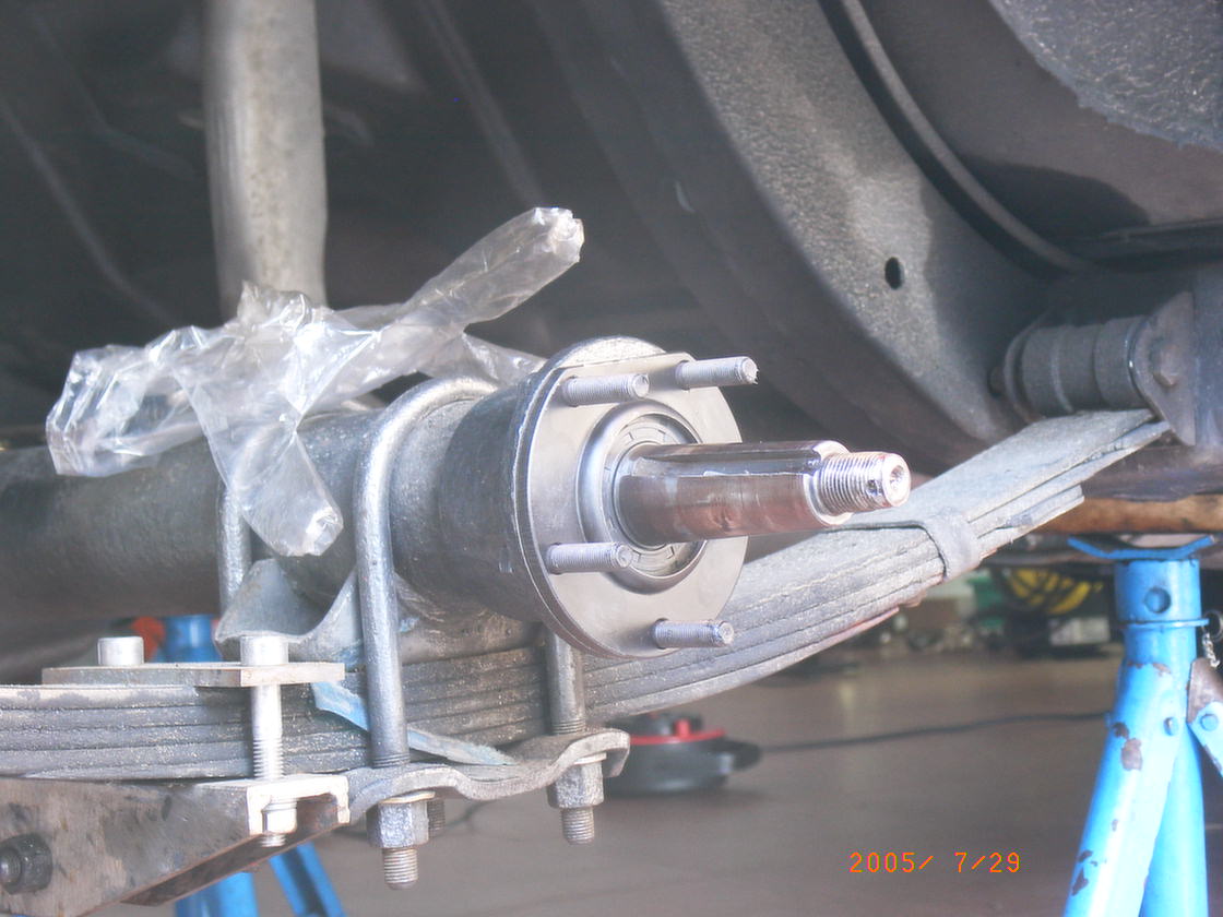

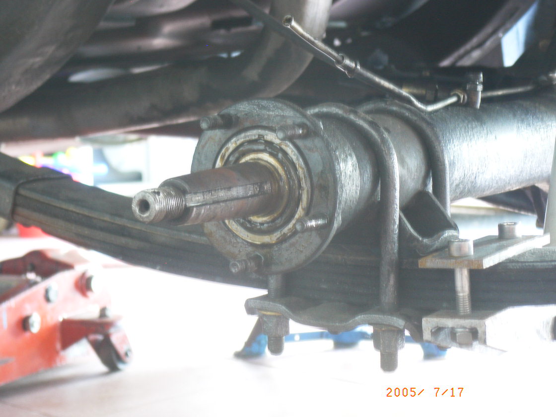

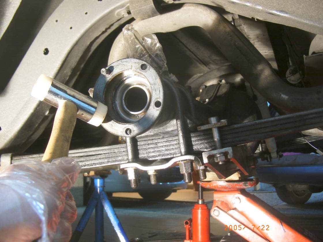

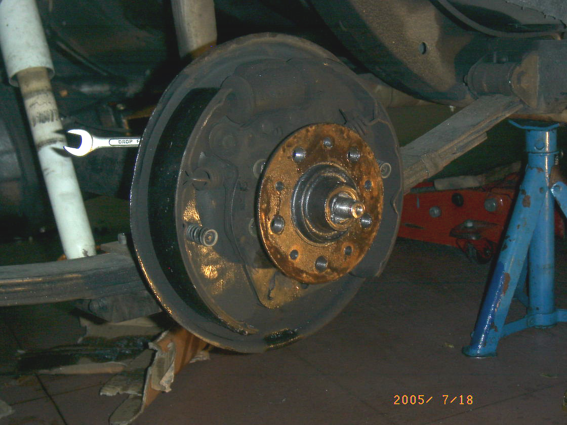

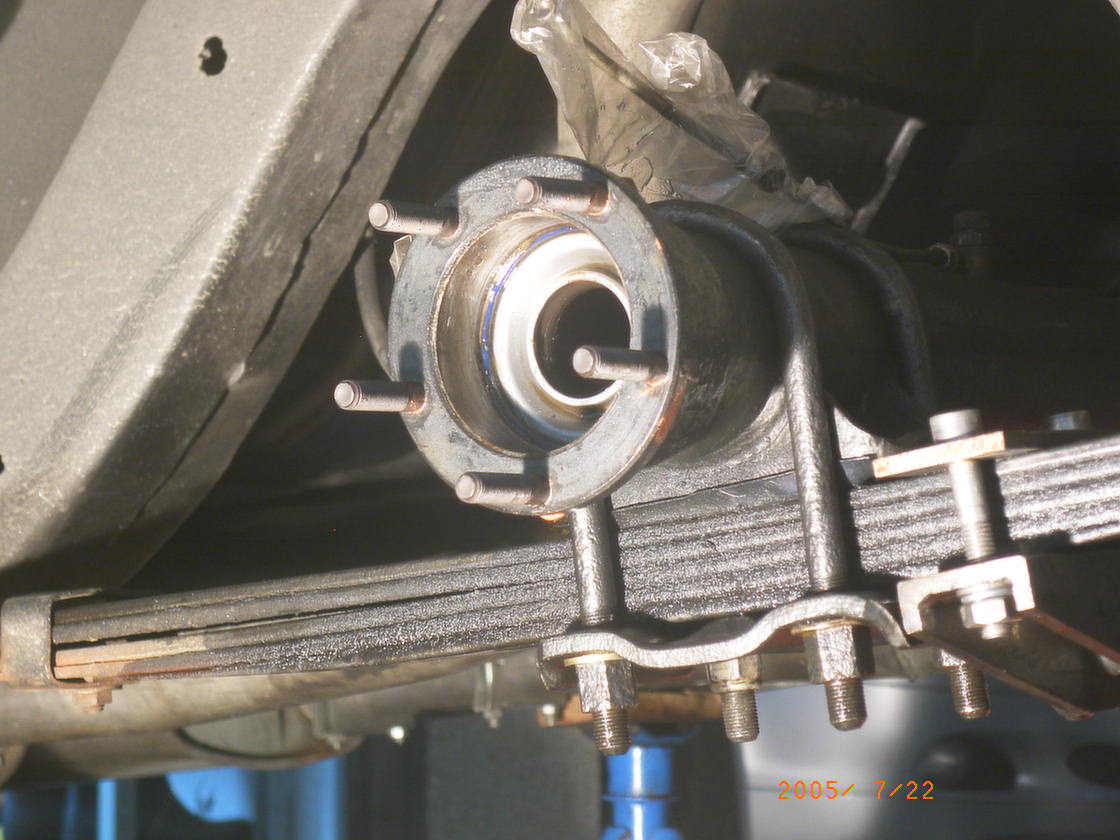

Next step is to remove the hub…
…as well as the backing plate and the brake lines.

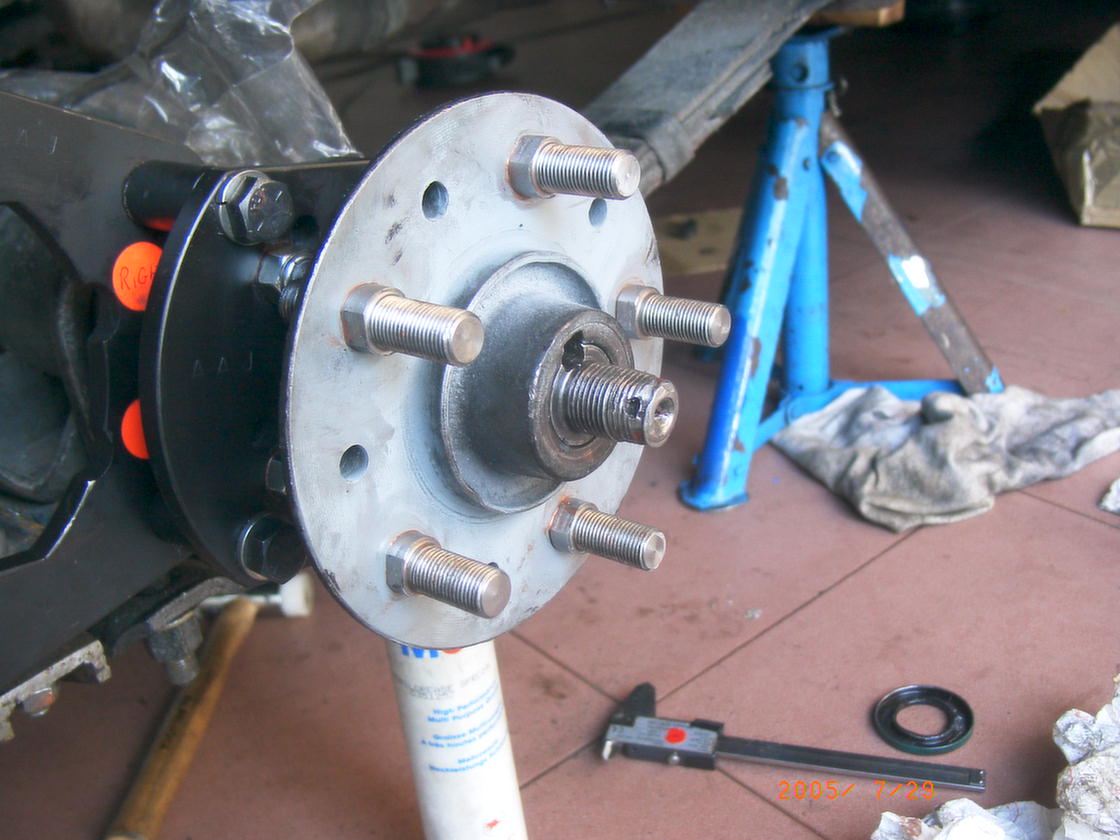

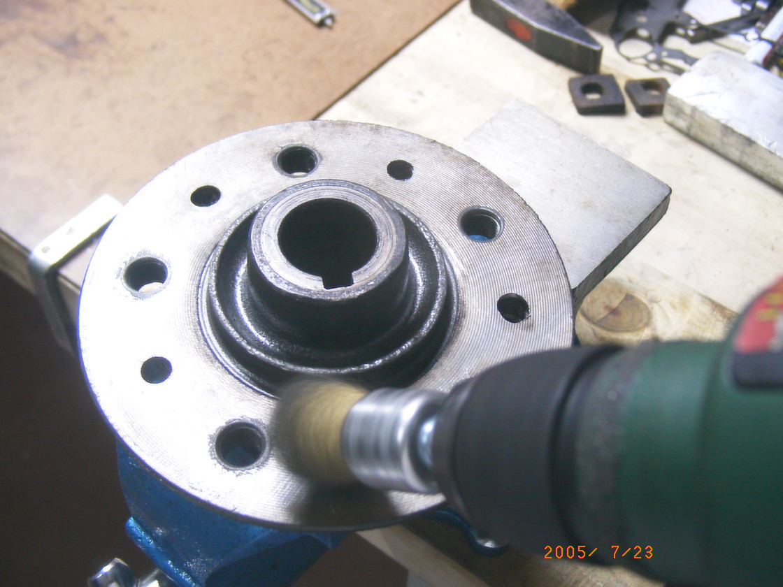

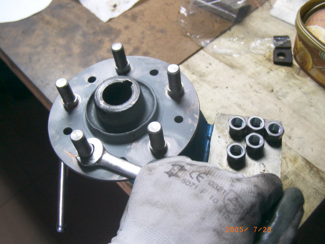

The outer surface of the hub becomes rusty very quickly. I cleaned it with a brush and spray it with zinc-spray.

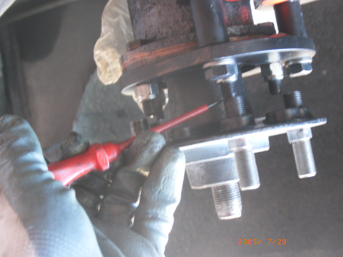

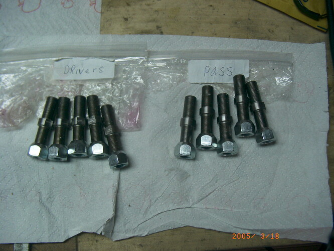

Also the lug bolts may be installed now.
Everything is set now – goodbye, left thread!

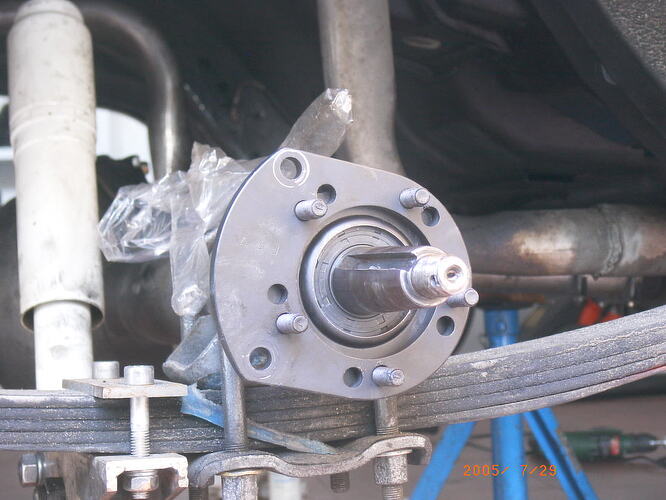

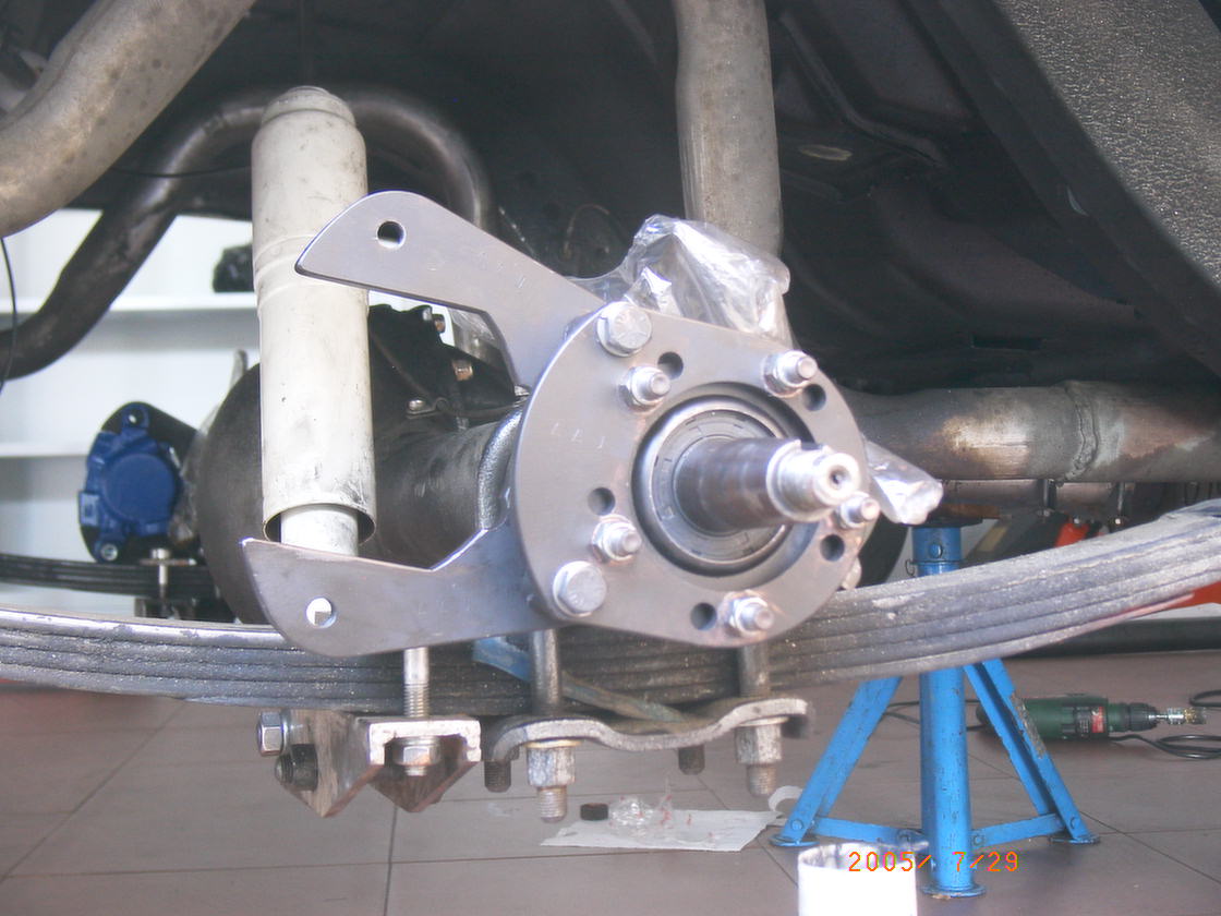

The original bolts of the backing plate are punched out…
…and replaced with the longer bolts from AAJ. (It’s not necessary to remove the axle shaft, as shown here; but I still had to do some other work to do on the differential.)

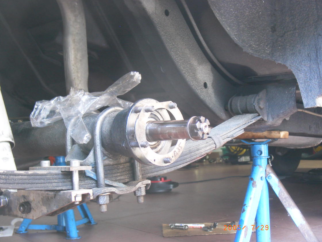

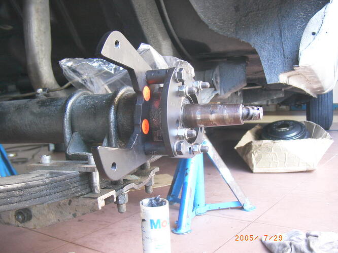

The spacers will be replaced as they have been removed before. Don’t forget them!

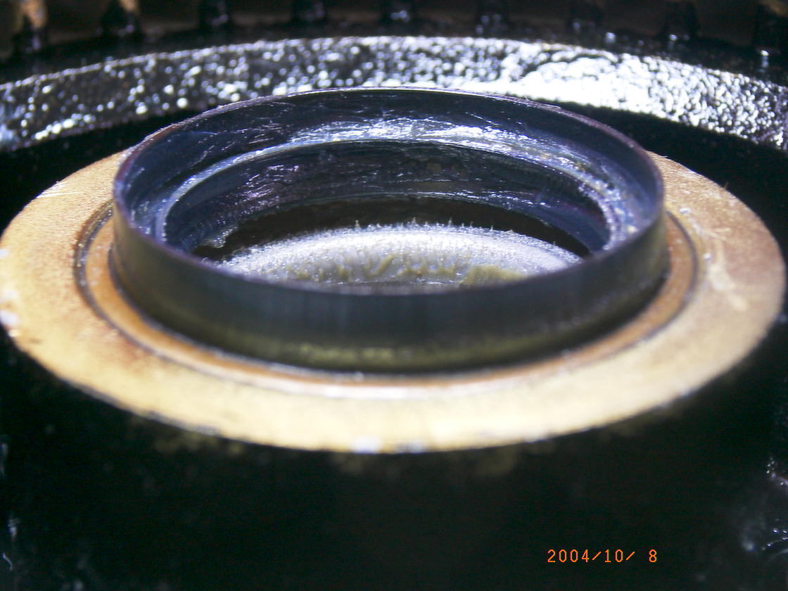

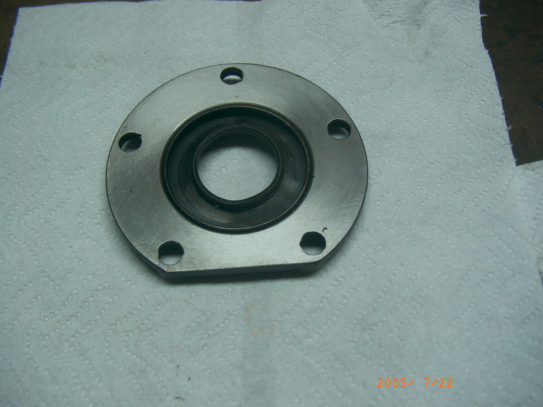

The dust seal carefully placed into the plate…
… and the plate slips onto the axle shaft.

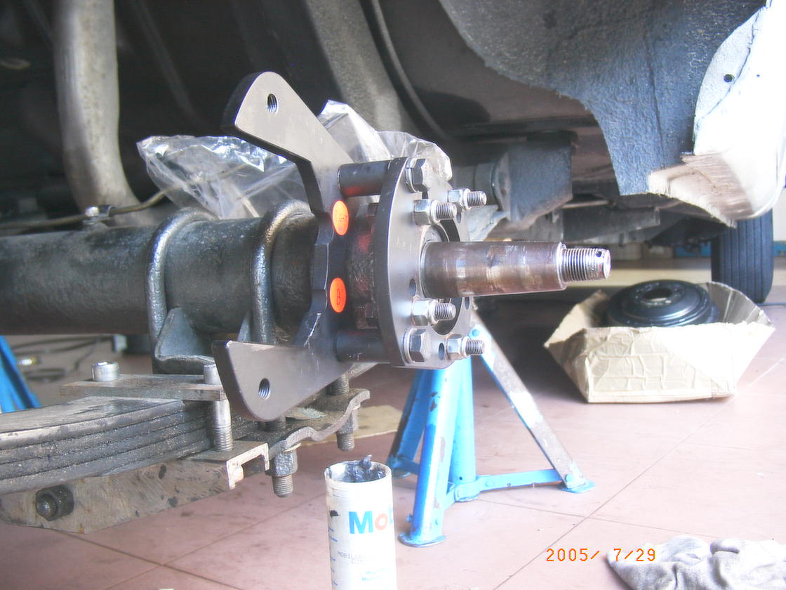

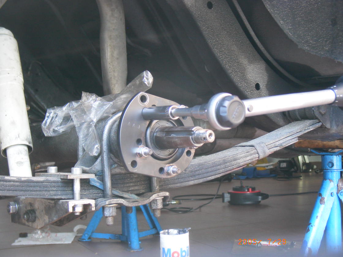

Now the first piece of the bracket is mounted and…
… tightened with a torque wrench.

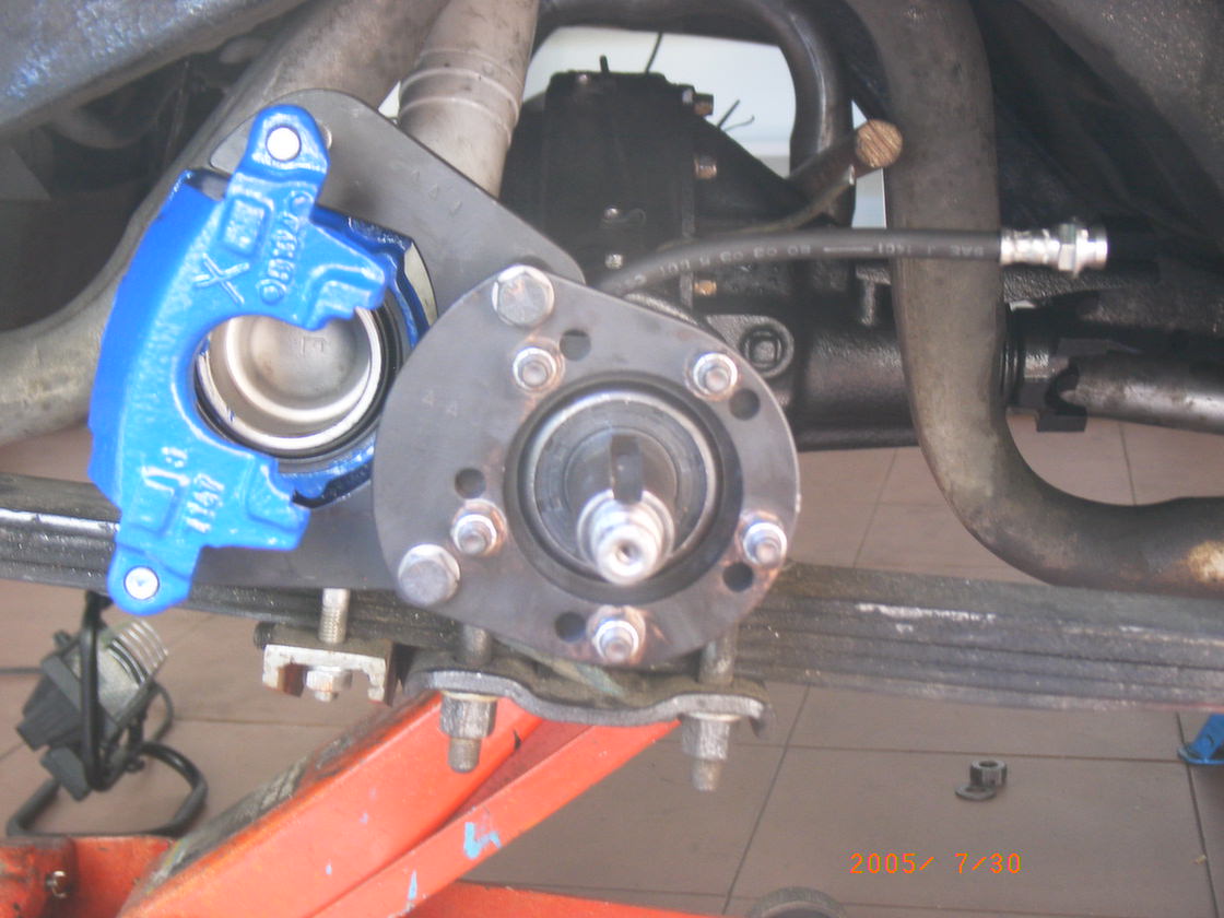

The second bracket holds the calliper.
Another point of view. I used Locktite on these bolts.

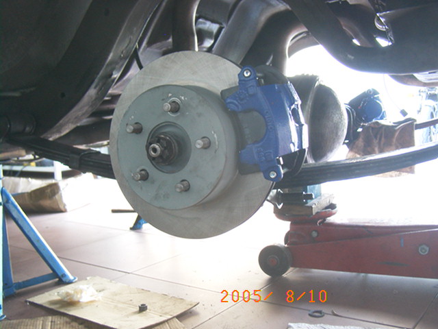

With the calliper installed, ready for a test.

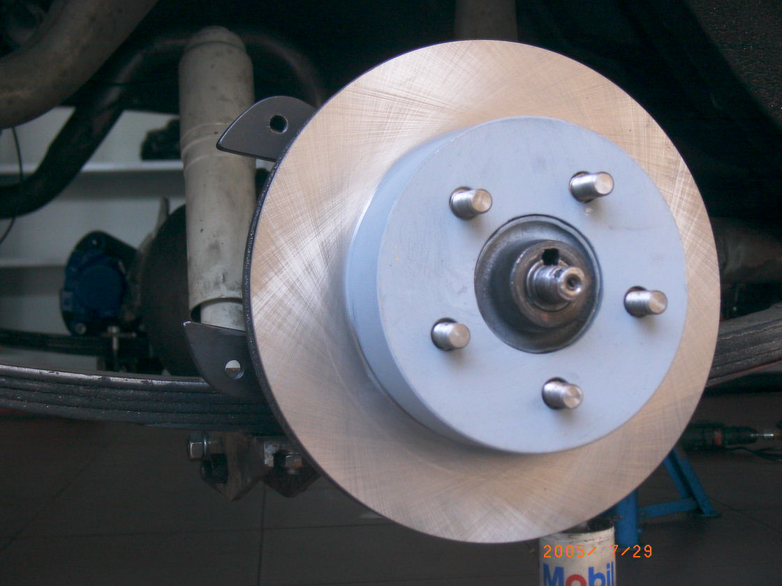

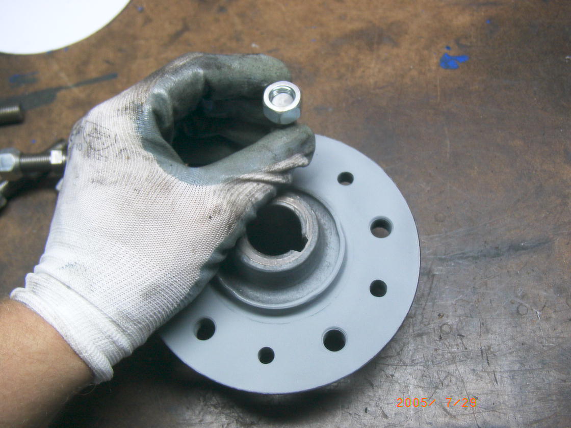

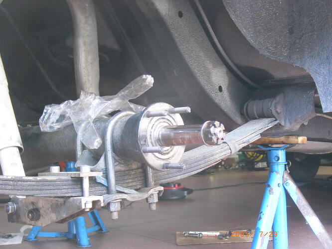

Hub on the axle shaft.

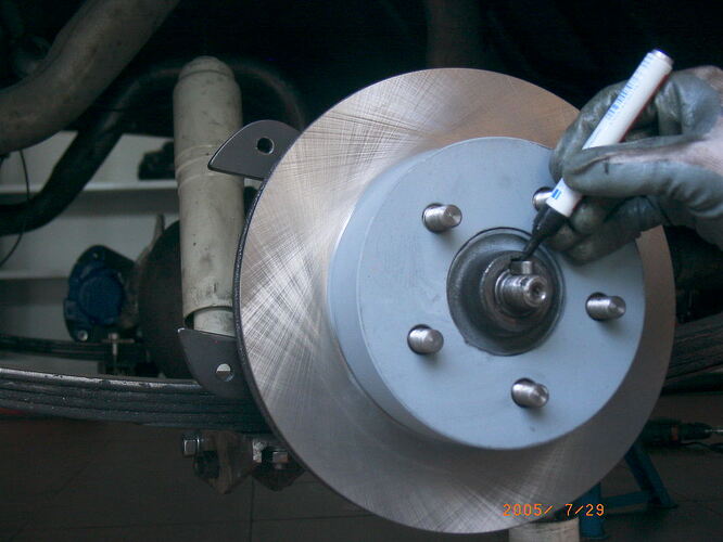

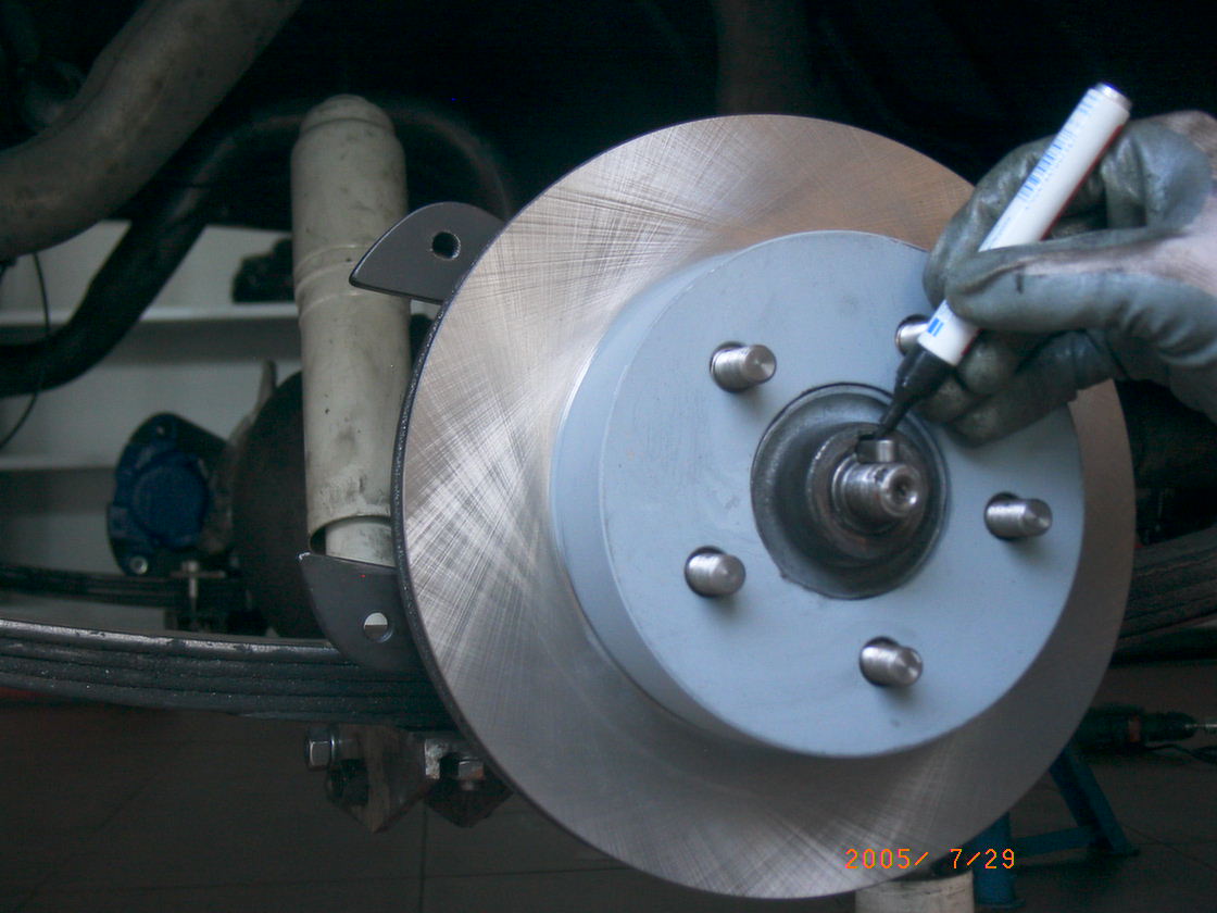

The disc is placed onto the bolt…
…and a new key is used.

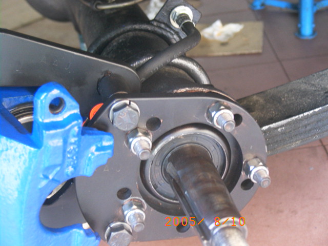

This little shim comes with the kit. It holds the brake hose in place. I decided to weld it onto the axle U-bolt.
Everything installed, all bolts checked, brake lines attached (left side again shown here).
And almost ready to go, except…
Same procedure as last year.
