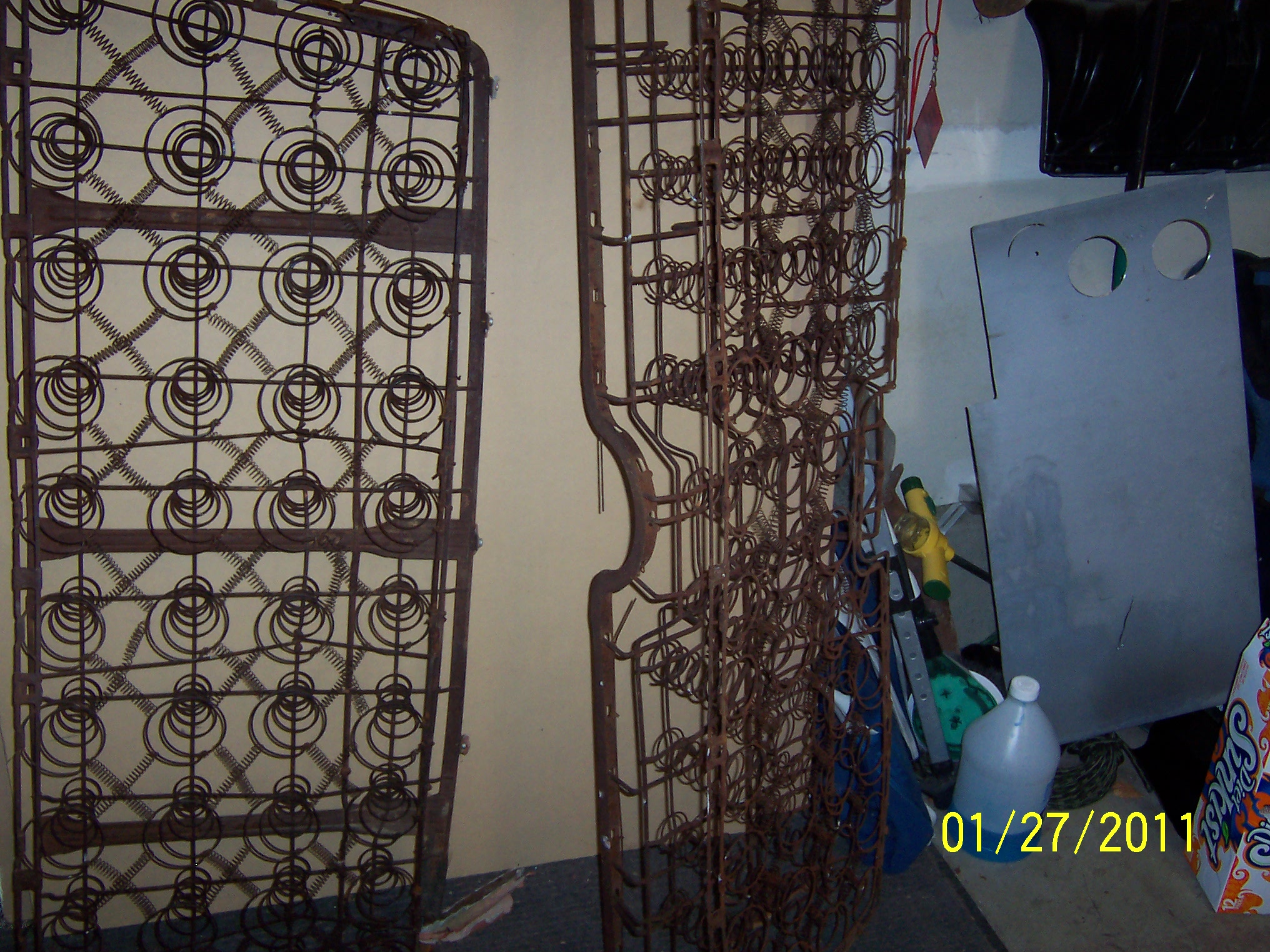

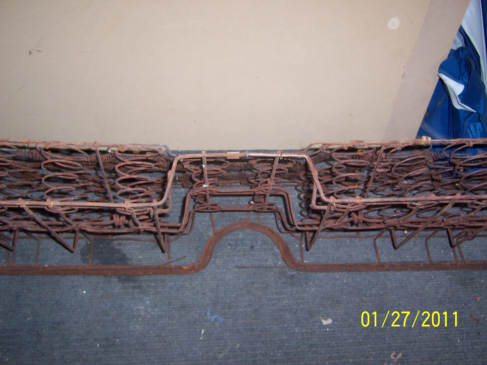

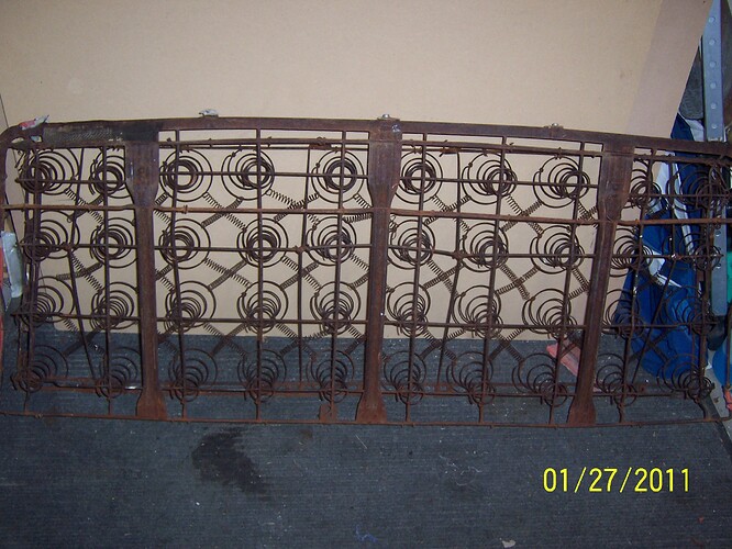

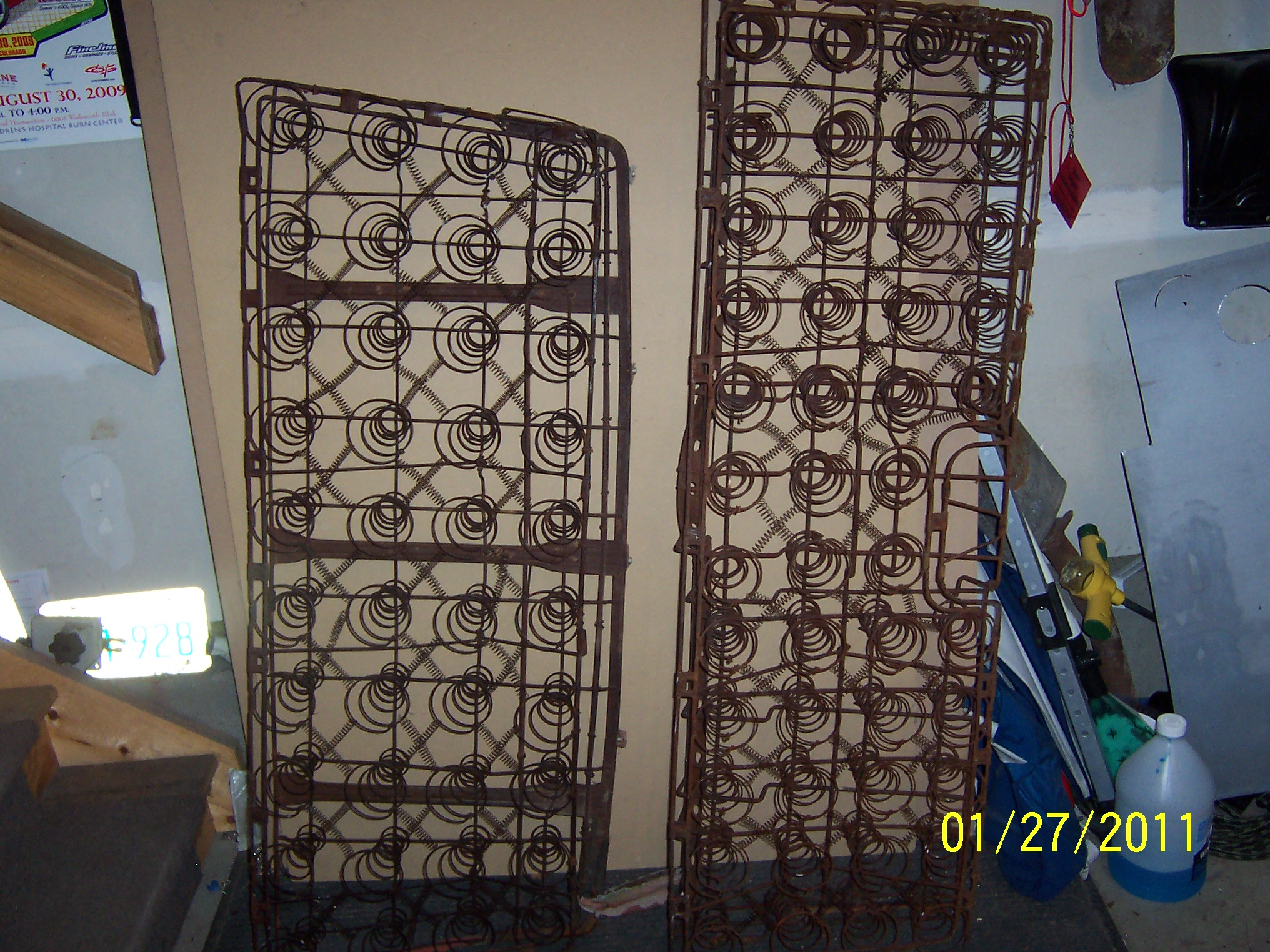

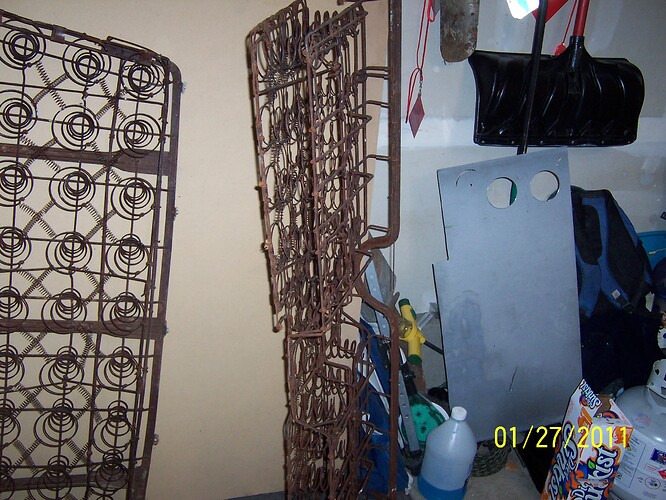

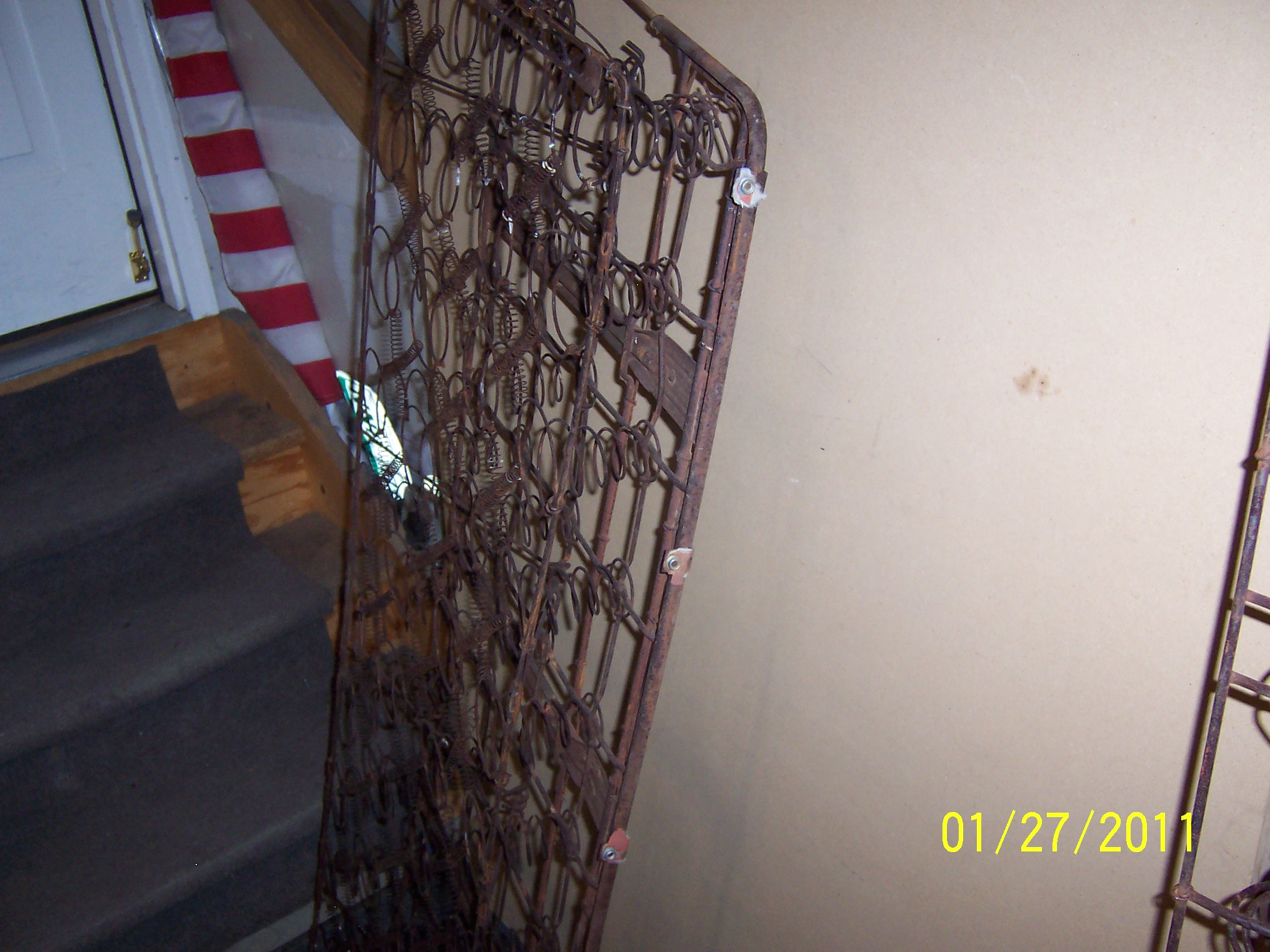

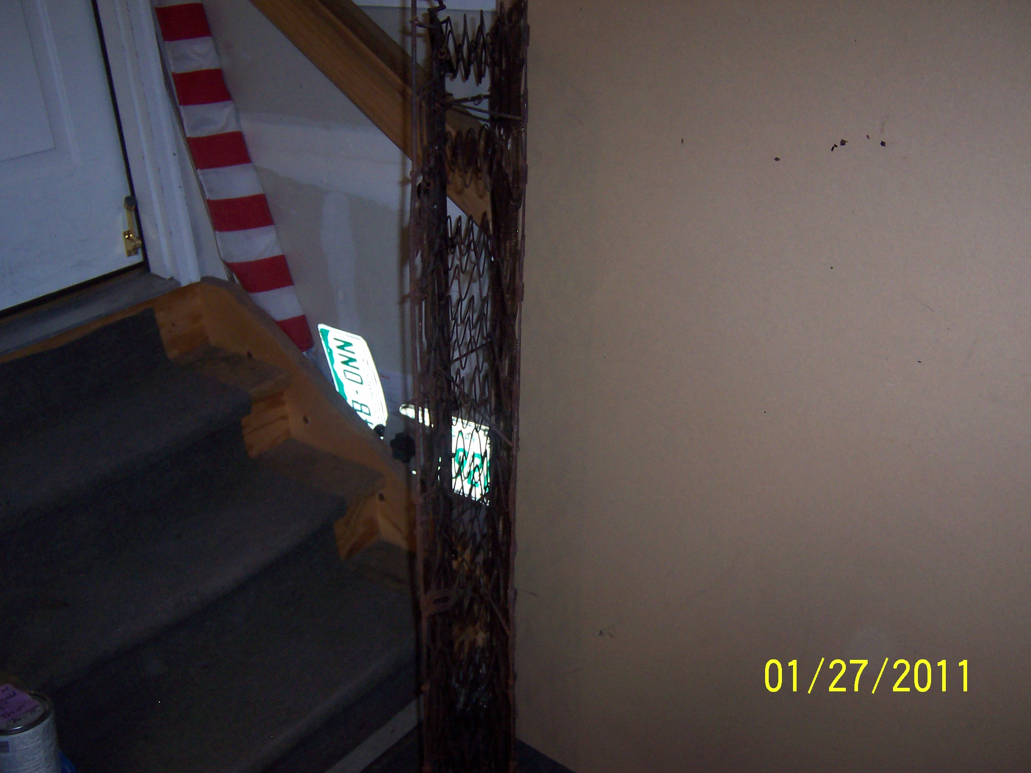

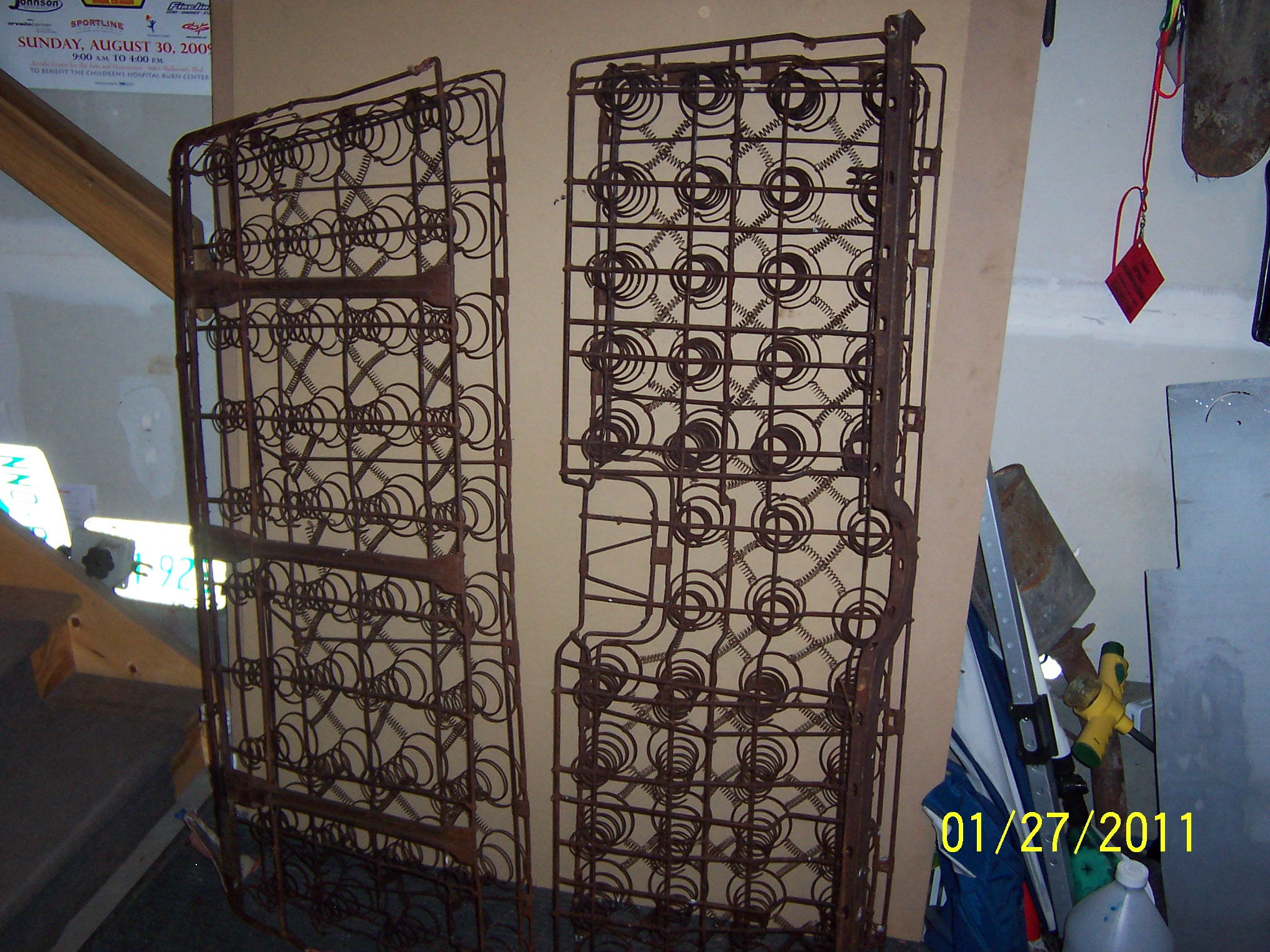

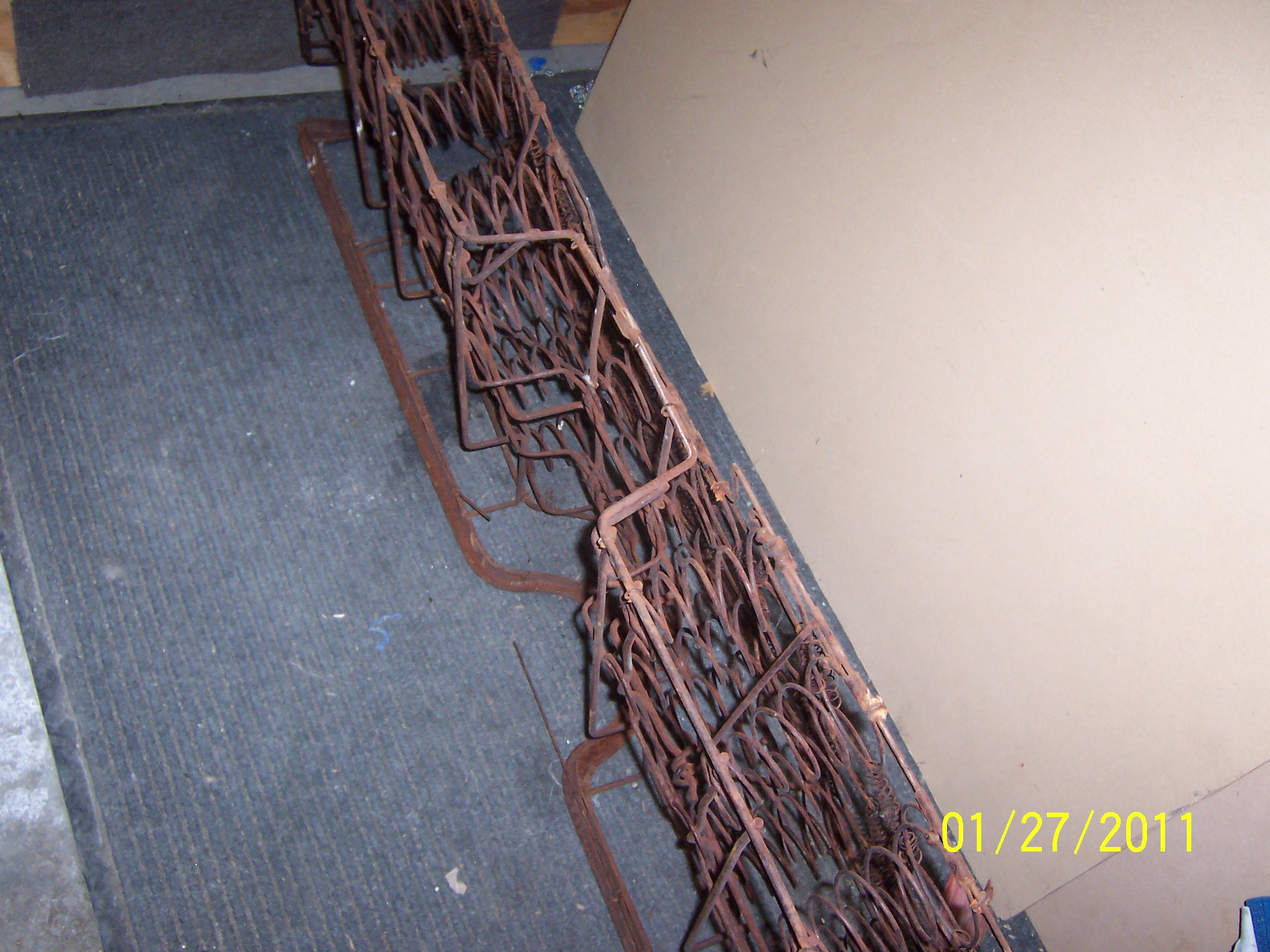

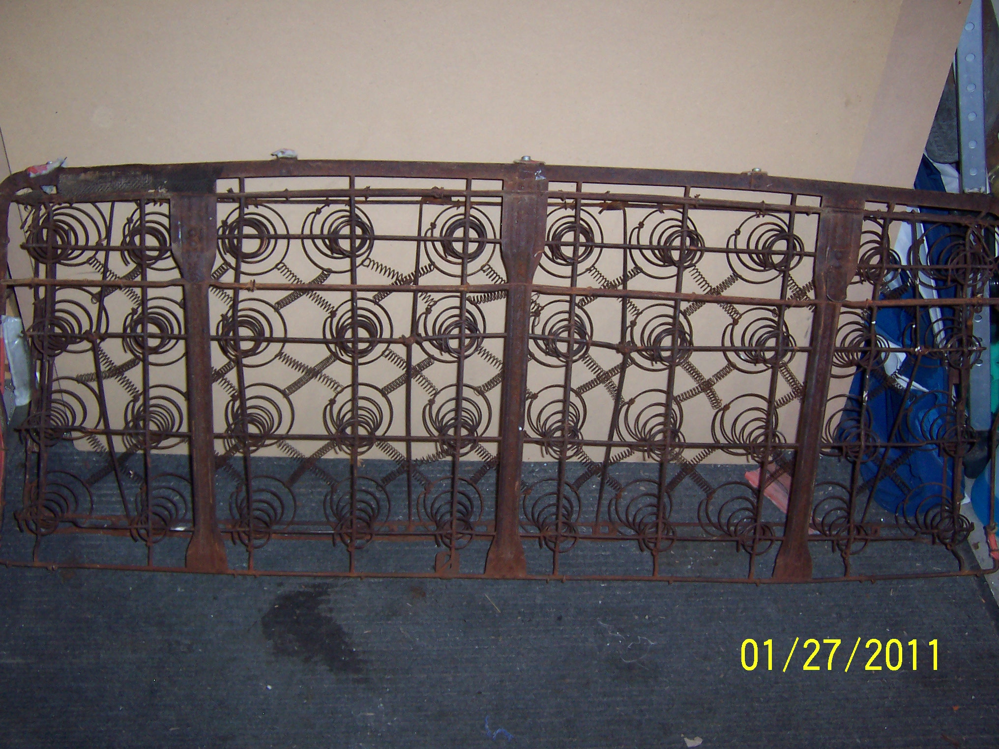

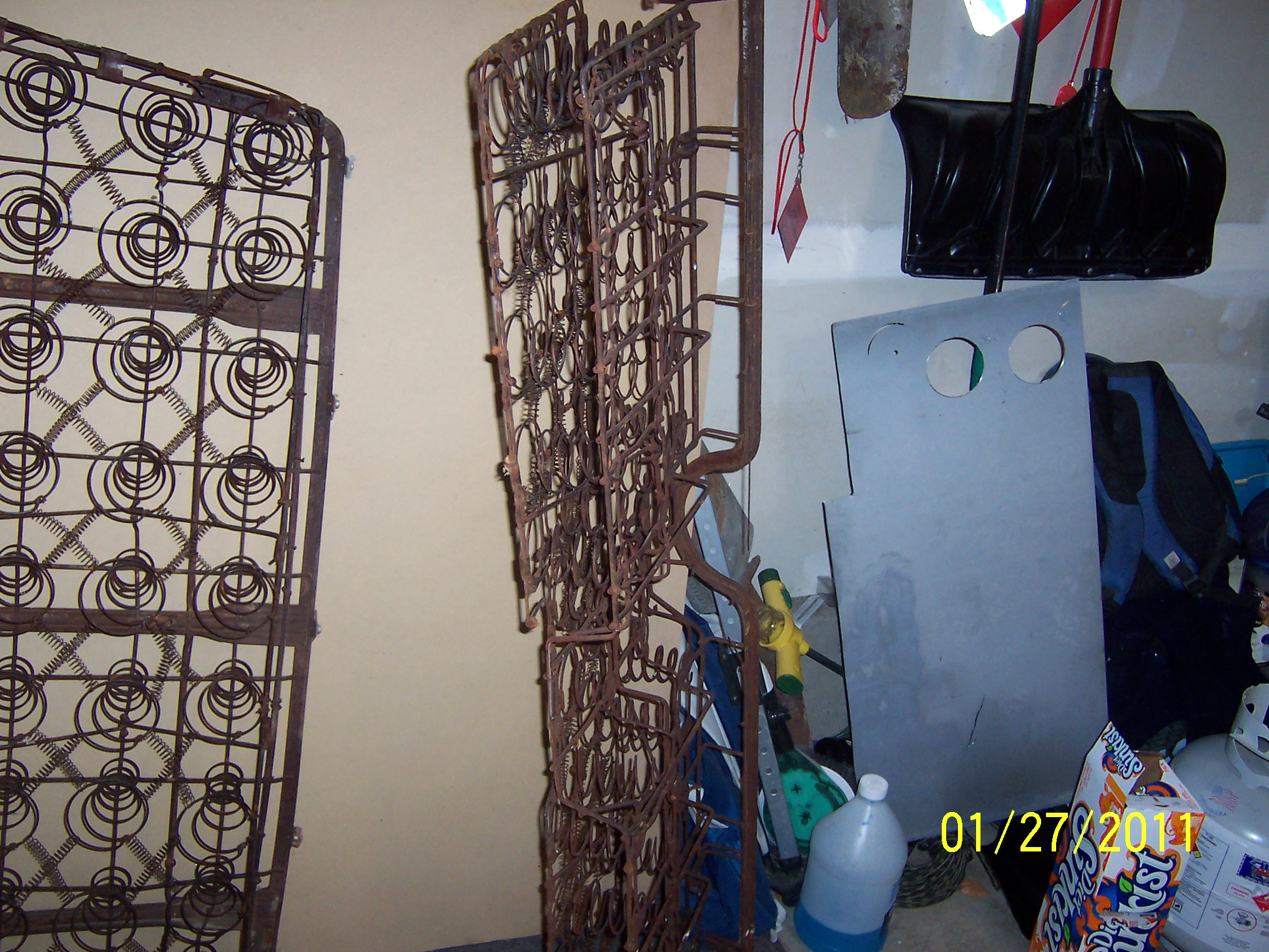

Ok, Dug them out and took the pictures in my Garage. Hope they help!
If there is a particular angle or view of any of the two pieces, let me know and I will zoom in on that part.

Compare John Q’s Picture #1, springset on the right,
with Dick’s Pic #21 of springset. There are differences. I hope they fit!
If John measures the overall length of the seat he has, and compares that to John’s, he’ll have a better idea of the chances.

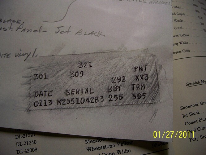

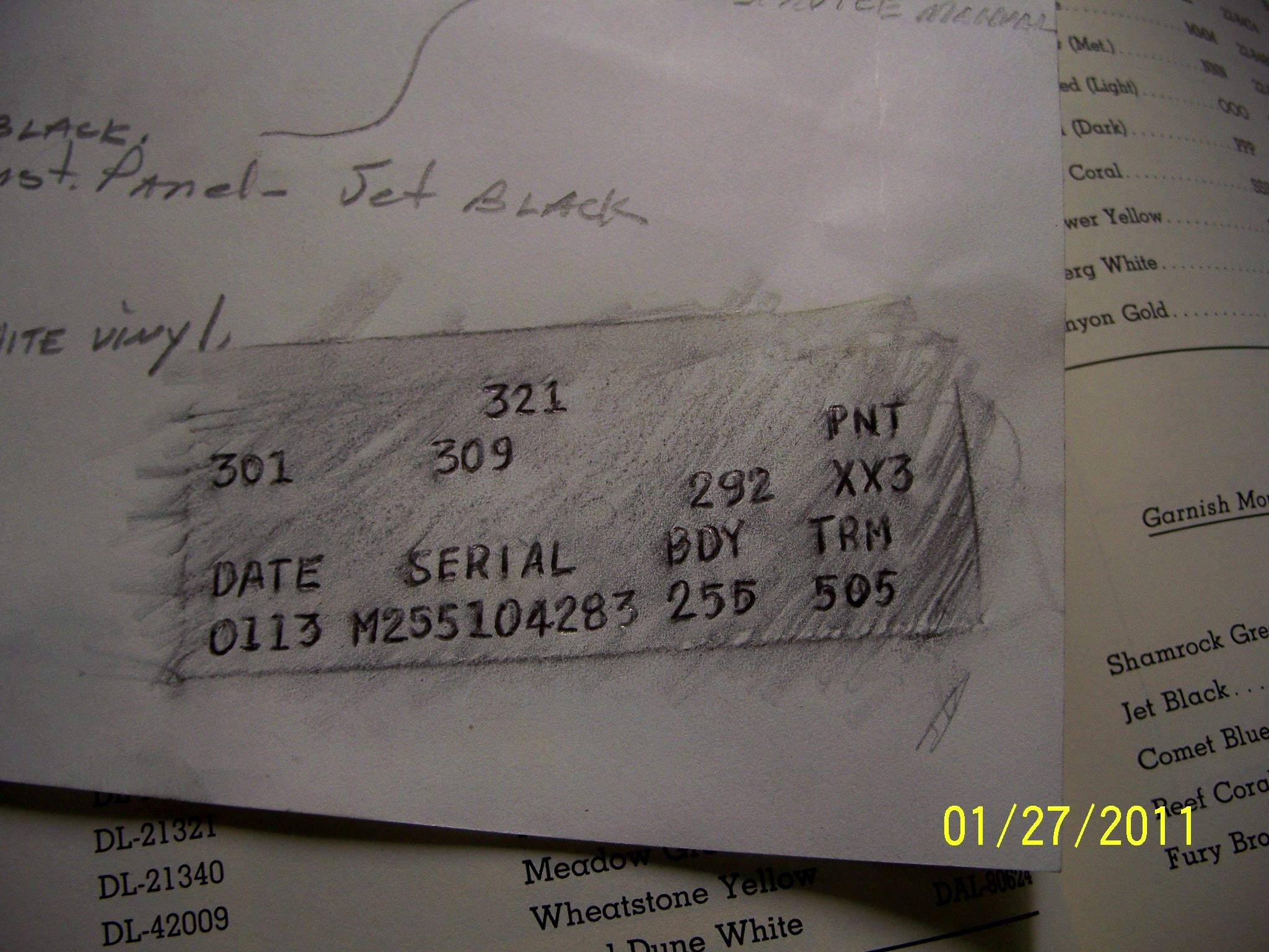

OK here is the tag info. I was in Hypoluxo, Fl about 15 miles south of me several months ago. There is a Car Museum there with a 59 Red SF Convertible that is absolutely Georgeous. I remember seeing a tag on the firewall but none on the cowl or door. There were two small holes on the cowl and mine has the two holes also, so I thought someone just moved the tag but apparently thats were it was supposed to be because I tried getting this one off. Took the screw out, stuck a knife under the botton to pry it off, bottom came up but the top has two small spot welds on each upper corner and it would not budge. I took a piece of paper and a pencil and made a shadow image as Roger suggested.
The 57/58 service manual on page 4 states: Body number location: The body number is stamped on a plate which is attached to the left side of the ENGINE SIDE of the dash. (I assume firewall).
See Picture: Seems to be a combination Vin/Data tag. Date: 0113
Serial: M255104283
Body: 255
Trim: 505
M255 Newark LP2N-1001
Paint: XX3 (XX is Iceberg White). What is the Three??
Other numbers: ???

Matthew - Those are some nice offers, sure wish you lived on the side of the pond. Please enlighten me/us with any more information you can glean from this tag.

Okay then, I am satisfied it is the official tag.
Those of you who have received Build Sheets from Chrysler Historical can probably decipher the tag.
The Keijs gifted me a booklet which contains some order codes, so I will make some guesses here, guided by the booklet:
321=?
301= power steering
309= package including Sportdeck, side trim inserts, and two-tone paint.
Since it’s a convertible, I am guessing the top fabric color was the “3” seen in
the Paint code. I don’t know what color “3” is.
I used to have an interior color chart, but I think I sent it to the Keijs, along with a bunch of photos they are going to copy and then return to me. :slight_smile:
Your car obviously had a blue interior. Maybe “3” = blue.

I guess the XX3 stands for Body: white / Insert: white (it had the sporttone inserts so this should be body color) and the 3 is for the cvt top.
Yours was scheduled on the 13th of January 1959.
I need to check some data plates to see if we can figure out more things.
Anyone got another plate like this? I have 3 over here, 2 that we got from Roger and 1 from the Fury but they are all different!
These are also mounted with 2 screws on the side while Dick’s data plate is mounted with 1 in the middle. Mystery!
Alright! After some research i can come up with this:
301 = Power steering
309 = Sport deck
321 = Convertible top color, Black
292 = Powerflite transmission
PNT = Paint, Iceberg white
Date = 13th of January
Serial = VIN
Body = 255, Belvedere convertible V8
TRM = Interior, brown seat with orange bolster
Roger: - It does have power steering. I think all 59 Plymouths, but I’m not sure, were all painted one color. Painted white tops, etc. were all done by owners. This was definately a 318 car, did they have powerflight on 318’s.
Dan - It’s a deal but only if he brings all, I said, all his extra 59 parts with him.
Matthew - That was quick, I have two Torqueflite transmission, so it will get one of them, I thought Powerflite trannys were only on 6 cyl engines. Brown and Orange, UGH, It’s going to be black & White. Whats a bolster. What about production number.
I forgot, I don’t know if Belvedere’s had dash pads but this one is going to get a black one.
You have to change the 292 to 293 then! It’s funny as for the body type order number 292 was for a Sport Fury hardtop.
The powerflite was availble on the 318 and had a standard axle ratio of 3.31 and the 3.91 was an option (option code 537 and it is recommended for mountainous areas).
Torqueflite on the 318 had a standard axle ratio of 2.93 with the 3.31 as an option
The brown and orange interior was only for the Belv cvt. You could get other but the colors are the same for a Custom Suburban.
They are:
Blue - blue
green - green
gray - gray
gray - red
Dash pads were an option on all models except Sport Fury. They were standard for that one :sunglasses:
Any chance your other 59’s have these plates for decoding?

I have a little time before the work begins in February. I can loan out the springs for a quick look and copy if it can be done in a couple weeks or so. No problem with that if he has someone to do the copying or duplicating set up to do so.
Ok…With Tape measure…Will measure!
The verticle part of the rear convertible seat frame is 54.75" wide measured from the widest point of the base (near the interior floor of car) of this vertical part.
Top part of this the vertical rear seat at the top part, is 42.25" wide
The top part of this same vertical part is is 49" tall from the bottom of the rear part of the frame to the top of the rear part of the frame (area that rest against the pump supports cross member)
The base of this vertical part at the base is 5" thick (front to back) and the top part of this part is 4" thick (front to back)
i will try to do some sketching for future needs of Vert owners.
Hope you understand the measuring points.
