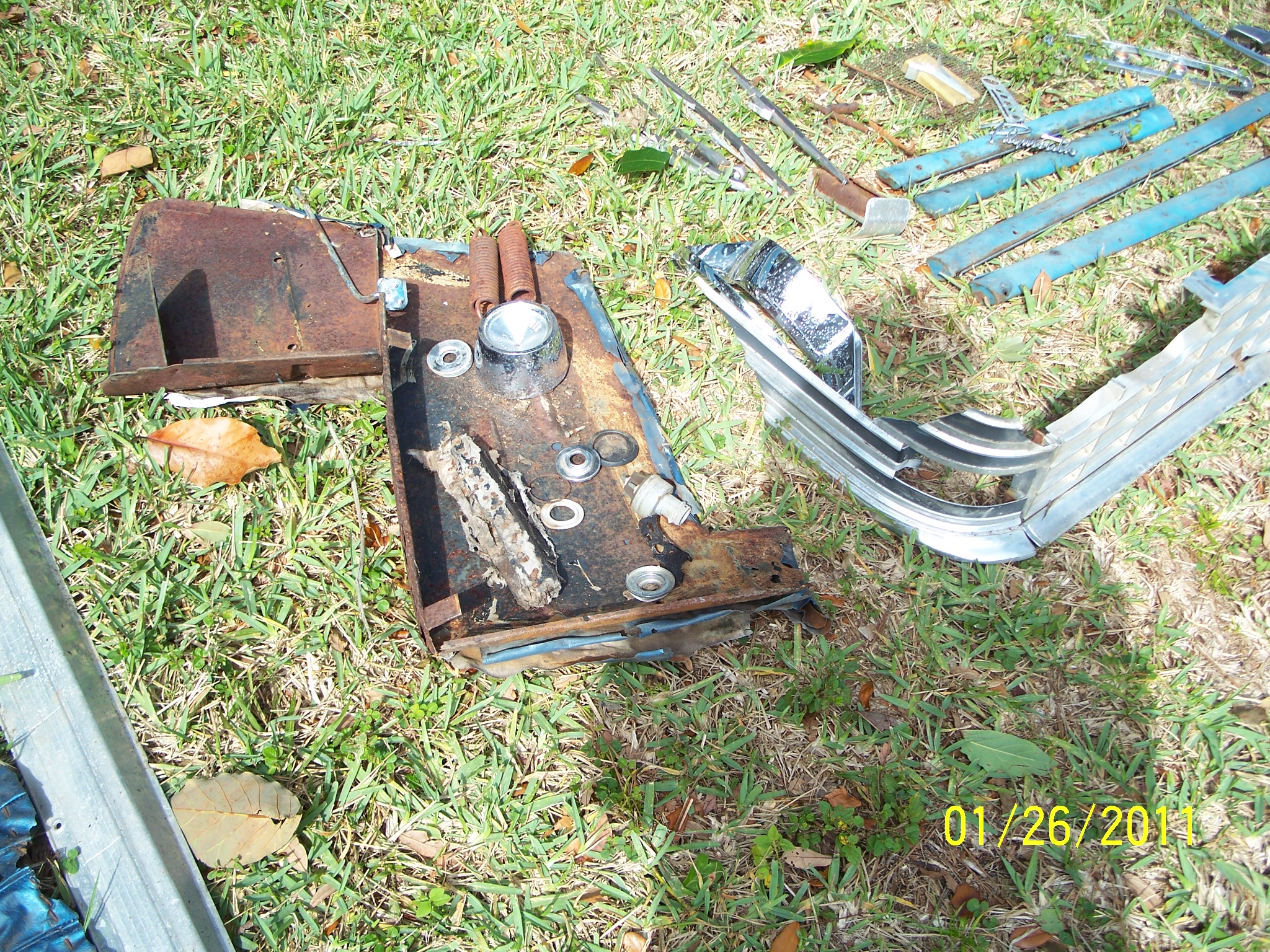

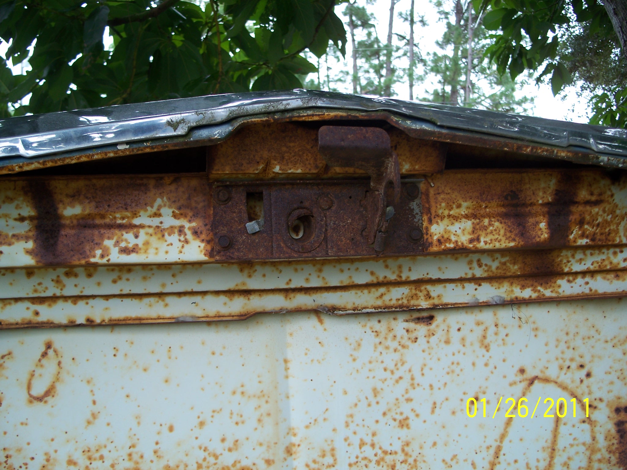

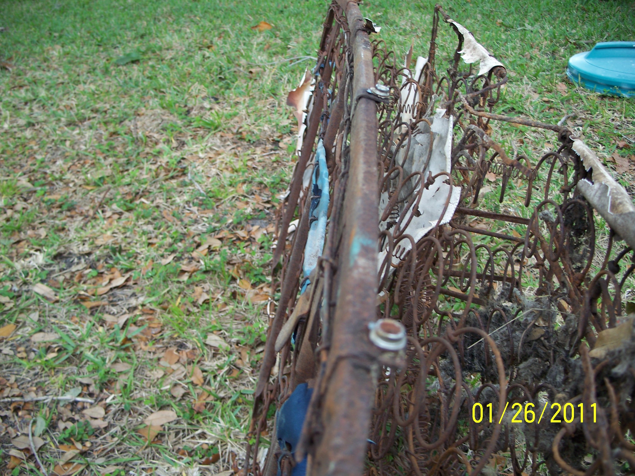

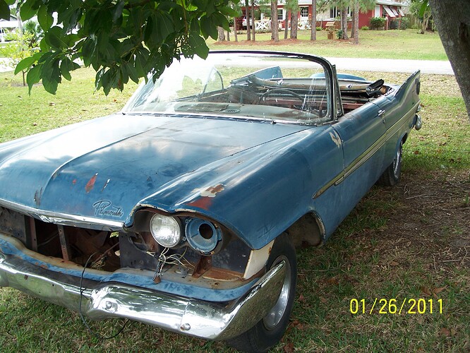

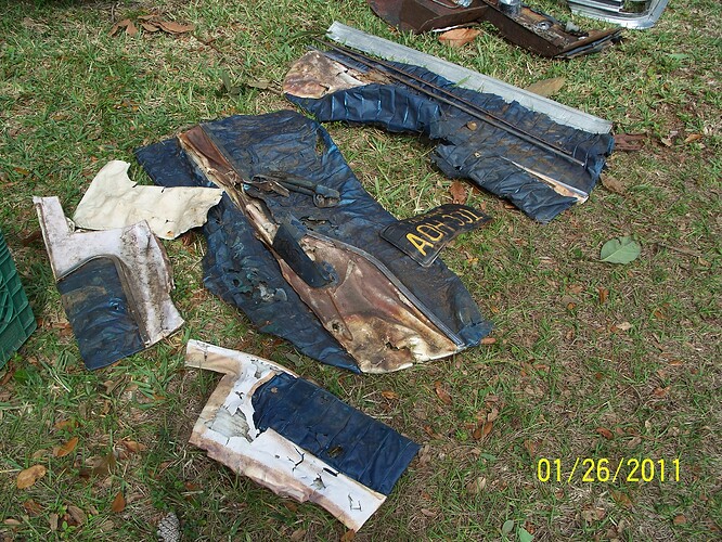

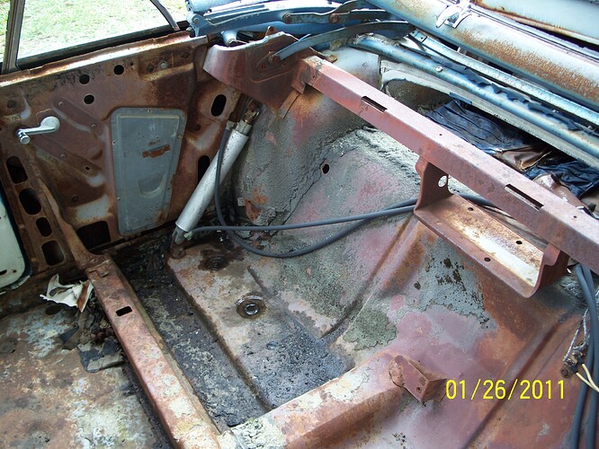

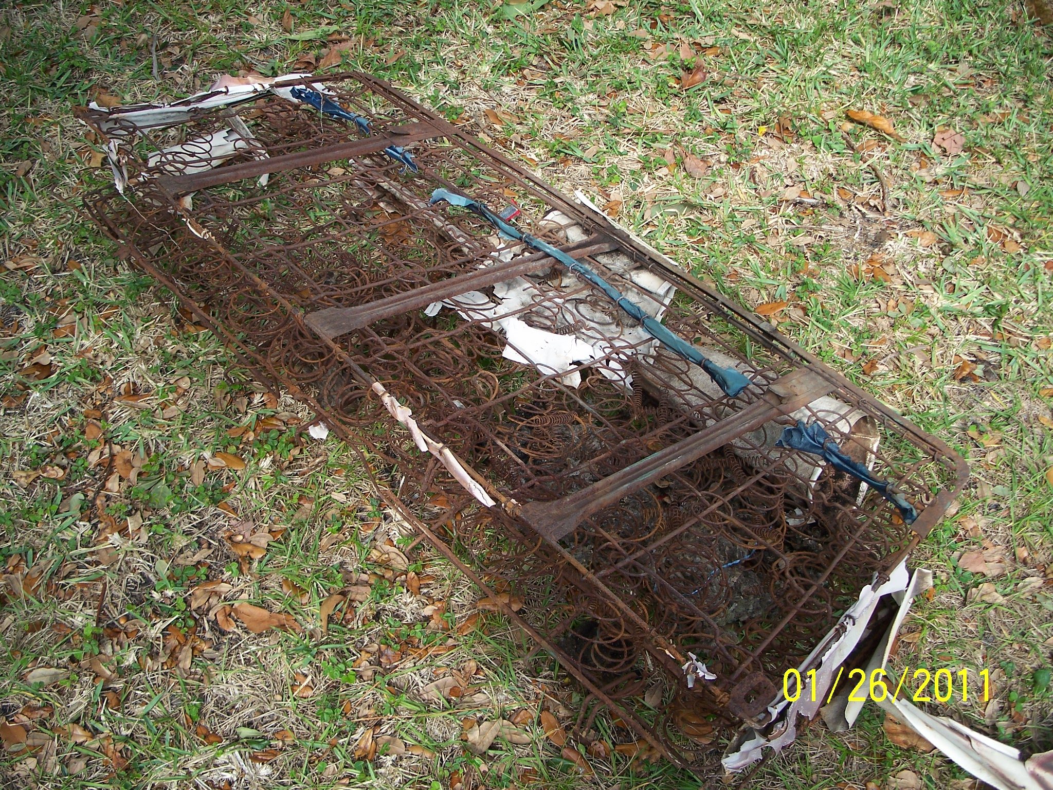

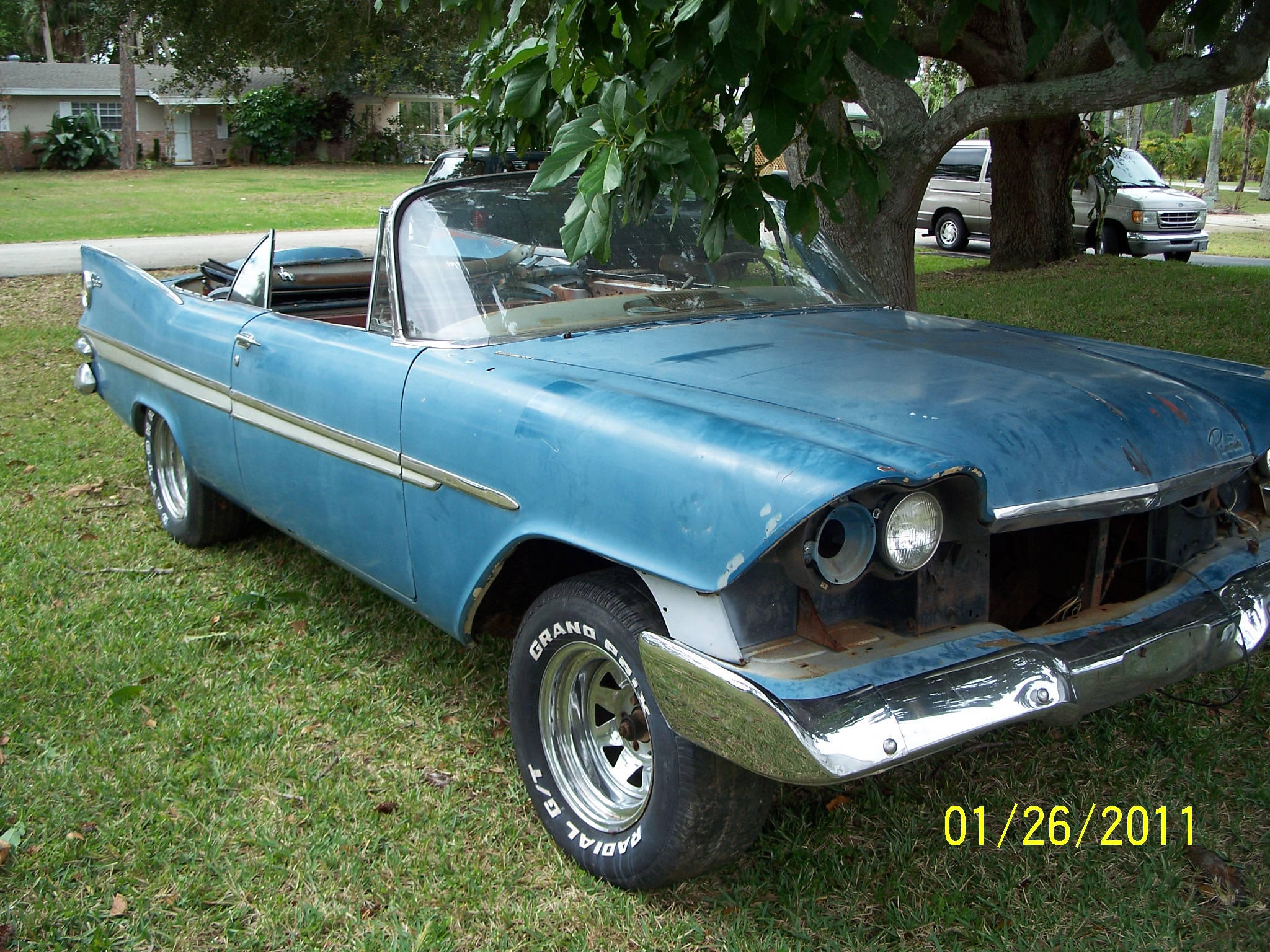

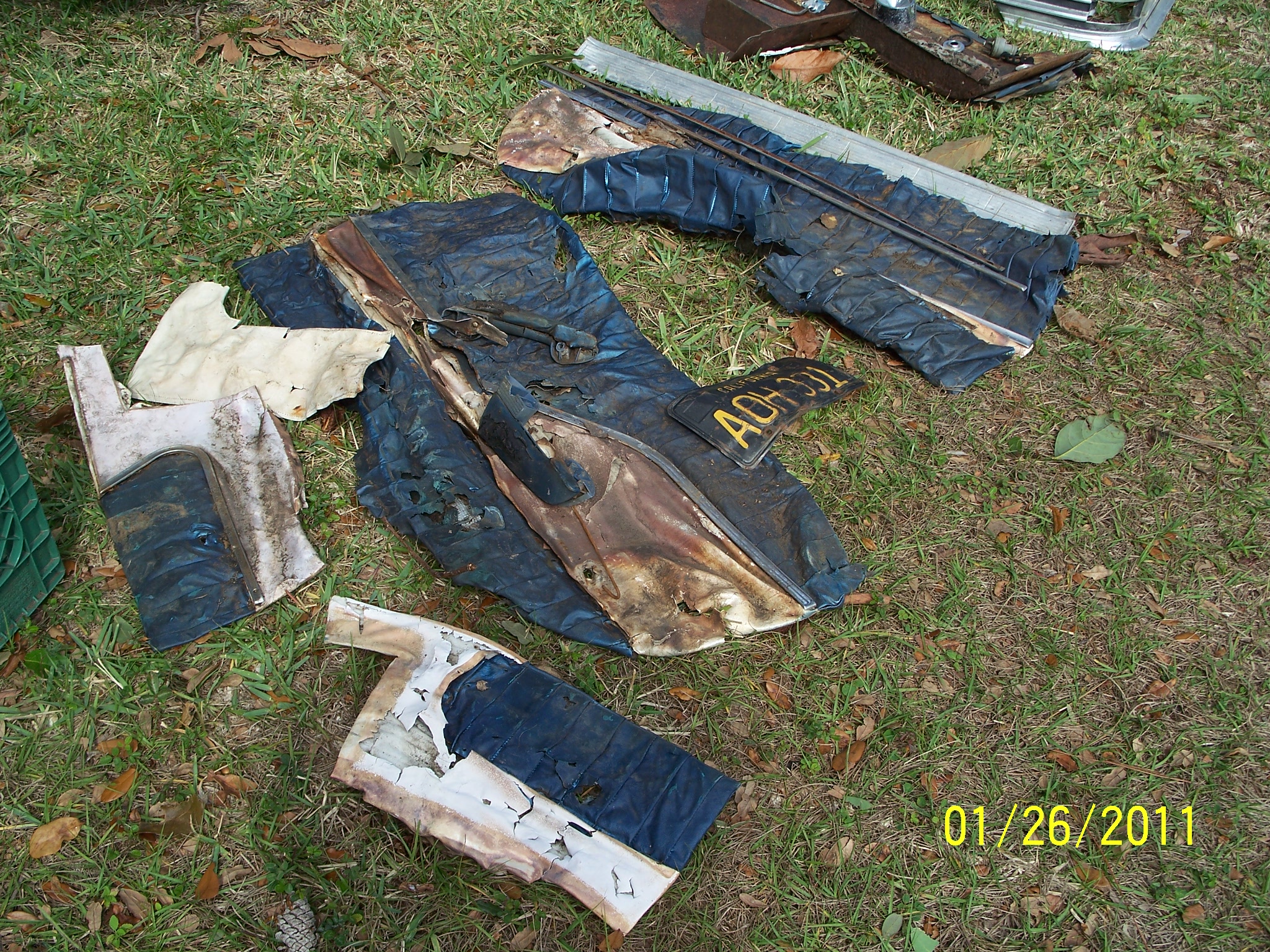

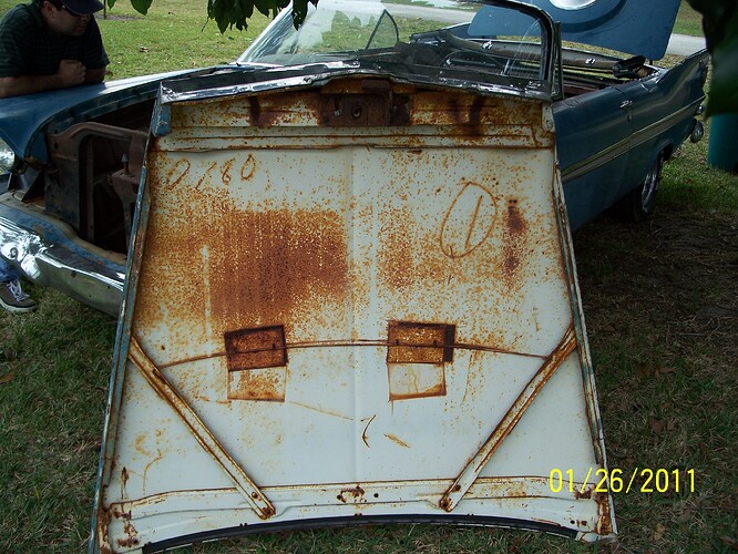

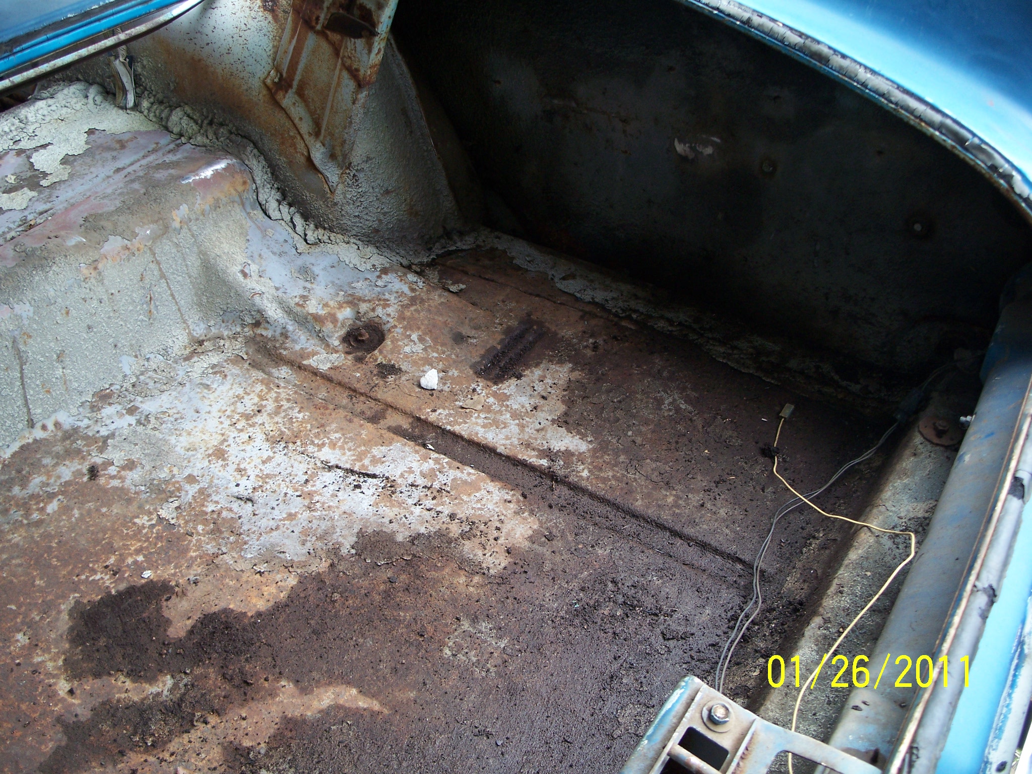

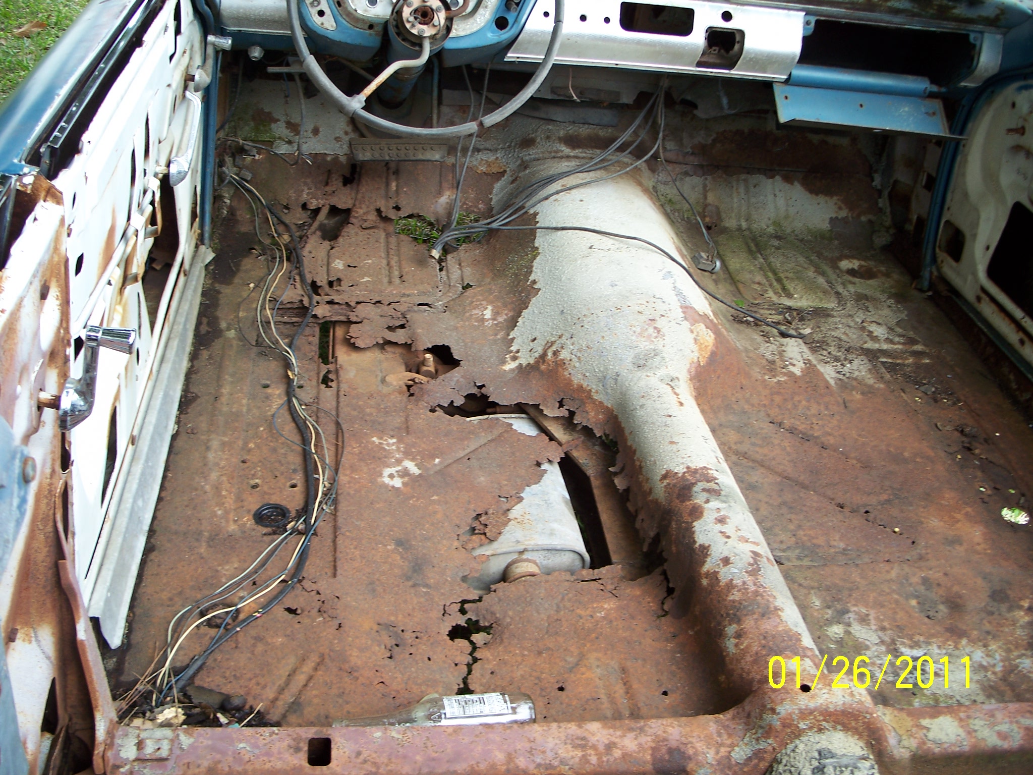

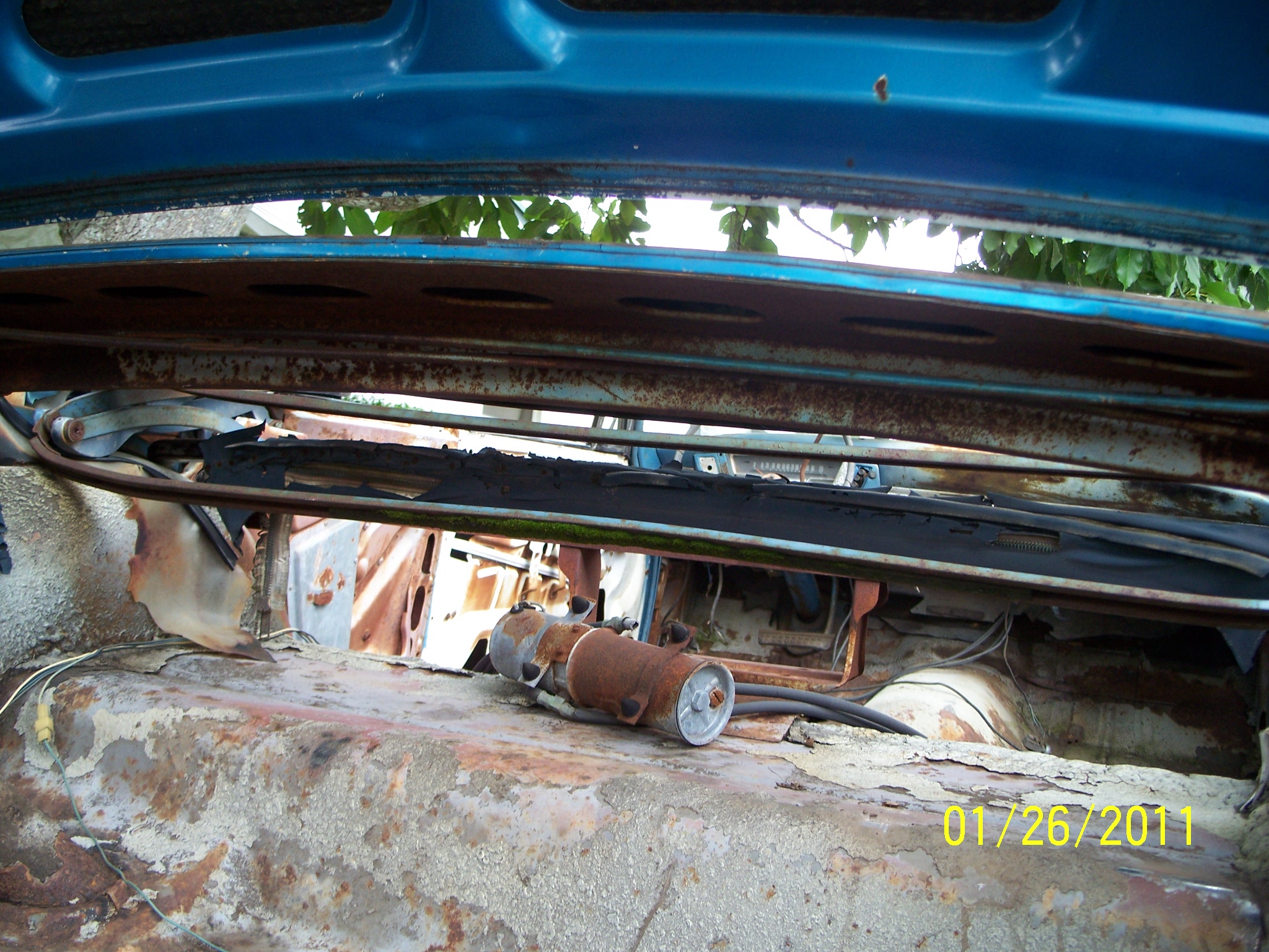

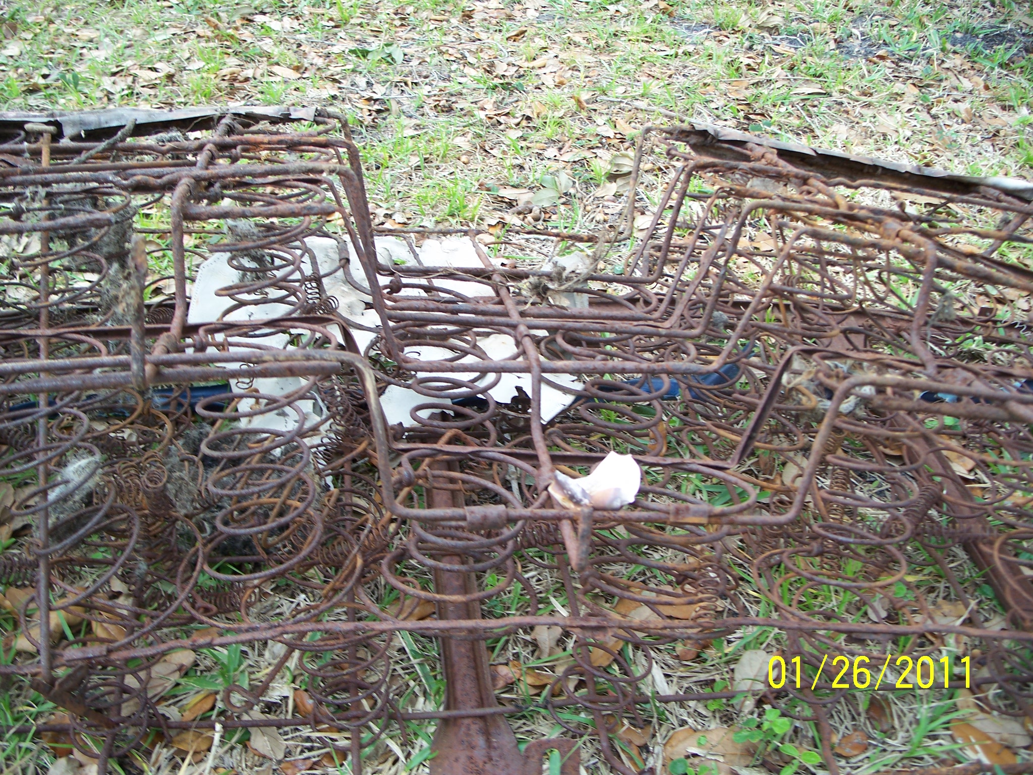

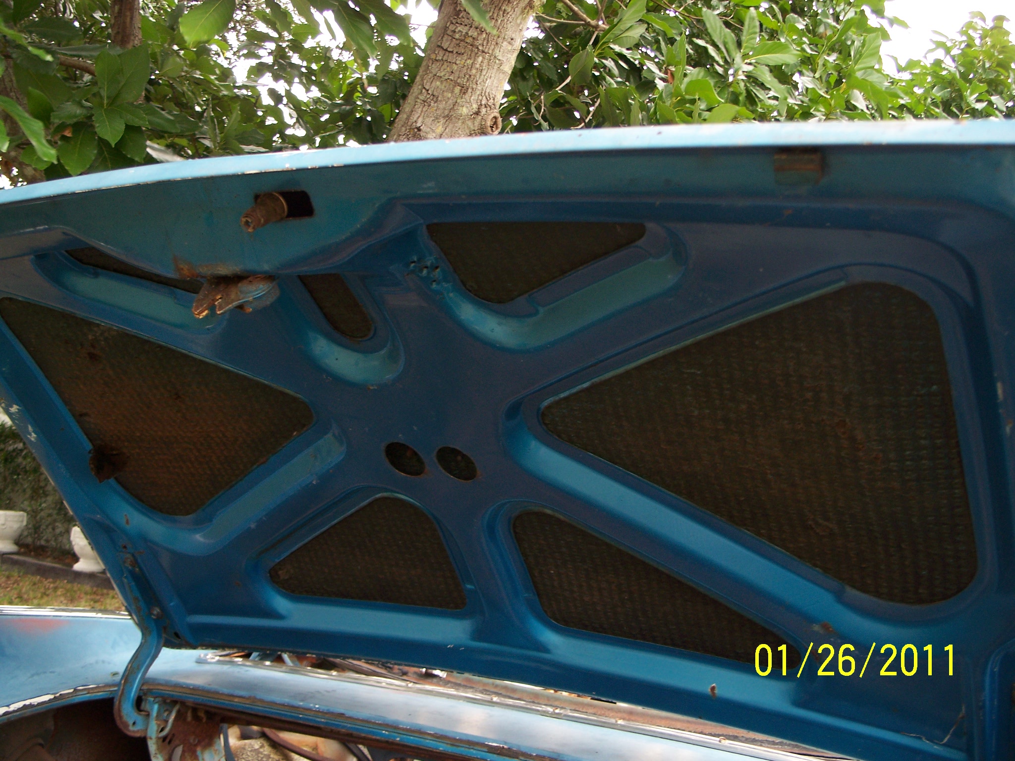

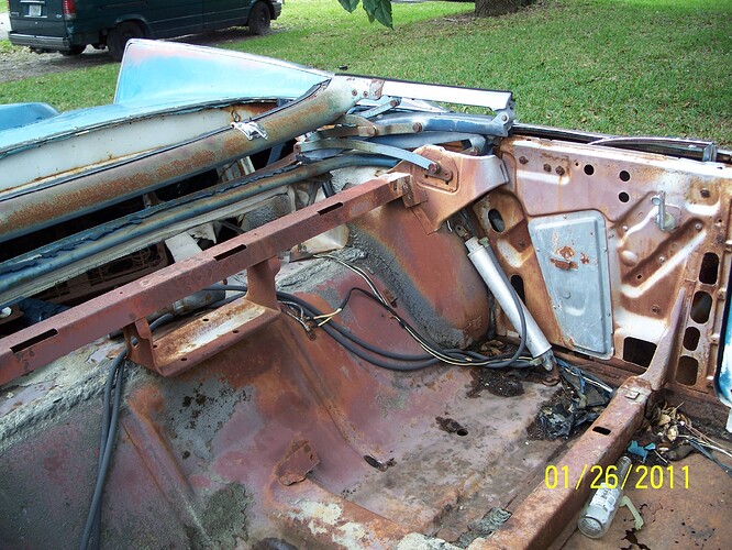

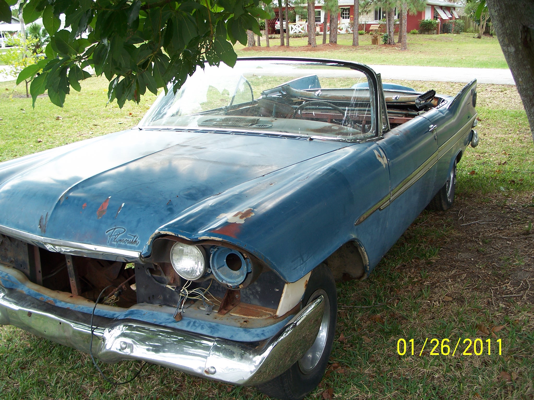

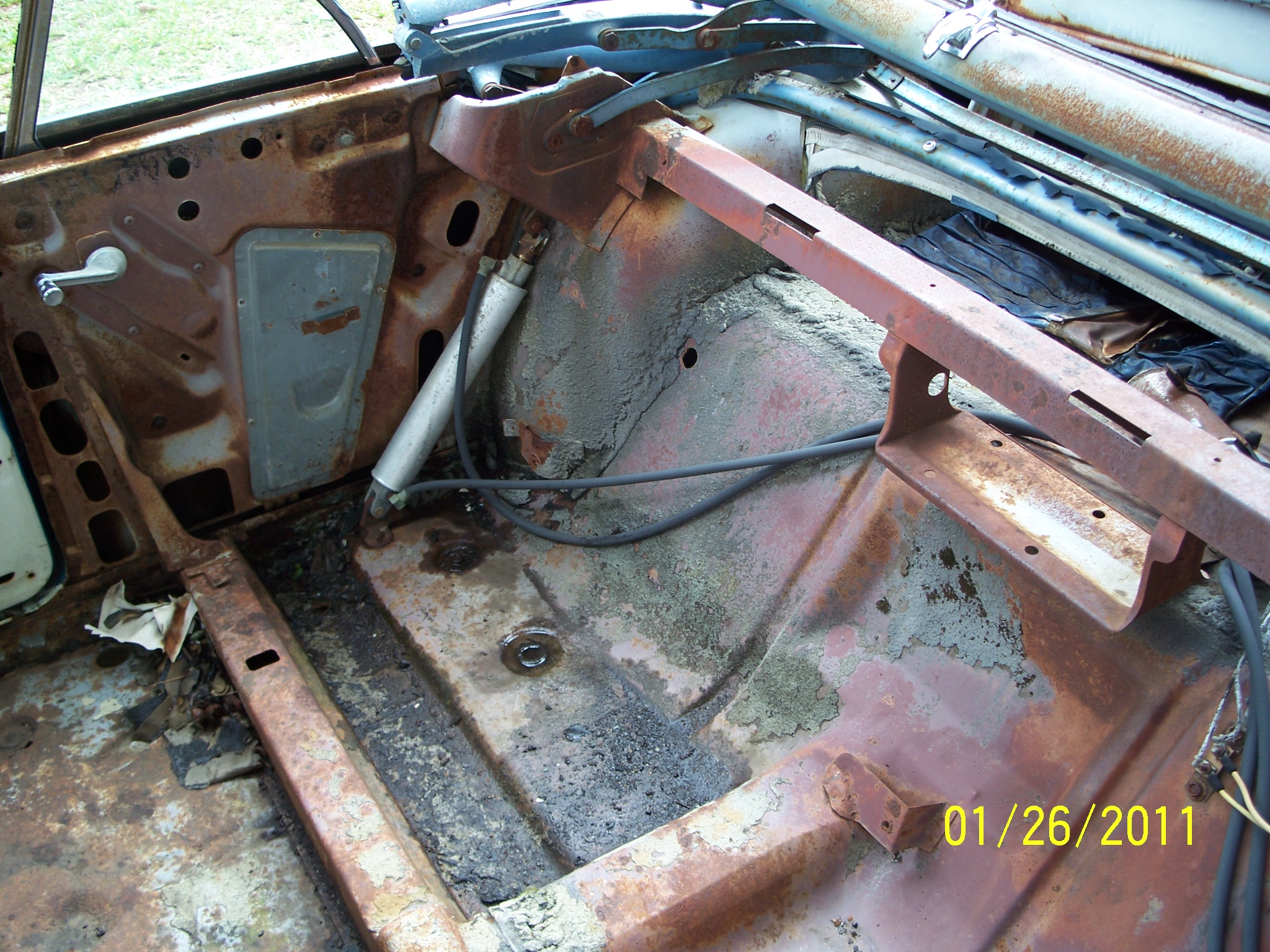

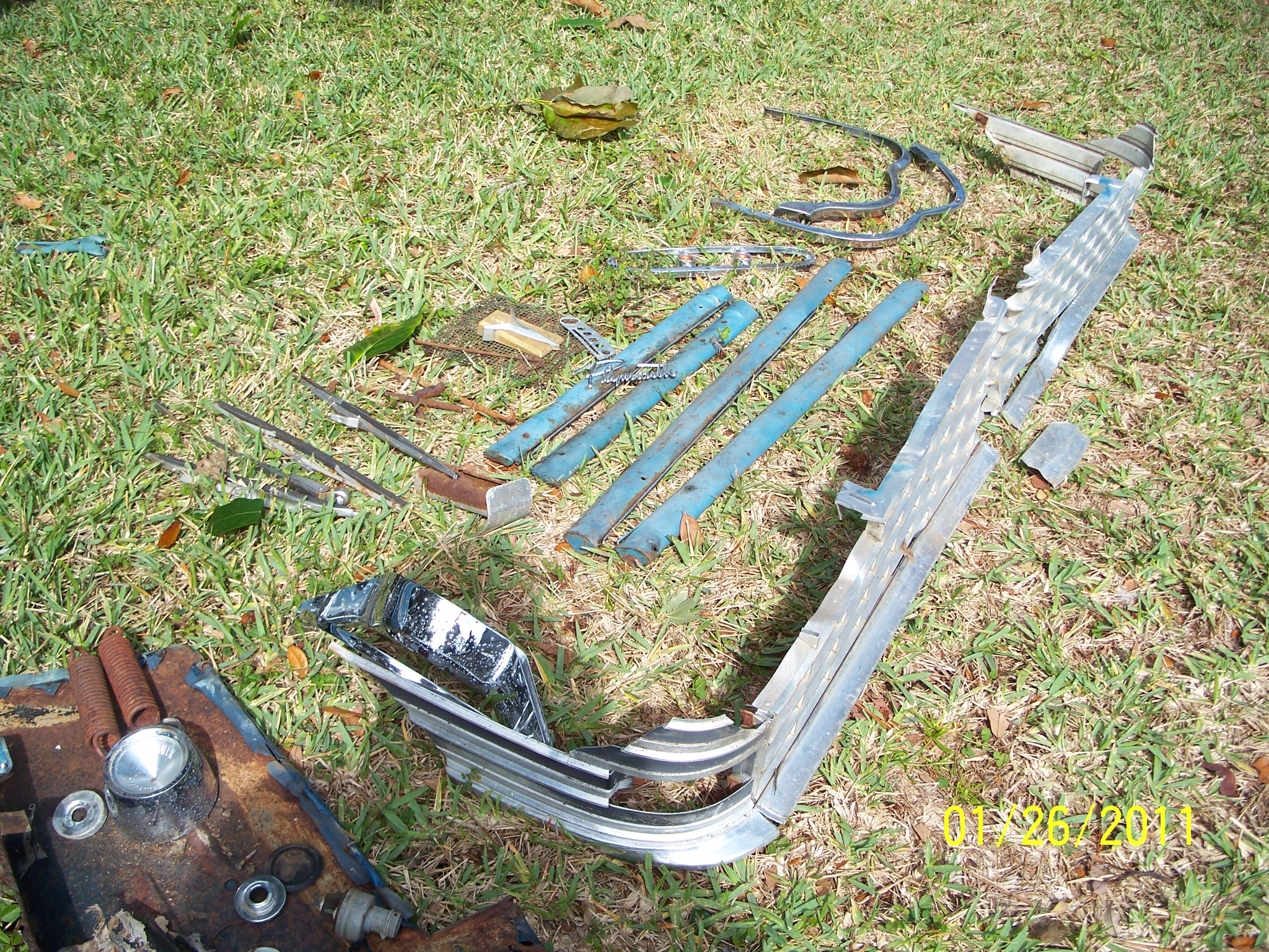

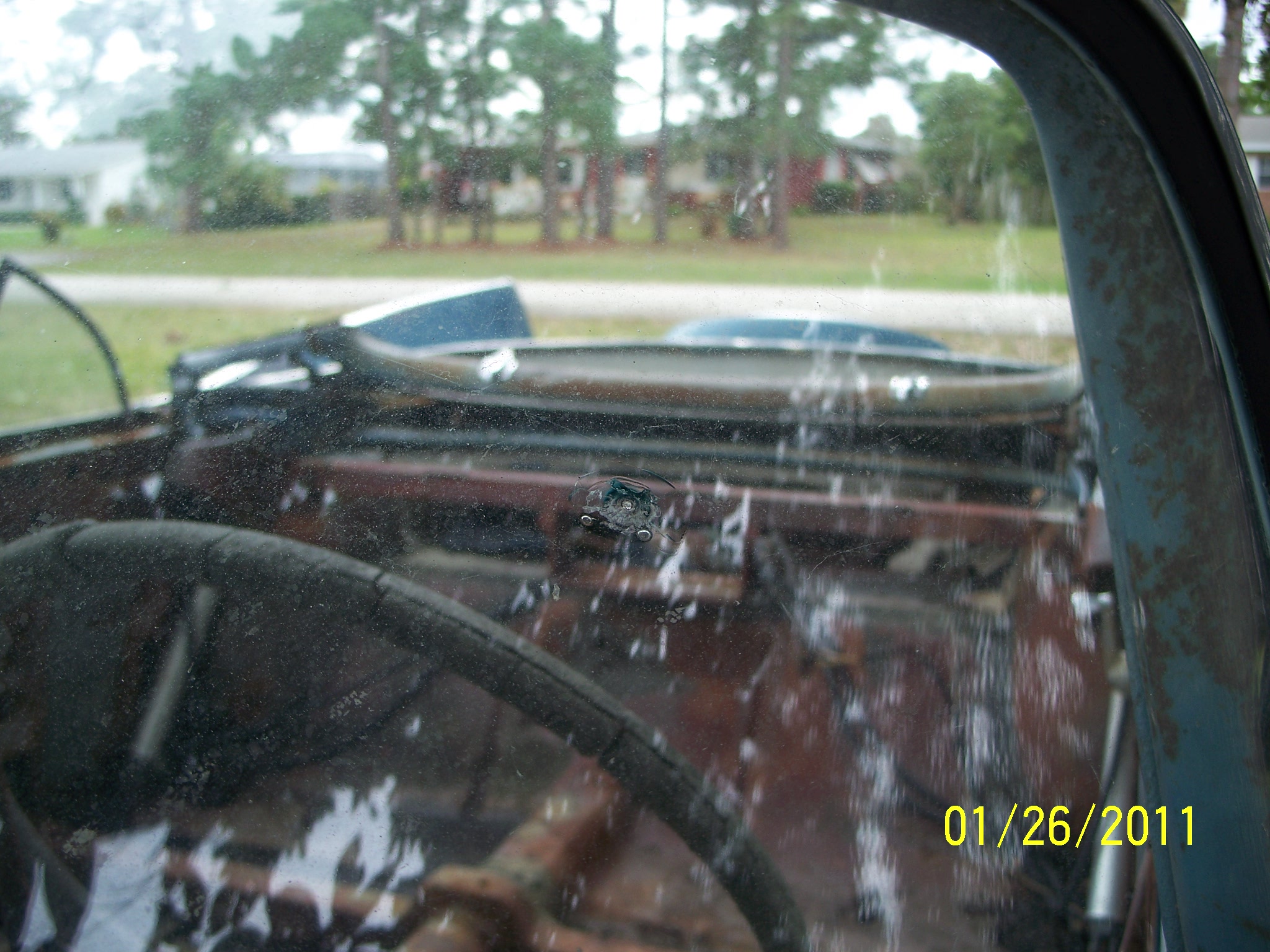

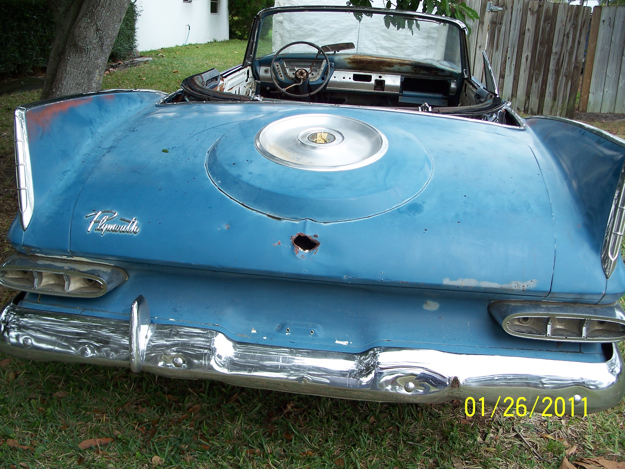

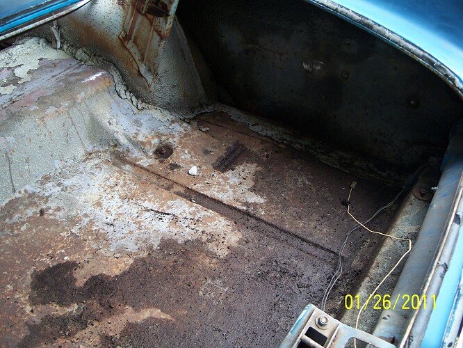

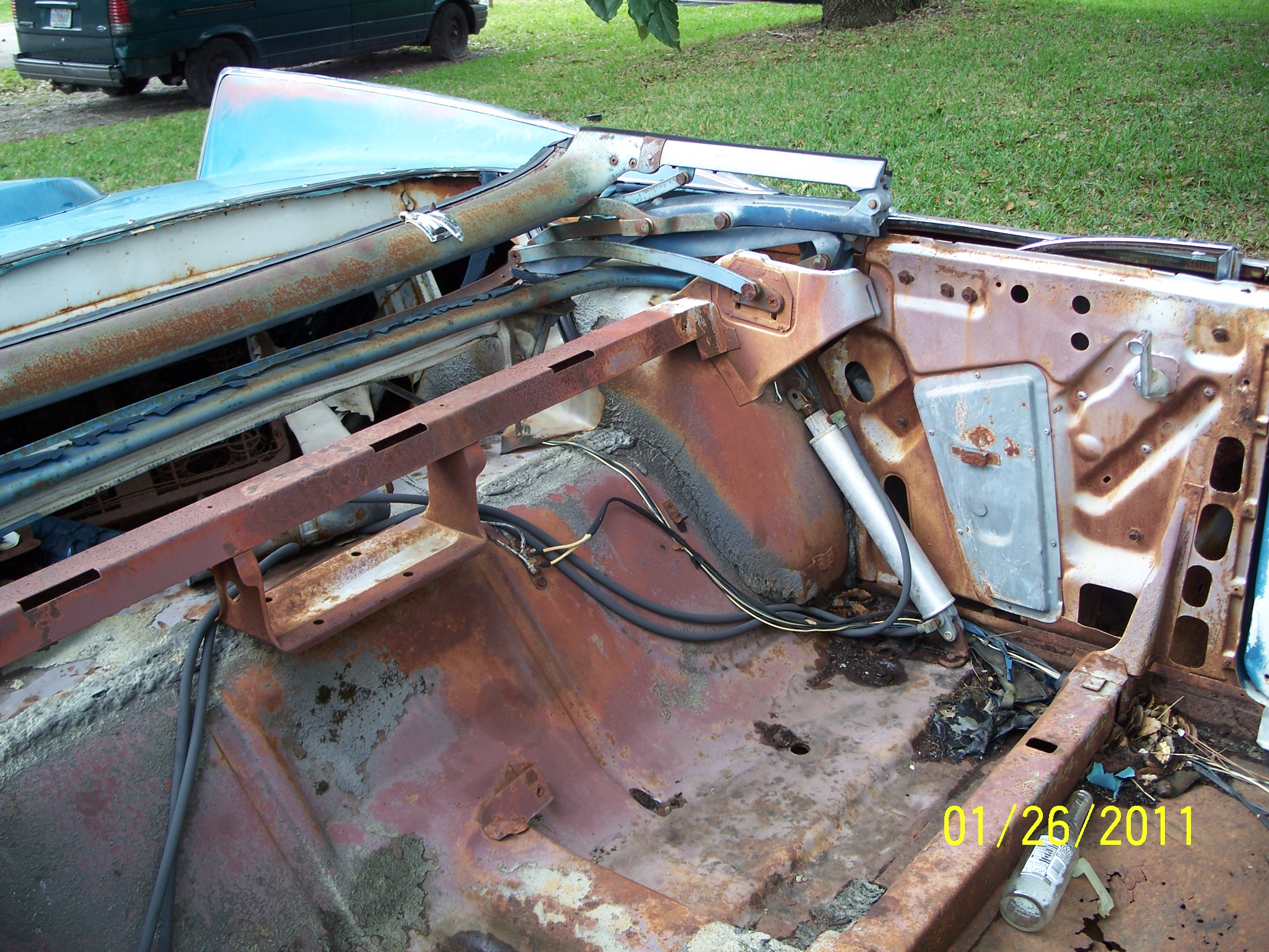

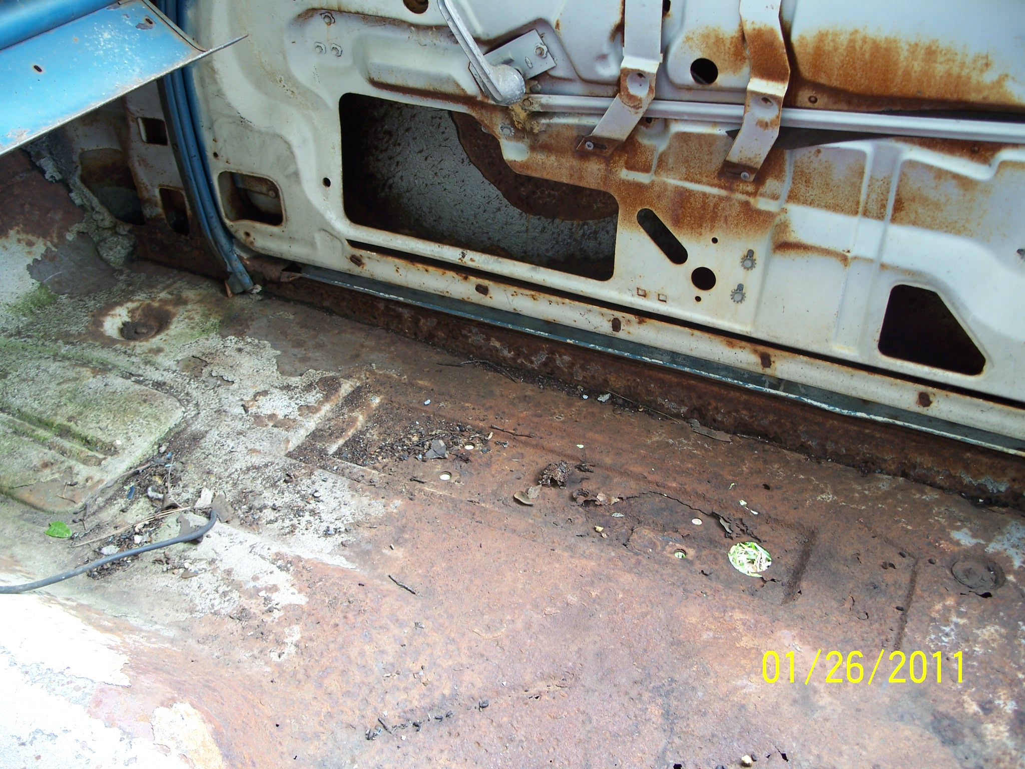

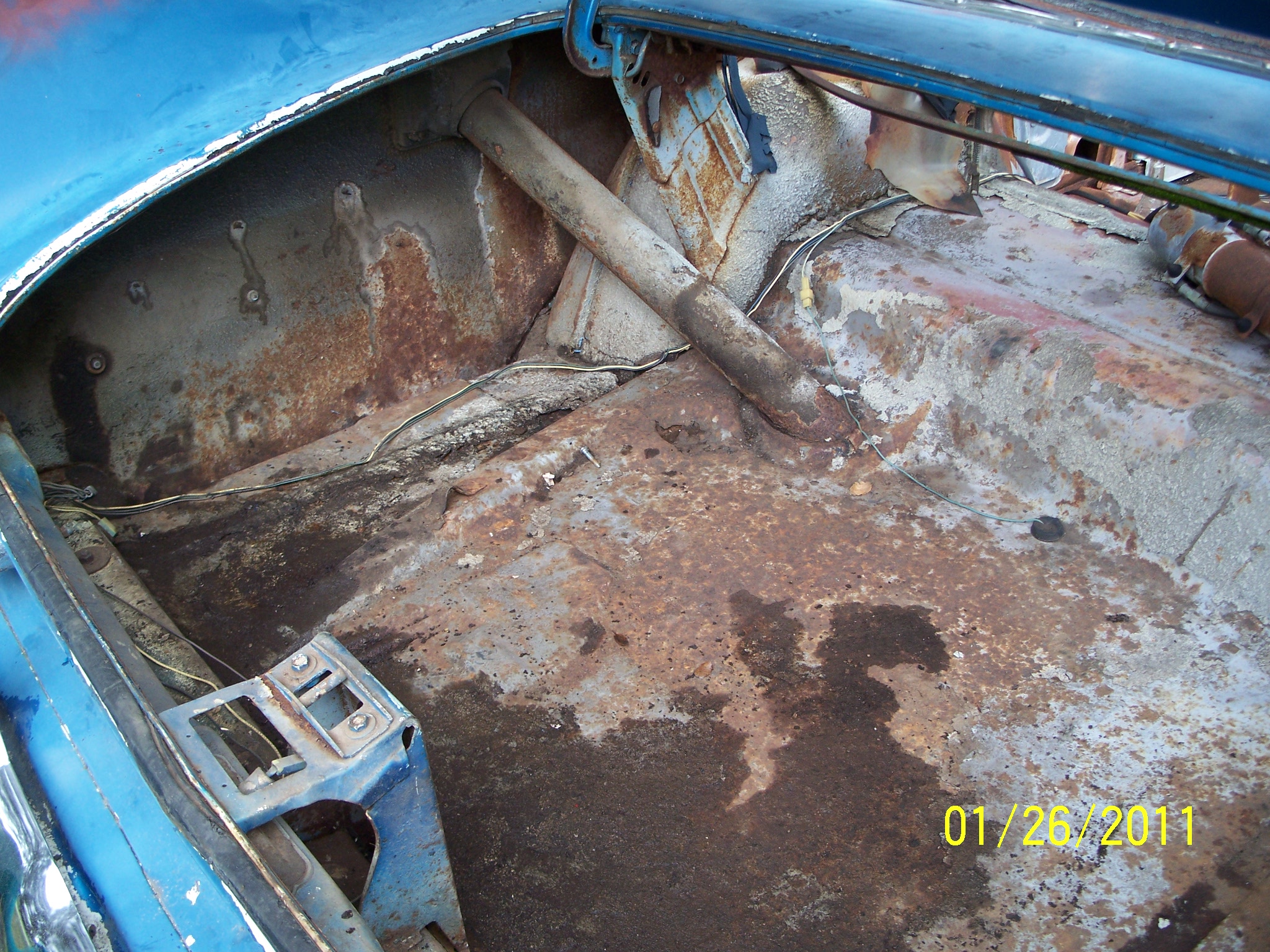

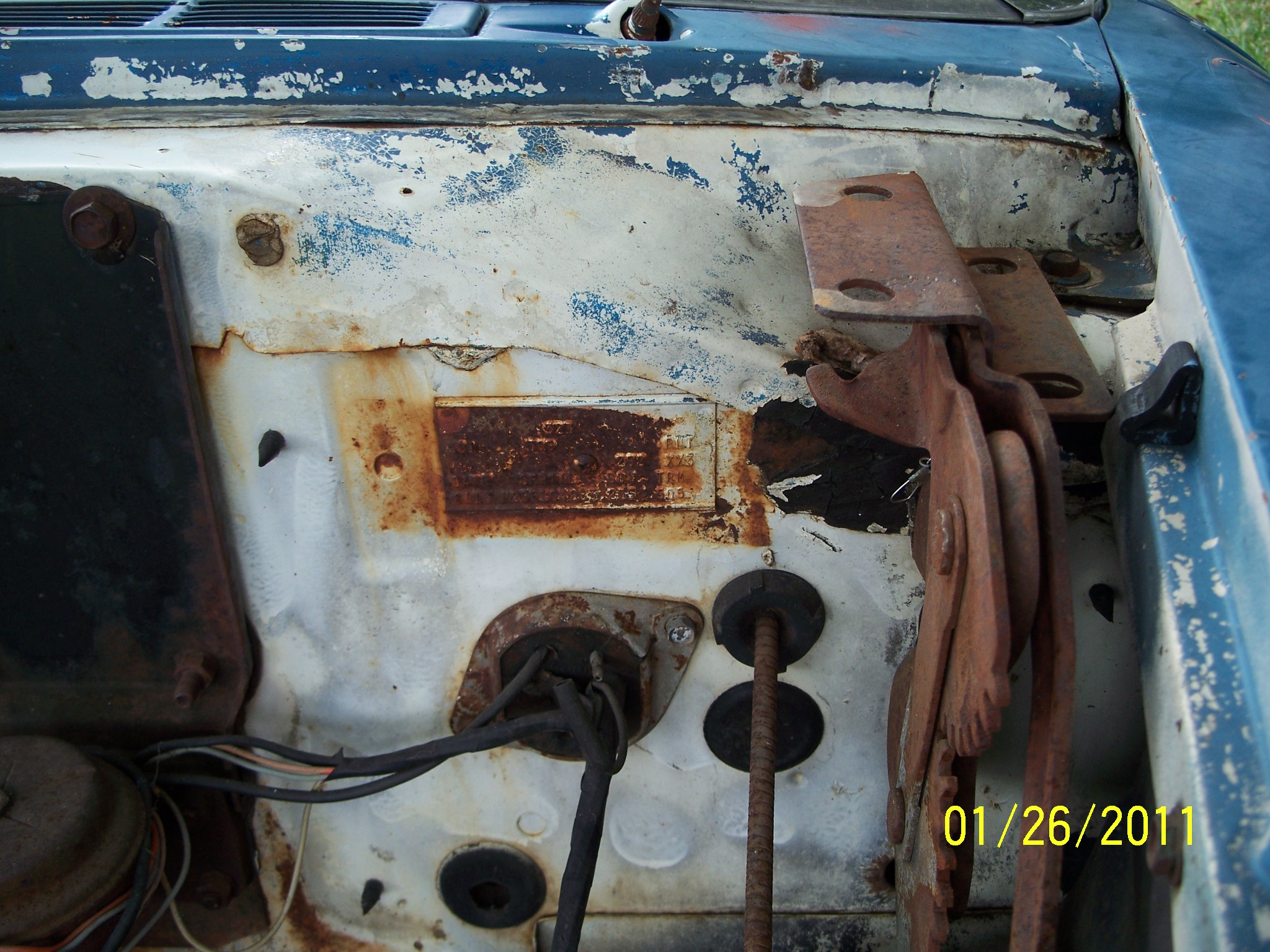

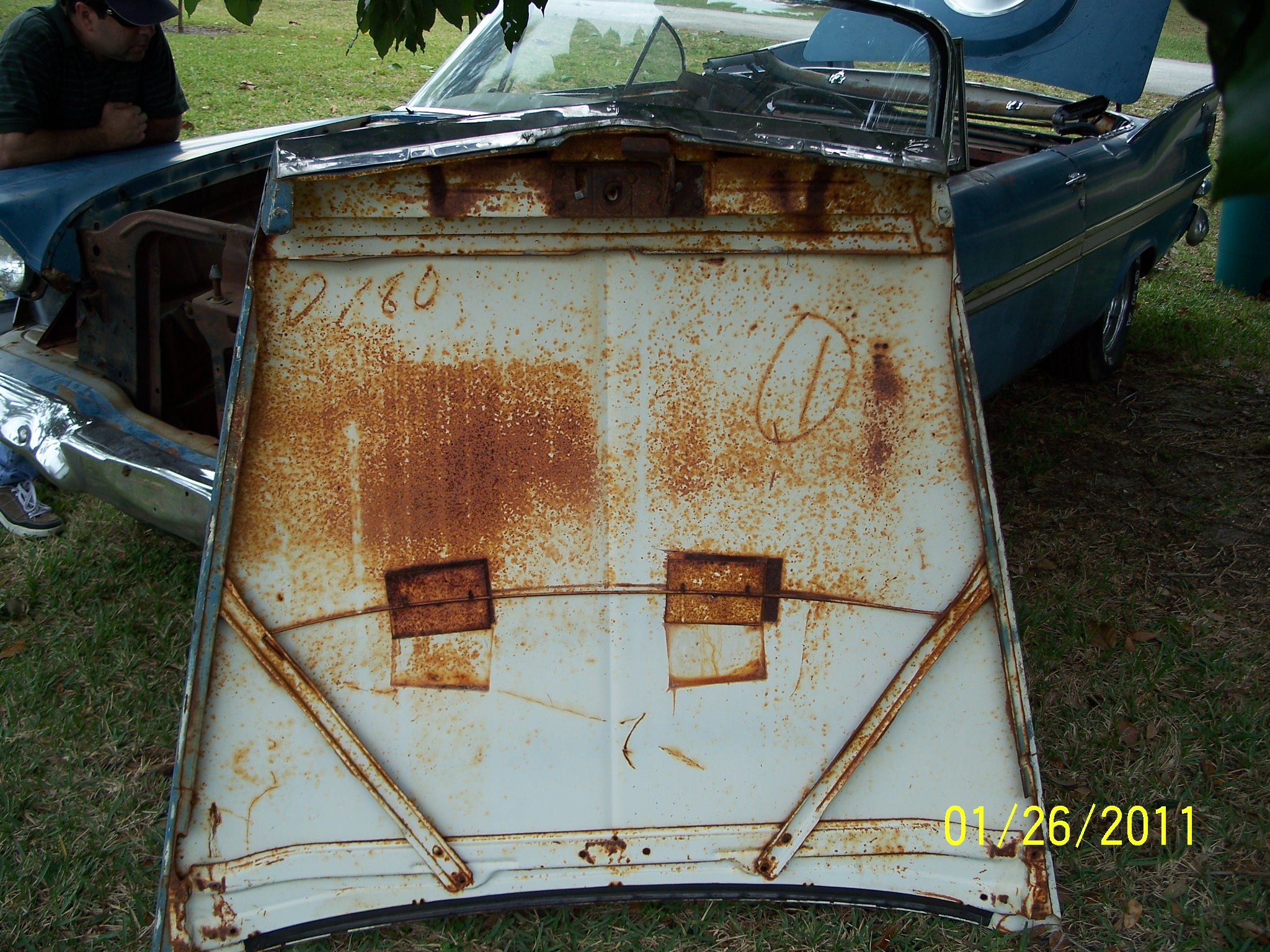

Alright, Already, Hold your britches on, Here are the pitchuhs. It’s about what I expected, the body overall is in better shape than the red and white one I’m doing right now. I’m reasonable sure it was originall white. The windshield has a fisheye, looks to have been made by a BB. Windshield will stay, I can live with it. No seats, there is a seat spring but can’t figure where it goes. It has snaps on it. One of those hard to find pieces that goes over the top cylinder is missing. It will need new floors and inner rockers, the outer rockers seem to be OK. It will need lower rear outer quarters but I think the trunk floor is saveable. The dash is all screwed up but I have a complete one in my parts car. It has power steering but standard brakes, I will put power brakes in it. The inner fenders have been cut for (headers maybe) the frame is real good. Ther is some kind of tag on the firewall held on with a screw right in the middle, I will take it off and clean it up, it is probably a door tag, it looks to big to fit on the cowl. Yea, the gas tank is there, no surface rust on bottom. It will be a long slow process but I’m up to it.
SEE THE PITCHUHS,
It’s not that bad! Just the floor.

I think that seat is the back. Are those things on top the clickers for the top cover?
The spring set with snaps should be the rear seat back-support. The boot cover snaps to this. The other springset is the rear seat bottom.
Ah, another project to keep you young and active, Dick!

I’ve NEVER seen a VIN tag where that one is located. Really, really wierd.
Please give us the VIN # and info from that tag.
THe cvt VIN tag is supposed to be high on the firewall, on the horizontal surface just under the hood.
Roger, i am not sure what this thing does over there but this is not the vin tag ![]()
The picture is showing the data plate and that one should be mounted on the passenger side behind the hood hinge
You are absolutely right, matthew. I called it a vin plate out of laziness. It is a data plate. ![]()
Shoot! it got by my roadblocks!!! ![]()
Looks good shape, Floors no problem. Roger and Matthew are correct on the seat with the snaps, it is the vertical part of the rear seat (good that you have that and the base, Horizontal part)
The data tag looks like the type I have on my 69 Charger and 70 Cuda. Please get a close up picture of that one. Curious to read the codes on it. ![]()
Weird location for it too as Roger has surmised…
I tried to enlarge this data tag and still can’t read it. Even stranger is the way it is affixed to the firewall with a single phillips head screw thru the middle of it. I also don’t see the VIN tag above the brake bracket either.
just some wild guesses… Canadian Mayfair convert…Export? Military Sales convert? Random tag placed by Hoodlums…(ford guys!)
Only a close up of the tag and others viewing it will get us an answer… ![]()
Hey John Q, I like the general guesses of origin! Maybe Canada did these things differently.
Dick, the cvt VIN plate, if it exists on your car, should be on the little horizontal shelf at the top of the firewall, on the passengerside. Peel up that rubber weatherstrip in the area above the heater box.
Probably no Vin # on the Bill of Sale…
That Data plate sure is rusty, yet the area around it is not. This makes me think someone added that plate later.
You may be able to make a rubbing of the plate, then John and Matthew can decode it!
The reason Dick couldn’t figure where the rear seat springs fit is (IMO) they are not correct for this car. The springset with the snaps has an obvious dip in the center, which no 59 Plymouth cvt had. ( checked the Showcase).
I sure am sorry one lift housing is missing.
I believe in the photo with the boot snaps, it is the seat back and the seat bottom is folded up against the back. You can see the seat frame with the arch that goes over the driveline hump. The next photo of a seat bottom might be the front bench bottom but doesn’t really look like 59.
Tom
John Q, you’re needed..to compare your car’s seat springs to Dick’s. Get out the camera!
I agree with Tom that the pic of springs standing upright is in fact two sets of springs pushed together.
I do not remember the seat bottom “tunnel” being so squared off.
In any event, those springs are really rusted thin in places. ![]()
