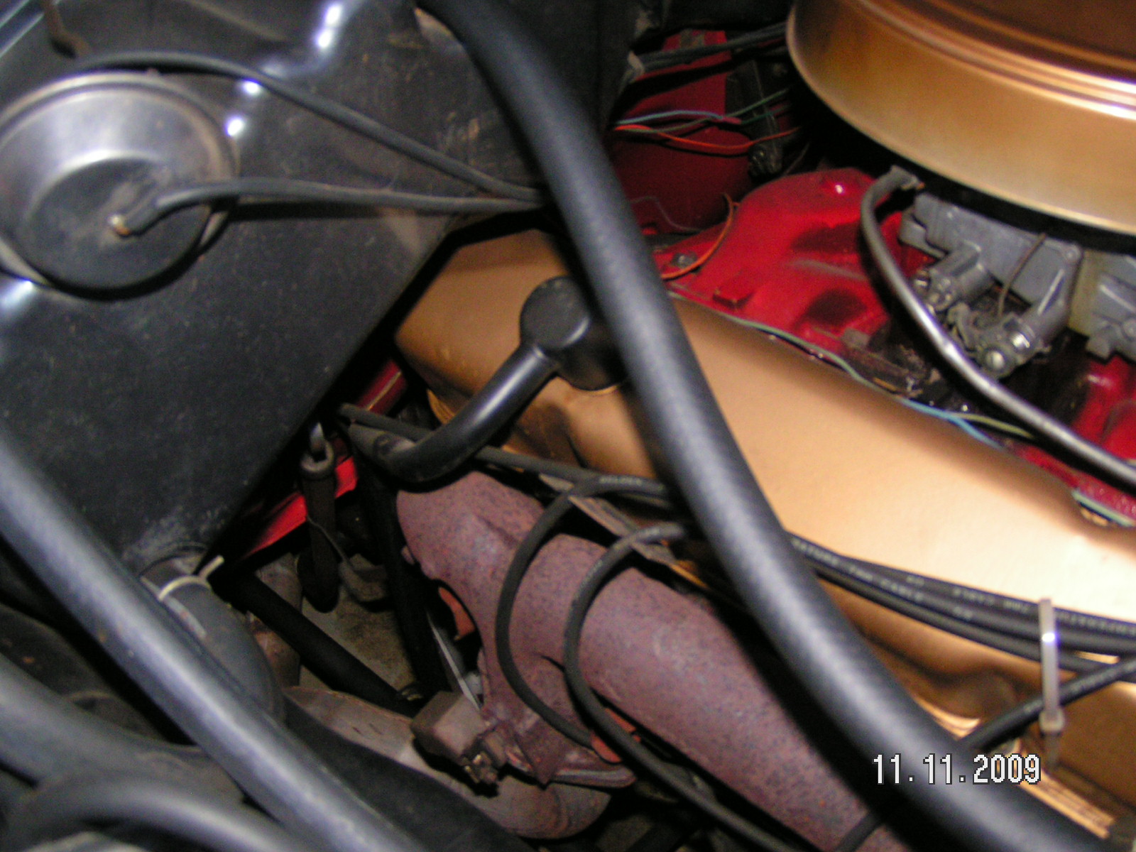

Here is a pic of a draft tube, in place.

The factory draft tube in the photo is made of steel..it is long enough to reach the area of the frame…that’s it. I suppose you could go with a long rubber tube fitted to a nipple in an after-market valvecover cap. Better for the environment if you pipe it into the aircleaner. Your car has the 318? I will not ridicule you for any of your questions!
As for piping both sides, here is what I suggest:
Apparently you have a fair amount of blow-by. If I were you, I would buy a tight cap for the left side. One with no venting. Then at the passenger side, I would pipe it into the aircleaner. The draft tube works well when there is average blow-by…it seems your car has MORE than average blow-by. 1959 Plymouths were notorious for their piston rings not seating, even from new.
