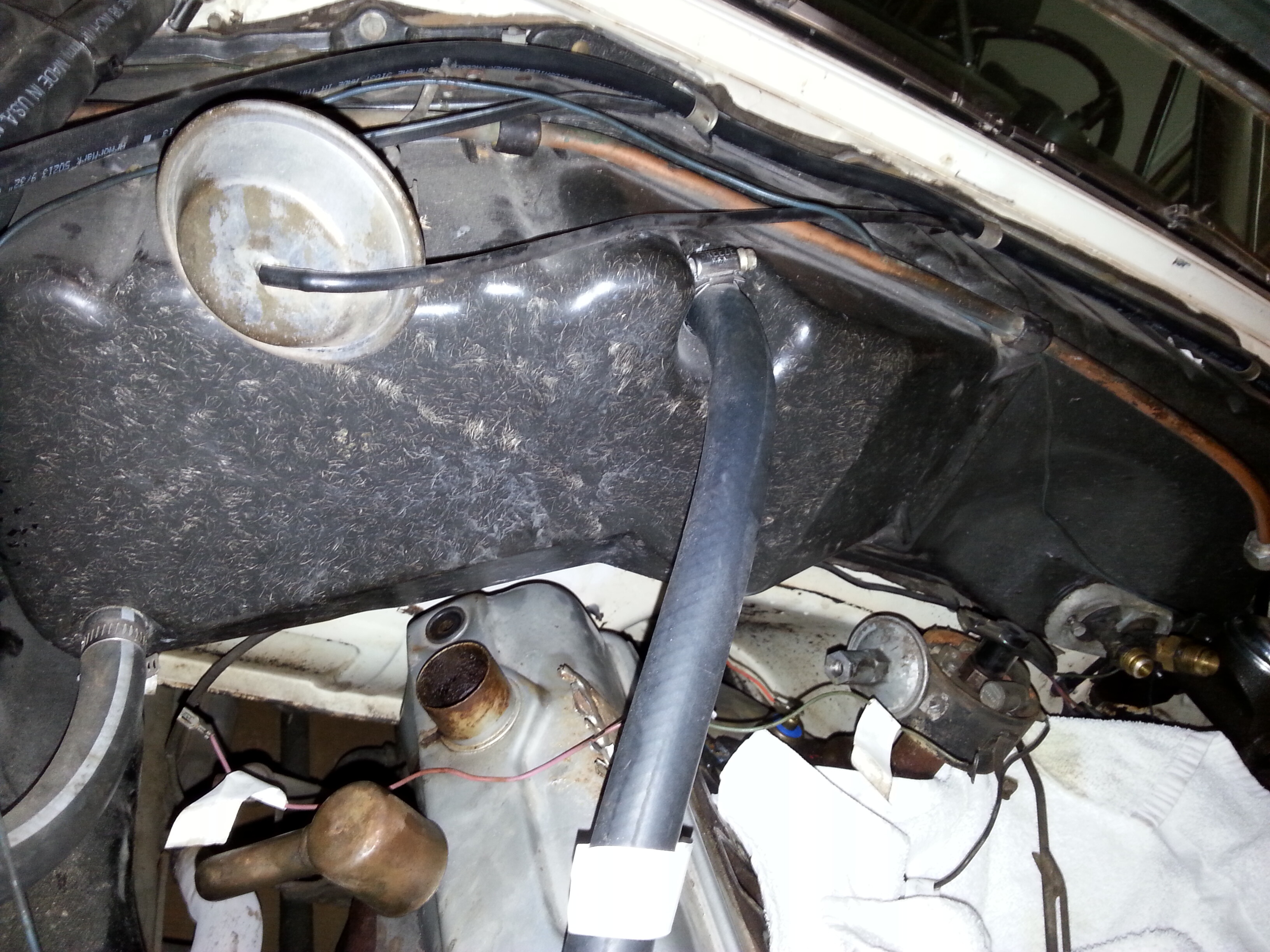

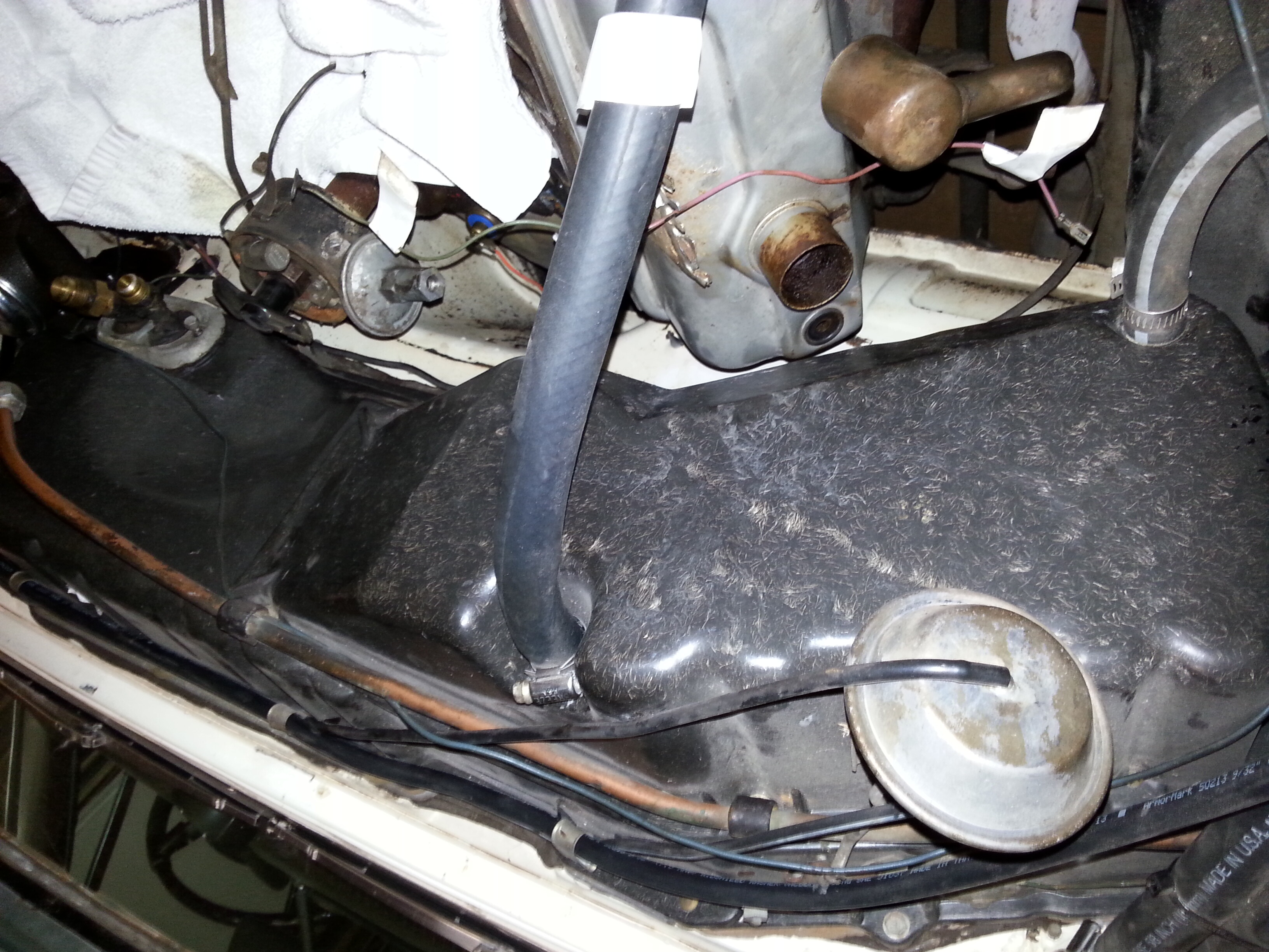

In the process of attempting to remove the passenger side head, it seems that I will first have to remove or at least loosen the cowling. Is there anything I need to know about the process of removing or loosening the cowling? I’m open to any advise. I really didn’t want to have to mess with the cowling but it seems I’m not gonna be that lucky. Thanks for any assistance.
The picture being upside down is very confusing, a lot in that picture I do not recognize as being a 59 Plymouth. As far as the cowling goes it is not removable, I thing you are referring to the black heater box. I notice the vent tube is still connected to the valve cover, remove that and then remove the valve cover and the head should come right out.
Looks like your car has factory air conditioning, is that so? Even with it, I believe the heads can be removed without pulling the evaporator, with the right tools.

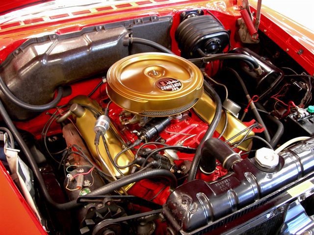

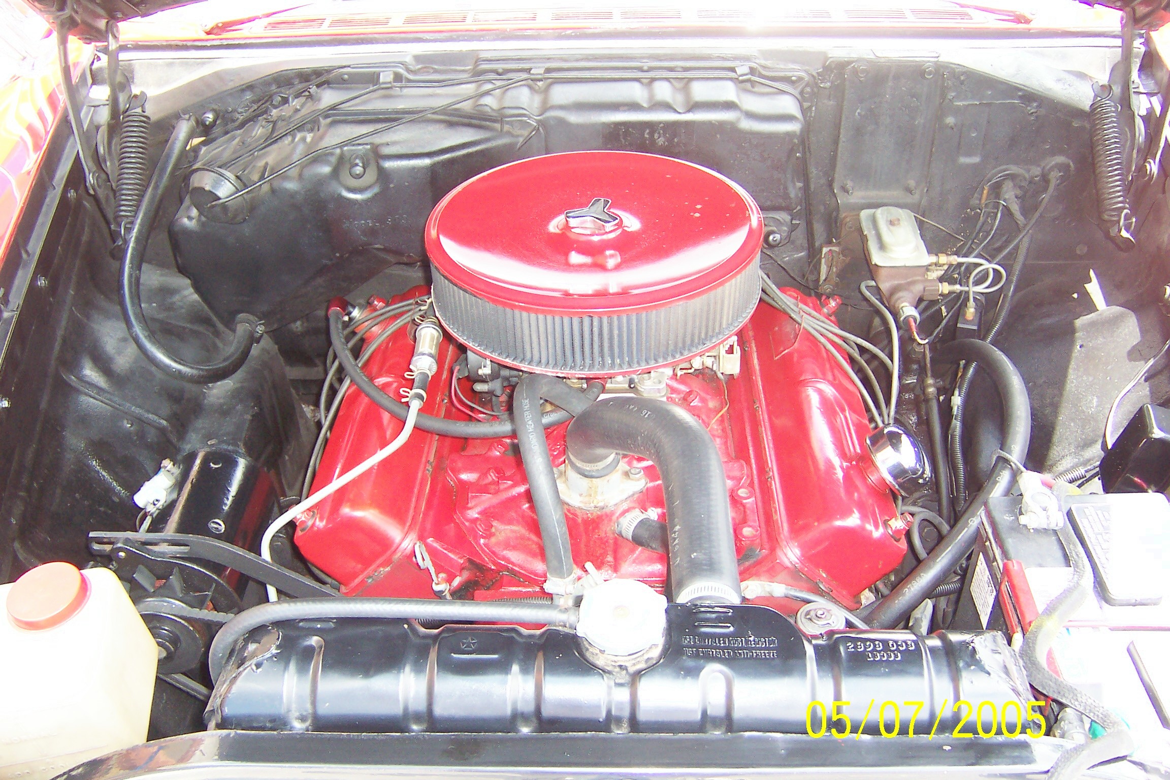

Eromas & John - My red and white car with the 318 and dual fours is a factory AC car. The heater and evaporator box looks nothing like the pictures eromas sent. There is plenty of room to get the heads out even if you don’t remove the valve covers.
The first picture is My AC car before I installed the dual quads. The second picture is of a non AC car, as you can see there is pleanty of room to remove the heads.
