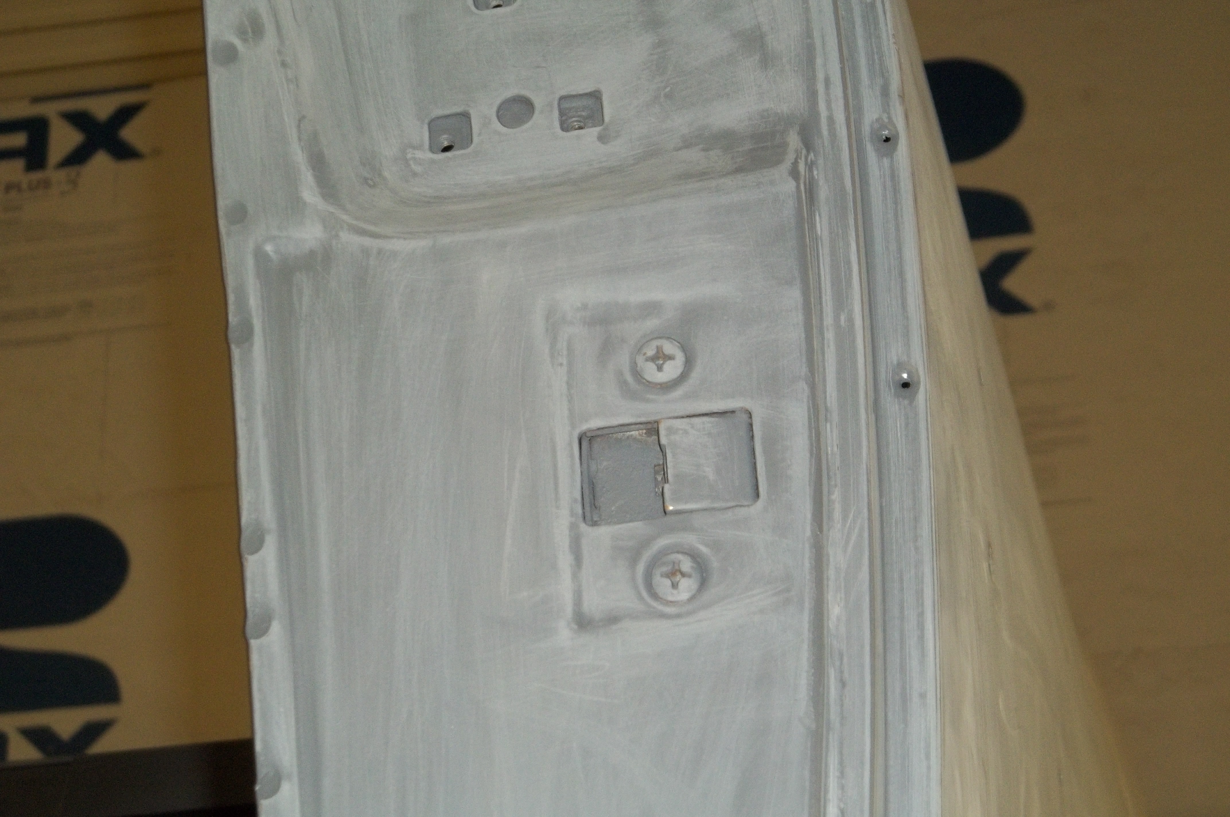

CUTE: The door opening has a front, that’s where the hinges are, it also has a rear, that’s where the striker is (upper) for the door latch. Below the striker is another (don’t know what to call it) piece. Will send pictures, please check your Vert and see if you have that piece.
Thanks,

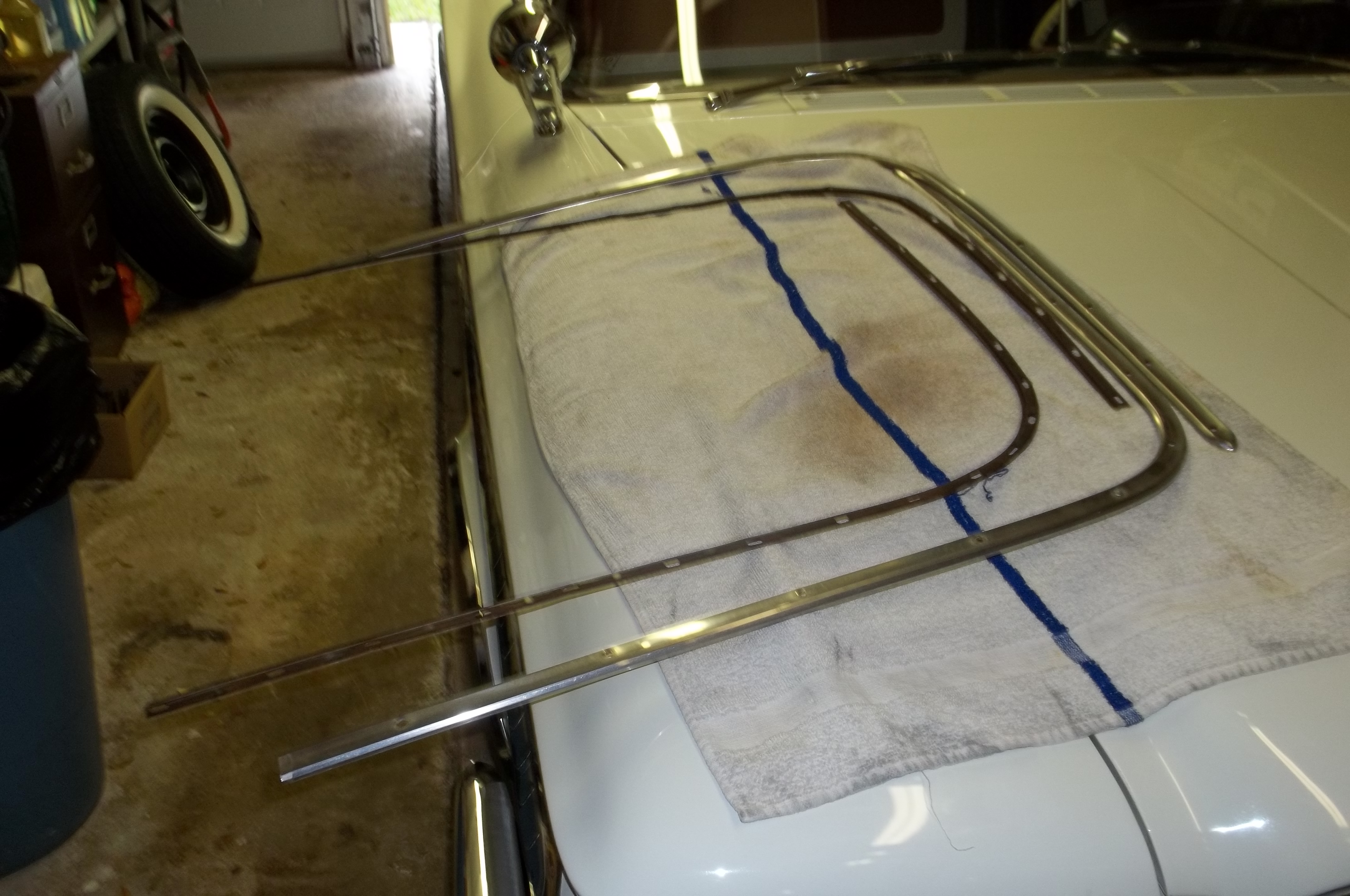

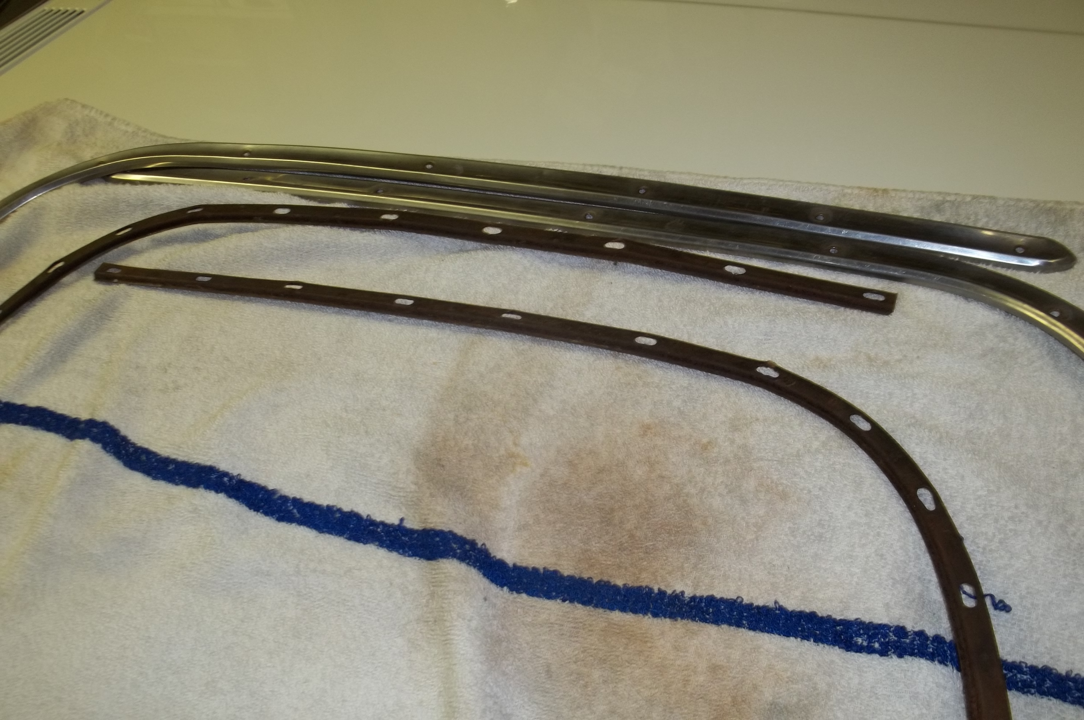

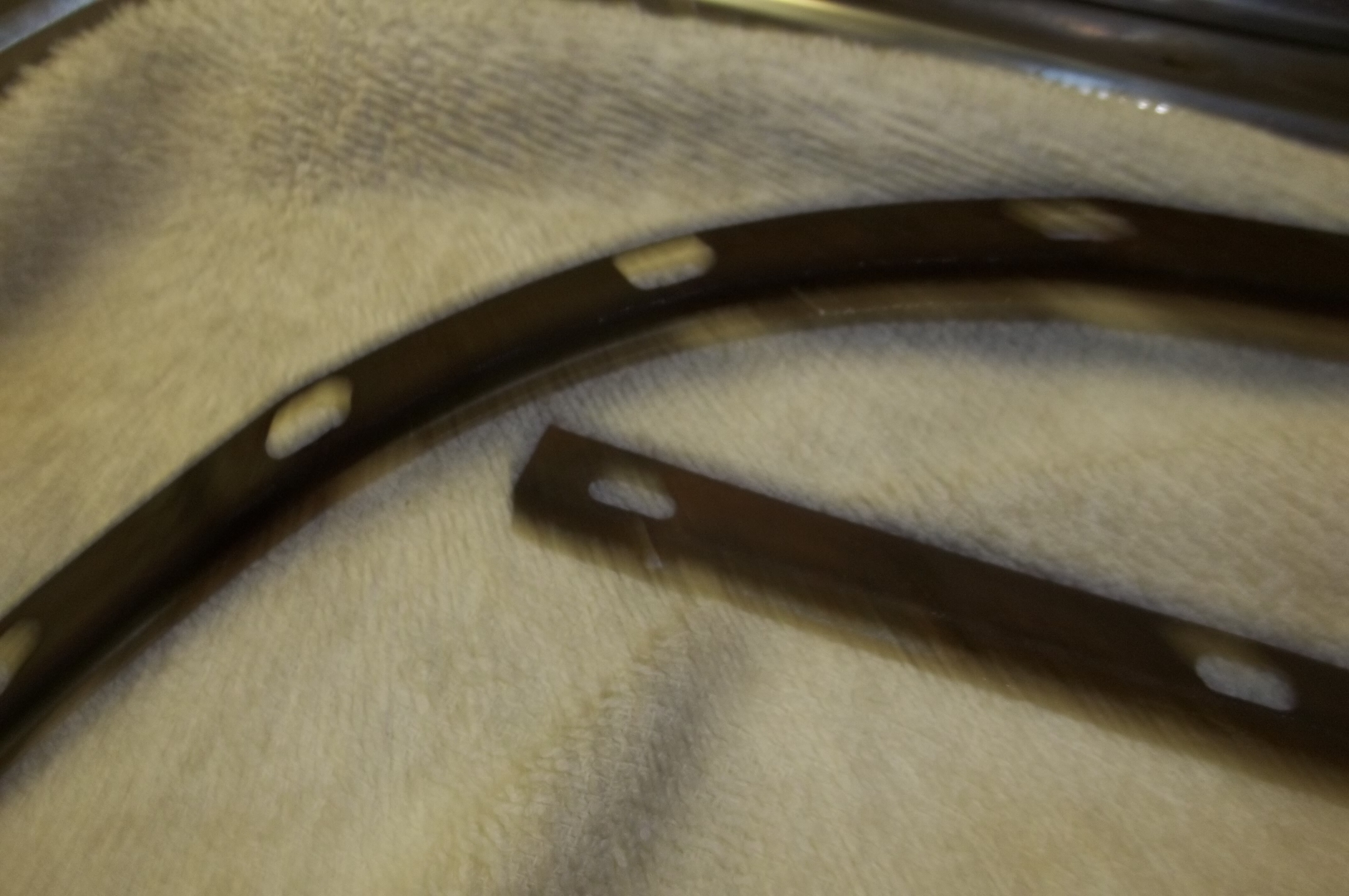

OK heas the pitchuhs, The darker strip for the top goes under the stainless moulding. Also showing the door latch thingy.
The second latches are for safety reasons, to keep the cvt doors securely latched, should the frame flex too much while driving.
The stainless snap track along the top edge of the back seat is where the boot snaps to. Matthew faced this and made changes. As you know, the Keijs bought my car; my upholsterer had put the boot snaps on the back seat upright cushion which was incorrect?..as the time goes by it’s getting harder to remember.
As to the purpose of the steel track…it was original equipment.. it supports the stainless track above it/keeps the stainless from caving in when the snaps are tightened down?..if you can do without it, I say OK.
Sorry, I can’t think of any better words to explain…we need Matthew BACK ON LINE providing pictures!
Dick, the dark strip is what secures the top to the car, I would definitely use it. The stainless is just for trim. If one would ever want to remove the stainless to fix a dent of re polish it, you could do that without the top coming loose. Make sure the screws you use to mount the dark strip are very low heads or countersunk so they don’t make a hump in the stainless trim when you tighten it down.
Roger is correct on the additional latch on convertible doors.
