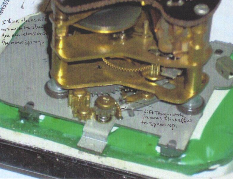

My brother seems to have found a way to adjust the speed of the clock. Its rather simple, but takes a while to zero in. If this isn’t general knowledge, i’d be happy to share. I think we also could advise on gettin it goin. Steve Storey
Steve, please share! I have one of those clocks that’s right, but only twice a day ![]()
Hi-To get a stopped clock going lubricate the various shaft bushings with a light oil ie trans fluid. I used a 1 amp battery charger to power it. Any 12v source will work fine. Clean the pick up coil contacts with fine sand paper. To expose the movemeent I had removed nut on back which also secures fuse block. Pry outword on either top or bottom. Refer to the attachements to find the adjustment cog. My brother says he doesn’t recall having to lift the tang to rotate the wheel? We both think you turn the wheel ccw in toward the center of the movement. I used my reading glasses as well as opti-vision viewer which is a great investment. Wearing those is almost like being 18 again!! Rotate a few degrees at a time. Its like watching paint dry. If you have any questions don’t hesitate. If you don’t think your cut out to be a clock repairer Matt said he would lube and adjust for $50 plus postage. Happy trails , Steve
