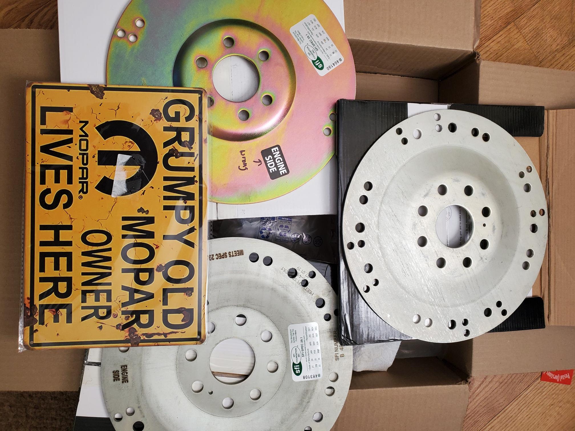

Ordered more performance flex plates, for 727 and 518 automatic transmissions. Still getting the side eye from some of my neighbors, that think I am working on ‘nerve gas generators’. Until their transportation leaves them stranded, then all of the sudden I have new friends in need. Pictures are for educational purposes only, not smut, just naked car parts. Rick
Sweeeeet, Rick! Are these flex plates going in transmissions for personal consumption, or are you rebuilding other folks transmissions as an avocation? And shouldn’t there be bullet holes in that sign? :smiling_imp:
Say hi to John for me - we miss him in these parts…
One plate is for me, others for customers. My sign does have holes in it, this sign is for John Q.

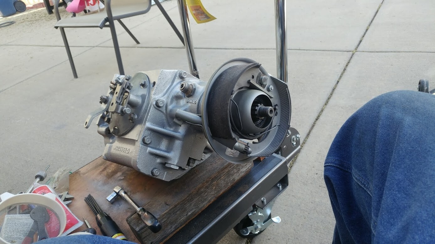

Helping a friend pull a M-6 transmission from a 50 DeSoto, it has the same emergency brake arrangement. So the same system seems to have been used from 49 to 1962 Chrysler products.
My '63 Valiant wagon uses the rear drum braking system for emergency brakes, Rick (as well as having a park pawl for the transmission). That’s consistent with your observation.
What did Mother MoPar do for emergency braking before 1949? Or are emergency brakes a post-WWII invention?
Dan, My 47 WC pickup has an external band on drum, ratchet lever locked in place until center button is pressed to release ratchet saw sprag Adjusted by threaded bolt and centering limit, on bracket.
