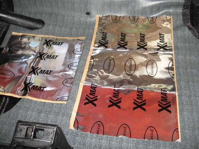

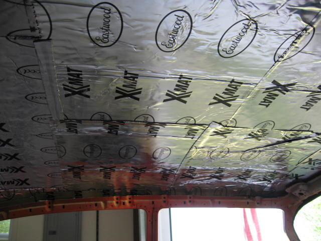

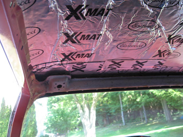

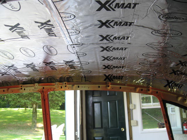

But you might want to think about using Eastwood’s X-Mat - others on the Forum have, with success: https://www.eastwood.com/x-mat-sound-deadening-material-5pc-12x12.html?SRCCODE=PLA00010&gclid=EAIaIQobChMIl6vymJPh5QIVk5JbCh3DBQPKEAQYASABEgKzHPD_BwE
I used 3M adhesive spray for the ceiling tiles, but X-Mat has it’s own adhesive right on the squares - you just peel off the paper backing and stick in place.

Art, it’s a little pricey, but you may want to use Eastwood’s X-Mat - Mark Merritt used it in his Fury to great success. Check it out:

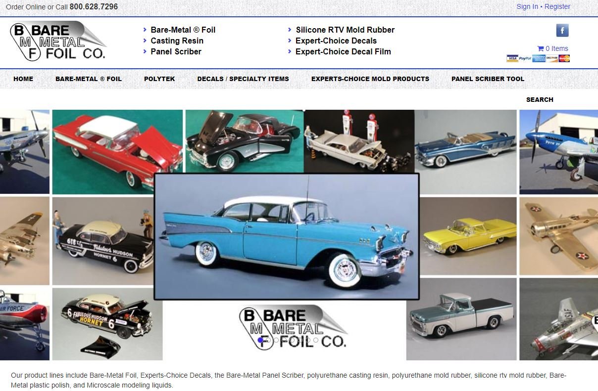

Hi Art, I haven’t tried this stuff myself, but I remember Dave Stragand (The Forward Look Network) recommending it. It’s chrome foil with an adhesive back.
Here’s their website: Bare-Metal Foil, Silicone Mold Rubber, Polyurethane Mold Rubber, Casting Resin
Maybe this would work for your retaining strips?

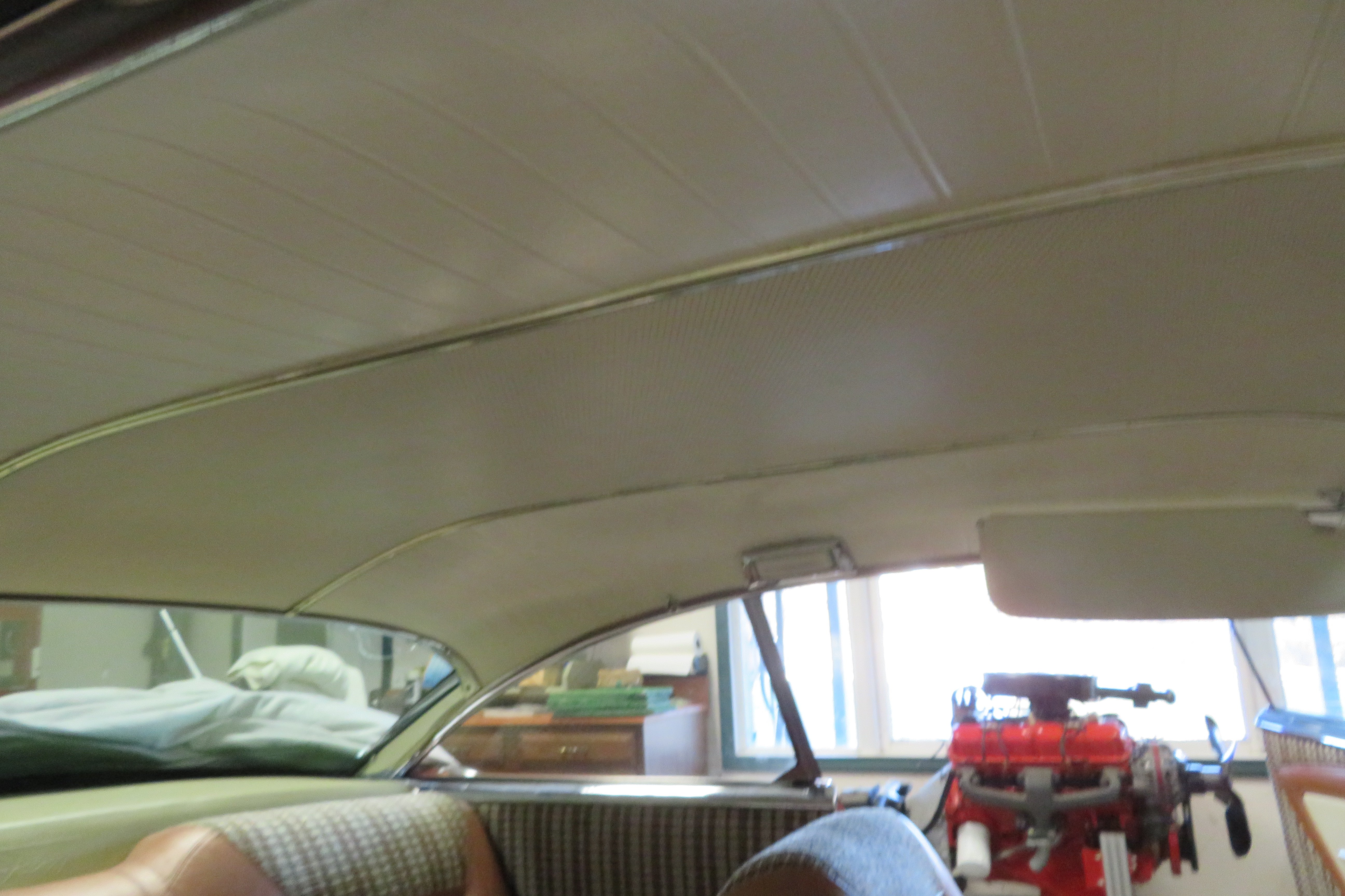

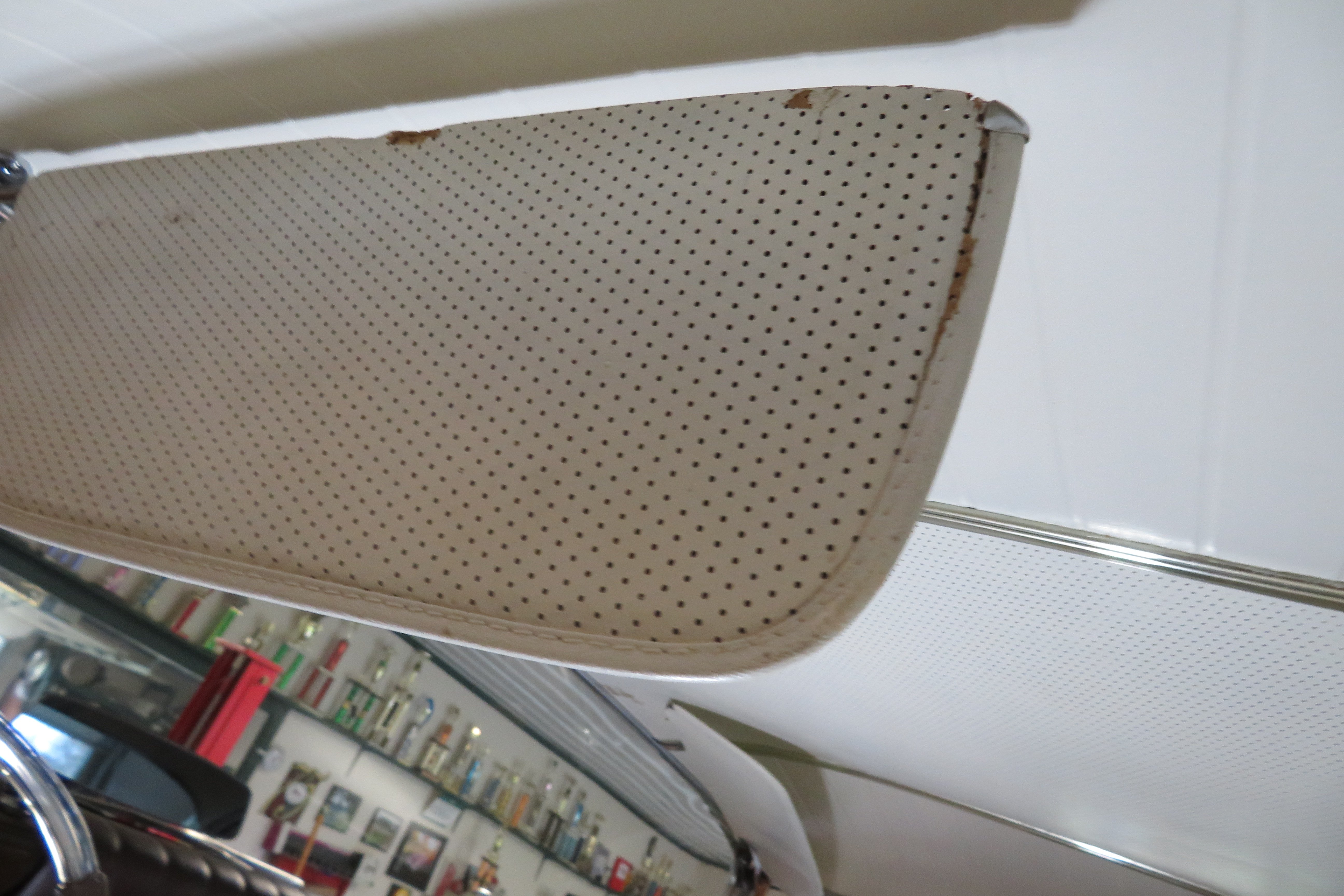

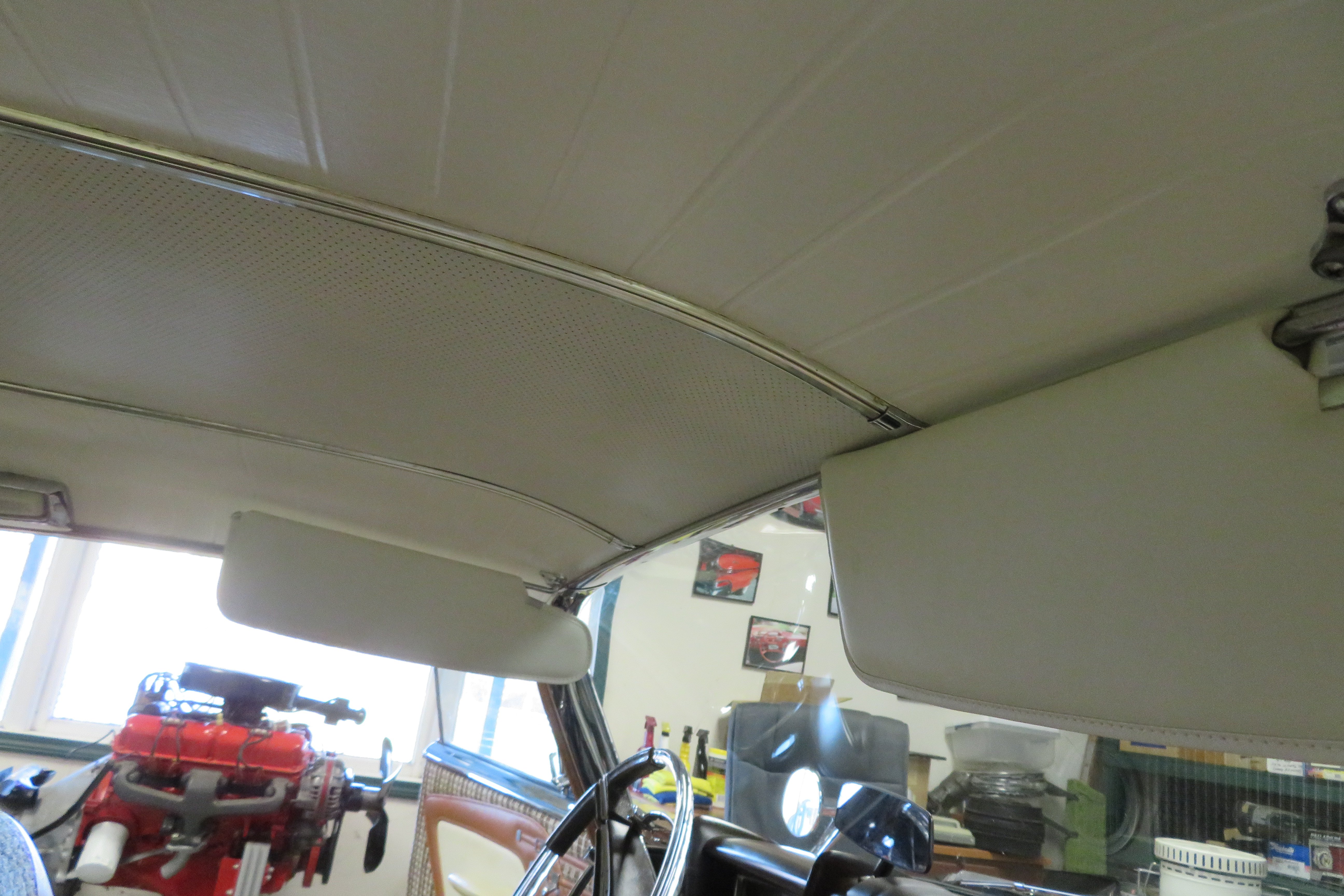

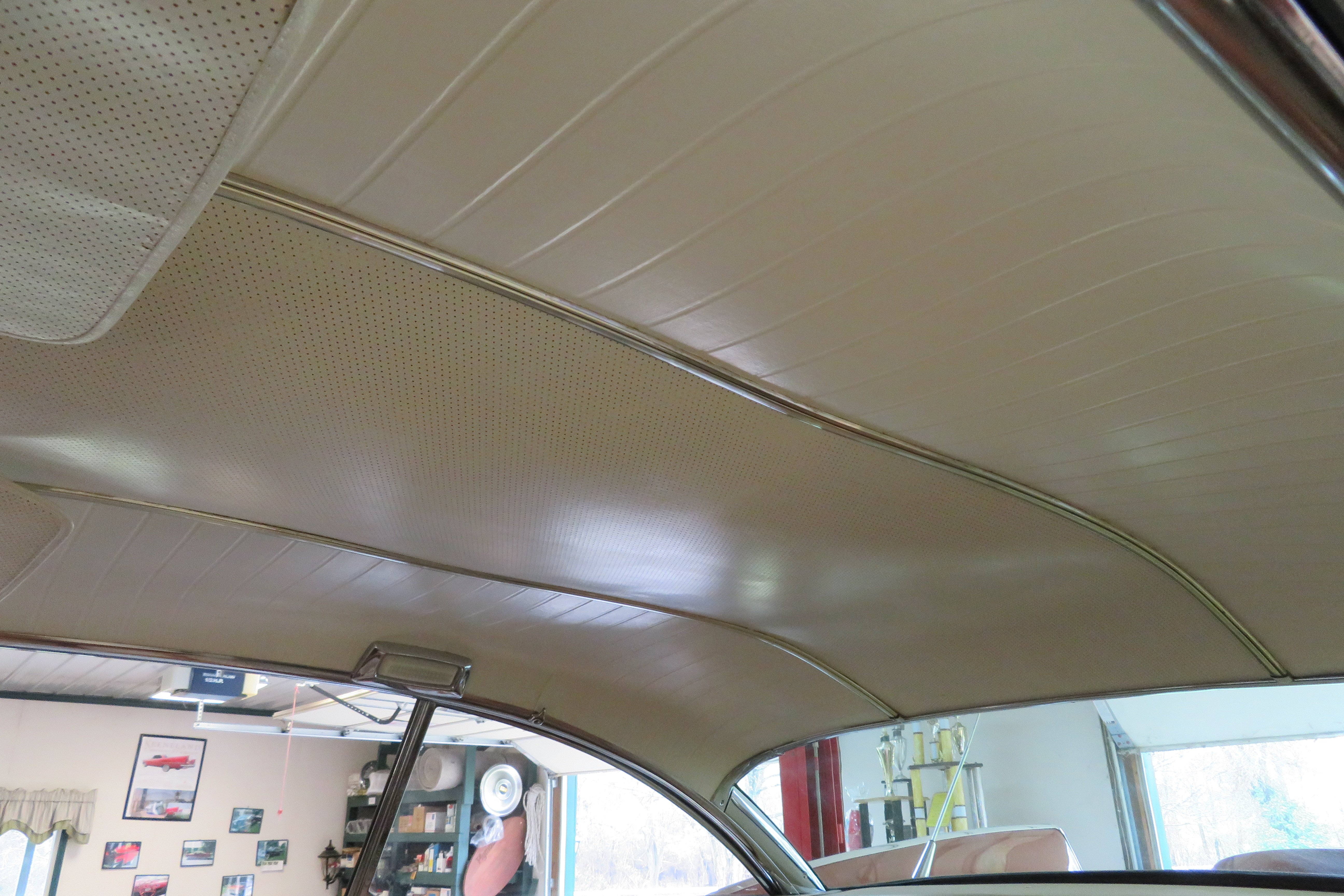

I am going to try and insert photo’s of the headliner work. The first photo shows the sagging condition of the liner (person who did the work said
it was on the verge of dropping in it’s sagged condition. The second photo show the Sun Visor that were in rough shape. (I believer they were the originals from factory) The third photo shows the center headliner re-installed along with the Visor’s having been recovered also. He spray painted
the center headliner while out of the car to cover the Visor swing marks.
