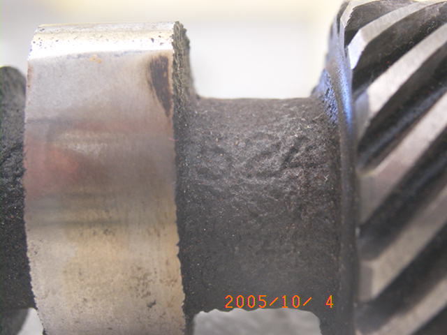

In a box that came with my SF almost 20 years ago I found a camshaft. It was told to me that this camshaft was the original one and was replaced just before the car was sold to me. The cam shows the number 524.
Here is the problem:
My 318 shows a compression of 130 psi. on each single piston, what’s inside the required tolerance of 125 – 160 psi. Yet the engine appears very tired and doesn’t respond as I think it should.

  • Is it possible to identify the cam by this number (524) and if not how do I know what cam-lift and cam-duration this cam has?

The stock Fury grinds for 1957,58 were 256/.405 and 260/.405 respectively. Aftermarket grinds were approx. 240/.387 to 256/.400 or thereabouts.
The cam you have pictured is not a Poly camshaft and will not work in your Poly engine.

But let me ask the question again. If the pictured cam is not a 318 poly cam the guy must have lied to me, and if so what did he put into my engine? How can I identify the grinds of this cam?
