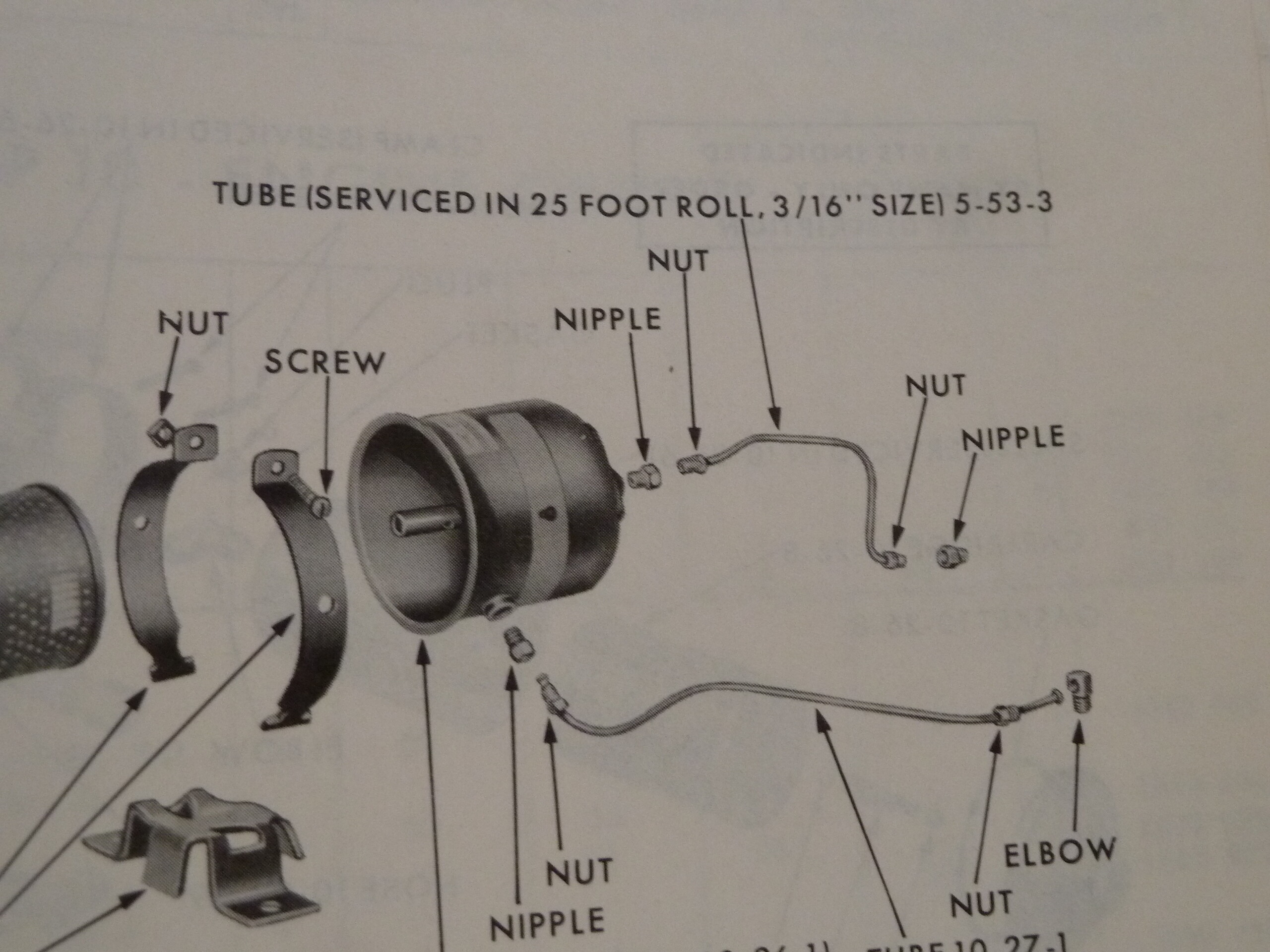

What are the proper sized oil lines for the bypass oil filter on the straight sixes? Both of mine to and from the filter are 5/16" brake lines, this seems a bit small to me. Does anyone know the correct size or is this in fact correct?? Any help appreciated.
Steve
According to the Parts Book, it is 3/16"!

In the Book, there is one other schematic of an oil filter- it shows the same 3/16" lines. To us that seems crazy.
