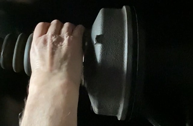

OK: No more excuses. Today I finally got Faulkner up on all four corners, and crawled underneath. And doncha know:
While the trunnion housing doesn’t budge a bit, the driveshaft slops around inside of it as I torque it back and forth. I think I’ve found my culprit.

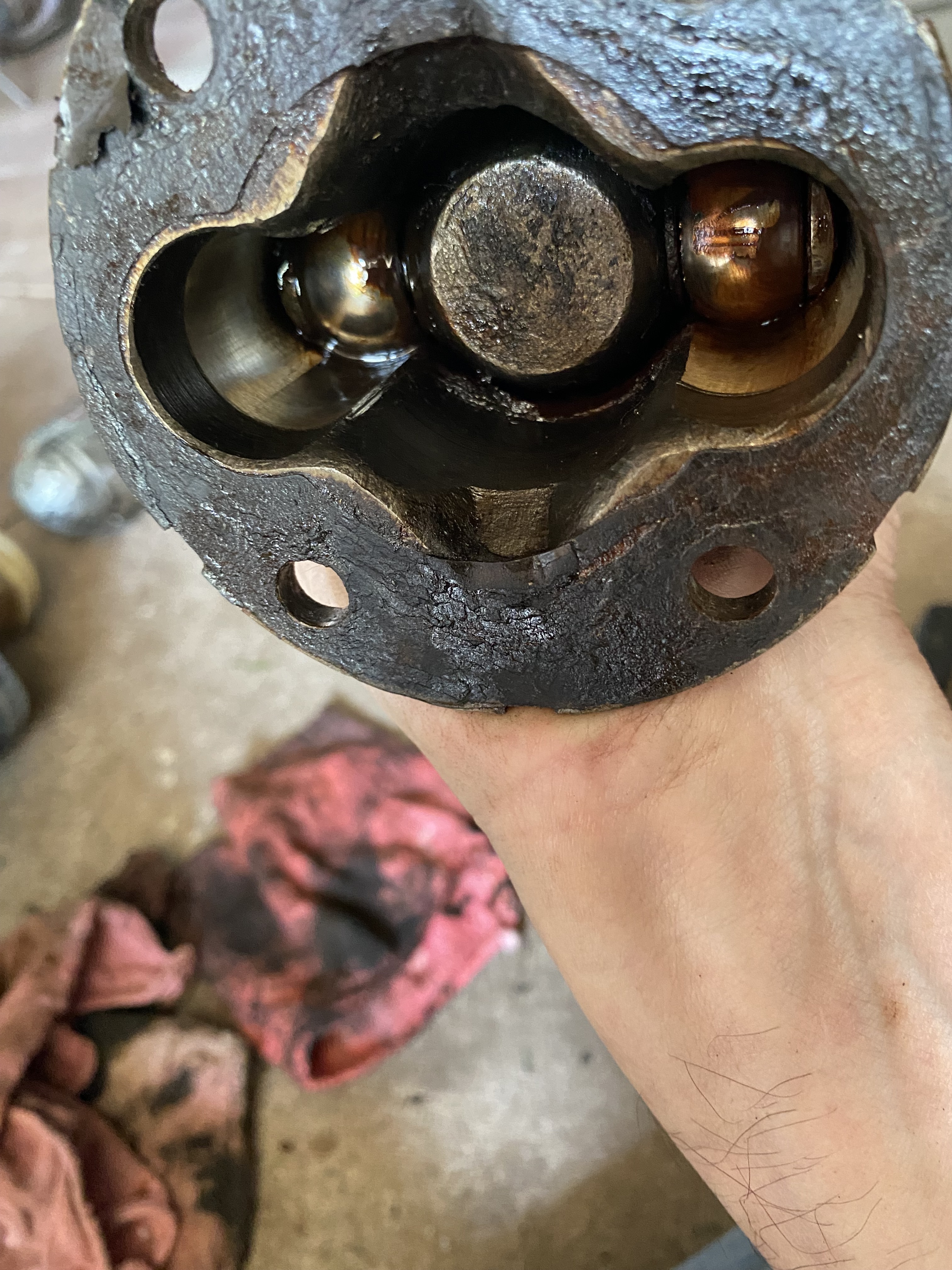

OK, the driveshaft is down, and I’m looking down the barrel of the trunnion joint…
The housing has been sleeved! Is this the way they came from the factory, or was this a unit refurbished somewhere in Faulkner’s history?
The bad news is: With the ball assemblies out, I can feel ridges in the sleeves. This housing will need to be replaced. Anyone have a bead on P/N 1739 920?

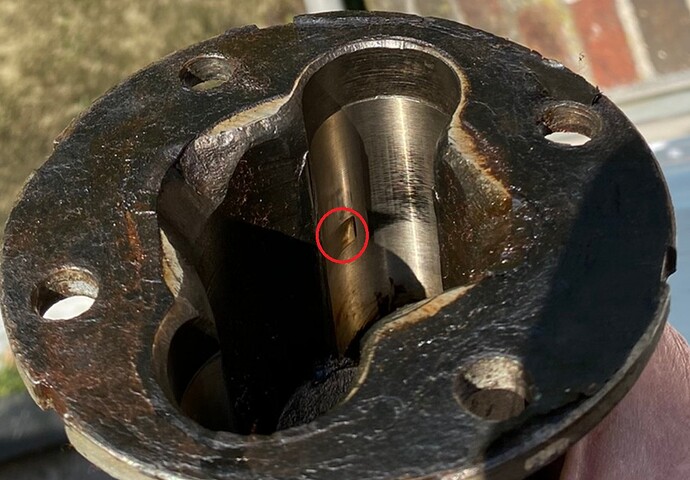

OK - found a moment to run out to the garage, and drag the driveshaft into the daylight. Sorry for the shadows, but I think you can figure it out.
What I’ve circled in red is actually a slight indentation - northeast of that is what I think is described here as “brinelling”.
The other side looks (and feels) similar.
