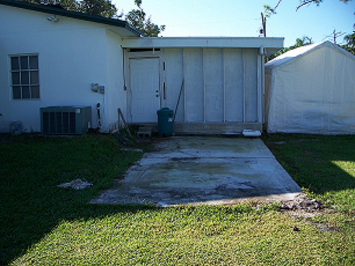

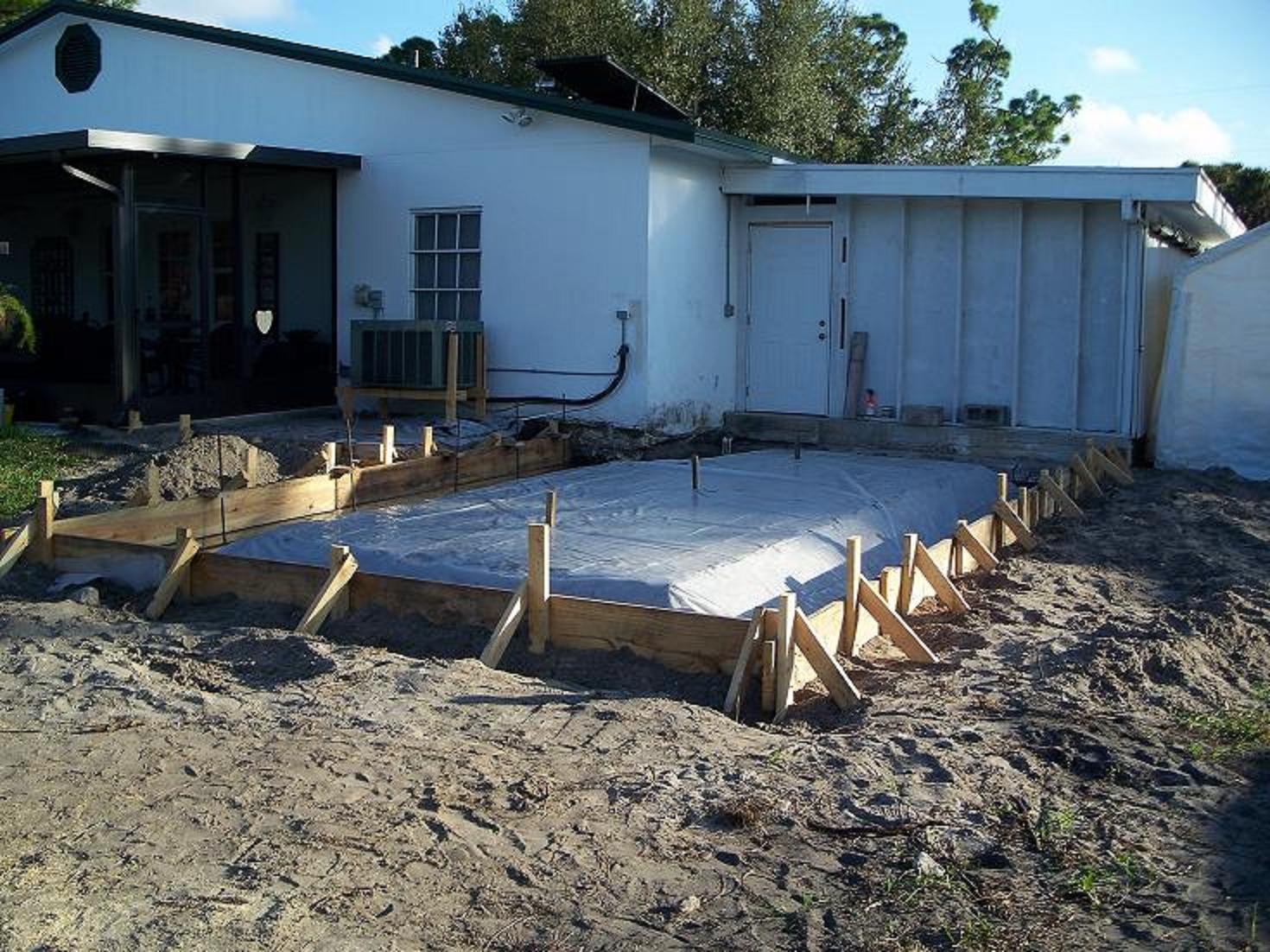

There was a 10’ x 20’ prefab shed on this slab that was moved to a corner of the lot. The shed is where I do Stainless and Alum. Dent repair and Polishing. This slap had to be broken up and hauled away.

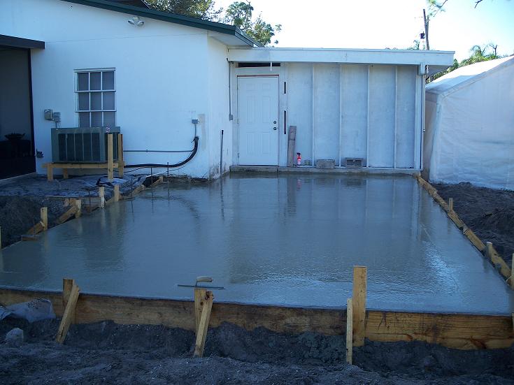

The Slab is 16’ x 30’.
The concrete is 12" deep x 36" wide where the Lift will be mounted.

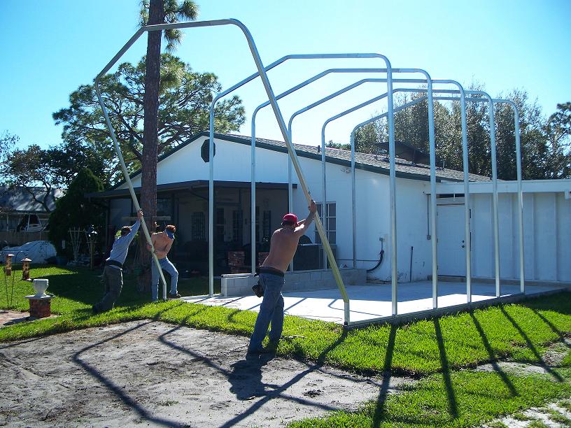

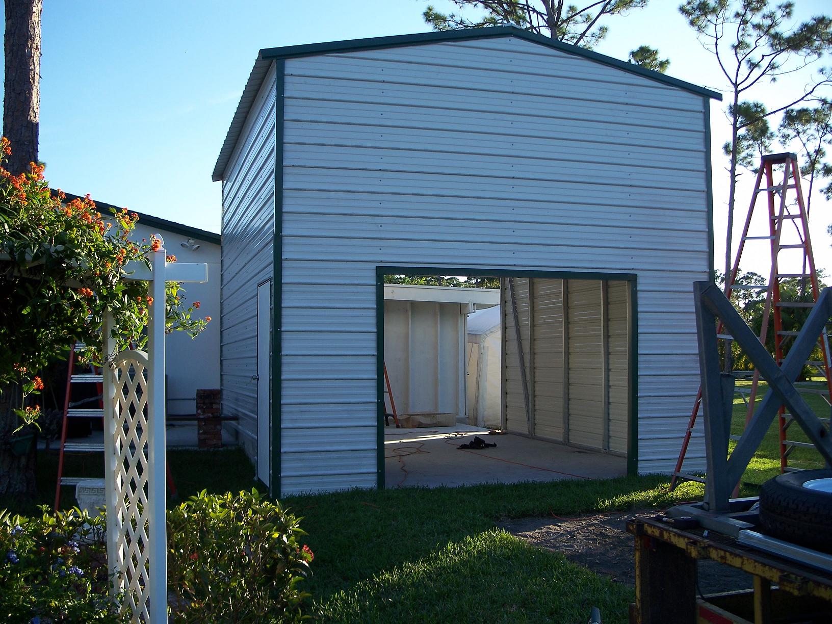

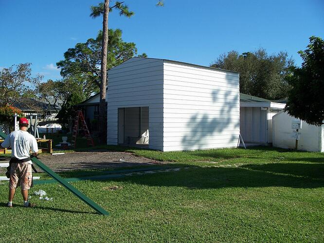

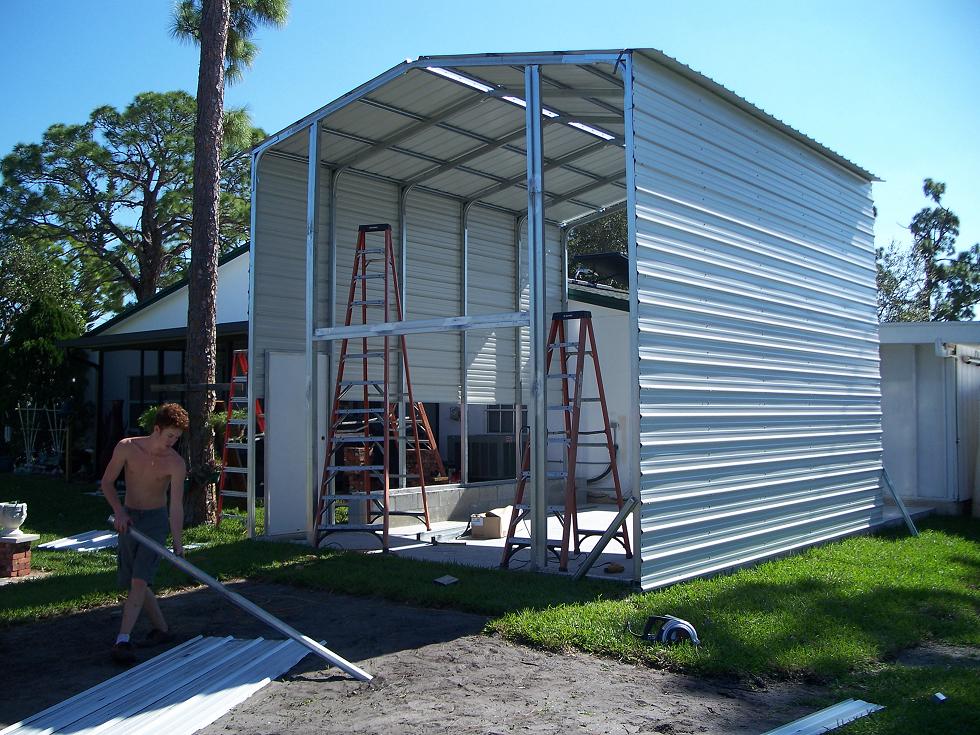

Going Up.

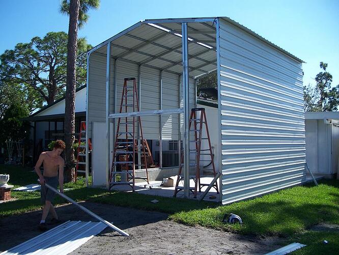

The 8’ gap between the old garage and the new will be framed in and then covered with the same metal siding. The roof will match the old garage.

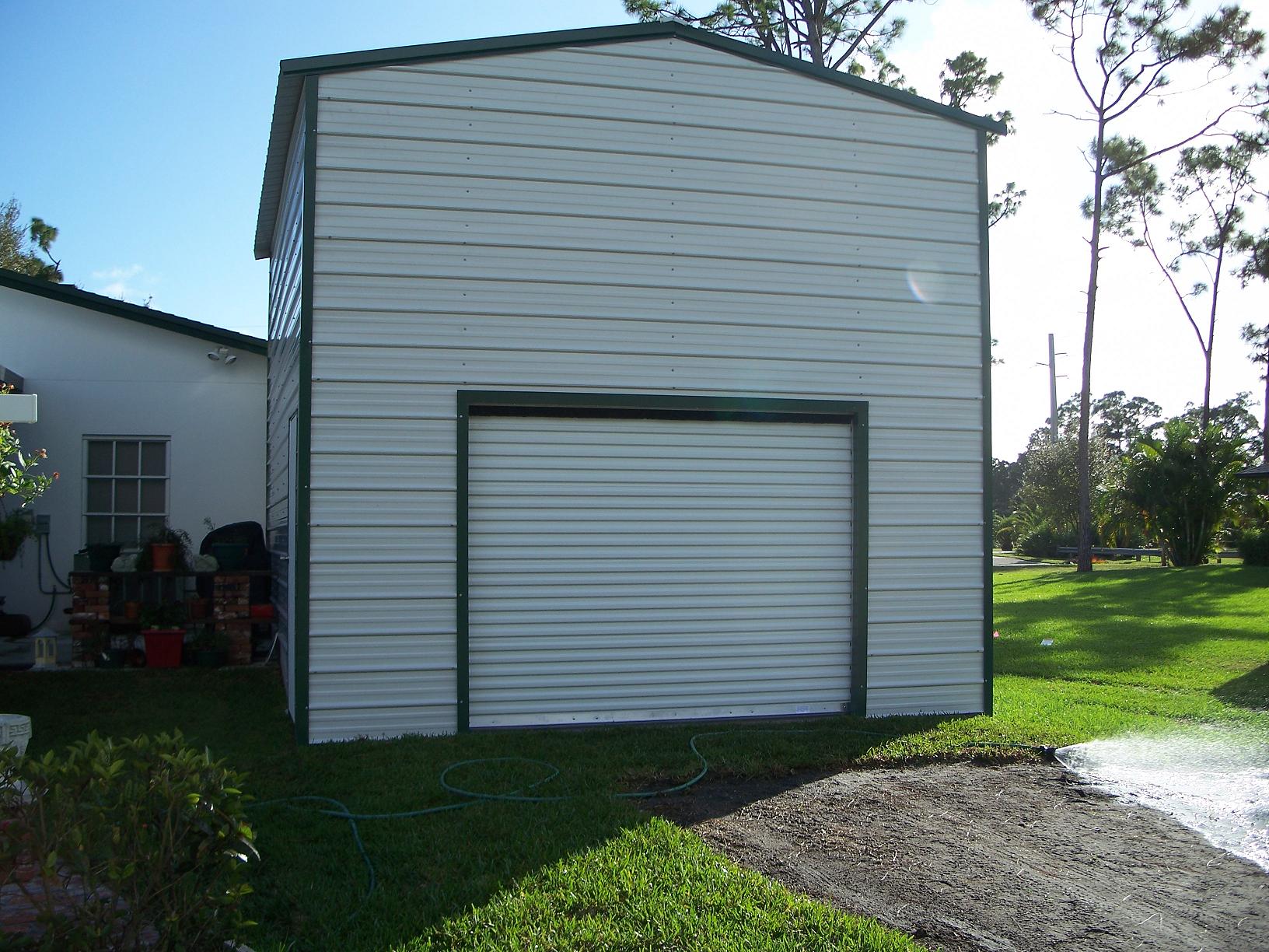

Ready for trim.
Trimmed out.

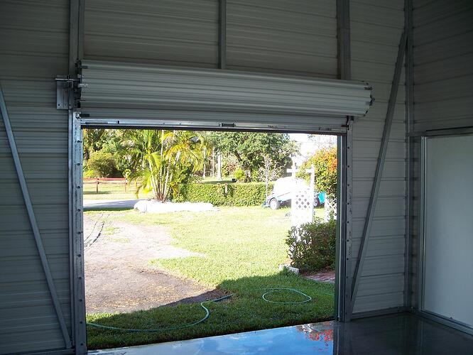

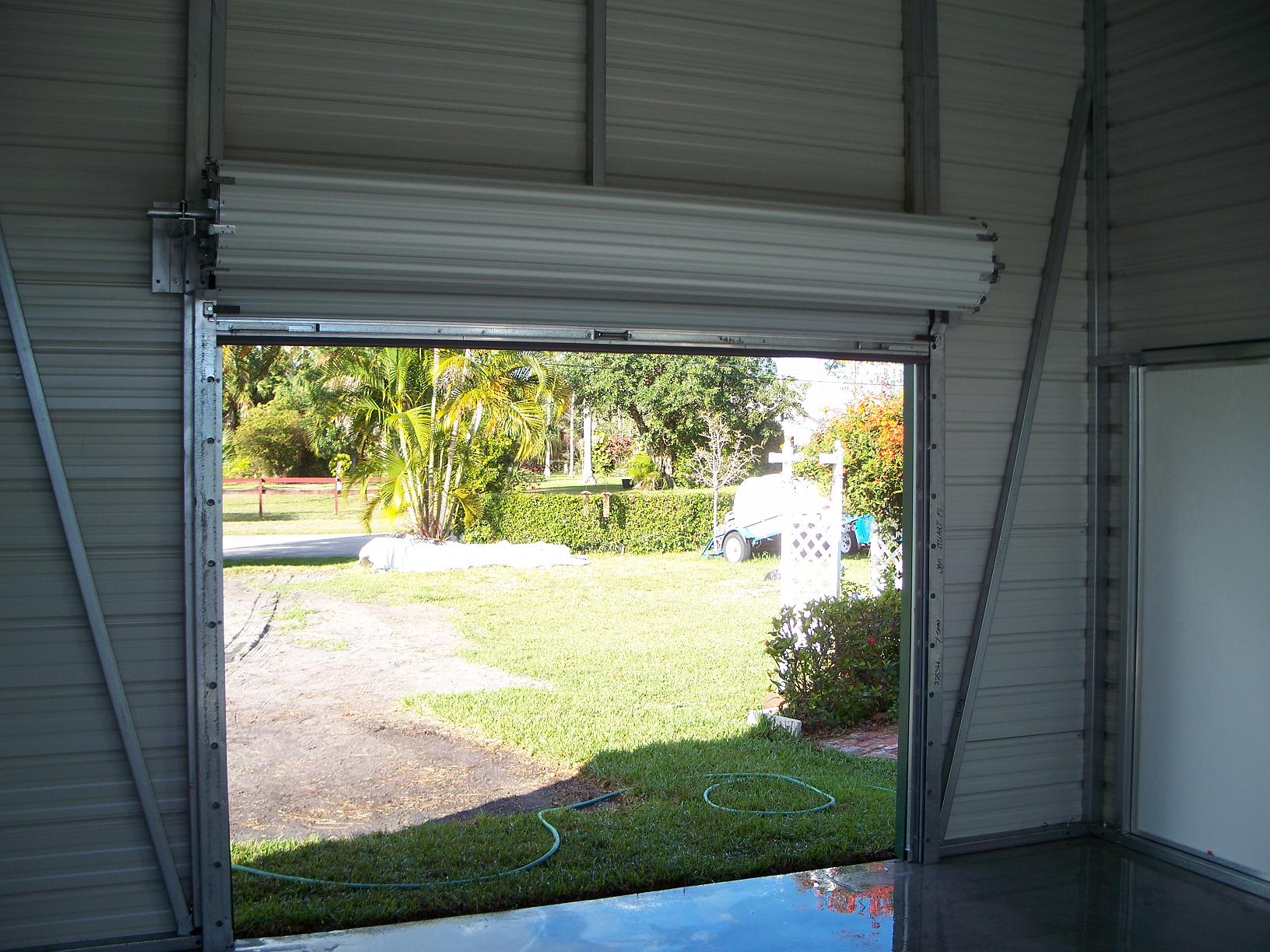

The door looks small but I can get my E-150 Van thru it.
Garage and entrance doors installed.

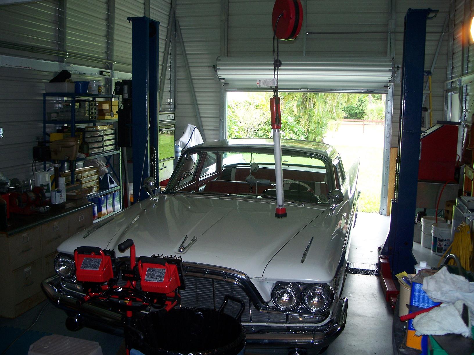

It’s tight but not too bad, The Desoto just clears in front and back.

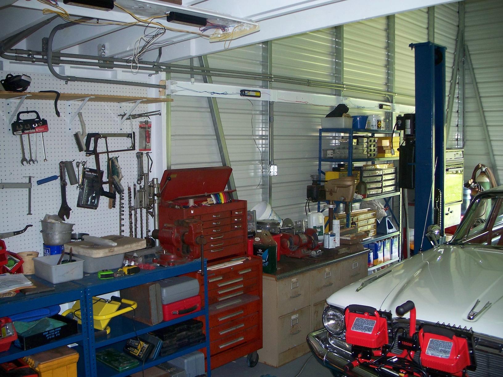

Installing all the electrical, 220 for welder, powder coat oven and lift. Used filing cabinets at garage sales make excellent parts storage.

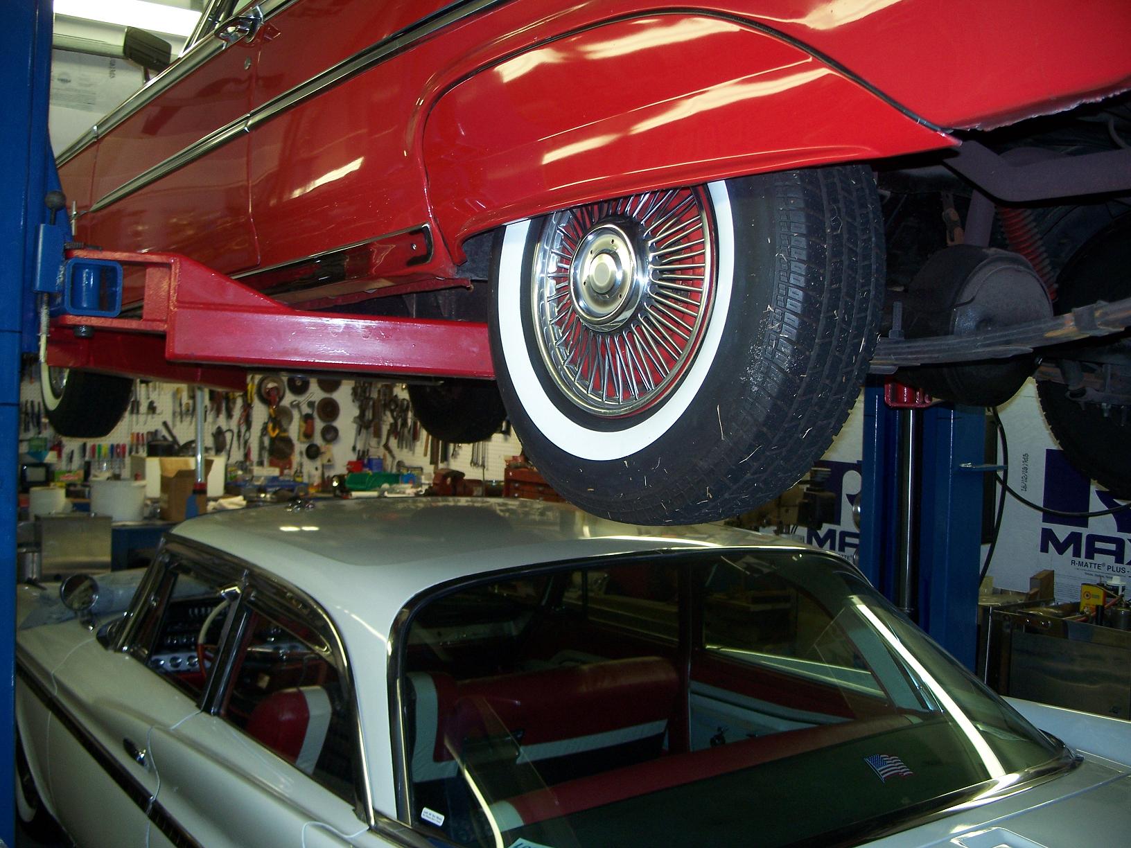

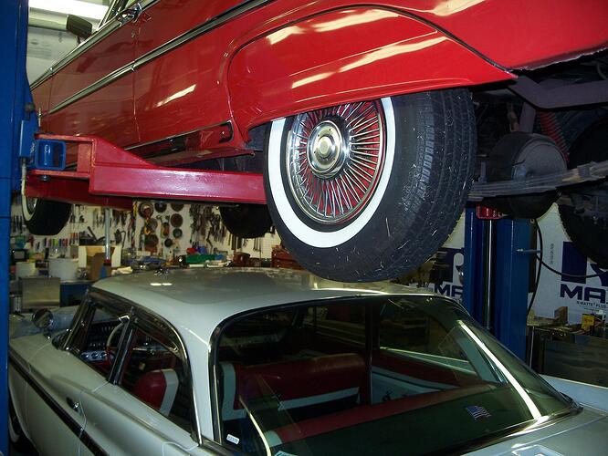

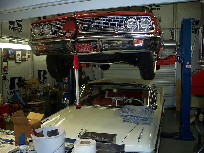

This is how they will be stored, you can see a drip pan under the ford but it was a pain putting up every time. Now I just clamp that blanket you see on the hood of the Desoto, makes it a lot easier.
Sometimes you get so lucky its scary. I found those fender skirts on the Ford on ebay. The paint was an exact match.

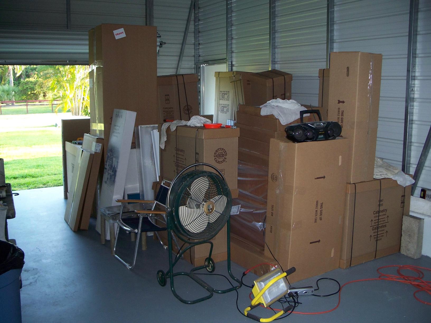

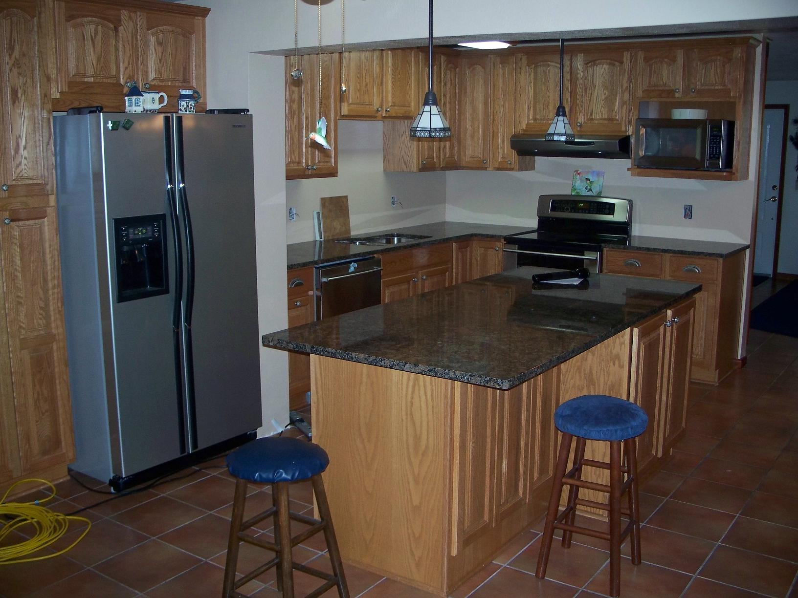

OK, not for the expensive part, This is Yvonne’s new kitchen before installed. That Oster fan is the first appliance we bought when we got married in 1960 (48 years ago) we had no Air Conditioning.
You gentlemen are looking at the cost of a new garage, only thing left is the backsplash. Some people will do anything to get a GARAGE WITH A LIFT. Dat’s all folks.

Kitchen is beautiful! Wish I lived next door so I could borrow the lift!!
Thanks Steve and John - The lift is a Itchey Scratchey sold as a Superior Lift and marketed by Eastwood. 9000 lb. capacity. At first I wanted a four post lift because a couple of my friend have four posts lifts but they are always jacking up a wheel when ever they do suspension or brake work. I’m glad I got the two post because I can easily do suspension and brake work and still store two cars. I bought the lift used from a local car guy that was moving and had to get rid of it. I paid $1,000.00 for it, he paid $3,500.00 plus freight from Texas to Florida. Heck, you can get them today for $1,495 brand new plus freight. He had the lift installed outside with no weather protection. I tested it and it worked fine, the problem was water had gotten in one of the cylinders and when I laid it on it side for a year and a half it rusted badly and leaked oil like crazy. Had a rebuilt cylinder installed for $350.00 and now I’m good to go. No more cars, four is enough, although I would trade my Ford and Desoto for a 57, 58 or 59 Convertible. My first NEW car was a 57 Belvedere Convertible (Age 21). Besides if I got another car my wife would divorce me and probably get the cars. I’d rather have her anyway, she’s a keeper. If you guys ever get to Florida, look me up and I’ll let you use the lift.
