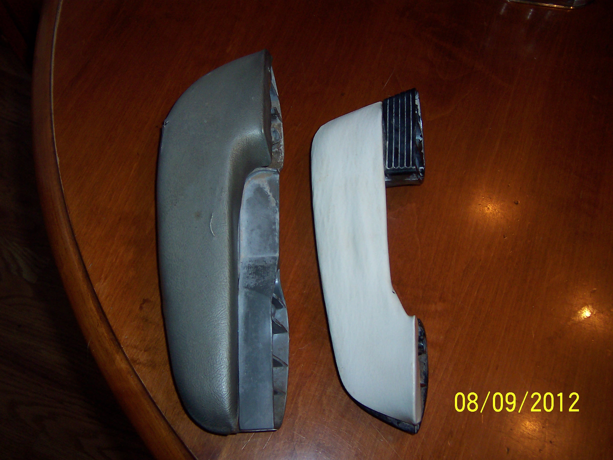

I am at the point where I am going to be installing a set of armrest into my car on Thursday, They still need to be re-padded and all but I have to put something in for this show this weekend.
Question is to me, are the armrest and their bases the same for SF interiors as they are for Belvedere Interiors? I thought they were but in examining some SF pictures they look fuller and longer. I did put a SF interior in my Belvy, The door panels are the SF type.
I have one original SF door panel in the basement (rough shape) but the Belvedere armrest is smaller then the imprint left in the door panel. I have a set of larger Arm rest that fits that pattern to a “T” but could that old original panel be a mistake? I thought the larger set I picked up on ebay was for a fuller senior Chrysler/DeSoto.
I looked in the parts catalog and could not find a section on armrests. Maybe I missed it but need to know quicky which way to go. I hate to put a larger imprint in the door panel by putting on the wrong armrests. :confused:
I know it is hard to ask this question without pictures. So here they are.
The arm rest on the left is the one that fits the imprint, size and shape that went with the single original Sport Fury door panel. The one on the right is the one that is exact to the one I took off my Belvy door panel when I started this restification of my convertible.
Is the one on the left the one that you SF guys have on your car?
I have the larger ones on both of my cars. I know the big one is standard on a SF. I think the smaller ones were on four doors, and others. I"m sure a lot of us would use the larger ones on a rebuild when we had them. My Belvedere convertible has a lot of options that I added during it"s build.
Tom
Thanks Tom! That confirms that there was a difference that I never thought of. I was getting the smaller ones ready to mount and was checking orientaion of which one went right or left hand side when I noticed that the SF version looked bigger in some of the Showcase pictures.
And then when I compared the pattern to the single old SF door panel I have, I knew something was amiss. So that is another item that is better on a SF version is a more comfortable arm rest! Glad you knew! :smiley:

My SF has the Left type as shown in the photo.
