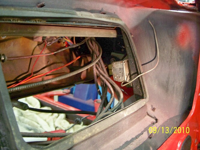

This switch (see pitchuhs) with what I assume is a temperature sensing probe is mounted on the firewall right next to the AC recirculating door, when I removed the evaperator box I found the probe going thru the recirculating door opening into the evaporator chamber. Seems to me that will interfere with the door closing properly, (by the way I found the door in a shambles, sent it to Gary Goers and he made it like new) My question is: Should the probe go thru the door into the chamber or hang out in front of the door to sense the temperature so as not to interfere with the door closing. The wires on the swith are routed to the blower fan motor. There is no picture of the switch in the manual or parts book but the part # on the swith 1885864 I found it in the index at 24-28-241 Page 24-6. What chall think.

Look closely just below the lower left (drivers side) corner of the opening…is there a little grommeted hole there?
A Mopar filmstrip I have shows the sensor going thru a grommeted hole located very close to the flapdoor.

Thanks for the reply Roger, There is no hole of any kind, I suppose I could drill a small hole and put a grommet in it for the probe if I was certain thats where it goes. I forgot your car is Air Conditioned, could you look under your dash and see if you have that switch and where the probe is routed. It would be much appreciated.

Roger - Didn’t mean to put you to all that trouble. Looks like that may be the answer, I’ll have to drill a hole and use a small grommet. I havent fiqured out how to contact John Fins59 can you help me with that.

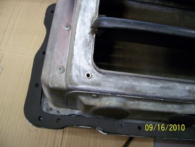

Roger, Roger - I found the hole, I knew if you kept after me long enough I would find the hole. ahem!! It’s in the evaporator housing. see pitchuh.
SUCCESS! :smiley: :smiley:

…and I don’t think you need a grommet…
No, you don’t, on the other side of that hole is a tube about 1-1/4" long that quides the probe into the evaporator coil.
Thanks for that bit of information. As I wrote earlier, my a/c came as parts, shipped from out-of- state..I never saw the parts car, and obviously some parts (such as this “tube”) stayed with that car, which no longer exists.
Is the tube closed off at the far end?
when you look at the hole in the evaporator housing you are looking at a metal flange that is part of the tube, the tube on the other end is open and ends right before the fins on the evaporator coil. all the tube does is direct the temberature switch sensor (probe) into the evaporator, i pushed mine as far as it would go.
