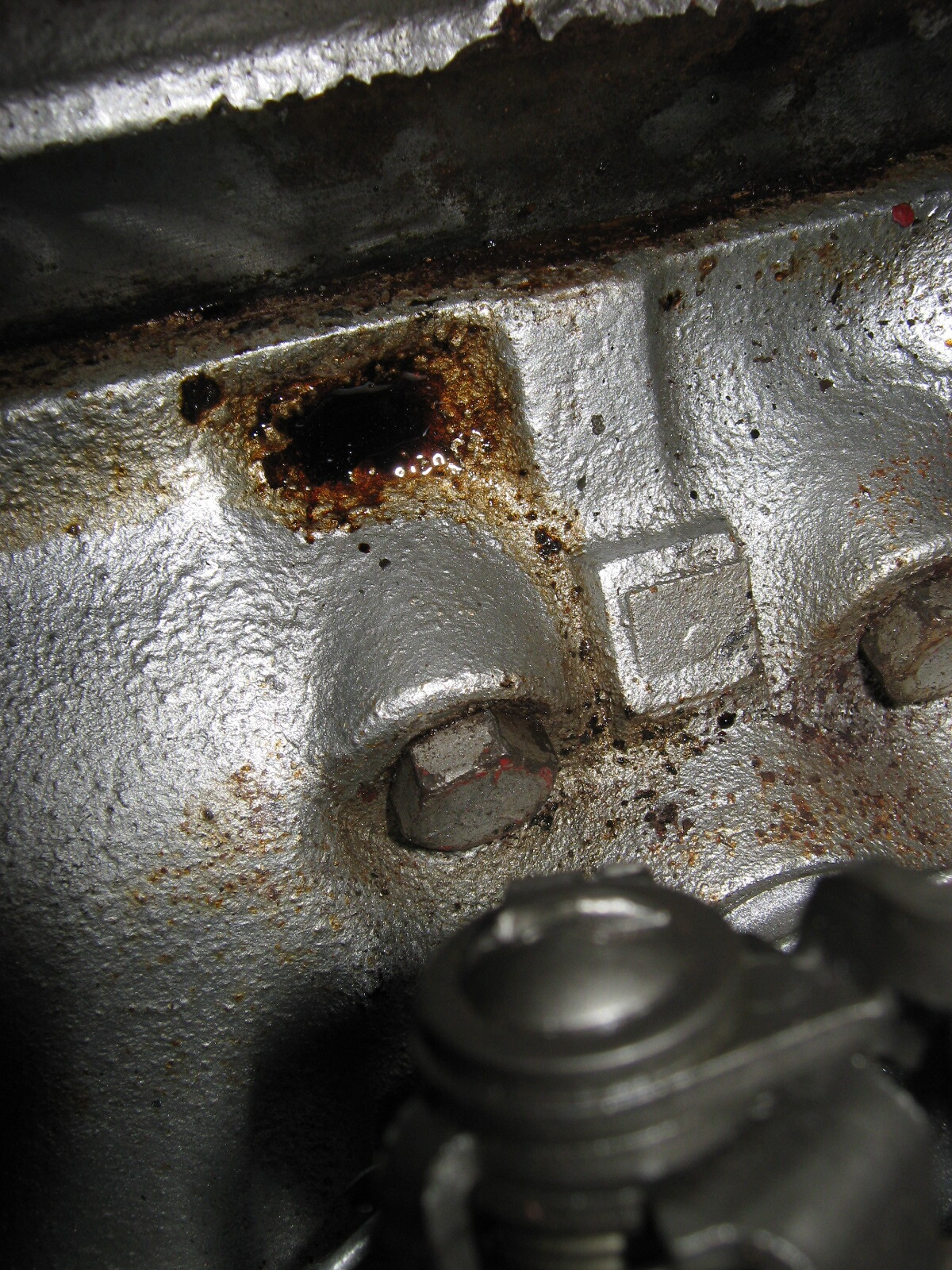

So I pull Faulkner into the garage, and I pop the hood. And doncha know: I see antifreeze percolating on the left side of the intake manifold, even worse than when I had my mechanic pull it for this same reason.

If this is the case, it’s not documented in the shop manual – at least, not as far as I can see. The shop manual only makes reference to the 6-cylinder exhaust manifolt cap bolts needing sealer, but not the V-8’s – yet, I know 318 exhaust manifold bolts leak if you don’t permatex them, so they penetrate the water jacket. And a telltale sign, as I closer inspect my intake manifold: there’s an evaporation stain coming from the head of a manifold bolt, with a trail leading to the pool where fluid was bubbling with the engine heat.
I think the bolts are the culprit, not the manifold gasket. Anyone else care to wager an opinion?

Well, I had really jumped to conclusions. It wasn’t antifreeze – that would of course have been green – but more than likely fuel. I called Ed Eckerson and we discussed; he thinks more than likely, I’m running rich and the fuel is blowing out the throttle plate rod. And that makes sense, because the stuff is evaporating, just as you would expect gasoline to do. And he inspected the heads on a 318 he had; the intake bolts do not penetrate the water jacket.

Well, I had supposed that my problem with antifreeze had to do with exhaust manifold bolts; that’s one of the things I had my mechanic look at. But today I put Faulkner up on the ramps (didn’t get around to installing your lift, yet, Dick :blush: ), and crawled under. Lo and behold – all the exhaust manifold bolts are bone dry. But, antifreeze is slowly dripping from the passenger side of the car…
And then I see it. It seems to be slowly seeping out from under the head! Right at the rearmost bolt… Oh No!
Could it be that by my mechanic putting some pressure on the heads – either by pulling and permatexing exhaust manifold bolts, or by reseating the intake manifold – the head loosened up a tiny bit? I remember when I got my flathead six rebuilt, the engine guy told me to retorque the head bolts after a time. I never did that for this rebuilt engine – is that something I should have done? Should I try to retorque the exposed head bolts, and see if that stops the leak?
The good news is, there’s no water in the oil. But this is scary stuff – and I don’t want to do the wrong thing. Any one have some good advice for me?
I just spoke to Ed Eckerson; Ed says that, while the intake manifold bolts don’t penetrate the water jacket, the surfaces of the intake manifold do come in contact with water passages. There’s a chance that the leak is coming from there…
Ed seems to feel that of the two, it’s more likely that it’s the head gasket – and that it couldn’t hurt to pull the valve cover, and try to retorque the bolts. But to me, given that the intake manifold has just come off – and, that the leak is worse than it ever was now – that could be implicated.
Ed told me to clean the area up real good, put some water color paint on the area, fire it up and let it come up to pressure – then turn it off. He thinks that will reveal where the problem lies.
(Hey – maybe the intake manifold bolts need to be retorqued…)
And that’s exactly what I’m going to do – first. It turns out, there’s a little pool of antifreeze in a recess at the back of the block, where it mates up with the bell housing, well above where the head meets the block. This sucka is leaking from the intake manifold – lucky for me.
And if I have to pull the intake manifold, I’ll do it myself. I have an extra gasket kit from a shipping mistake.
Every stinkin’ bolt was under 30 foot-lbs; every stinkin’ one. Probably somewhere between 20-25. I started at the center, went side to side, working my way to the ends (sound familiar, Roger? :astonished: ), and snugged it up. Gave it a nice coat of high-temp silver, slapped the coil and carb back on, started it up, brought it up to temperature… Then started looking all around. And I saw…
…the leaks were gone!
Thanks to Ed Eckerson, yet again, for his sage advice. This could have been ugly, but it ended up being inconsequential. Feel like I dodged a bullet (and seriously worried about making Carlisle).
