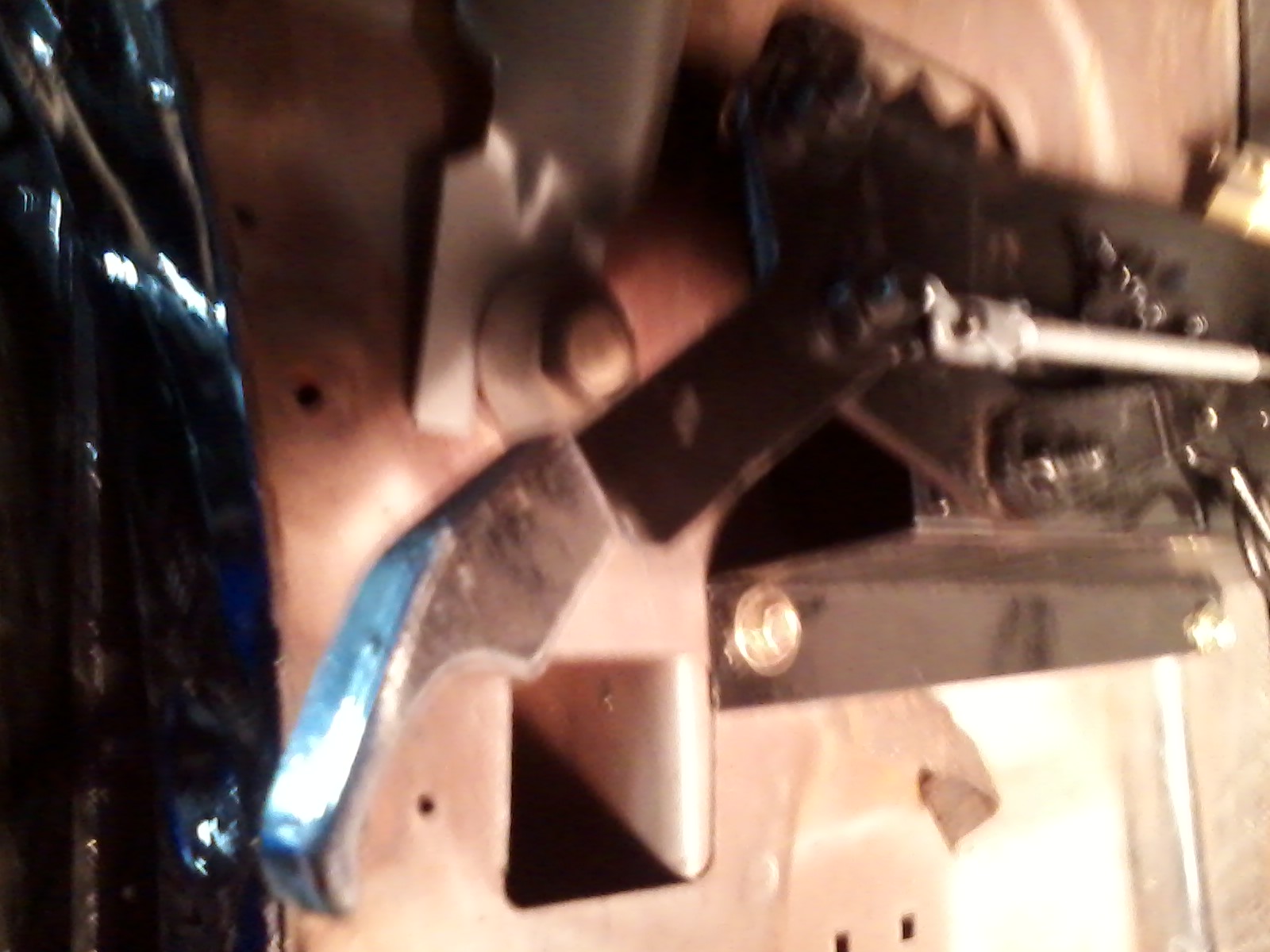

  2. Fabricated a sheet metal box that would fit in the space to the left of the current parking brake handle. I attached the handle assembly
    to the box, using the handle’s original attaching bolts. (Picture 1)

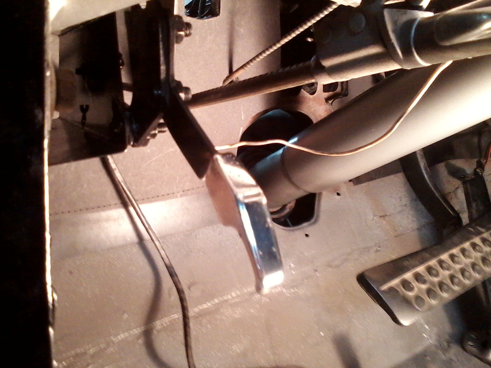

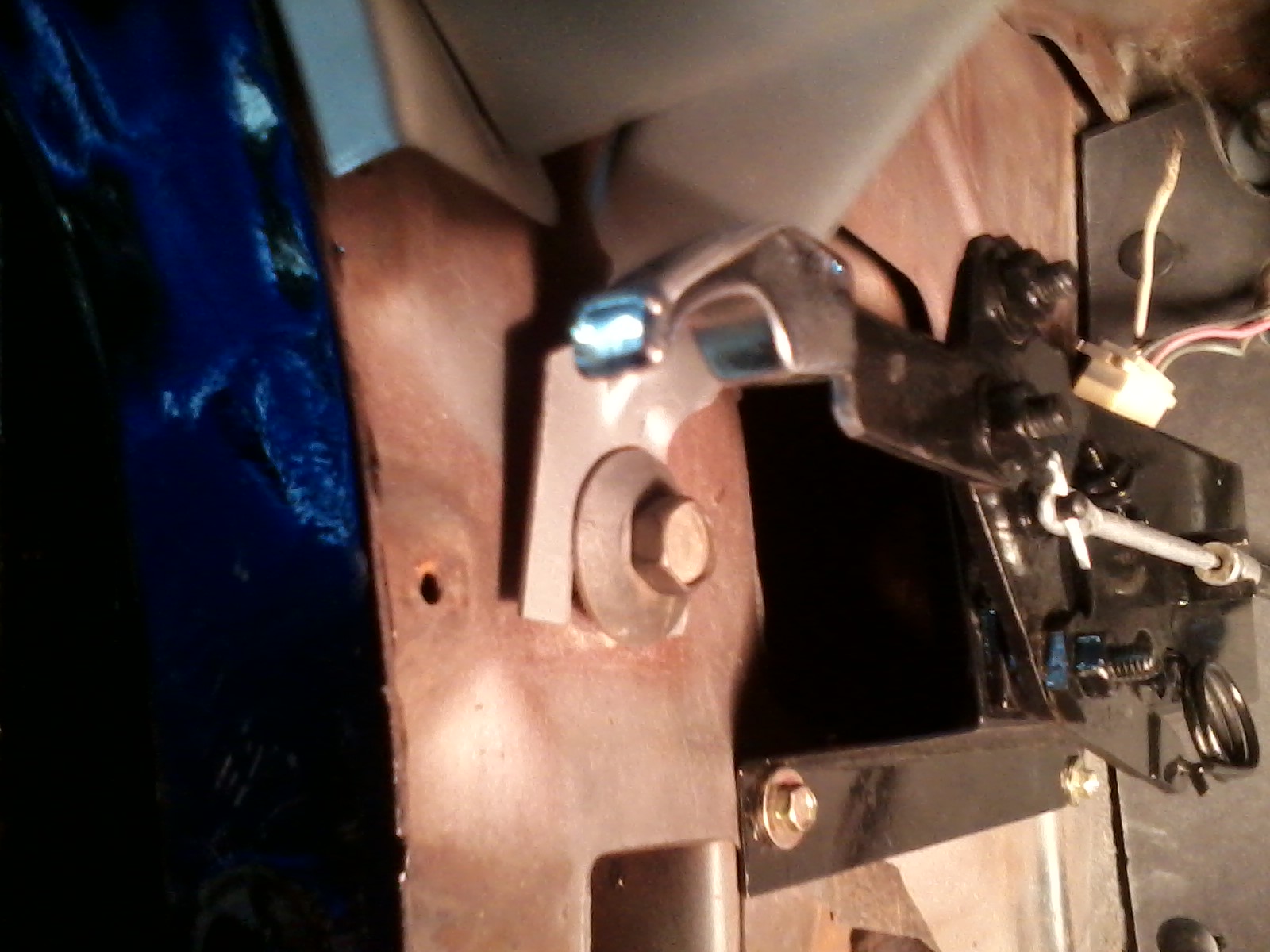

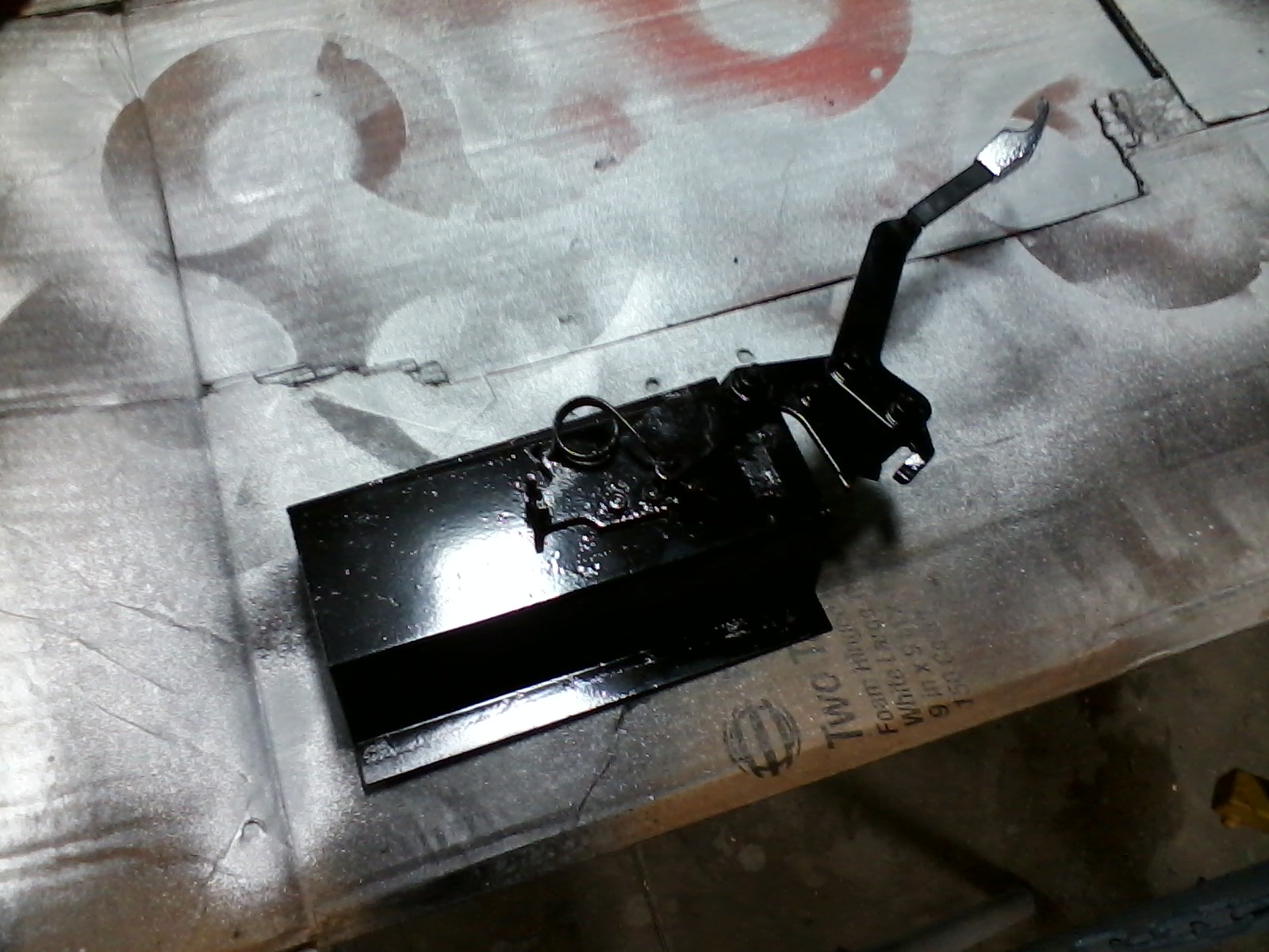

  3. This box/assembly was attached by 4 bolts to the lower left cowl; this area is normally covered by the cardboard kick panel. (Picture 2) I positioned
    the box and lever assembly so that PARK is activated when the lever is “up,” and deactivated when the lever is “down” My reasoning for this was
    that it would be almost impossible to accidentally hit the lever with my knee and move it “up” while the car was in motion, thus causing much
    ratcheting noises and probable damage to the park function in the transmission. (Picture’s 3 and 4)
