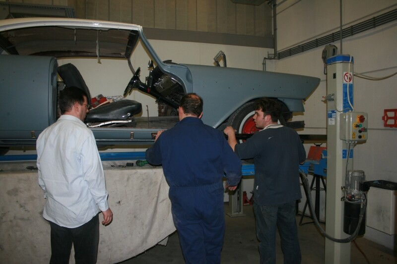

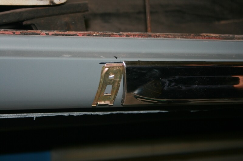

I bought a set from Roger too and these clips are great! I had been trying to find them on line and at Carlisle for a long time before Roger remembered that he had spares. We put them on like in the description but added a small screw as we did not trust the durability of the small lip going through the hole. One of the hardest things in the resto was to put the rocker mouldings on the car though, it took us 4 hours with the three of us to fit them before painting. And when the fresh paint was on it took us a little bit longer to mount them but we managed to do it without scratching :sunglasses:
Here are two pics that might be a little help

Ron, it appears from the the photo that you slid the trim onto the clips from the front. I have put these on cars many times by hanging the piece in place on the top of each clip and snapping it onto the bottom part of the clip. Do the snapping one at a time by pushing in and down.
I mount the clips per directions but put a screw in the center like was mentioned.

We tried snapping the trim on but it was impossible, maybe we are not skilled enough :blush: We found the right way with the screw in the center though :smiley:

All wonderful news on how to install and what these clips looked like that I am getting (or soon get) from Roger. Tom Fox’s way of installing these mouldings is how they did it on the assembly line in the mid 70’s (summer college temp job) at the Lynch Road Plant (the old Plymouth plant) on the 1976 models with rocker trim. Kinda of a twist and a bend a voila’ they were on. I will anchor with a set screw also since this will make sense for security of the moulding strip.
One that I will try but if not Ron’s way will work too as long as I gather up a couple of my local Mopar friends for an afternoon in the garage installing these!
