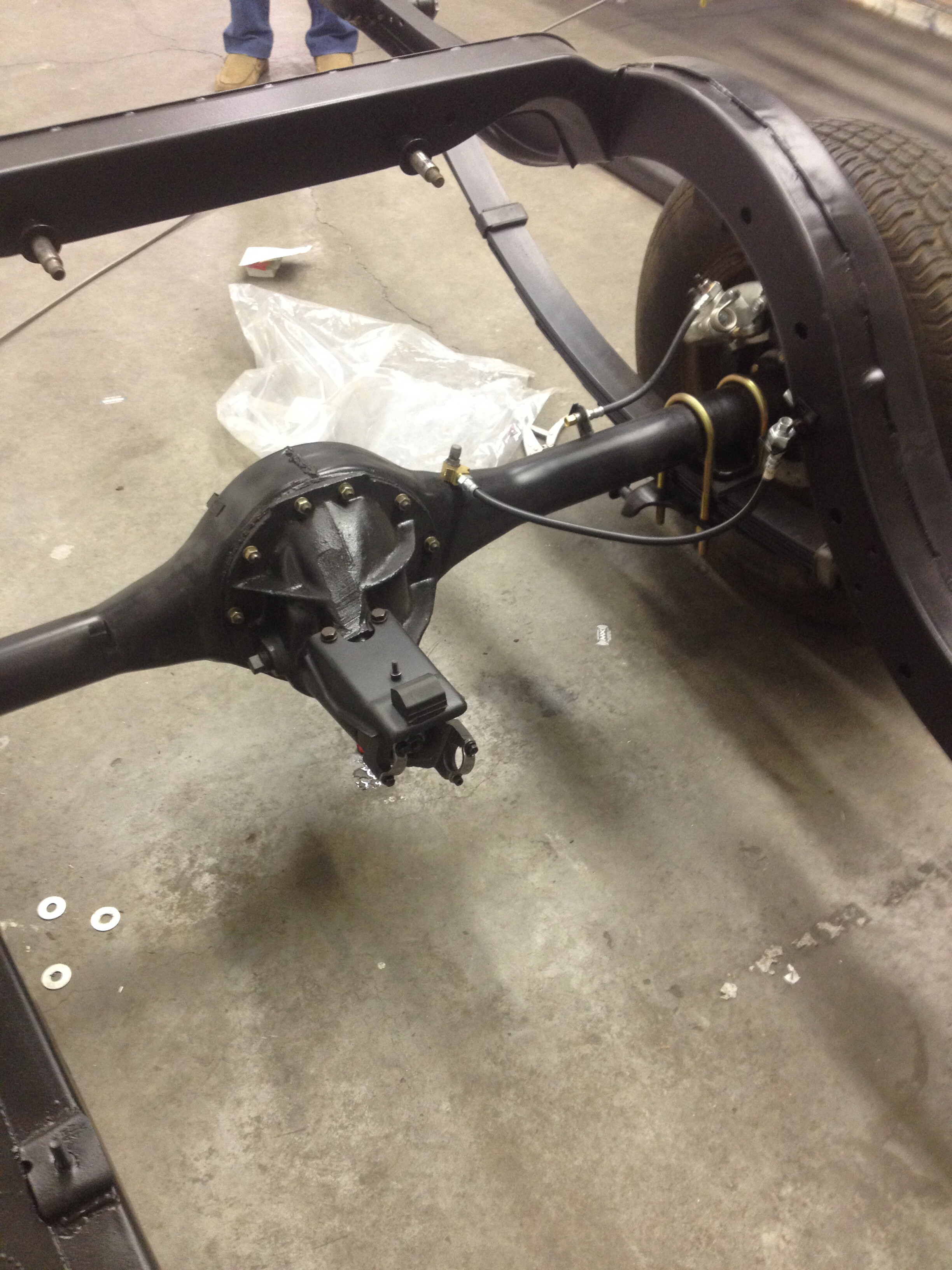

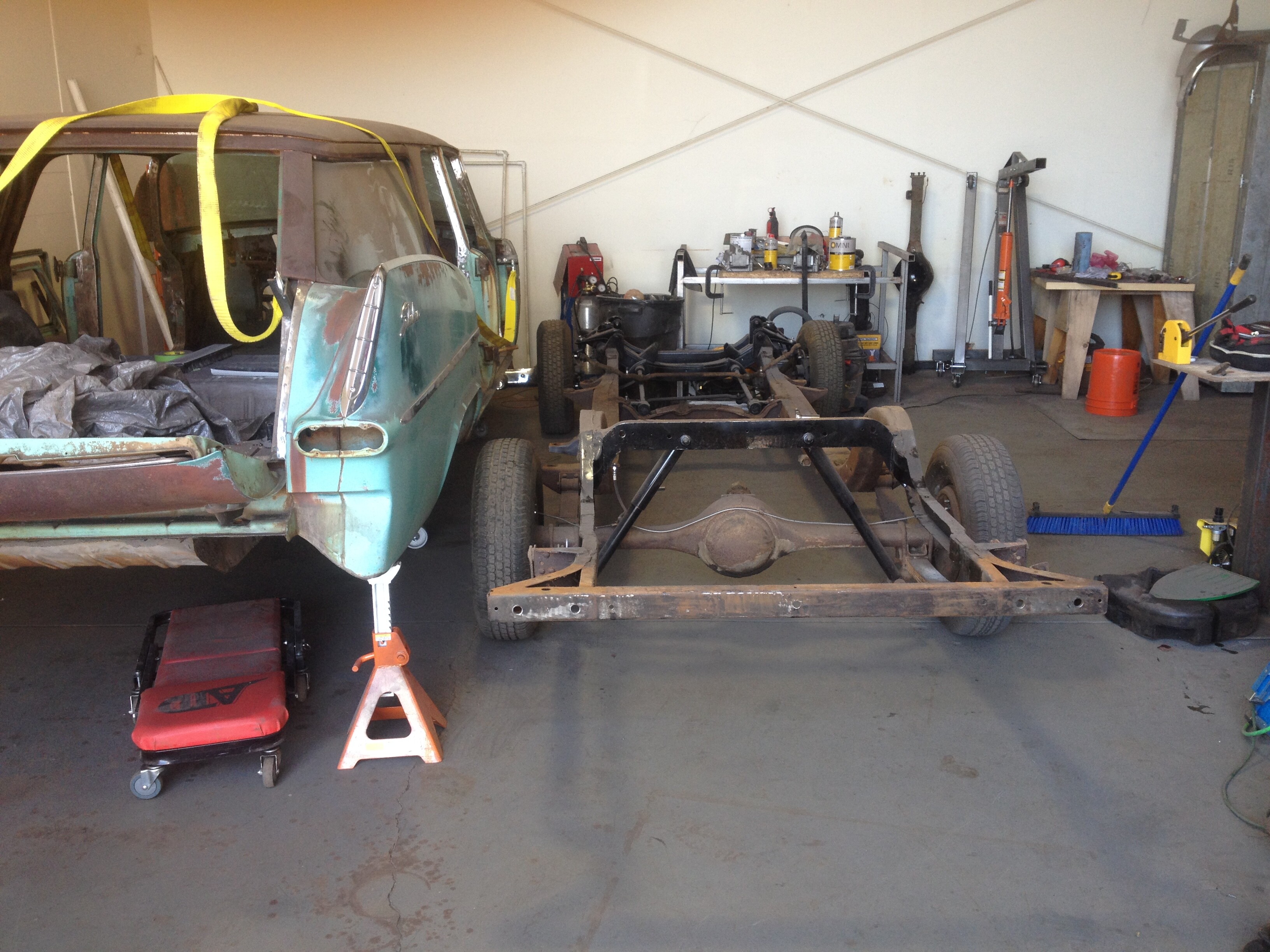

Body off frame …frame has been blasted painted, and new front end suspension all around. Disc front brakes and since the 3spd overdrive is not salvageable so no ebrake …So I switched out the rear end for a coronet rear and put in disc brakes in the rear and a 3.55 pumpkin with new eaton posi. Now I have an E brake.
The engine was suspect so got a 62 318 poly from John at Big M in Cali. It is being rebuit with advice and parts from Gary Pavlovich and will be ready this week or next. For right now im using a fury dual quad intake but my try the new intake gary is designing for the 318. The tranny is a 46RH 4spd overdrive out of a durango that will bolt up to the 62 poly and give me good highway cruising with the 3.55 rear end.

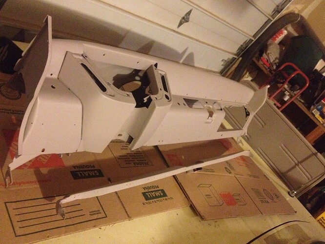

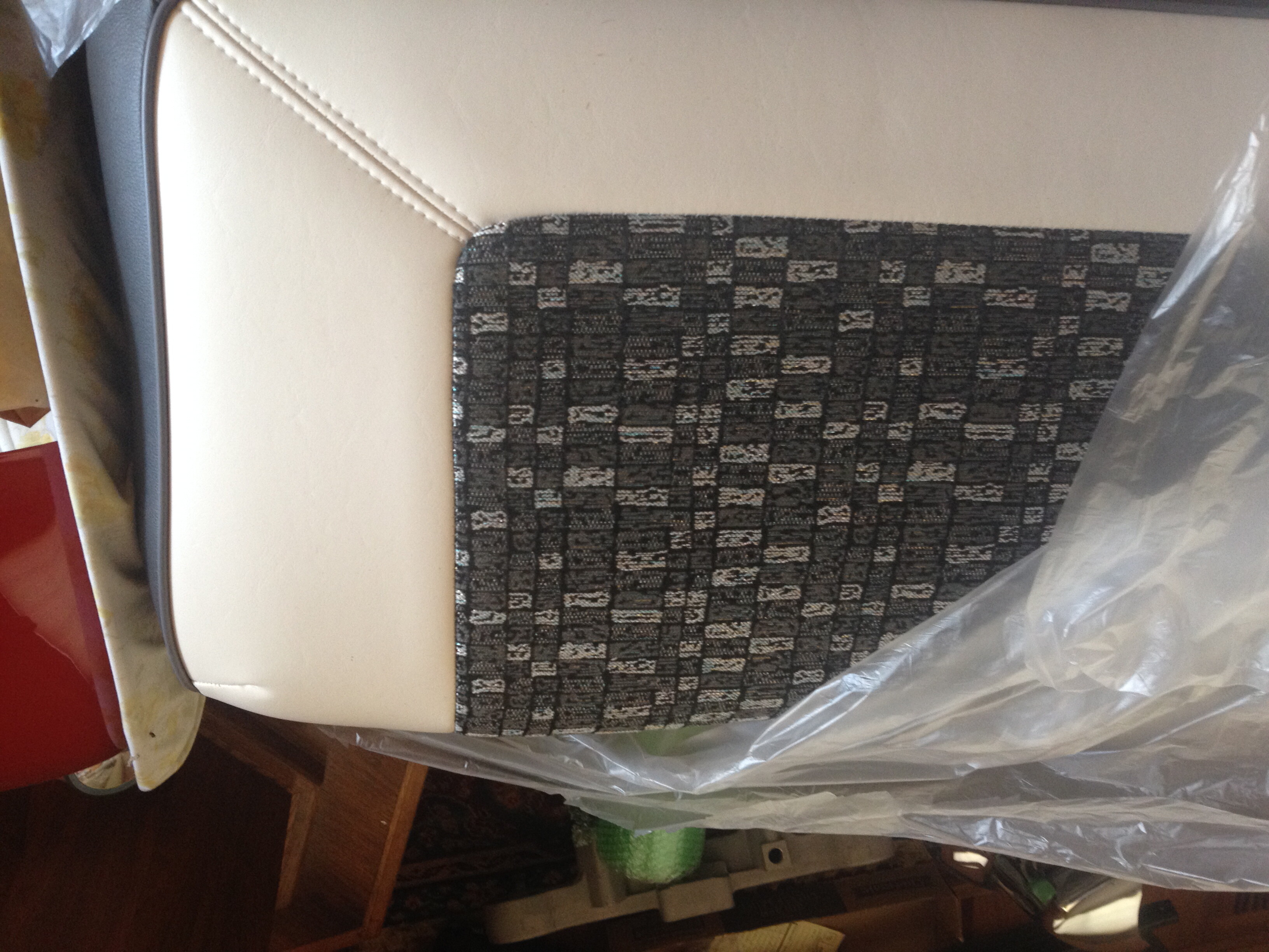

Have finished all the interior pieces in epoxy primer and 2k high build and am going to be painting those soon. Interior done waiting to go in. Still fabricating seat legs that were rusted out.

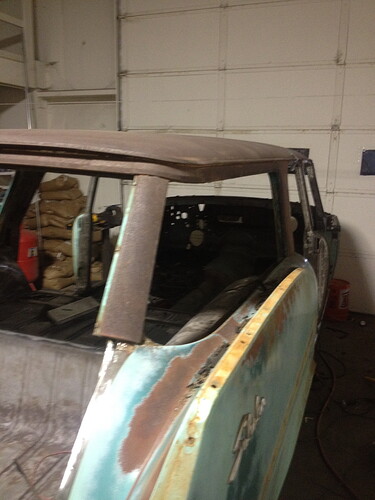

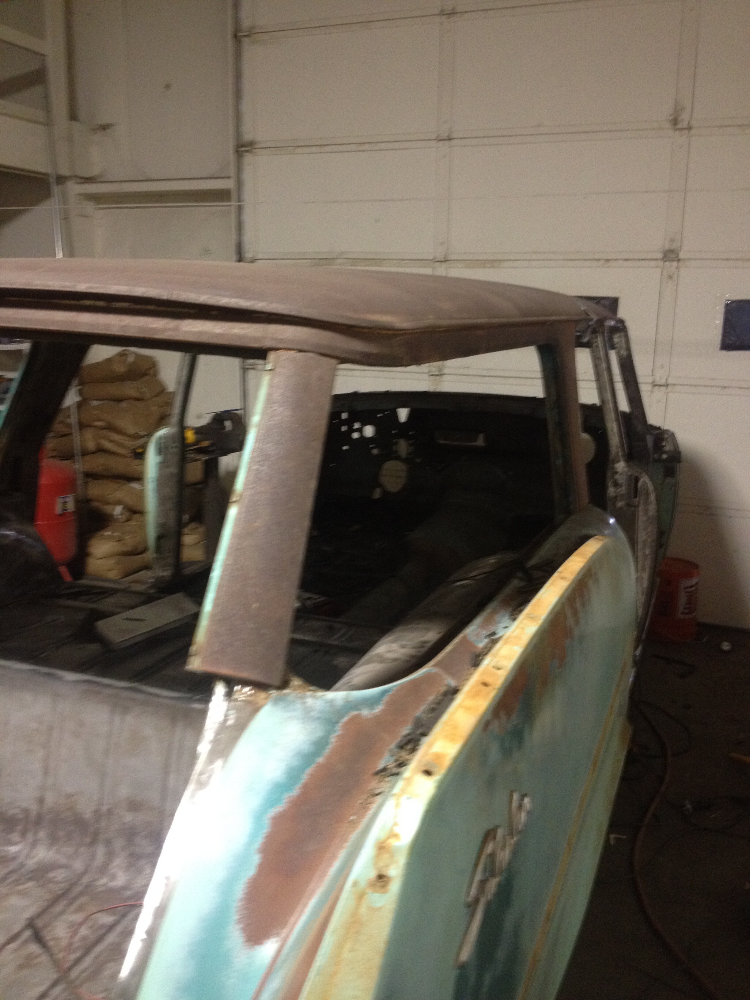

Most sphincter tightening part of resto was taking glass out of rear of wagon this week.All safe no chips or breaks.
Body goes on rotissarie this week or next and bottom gets blasted with crushed glass I picked up in Hayward Cal. Works well at cutting rust and supposedly no silica. Used it on frame and it worked great. Will hit the underside and the few hard to reach areas in door areas then use sander on rest of car. Here are a few pics.

Dash and other interior parts
