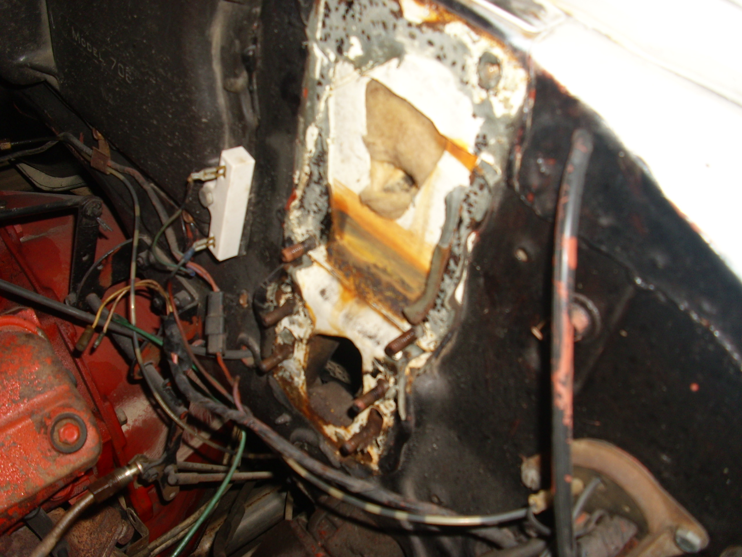

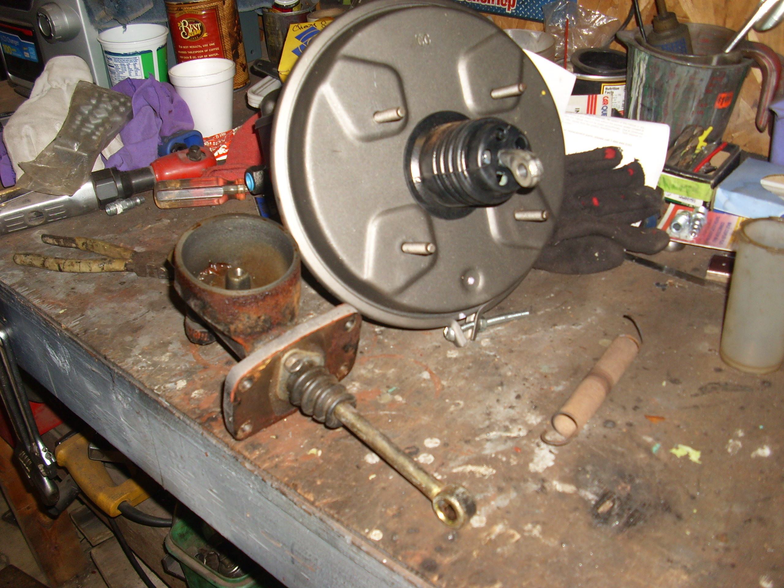

Fins-I’ll try to take a few pictures of my situation. Thats weird that your booster would bolt up. My firewall is stepped between lower bolts and upper bolts. Bolt center were about 1/4" off. My mounts are pressed in bolts which are part of the brake pedal pivot assembly, instead of receiving holes for the 4 booster mounting bolts. My car never had power brakes. Might that be the problem???
Here are a few pictures that depict my problem. I’ve kind of decided to try manual disc brakes. If that doesn’t get it I’m thinking to try a stock booster.
shows stepped plate removed from firewall
firewall w/mounting bolts
duster booster and my 59 mc

I have the Parts Book open in front of me, and for what it’s worth, ALL '59 Plymouths had stepped firewalls and all had stepped "reinforcement"s..(the name they gave to the mounting plate). Further than this I cannot advise…I don’t know what a Duster master cylinder looks like, etc etc.

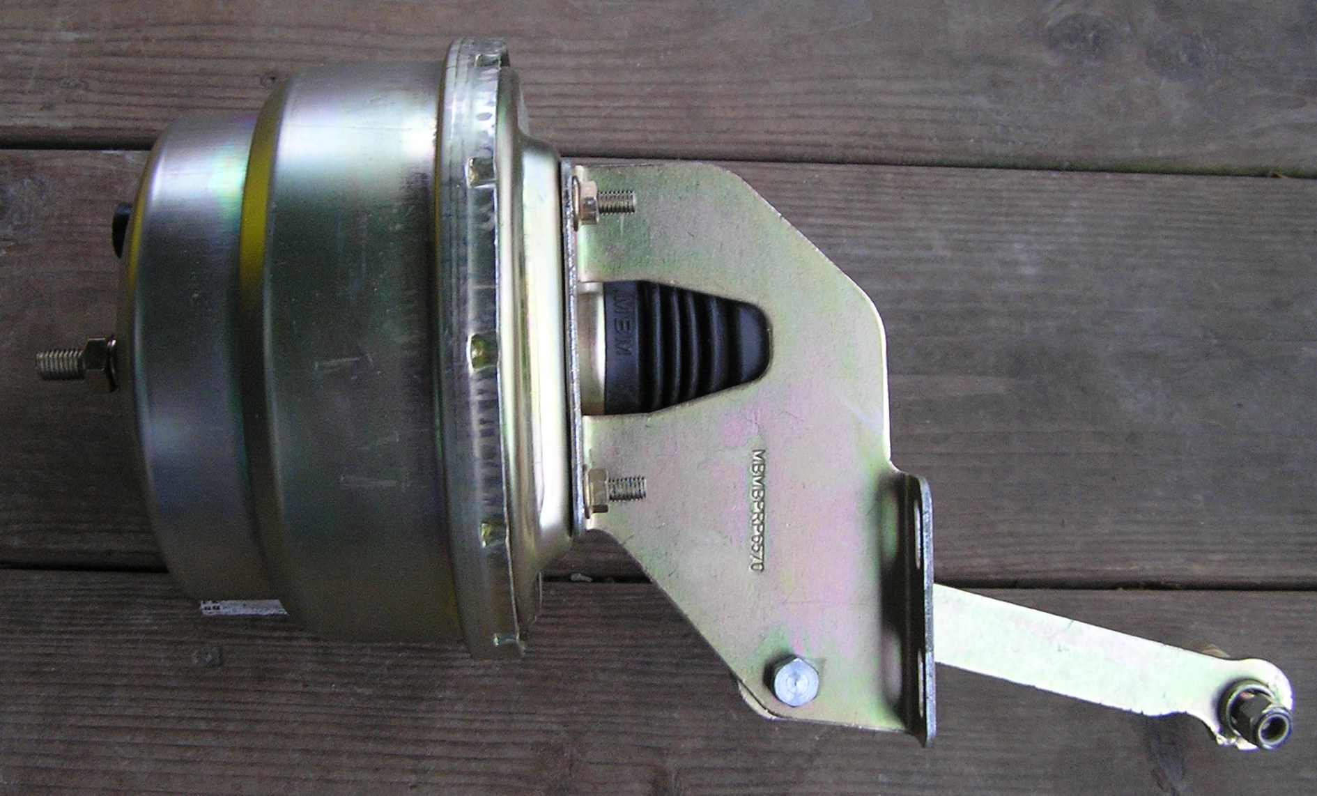

I’m kind of developing a theory about how the 75 duster misconception may have originated, if it is a misconception, as it appears. Roger at AAJ Brakes was dubious at best about my pig headedness regarding the Duster idea, so he sent me a picture of an offset booster, which i think is the next generation of MOPAR booster brackets , probably 1965 vintage vs 1975. These appear to be available on Ebay as a unit with mc and booster. I can see how they could easily be modified or utilized. However, I have a deathly fear of the need to work under and around my dash-so the bolt on idea was a no-brainer for me!! So thats how I got started down the old “Duster Road”. Roger’s picture is attached.
So of course the moral of this tale of woe is to heed the experts!!
**That’s the ticket, just what the doctor ordered.**Great picture!These were optional on all A Bodies… not just Dusters. there is also a side brace to help stabilize the whole thing that attaches at a right angle at the master cylinder bolts to the fender well.

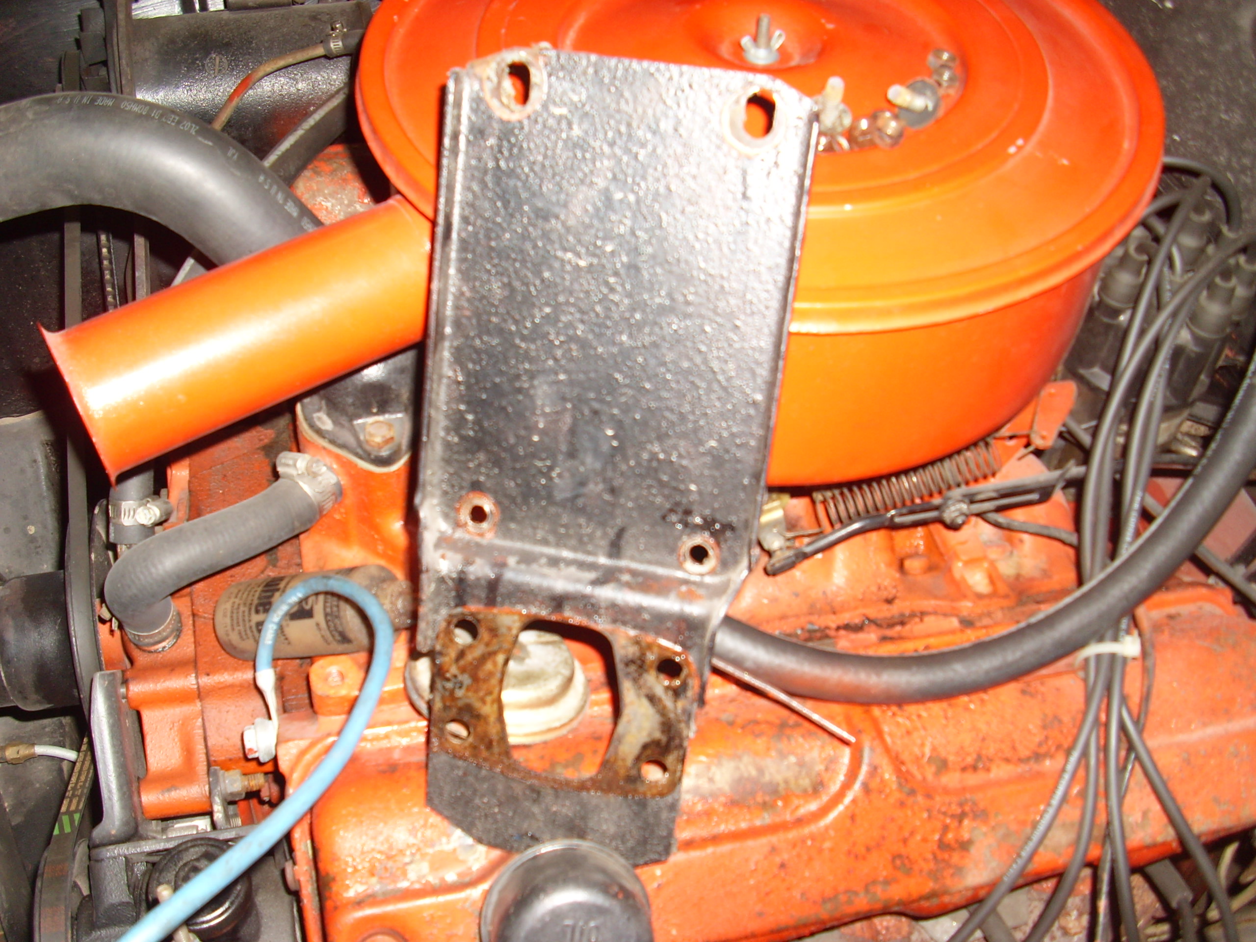

Well, you guys really have me confused now. I put AAJ front disc brakes a double pot MC and a proportioning valve on the car I am now restoring, it is a non power brake car. I plan on installing power brakes. I may be wrong but I think the pedal mechanism and mounting plate is different for cars with power brakes, anyway I got a setup that was for power brakes on e-bay. Now I will have to do more research to make sure. I’m attaching a picture of what I have now.

at the risk of repeating myself, the only idfference between power brake mounting plate and NON- power brake mounting plate is that the NON- pb plate does not have the booster hole.
Thanks Roger. That was my conclusion also. The fire wall has the opening for booster rod and I actually was able to get in a position to see what appeared to be the receiving mechanism for the stock booster actuating rod. Several hours later I was able to extricate myself from under the dash-very dehydrated but none the worse for wear!!
