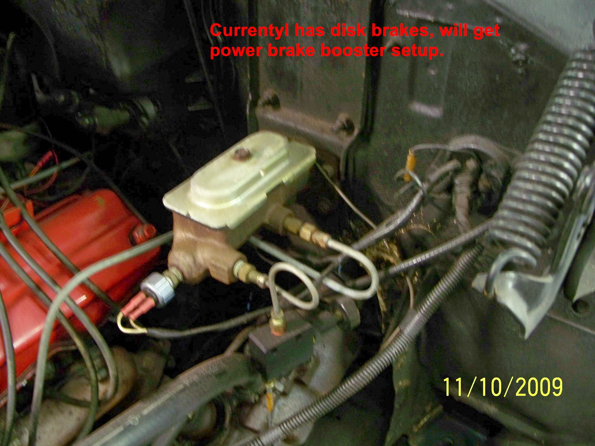

On my 59 I used the mid to late 60’s (1967 I think…) A body Dart master cylinder. Here is that picture of it.
The front cylinder goes to the rear ( I have proportioning device to adjust front and rear braking ratio if needed, there rear cylider goes to the Disc brakes I installed (Aspen/Volare F body)

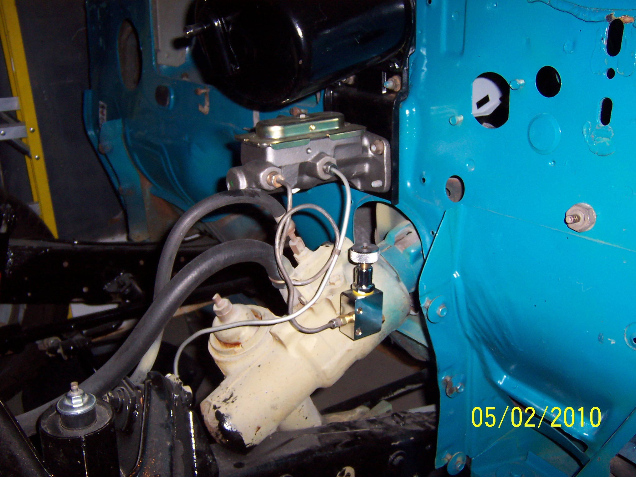

Looks like John Q. and I have the same setup for front disc brakes (brilliant minds). I drilled and tapped the front of the cylinder to take a brake light switch, the only drawback is, if you lose fluid in the front chamber you also loose your brake lights. This picture was taken at the beginning of the restoration. As you can see the rear brakes are on the front cylinder going thru the proportioning valve and the front discs are on the rear chamber.
