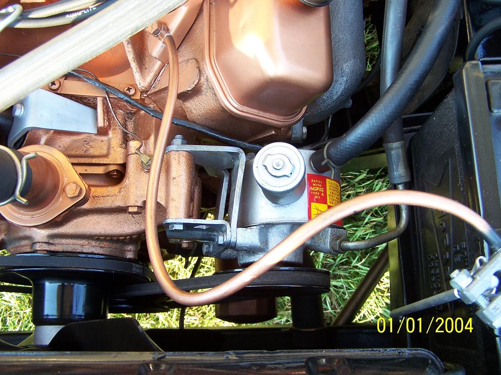

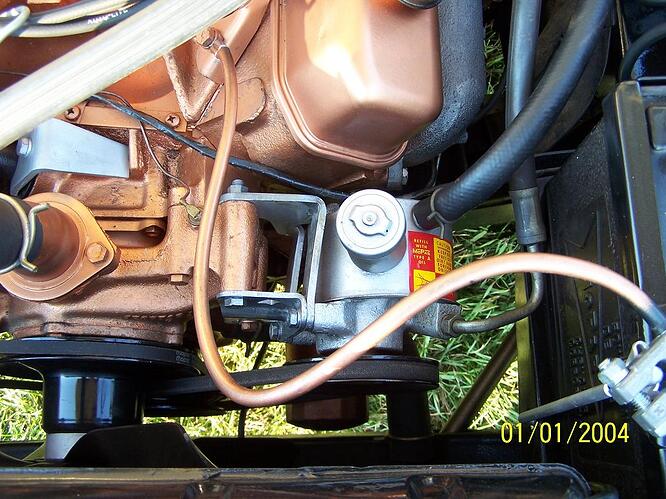

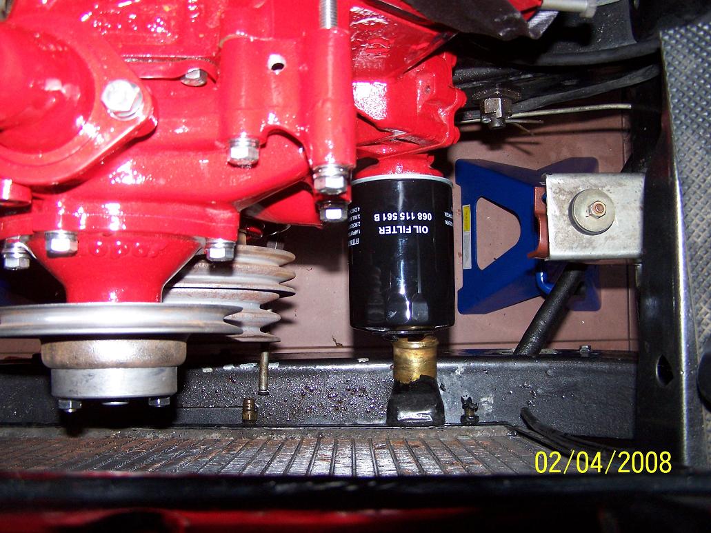

Here is another little detail that I discovered yesterday. The water outlet of the “318 radiator” meets the 361 oil filter.
First picture shows a 350 which I saw in Carlisle this year!
Second Picture shows my 361 with the radiator of my 318.
Oh yeah! I wish I had the kind of memory that held onto all those details. As you may know, I completely rebuilt my Belvedere convertible (with lots of help). It was a 318 car, and I upgraded to 361. Your dilemma with radiator reminded me that the same thing happened to me. To solve the problem, I think I had the radiator shop move the inlet to the other end, but maybe I found another radiator.
More challenging was installing factory a/c. The donor car was a 318 and so none of the bracketry worked, plus I needed a different water outlet fitting. All were difficult to locate.
