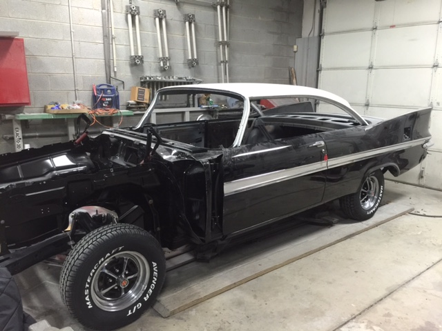

59 Fury 383/727 swap-trans linkage
I’m currently doing a '68 383/'63 727 Torqueflite swap into my '59 Fury while the car is apart for restoration. Those of you who might have done this mod, did you have any problems getting the old transmission/throttle linkage to hook up correctly? If you did, how did you work around it? The car was originally a 318 and cast iron Torqueflite. Thanks for your help. Dennis
