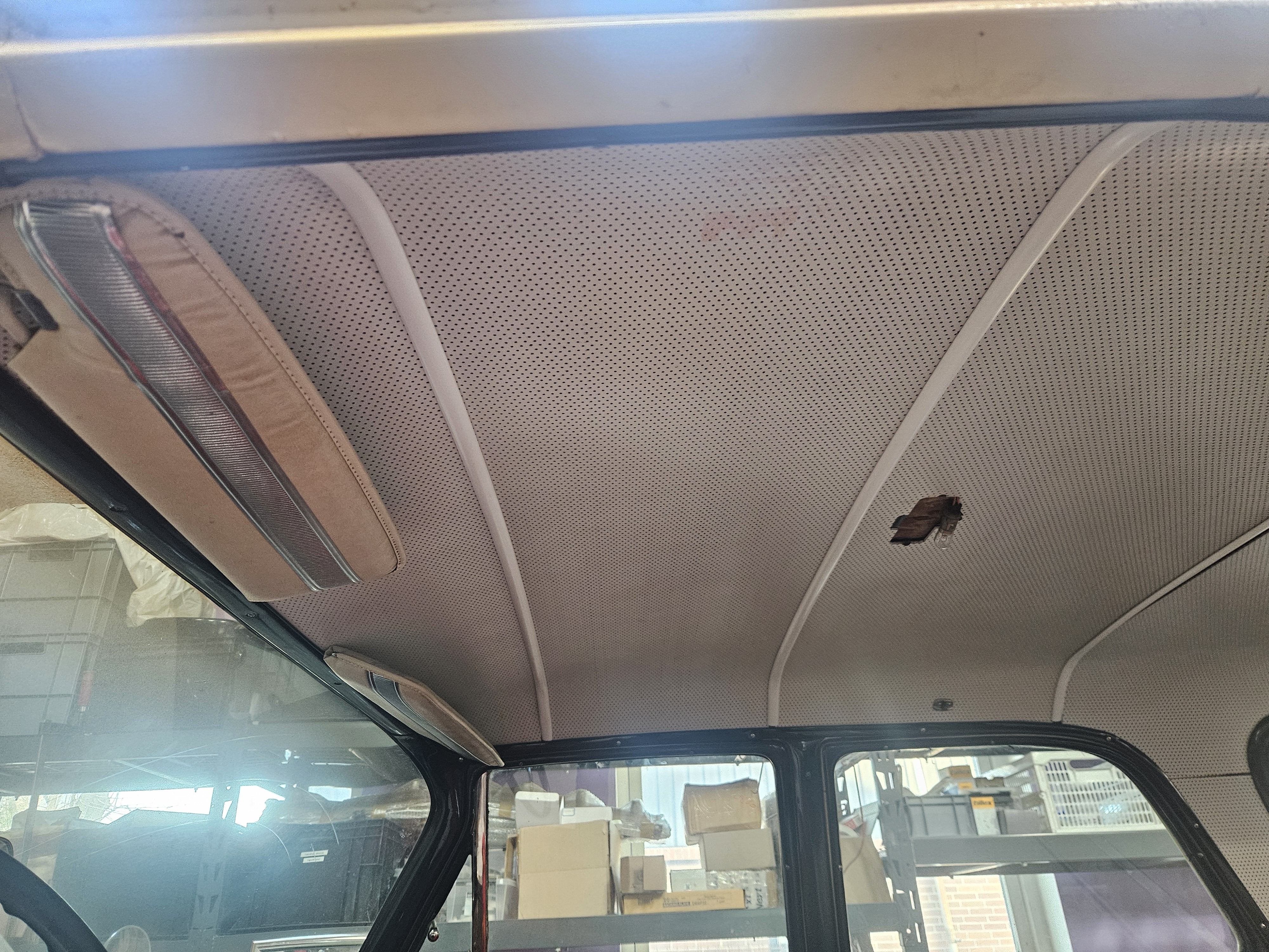

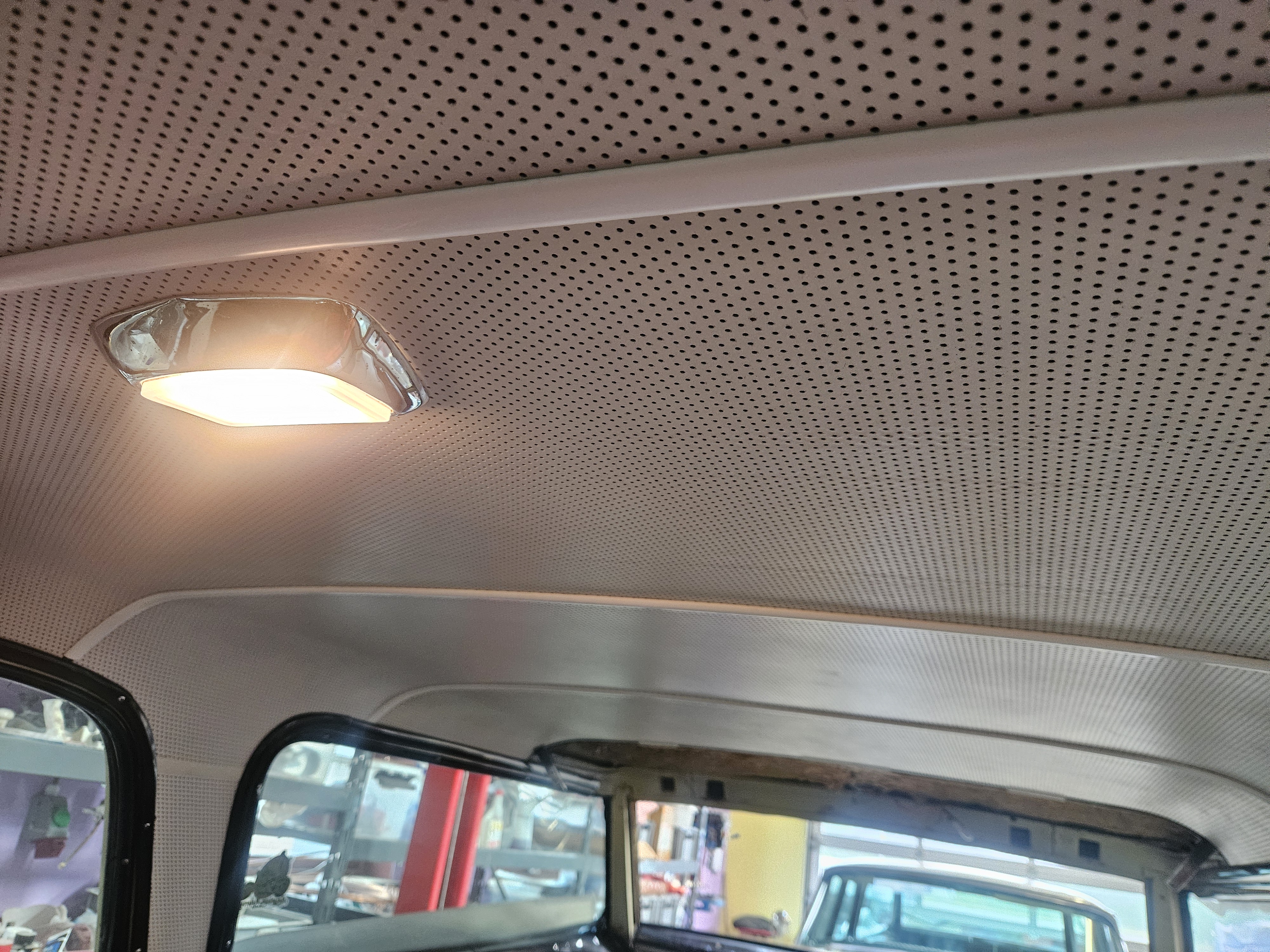

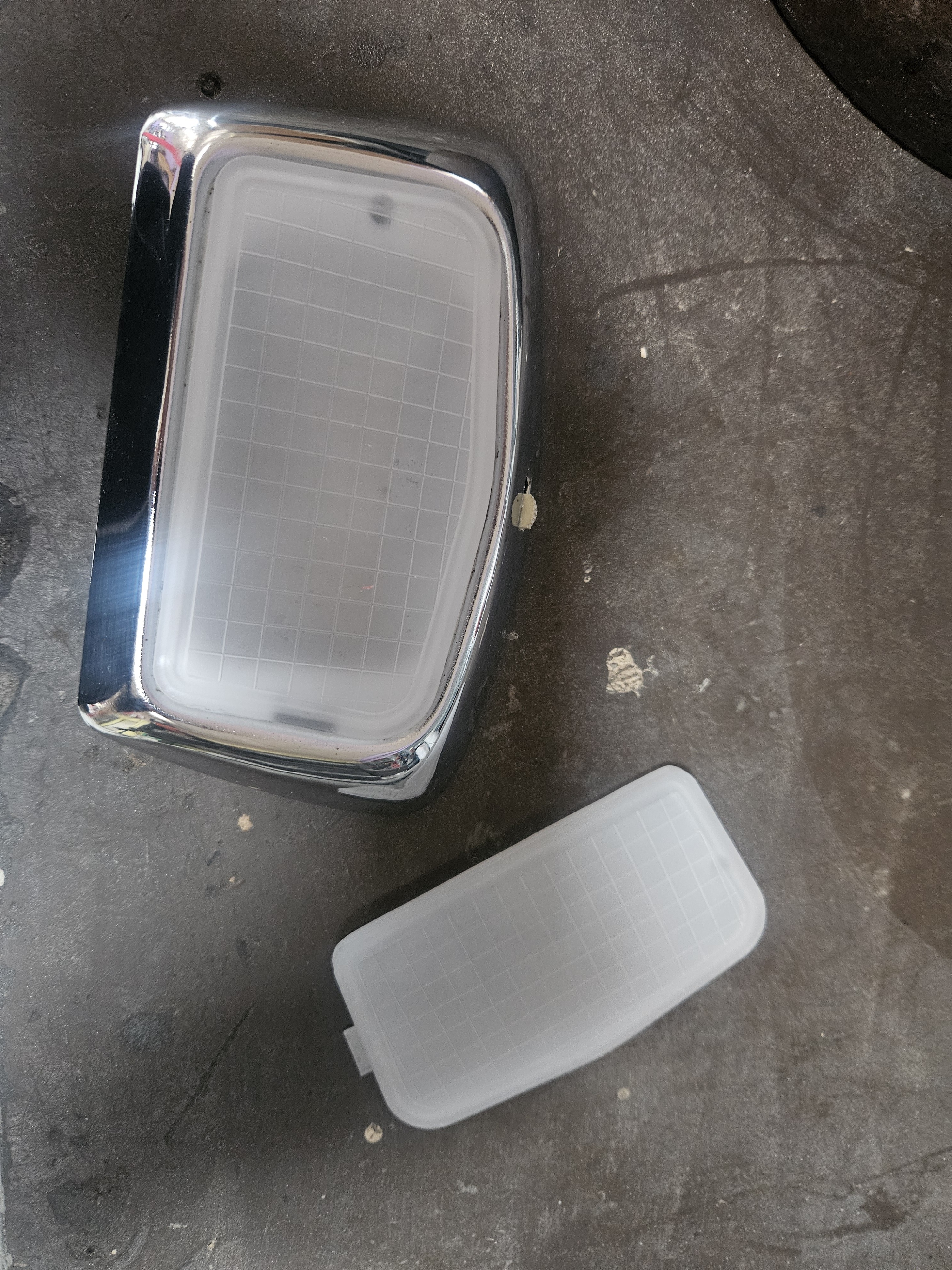

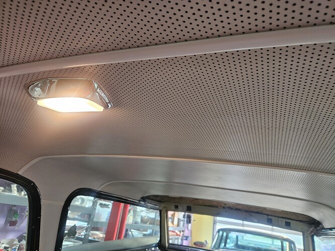

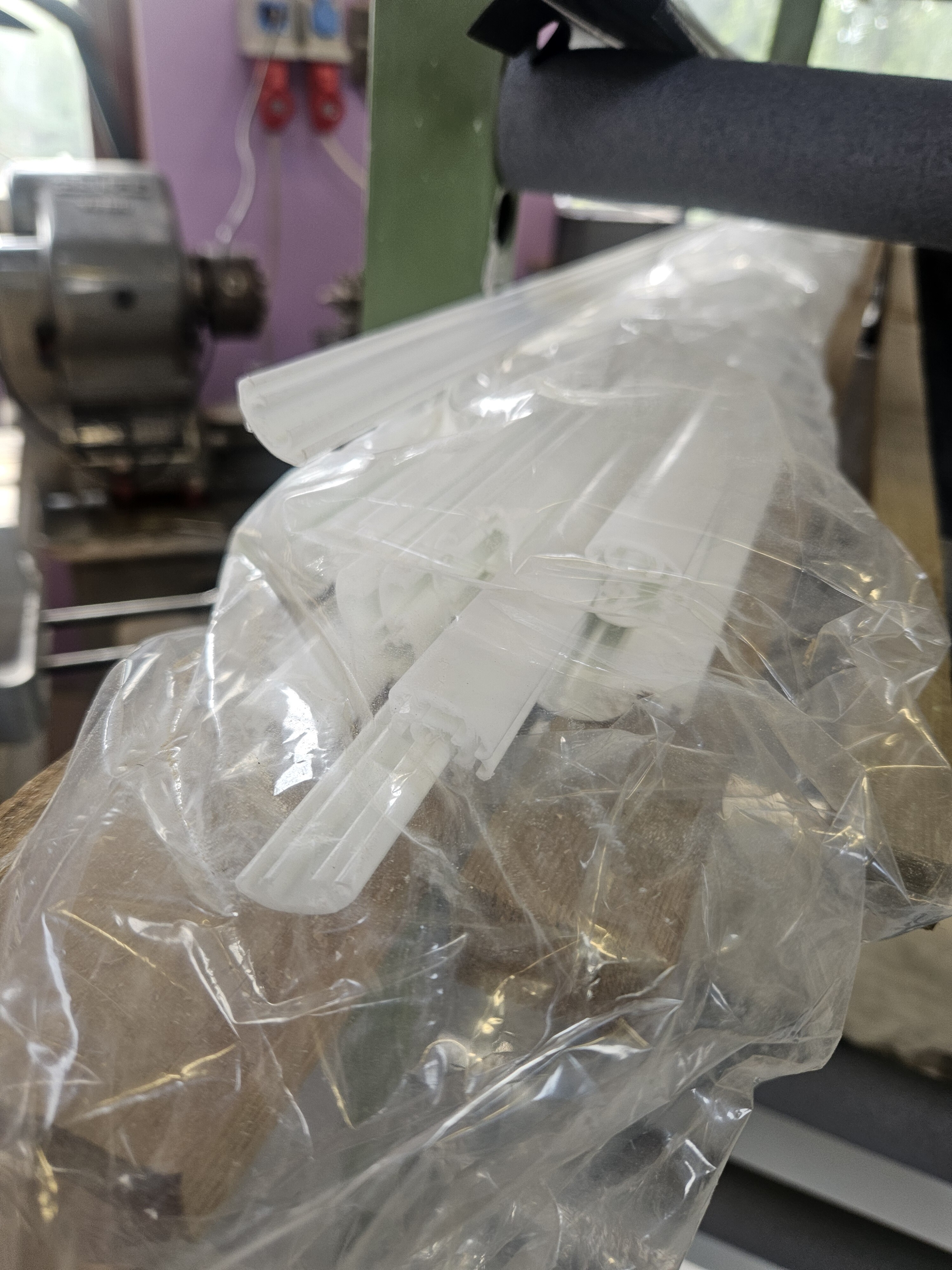

If your '59 Plymouth has a central dome light (i.e., not along the roof rail) and you need a lens… Well, print your own, courtesy of @morten.larsen ! You’ll find the STL file attached. Morten has also made an extrusion tool for the “side to side” headliner bows in his Suburban - I don’t know if it can be adapted for “front to back” bows, or not. (The latter are commercially available from Vans Auto.) Morten is also working on 3D printing of the bow ends.
Thanks, Morten!

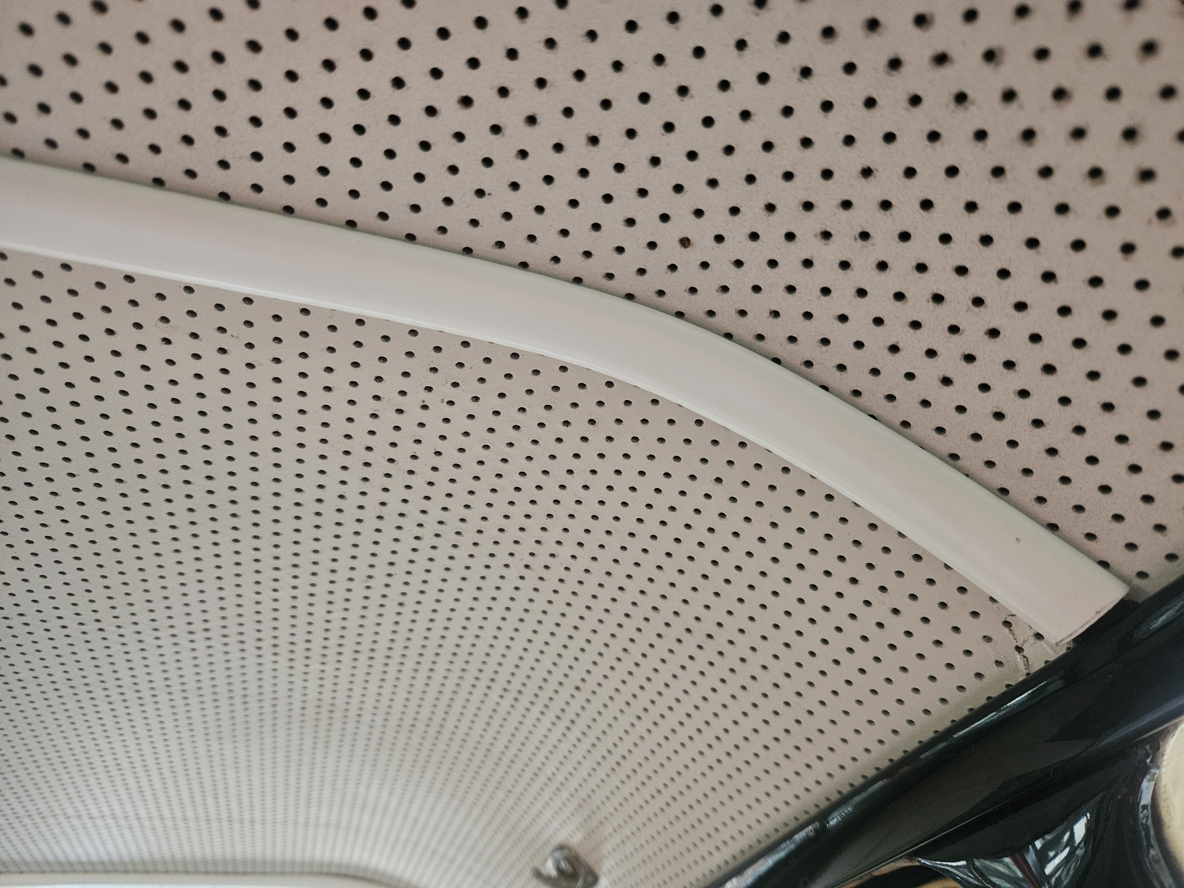

Crown moldings? Do you mean, the strips that hold up the headliner panels?
You have a Belvedere, Michael @nollenberger - correct? Then you need the front-to-back strips. You can get them from Vans Auto, as I say above - here’s the link again: 57-59 Plymouth Headliner Plastic Molding Chrome 65 Inches - EACH 2440144 - Vans Auto
thanks foor that … yes i have a belvedere is it 100 $ for each or is it a set?
It’s $100 each, Michael @nollenberger - pricey, I know.
