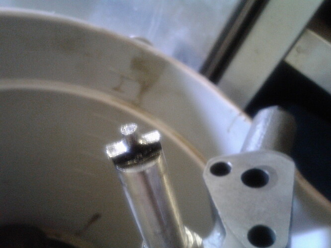

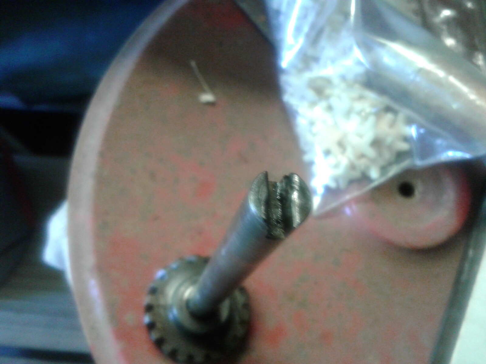

Got the pump out without pulling the engine. Was able to jack the engine up enough to get the pan off. Probably should have just pulled it. The male drive end of the brand new pump was worn to just a nub and the female slot on the brand new drive shaft was starting to wallow out. Because the engine was run with tbe light on l decided to remove a main bearing cap and a connecting rod cap and take a look, l decided to ask the .man that rebuilt the engine to look at the bearings and give me his opinion. Attached are pictures of the pump and drive shaft.
Picture files taken on my cell phone to large, these are from my tablet.
Wow thats bad i hope that your motor survived
Dick; What about the drive gear/shaft ? Did you find one? Now you got me thinking about mine,I put in A high volume pump but I remember the drive was A little worn. I think they are tough to locate. I didn’t like the set up with the tang and slot. I think it would be better with A hex shape. Could be more torque on that area than one thinks if you run thicker oil or the oil is cold ( in my neck of the woods). I wonder how long they lasted back in the day. Mine had 113,000 on it before the rebuild and as I said the female slot did show some wear. Just some thoughts. Mark
Mark - Took the oil pump to the mechanic that rebuilt the engine, he is sure no metal got into the pump to lock it up and shear the male slot on the pump shaft. Because the male slot sheared only the upper half he thinks the distributor was not seated all the way down into the block causing the drive shaft to rise up on the cam gear. The female slot on the drive shaft should seat all the way down on the male slot of the pump “oh baby” l digress! Around a year ago a drive shaft showed up on ebay l will use it. I compared the shaft length of the original distributor with the later replacement and they are the same. Every thing the mechanic said makes sense so l wll try to make sure every thing is seated properly. If it happens again im thinking of putting the 383 thats in my 59 Desoto parts car in the convertible. If John Q. Can do a 413 l can do a 383. So there.
Dick; That makes sense. Alot of engine manufacturer’s use that method, and it does look like it sheared it off.I would say he is right. I also think A good machinist could re-work that female drive. Sounds like you have A handle on it !!! Mark
Mark - There are two types of drive shafts. On one the gear is pressed on, the other one the gear has a pin in it but l think it is pressed on also. I just bought the shaft only from Rock Auto, it has no hole it’s for the pressed on gear. Check Summit Racing, they show all kinds of drive shafts but l didn’t see ours.
