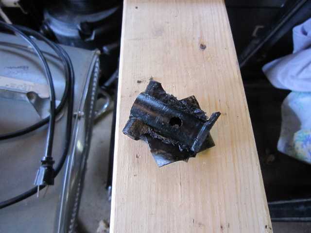

I just had that same problem after my front end rebuild. The guy tried to adjust the box but it didn’t help. turns out the the steering shaft insulator bushing was shot.
http://www.oldmoparts.com had them for $7.50, made a big difference! I thought I was going to have to replace my steering box but this completely fixed it.

It’s pretty easy! You have to remove the steering wheel and unhook the wiring harnesses from the column ( there is a spring, some washer and a spacer that goes in the bearing under the wheel keep those in order). Then there is a clamp in the engine compartment where the column meets the steering box- loosen that. Next unbolt the clamp that holds the column to the dash and slide the column off the steering shaft. The steering shaft is held to the steering box with a roll pin, this is where the insulator bushing is. Use a punch and drive out the pin and the shaft will come loose. make sure you mark which way the shaft was into the steering box, if you put it back 180 degrees off your steering wheel will be upside down! If you have anymore questions feel free to send me a PM.

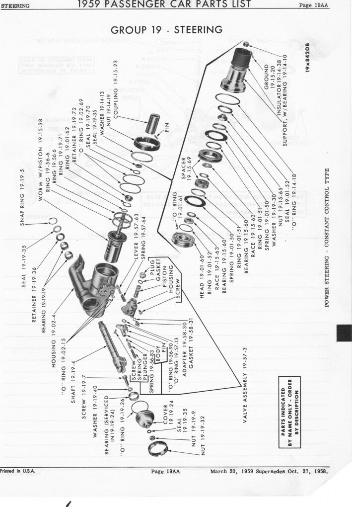

Anybody have a picture of this page in a Shop Manual??

I am not sure what is meant by insulator sleeve. Years ago when I had my steering gear out for rebuild, I noticed a rubber insulator (much like a sleeve) at the far end of the steering shaft. Without this, the horn won’t function. Could this be the sleeve under discussion?
I have a set of three 1959 Plymouth Service Manuals…one of them delves into the topics of Steering, and separately, Coaxial Steering. There are exploded views, and directions, but to be honest, I do not truly understand the technical stuff. If I could be instructed how to post the appropriate pages, I would be happy to do so. As far as I can see, none of the views shows an insulator sleeve.

Roger: It is called an insulator, but to some people may call it a bushing. It is a thick rubber piece that goes between the steering shaft and the steering box.

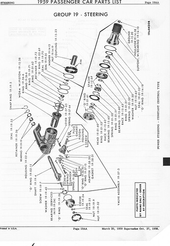

Here’s the pertinent page from the shop manual, courtesy of Roger Howard! Click on the image to see the full-size version.
After following this topic closley and since everything was readily accesable I decided to take a look and see if I needed to replace the rubber Insulator in Reddie, most other makes call it a rag joint. It cuts down on the vibration coming to the steering wheel and prevents metal to metal contact. It fits into and over a toungue and groove joint just above the steering box. It’s actually called a Steering Shaft Insulator. Gary Goers Part # 24B. $10.65. I really needed to replace the Steering Column Floor Seal #521. $35.00 and Steering Column Seal #333. $20.00 so I went all the way to take a look. Mine was OK except for a small split but I’m going to replace it anyway. If you order the #521 Floor Seal Gary wants you to send him the old core, I’m assuming it’s the old seal and the metal plate that bolts to the floor. You will probably also need a Steering Tube Insulator that fits over the steering box hub and into the end of the outer column. Part #485. $10.25. I had one and haven’t the faintest idea where it came from. Sometimes it pays to be a packrat. Add 15% for return shipping and sent a note and a check to:
