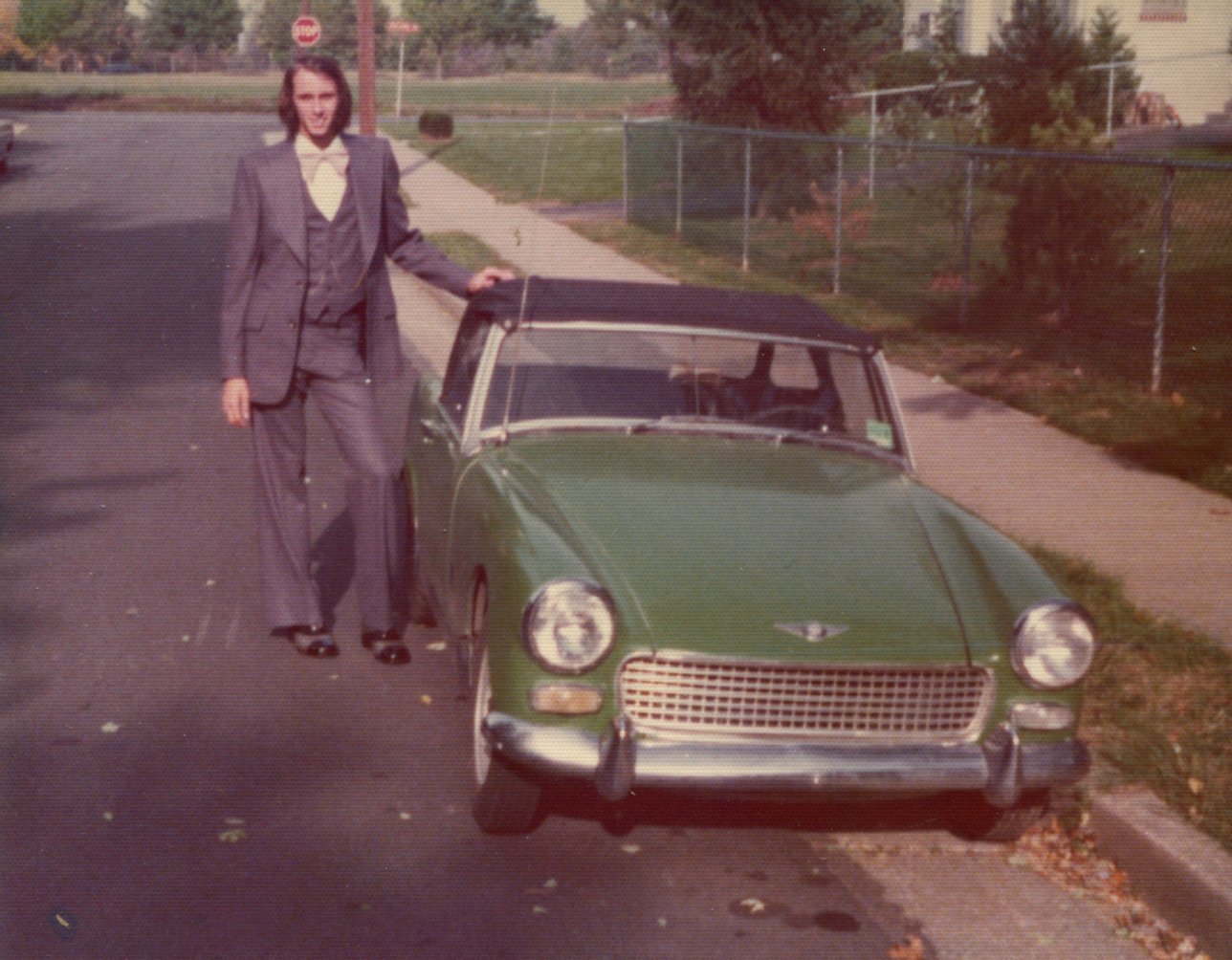

OK, it ain’t a bugeye, but it sure was fun. I could reach over the door and touch the ground…
back when I had hair
Disco Dan was the understudy to John Travolta in “Saturday Night Fevor”, a little know fact… :wink:
Wow, Dan, you look to be seven feet tall there!
Was wearing a stop sign on your head a local fad?
