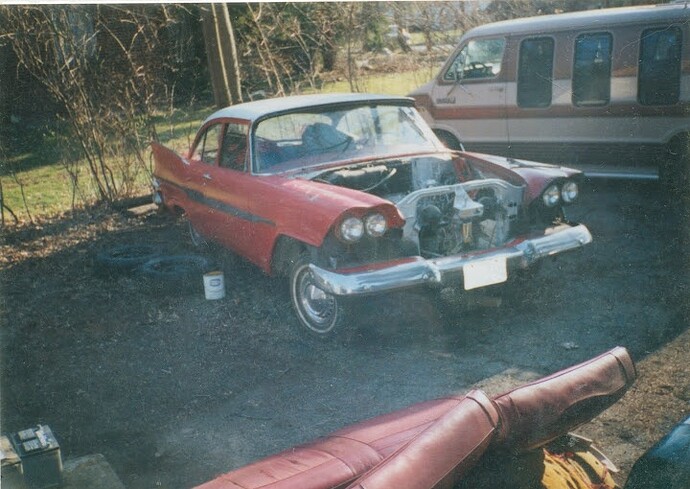

Just wish my dumb teenage self had been smart enough to take pictures in its original shape.
Then the first sacrifice for my car happened, I had to make a choice. Still living at my parents, I wasn’t allowed to have 2 cars. Well one had to go. I still miss that 69 Mach One, but I had a new love. I cleaned her up, din some light body work, and painted her on a teenage budget (i.e. spray paint) and reattaching the trim that was in the trunk, a bit was still missing.
She was my daily driver (cringe), She had to be reliable, and she was for another 3 years and 100,000 miles, @ 259,997 miles catastrophic engine failure. Head gasket I think, oil full of coolant, 5 cylinders with broken rings and badly scored cylinder walls. I thought she was done, I didn’t know much about engines, I parked her and there she sat for a few years.

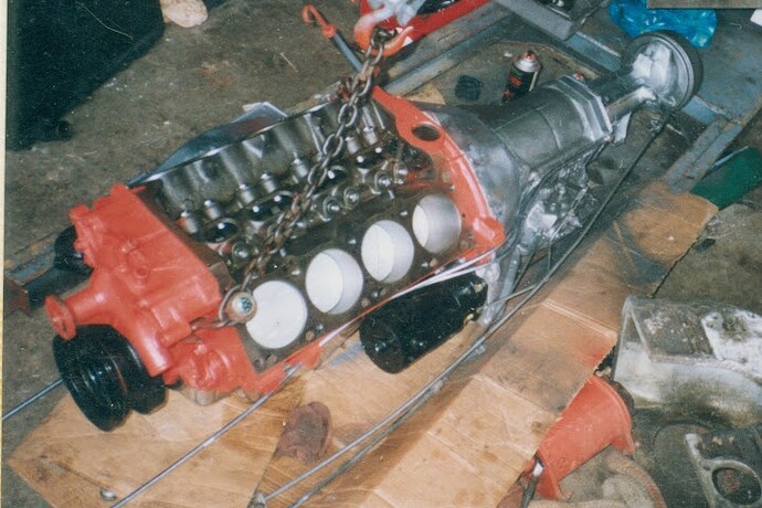

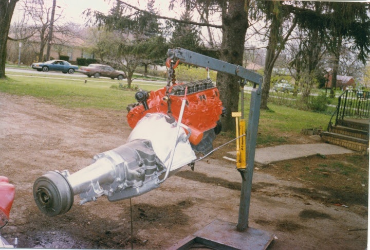

I joined the Marine Reserves where I trained as a diesel mechanic, by the time I got home I felt comfortable enough to be a bit more ambitious. I wanted more power, but I wanted to keep the push button transmission, thus the search began for an 8 cylinder that would bolt up began. I know, I still cringe that I would get rid of the original 230 but i figured she is a base model, thus not as collectible, and well she’s mine and that’s what I wanted at the time.
I found a 4 door Belvedere that someone had done an engine and trans swap on, but still had a 318 that he had pulled, I bought it all, the body on the 4 door was beautiful, but the frame was really rusting out. Figured I’d strip it for backup parts. I really should have. This is where I made a major mistake, a good friend of mine had gone with me to pick up the car and engine said he fell in love with it. Convinced me it was stupid to strip such a beautiful car, and wouldn’t it be great to go to car shows with a 2 door and a 4 door. I caved and gave him the car, he promised to restore it. 2 weeks later, without contacting me he junked it for $75 bucks, the crushed it for scrap. I’ll never forgive him.

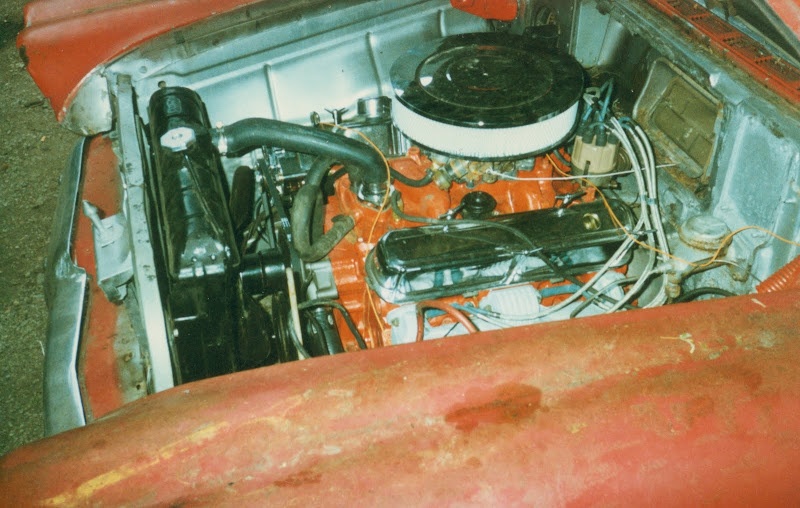

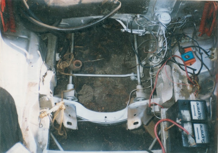

Then to make matters worse the 318 was rusted solid. I dissembled it the best I could, and brought the block, heads and crank to a local shop that basically told me I had a bunch of scrap, block was cracked. Bad day, good day? Either way it Was the birth of my Frankenstein Motor. I salvaged my crankshaft, had it turned, and to not drag this on too much longer ended up with mid 70’s 318, .30 over, heads off a 340 with the larger intake and exhaust valves, a high performance cam, and a 1959 318 crankshaft was a perfect fit. Now mt torque converter and trans could be used on a more modern power plant. There were a few other obstacles, new motor mounts welded in, and had to remove the alignment pins on the bell housing, but the bolt holes all lined up. I don’t remember all the details, its been awhile.
Since then I’ve added an Edelbrok intake manifold, and carb, and a Mallory Unilite Ignition. The only major modification was a posi rear axle swap from a 1969 Raodrunner, I don’t remember the gear ratio, but the brakes were way cheaper and bigger, and the axle was a bit shorter so I could fit bigger tires and rims.

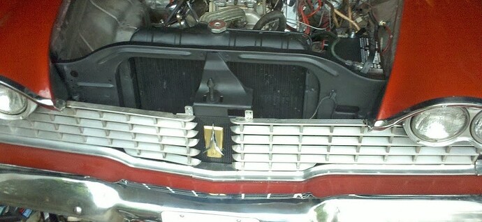

More Current photos
Exciting day, made some wind lace, and some eBay parts arrived. The windshield wipers are in great shape, minor rust on the springs, not perfect, but very usable. Just need to find a source for replacement wiper inserts, the rubber is shot. The headlight trim rings needed a light sanding and a lot of buffing, but the bronze color is coming out of them and they are straight. I love stainless trim. These cars were built to last. :slight_smile:

I also removed the grill, repainted the black stripes on the grill wings, and painted the radiator support black. It looked so good on your cars at Carlisle, I had to do it. Really makes the grill pop. I’ll paint the whole engine after the wedding.
