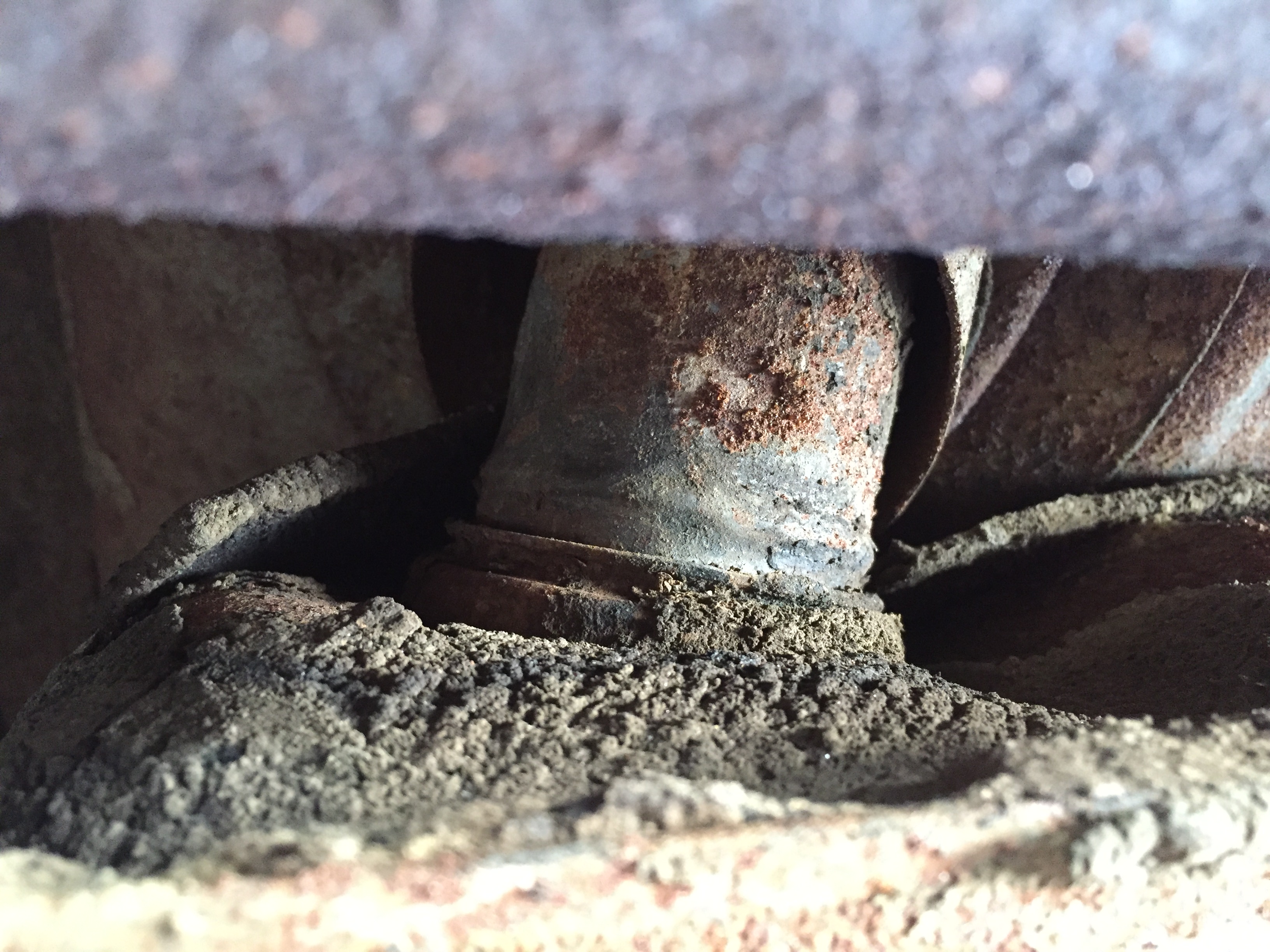

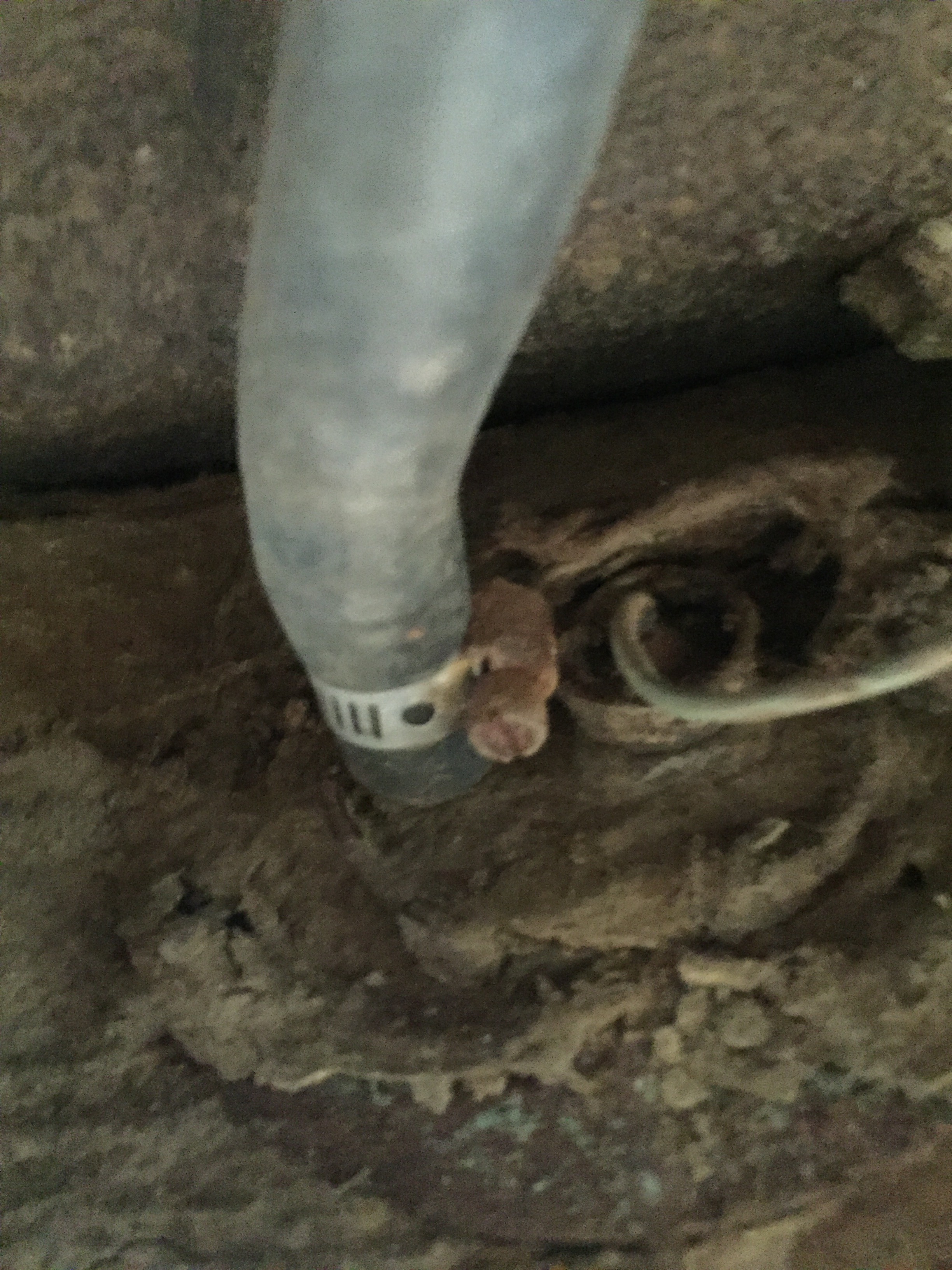

hey thanx for your fast reply… i bought already a new set. I’m going to try to install it now and take a look at the tank with a camera—since I didn’t replace that one. Is there any guidance on how to remove the filler neck so I can take the tank out?
