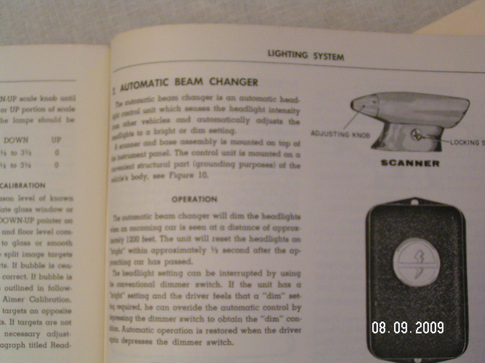

On the 1959 Sport there is an unusual weird shaped thing mouted on the dash just above the steering wheel. It looks like a side mirror botton stand with a cylinder made on top looking through the windshield or facing to front to back. It is chrome looking with a black round plastic front. It looks like a sensor or something. Sorry for the description . Will check it out in better light. Can anyone tell me what it is?
utterly useless. Of no value. send it to me.
Ok, I’m lying, your car has a rare (for Plymouth) Autronic Eye, a sensor hooked into the headlight circuit. When an oncoming car’s headlights strike it, the sensor automatically dims your headlights to low beam (if they were on High Beam). It was common on Imperials and Lincolns of the day. The sensor is not too hard to find, but the base you have is unique to Plymouths. Congratulations!
The automatic Beam Changer was a $48.50 option.
For $86.50 you could get the Golden Commando 361 with 4 barrel.
Now you know why they are rare in the Economy Plymouth line.
