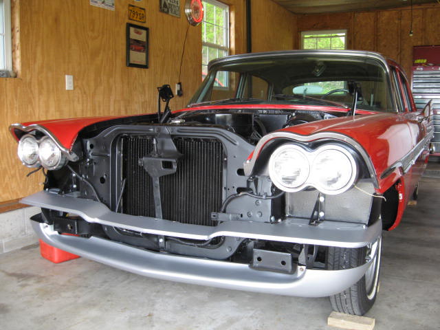

Guys; I got a little more done,nothing you hav'nt seen before,even A pitcha of my ugly mug. QUESTION; do they make or can you get the rectangular plastic inserts (8) that the screws for the headlight bezels go into (the raccoon eye around the head lights)? Mark M

Hey Mark she's lokkin great. Nearly there. Those plastic screw mounts are available as they have been used on car right up until today. There are lots of different sizes but I would try a crash repair supplier (could even try a crash/body shop) or a fstener/bolt retailer. I bought mine from Universal fasteners in Australia(that's where I live)
http://www.clipsandfasteners.com/Gromme ... _s/104.htm
Just found this site. The GM ones look similar to what you need for the headlight trim. I can't remember what size they are though. Need to measure the square hole in the headlight base. Good luck.
Guys this mob sells all types of body fastener for auto in general. It might pay to add this link to your favourites for your reference. Just because it doesn't say Plymouth part doesn't mean it won't work.

Great tips, Jason. And you've reminded me that's where I got mine...at an auto paint supply store.
They may also be on the "Quick Repair" swivel display (a stand-alone rack with 8 display sides) along with the replacement window cranks, interior door lock mushroom caps, etc. at your local Napa store.

Jason,Roger; Thanks for the info,A couple of mine cracked in half and are held in with tape,the plastic gets brittle after 54yrs.I'll look into it,thanks Mark M

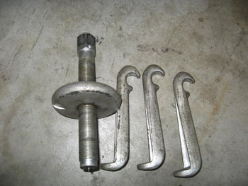

Back at it again,got the car all together,runs great,A littlle flat spot in the carb I'm not going to worry about it till I get some miles on it probably the accelerator pump(it's A new rebuild) othe than that everything is a-ok,tranny shifts nice,motor cranks right along,just need to get some miles on it.I am doing the brakes now,she's on A stand and am also painting the rims.I got new 7.50 14 coker BF Goodrich bias ply tires 2 1/4 white walls.I'M going "old school".Pulling the back drums was A M O T H E R!! But they popped and came off,had to use the breaker bar on the drivers side.The adjusters on the rear are froze,the front ones are fine,I did those last winter,the date on the rear pad has "84" I think that was the last time it had shoes,am going to put new ones on and free the adjusters up and bleed the brakes,was also going to turn the drums.The power booster still leaks A little and has A hissing sound when applying the brakes,also effects the motor at idle,i'll have to get to that later,only have 2 hands!!!!!!! LATER Mark M P.S. the hub puller was the best $37.00 on E-Bay I ever spent!!!!!!!!!

I'm excited for you! Many thanks for posting your report!
I love the pic of the hub puller...you got the real thing, and at a decent price !

I recall the impossible struggles with my hubs before a friend alerted me to and sold me a hub puller. Life was great after that!!

I might have told this story before but just in case. When I first got Charleen I wasn't aware you needed a hub puller for the rear drums so after much struggling I finally rented a Hub Puller and whamo, off they came pretty easily. So I figured a little grease on the axle shaft would help next time, WRONGO, ALWAYS LEAVE DRY. The nest time I tried to get the drums off no matter the force on the Hub Puller, no matter how much heat, no matter how many times striking the puller shaft with a hammer it was no go. Found out the only way was in combination with the puller and heat and a twenty pound sledge hammer it would work. Ater approx. 6 to 8 strikes with the maul they popped. Needless to say the drums were destroyed and useless. If this ever happens to you or your rear drums wear out ALWAYS remove the hub from the drum and save it. New replacement drums do not come with the hub.
