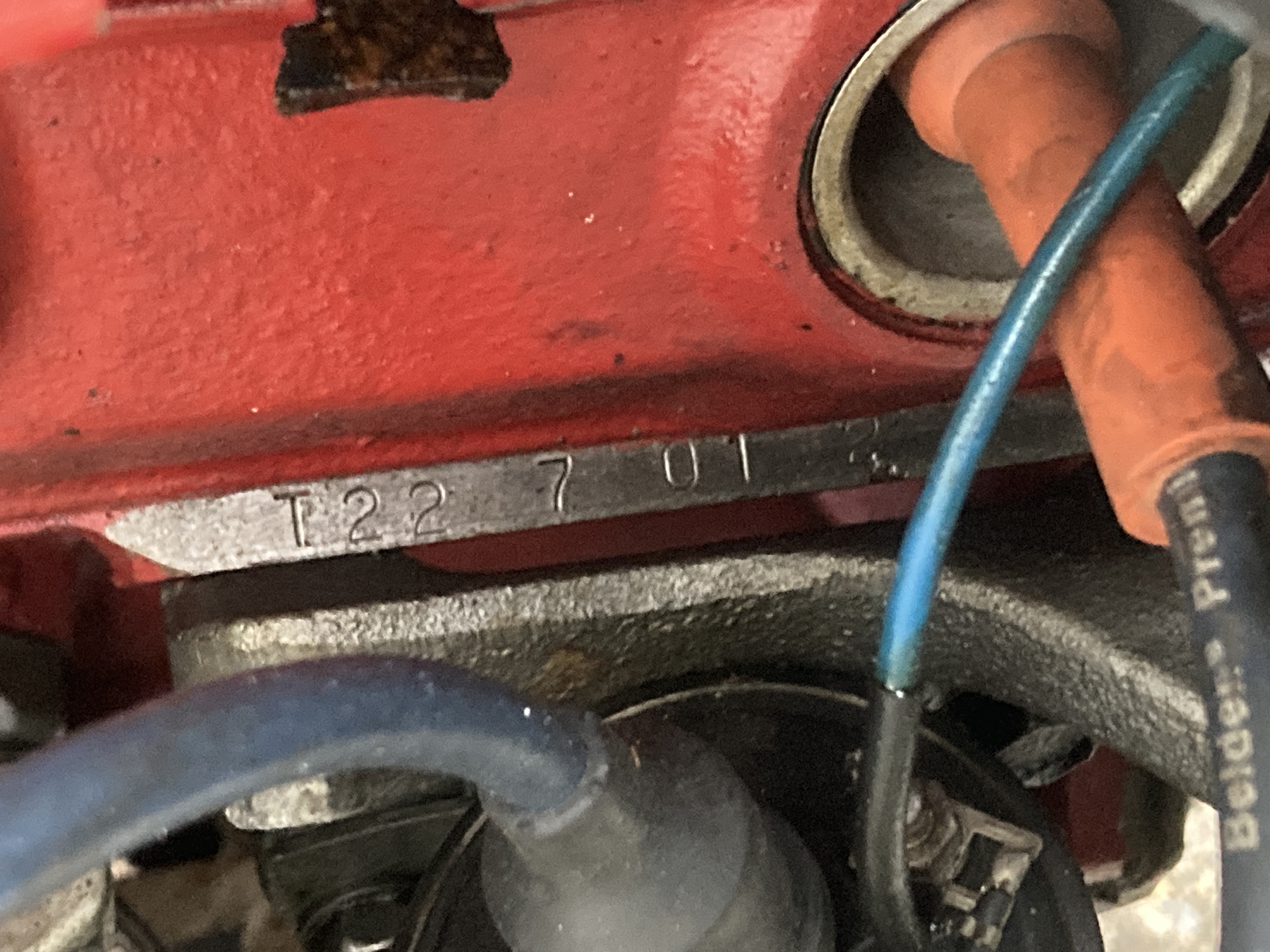

Looking good! 170 or 225 CID?

It's a cast iron 225, Rick!
freeze plugs tell the tale - an iron block

Freeze plugs give that away, no freeze plugs aluminum block.
