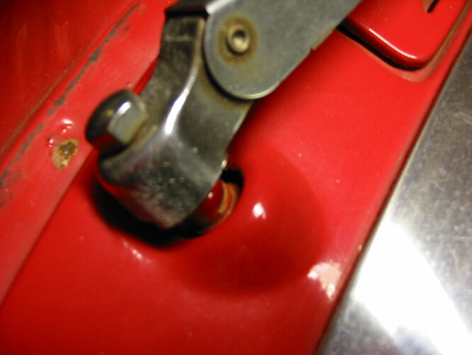

I bought a pair of hood bumpers from Restoration Specialties, to keep the corners from dipping when I lift the hood. While inspecting where to place them, I happened to look at the wiper bases. Ohmigosh! I ain’t got no grommets! In a good rain, I’ll have a deluge around my feetsies.
I’m in the same boat as Darryl. If Gary Goers doesn’t make these suckers, who does? I need a pair!

Regarding the pivot gaskets, I too do not understand where they install..I’ve taken a few of these apart, but I’ve only re-assembled one, and I don’t recall the seeing gaskets..perhaps, John, they go on the shafts before you install the mechanism (arms and motor) from under the dash.

I just flipped thru the 59 Parts Book (p. 23BF-10), and sure enough, the flat 3-holed gaskets install over each shaft plate, before they are pushed thru the firewall and secured. You cannot see these gaskets from the outside of the car.
Later Mopars..i.e. mid-60’s Mopars did use rubber grommets to seal the shafts.
Now, I see… Here’s the page Roger is referring to (attached). The gasket is on the inside, there’s nothing that goes around the post in the well.
Well, shouldn’t there be?! Can’t water accumulate in those little wells, and rust out?

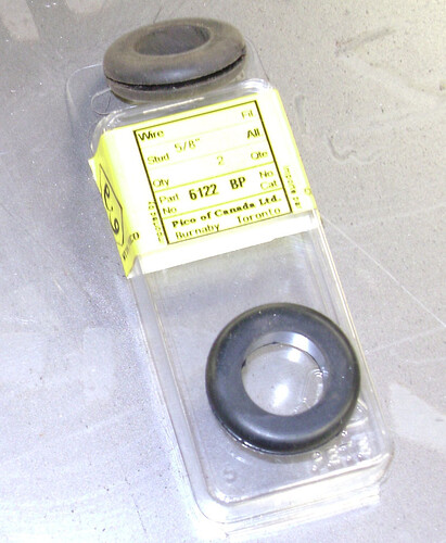

The second pic here is of a grommet that Darryl Gaspardone plans to put behind the well, between there and the pivot plate, in order to fill the gap. But, might not something like this work if inserted from the outside? Granted, it wouldn’t be original… But, Ex couldn’t think of everything. (Reading his bio, by the way.)
