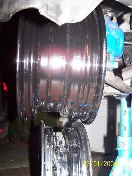

The size of the stock rims on some cars is 5”x14” on others it is 5.5”x14”. The rims on my car are the original ones (14”) but I’ve “opened” them to 7” width. I’m pretty close to the edge now (without cutting).
  • The front rims are “opened” with a negative offset - the rim goes more to the outside, otherwise it would touch the upper control arm. Also the tire would touch the inner fender, when the steering wheel is fully turned to one side.
  • The rear rims have a positive offset – the rim goes more to the inside, otherwise the tire would touch the fender.
The most challenging thing was to widen the rims that they fit over the callipers. Since you want to go for 16” rims that won’t be a question for you, but you have to consider another problem. Our cars have leave springs on the rear and that means the tail pushes sideways over the rear axle when you drive curves. An offset of 1” to 1.5” to each side is easily possible and then the tire touches the fender or fender-skirt. To make it safe you might need a Panhard-bar.

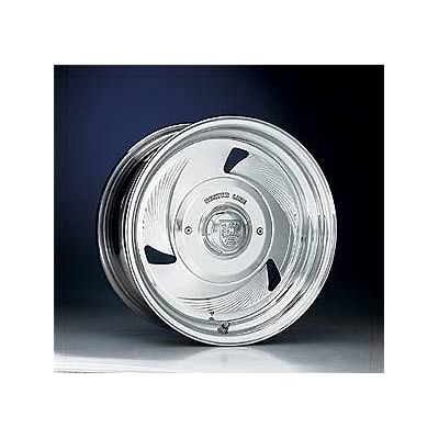

I changed to a 1976 Volare 8 1/4 3:23 Posi-Rear. I used 16 x 7 Centerline Fluted Hawk Rims with 3.5" offset. I mounted 225-55-R16 radial T/A tires for the back and 205-55-R16 tires in the front (same rim size).
There is still room left in the rear side to side, but since my car was lowered the problem came when you tried mounting the rim and tire to the car. There was just enough room to fit the tire between the car fender and drum.

16 x 7 Centerline fluted hawk rim
Thanks for your replies, Curt and Stefan! I am going to install a Dana 60 in the rear but would like to keep a relatively stock appearance. I was thinking of using a 15 or 16 inch chrome wheel, but I sure like the looks of those Centerline wheels! It sounds like the 7 inch wide wheel will be the right size.
