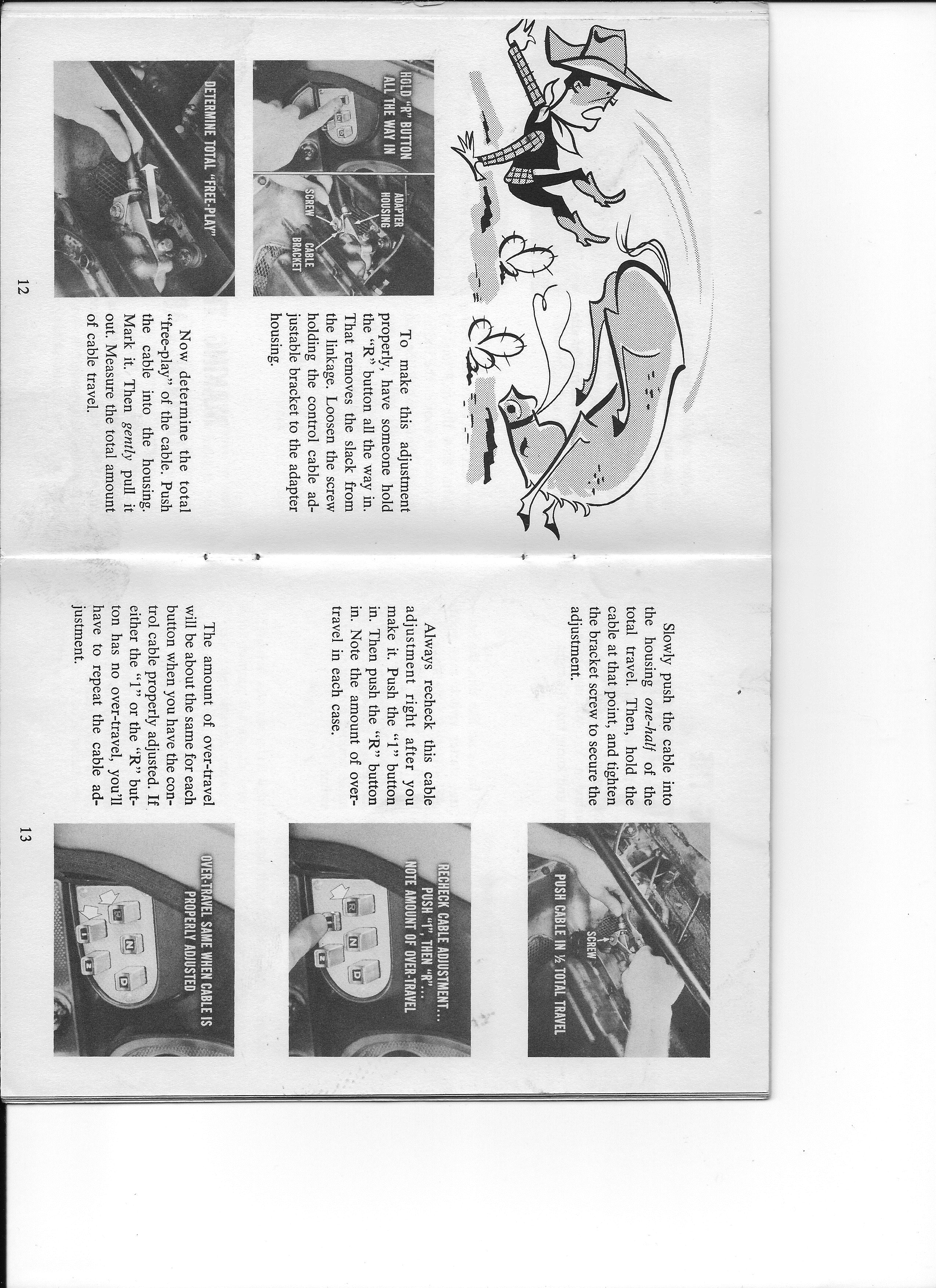

Guy - Hope this helps. Click on picture to enlarge.
Thanks., will look into it…already dismantled the complete dash to paint it…noticed on the shifter mechanism., the spring for the N button was comressed and stuck., so it wasn’t kicking back out..so probably have a few issues.
Thanks., Guy
