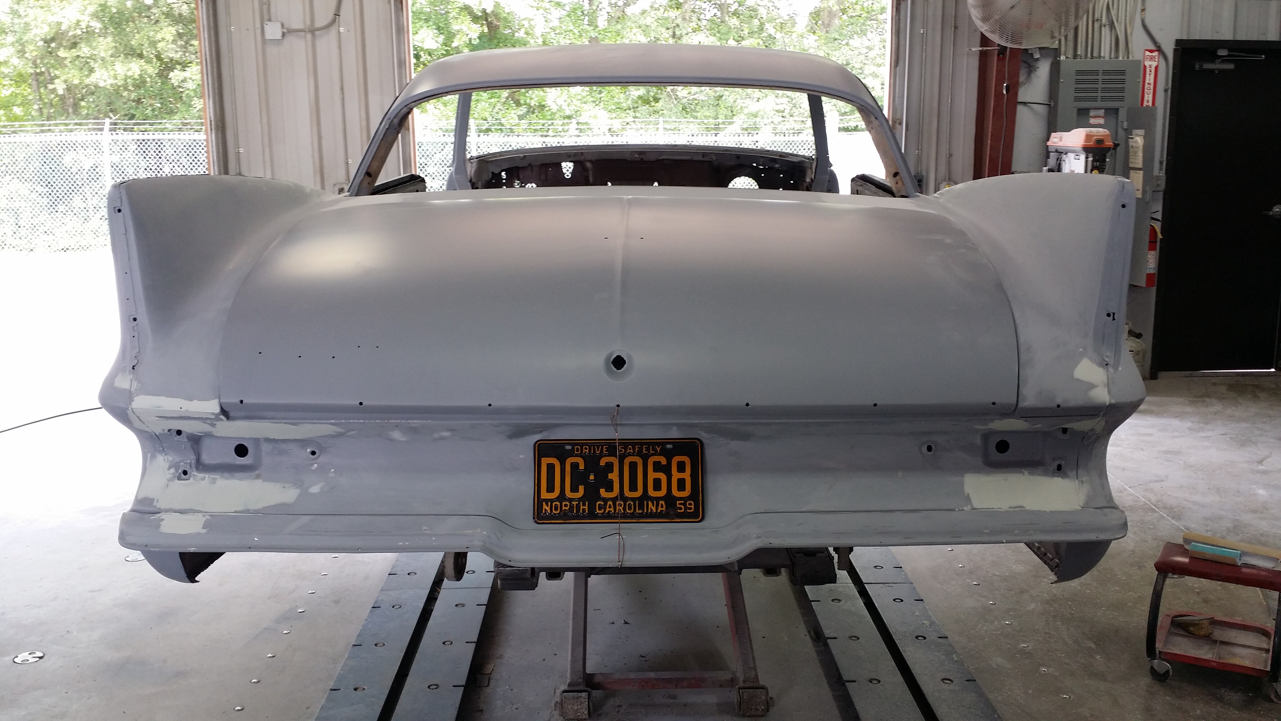

Thanks for all the replies. I hadn’t thought about using door edge moldings, re-sprayed argent silver or light gray. Here’s a pic of how far I have to go on the Fury’s re-do.I appreciate all your ideas. DC
Wow! it is looking great and ready for paint pretty soon! Keep the pictures coming of this rest.
