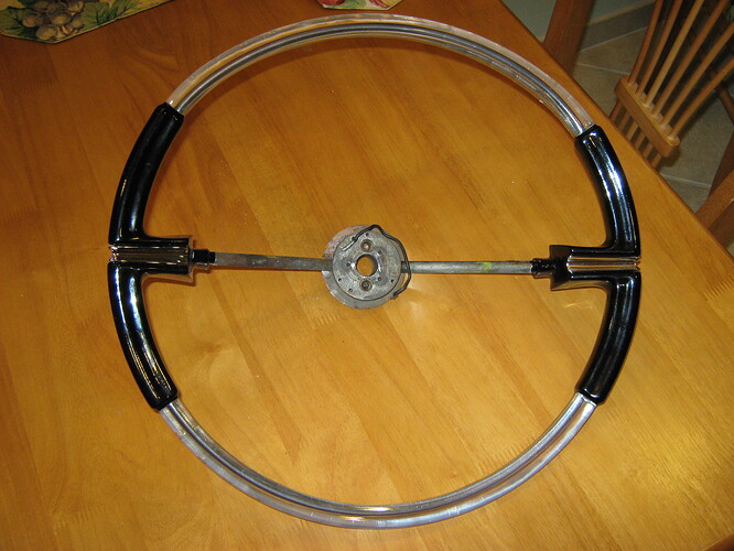

Hi Tony – I’m taking the liberty of posting the image here, that you sent me on an earlier occasion. Thanks! Dan
Yeah, that wheel looks very nice! Our wheel is now being recasted. Can’t wait till my parents pick the wheel up at tony’s place. I wanna see it :smiley:

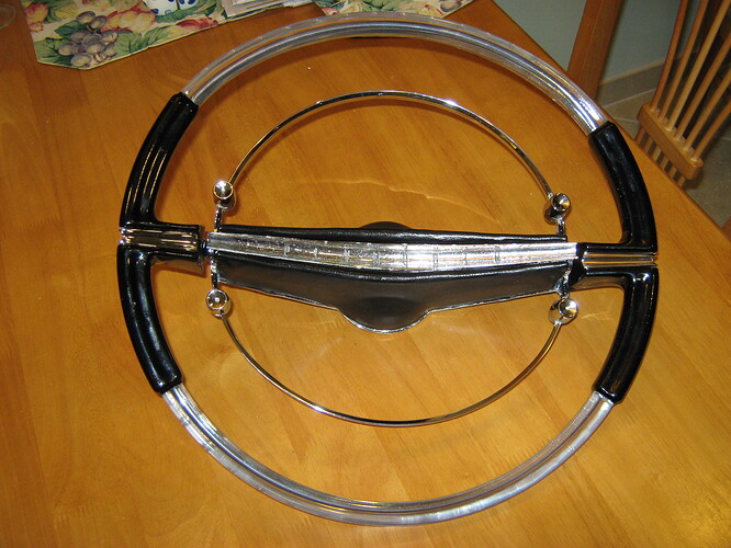

Ragtop, I sent out my steering wheel to be recast by Koch’s, in California. I don’t know if the work is as good as Eash’s, but I’ll soon find out – it shipped Friday. I’ll take pix and post them here when it arrives.
The also touched up the padded insert for me, and painted it and the brown parts of my wheel black. All for $600; we’ll see.
The wheel’s arrived! It looks just great. I noticed a tiny bubble in the lower casting, off to the side – really too small to even mention. The cracked brown pieces were expertly glued together – it looks like they may have been encapsulated in black, one continuous piece! An expert fusion with the clear plastic; and the padded center came out beautiful. Now, I’m going to have to get the “Plymouth” insert rechromed!
I’m really happy with the way in came out. It makes the whole “Robert Doucet” incident a distant memory…
