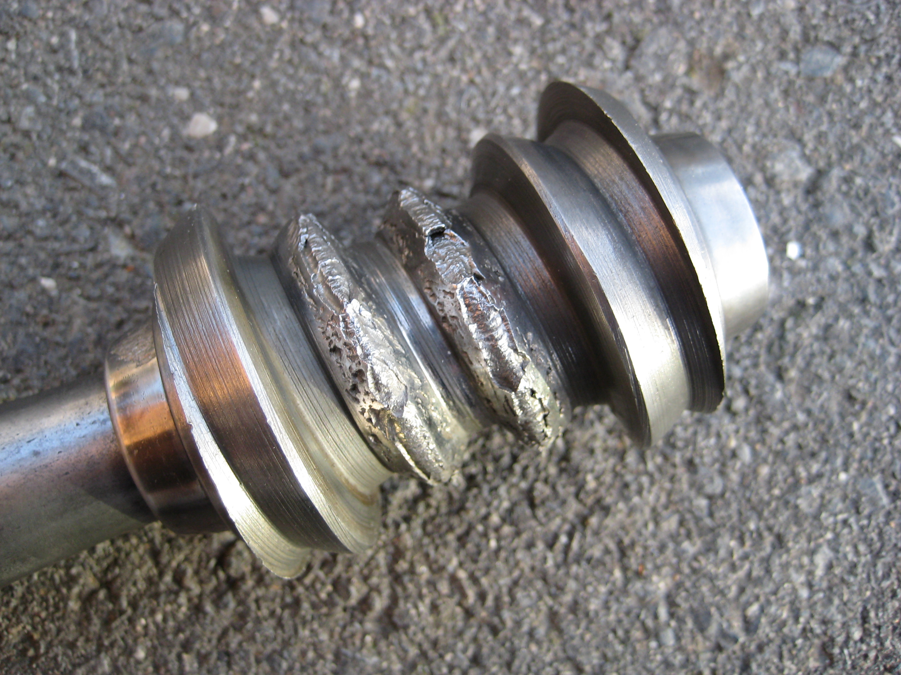

I am currently in the process of rebuilding my manual steering box.
What I thought I was going to do (renew bearings and seals) to what I have discovered that I have to do are now very different.
After stripping the box down and cleaning all the parts I have found that the worm gear is completely shot and can not be put back in, suprisingly though the sector shaft gear only has a couple of tiny pit marks :confused: not sure how that can be but it is?
Has anyone else ever experienced similar situations?
My million dollar question is this, does anyone know if this worm gear is available anywhere as either NOS or repro part?
It appears to be a press fit onto the end of the steering column shaft, but at this stage I hav’nt tried to remove it.
Any help here would be greatly appreciated.

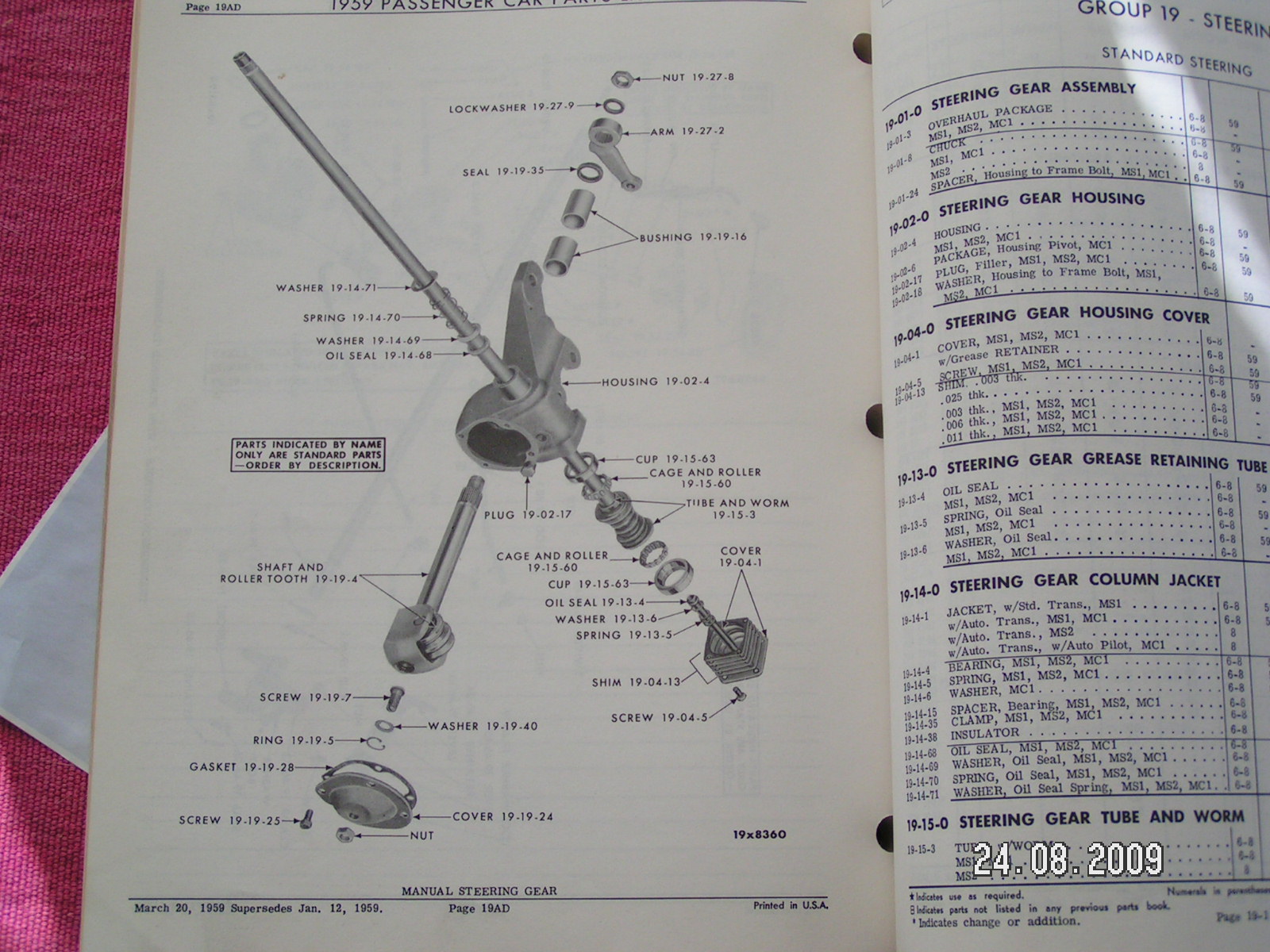

I have the Parts Book open to the correct page, laying on my scanner, but I haven’t figured out how to post a scan…,
I see a part labeled ā€œTube and Wormā€ = Mopar Part 1675 733.
There is no separate listing for worm gear, lending credence to John Fowlie’s belief that the gear is welded to the shaft.
Thanks for the part number Roger now just to find the part!!, I hear what your saying about the shaft and gear being one unit but there are no visible welds as far as I can see? I was speaking to a guy over here and his theory was that gears were heated up prior to being pressed onto the shaft and as they cooled down they locked on. I will try and press the old one off (got nothin to loose cause its already stuffed) and see what I can find out.

Roger thanks for posting the exploded view of the steering box very helpful, I’ll keep you posted when (or if) I get this problem sorted out.

I need the worm gear for manual steering, if it comes attached to the shaft thats cool but definitely need the worm, check out the photo, you can see why! I would even consider a used part if it is in good condition.
Let me know if you have any luck mate, much appreciated
Cheers
Matty, is yours as bad as this or haven’t you taken the box apart as yet?
That’s one messed up gear!
