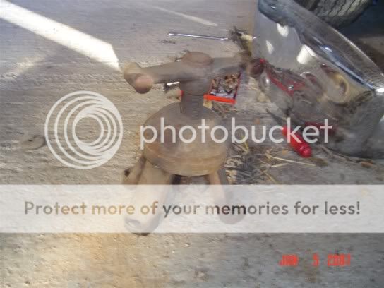

Are you using the correct type of puller? There are many different ones out there, and some that are rather useless. I use this particular type, I bought from the Snap-On dealer 30 years ago.

Nope, just a traditional puller. That is what I imagined I needed in my dreams last night while I was kicking myself in the you know what. My friend is a MATCO dealer and I can see with them. These drums just colapse under the pull of a normal puller. Thanks for the photo.
