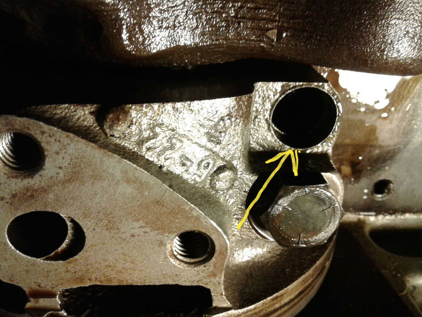

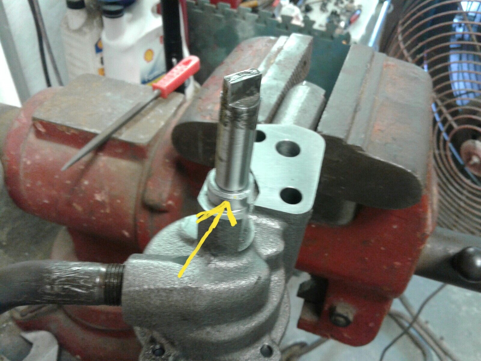

All the pictures have comments. Before installing the pump l inserted the pump drive and distributor to make sure everything stayed in place when l installed the pump. I was concerned because the previous pump failure was caused by the drive end of the shaft wearing/breaking on the top half of the oil pump shaft male flat only. Then l installed the pump and the pan. Next l will fill the pan with oil remove the pump drive, distributor and valve covers then using my home made priming tool and Yvonne’s drill motor to pump oil throughout the engine. Next l will lower the engine in place, button everything up and give it a go.
This I’d the collar that fits in the hole in the main bearing cap. I had to file and sand it to fit in the hole.
This is the hole the collar fits into.

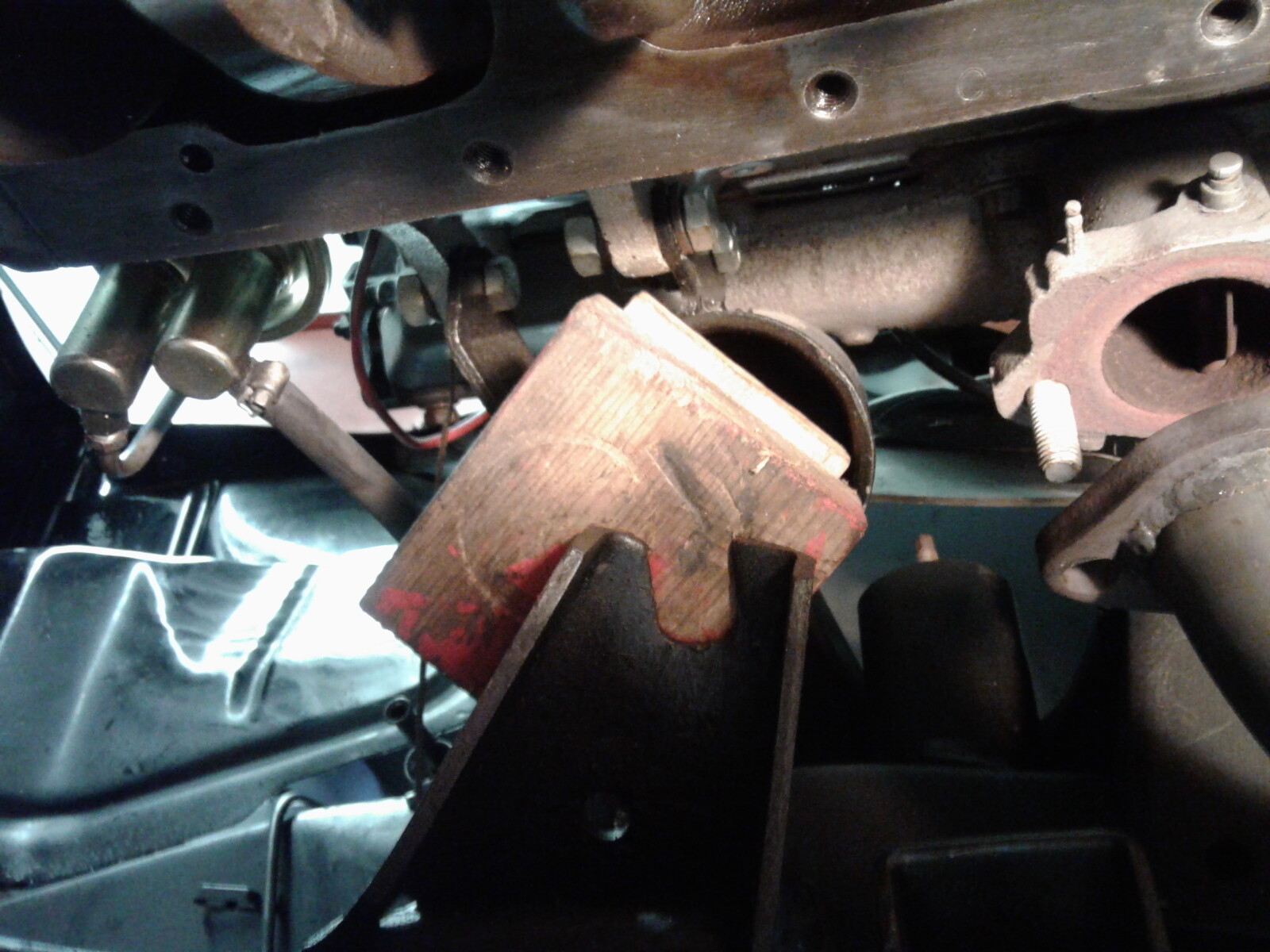

2" wood block inserted in motor mount bracket. Same on other side.

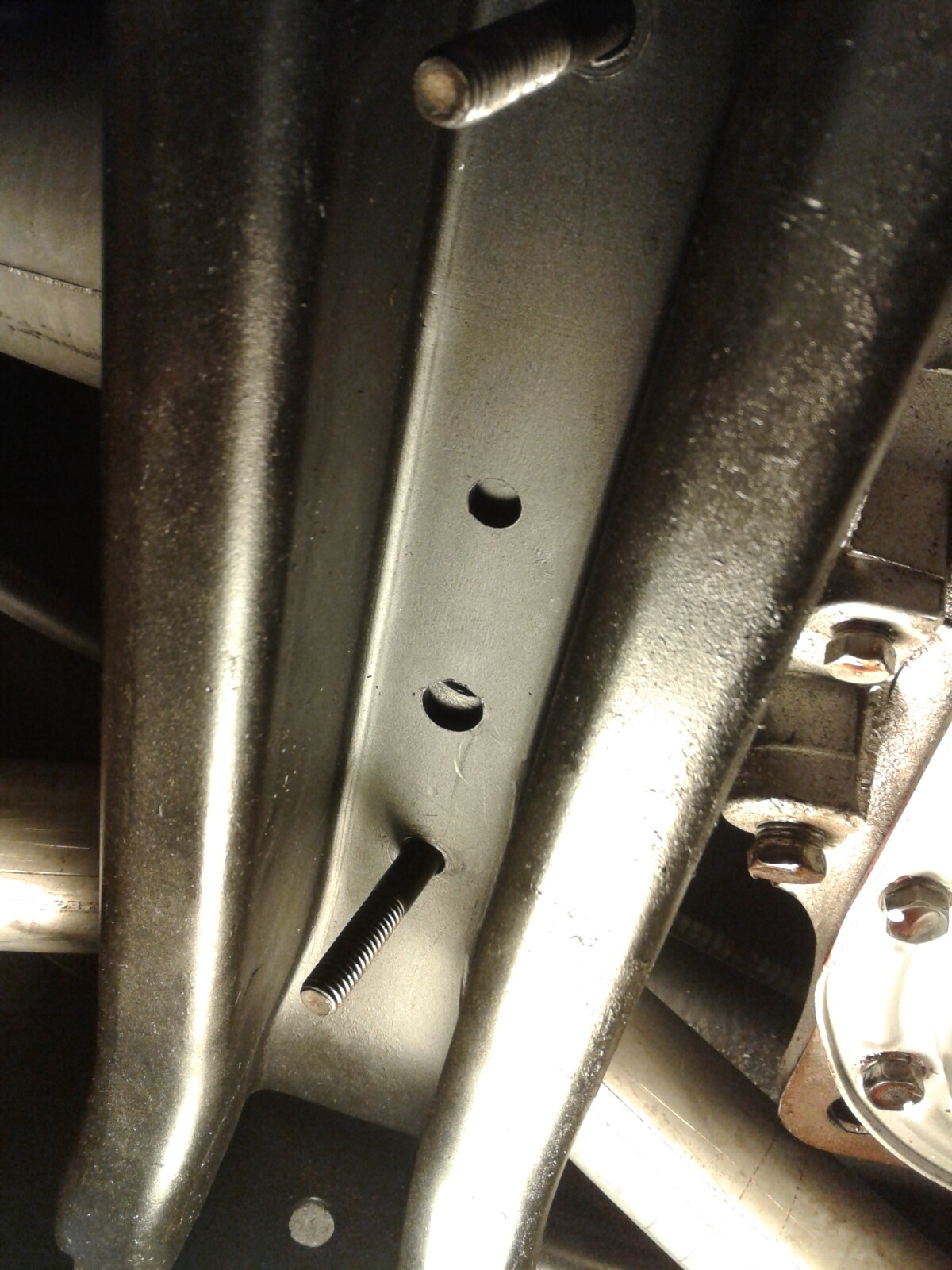

Two long bolts in transmission mount to keep the whole mess in place.

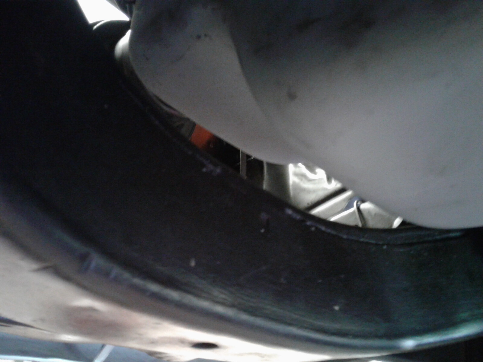

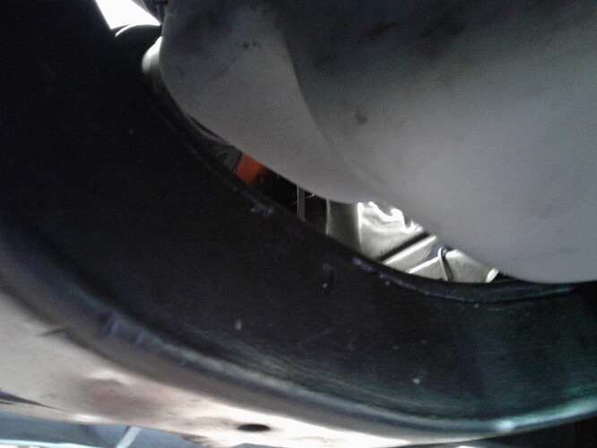

Plenty of clearance to get the pan out and in.

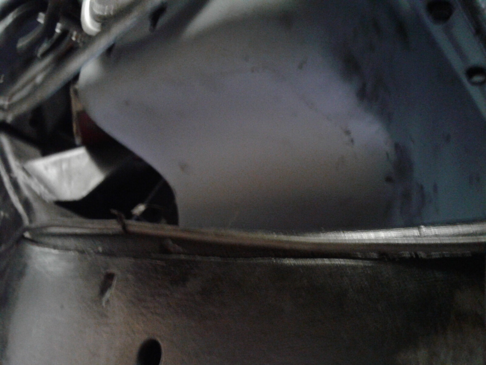

Another view of the clearance.
